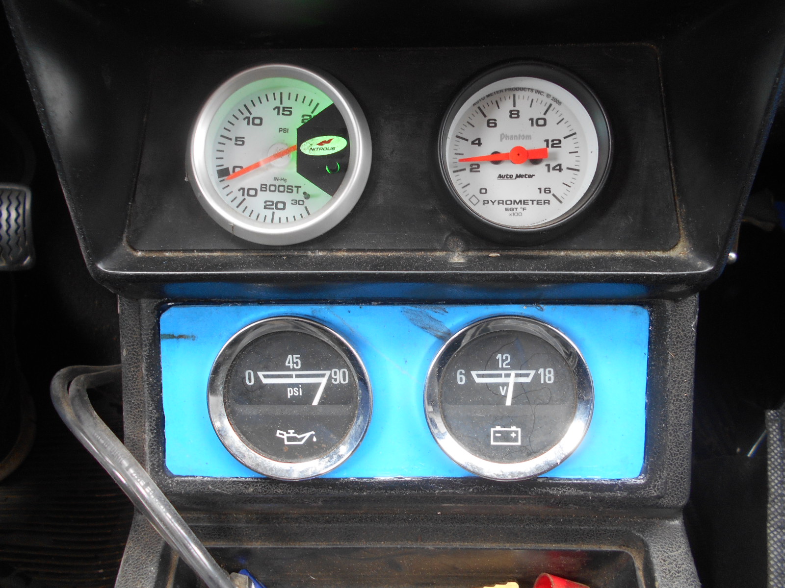

OK, I used one of them oil filter adapters(sandwich adapter), I had to buy the one with the thread slope I had, I believe I ended up with one that had M20Xp1.5 when I needed one that was 3/4 UNF 16.
I needed mine because I wanted to use an electric oil pressure gauge, but the sensor was to big to fit where the dash light sensor fit on the diesel engines, and these sandwich adapters are cheap, all you do is search "oil filter sandwich adapter" on ebay.

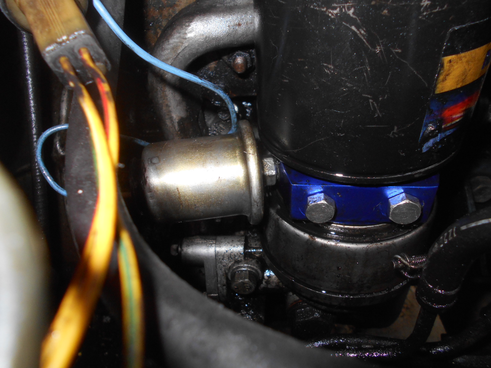

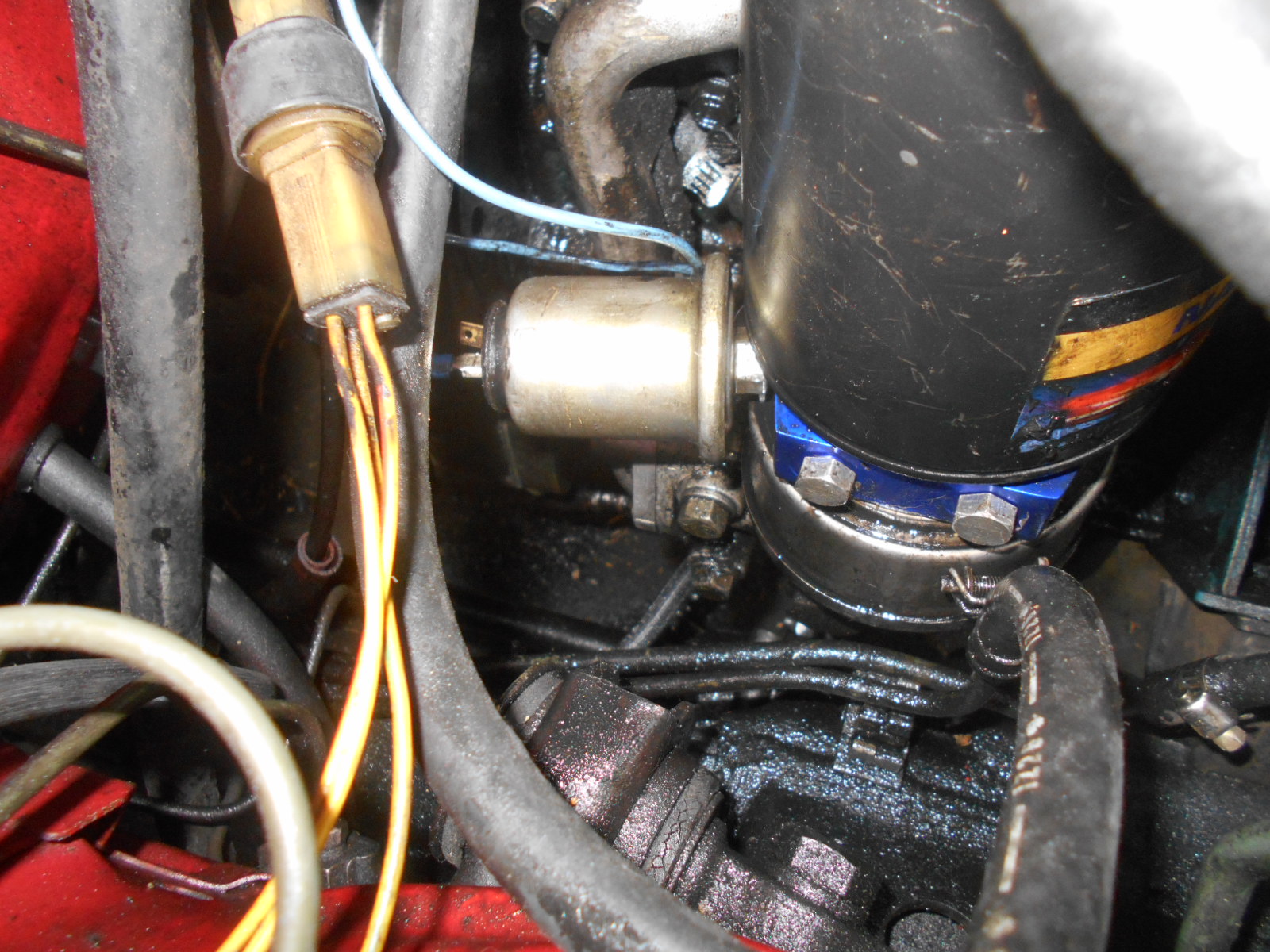

I added a couple photos of my adapter on the SD25 diesel engine, but I have the spin on oil filter threads that stick out, what needs to be done in your situation is you need a threaded nipple to spin into your threaded bolt hole, then buy the sandwich adapter that fits your thread slope.
Next you would have to buy a remote oil filter kit and install it on the sandwich adapter then route the hoses so the oil enters the filter the way you want it to if the spin on oil filter doesn't work the correct direction, now if you do this remote setup, you only have to mess with it once, as from then on you only change the spin on oil filter, as you don't have to mess with the lower part anymore.
When I put my sandwich adapter on and connected the sensor, I got a surprise, my oil pressure was maxed on the gauge at an idle, it shows way more pressure when the sensor is mounted on the adapter than it does mounted on the side of the block, so I say if you do go this route, check the adapter for oil leaks a lot till you are sure there are no leaks, a 100psi is a lot of pressure.

waynosworld, I think your oil pressure sender may be mismatched to the gauge. Have you looked at that?
- Posts: 618
- Has thanked: 3 times
Re: SD22 (MARINE) OIL FILTER PROBLEM

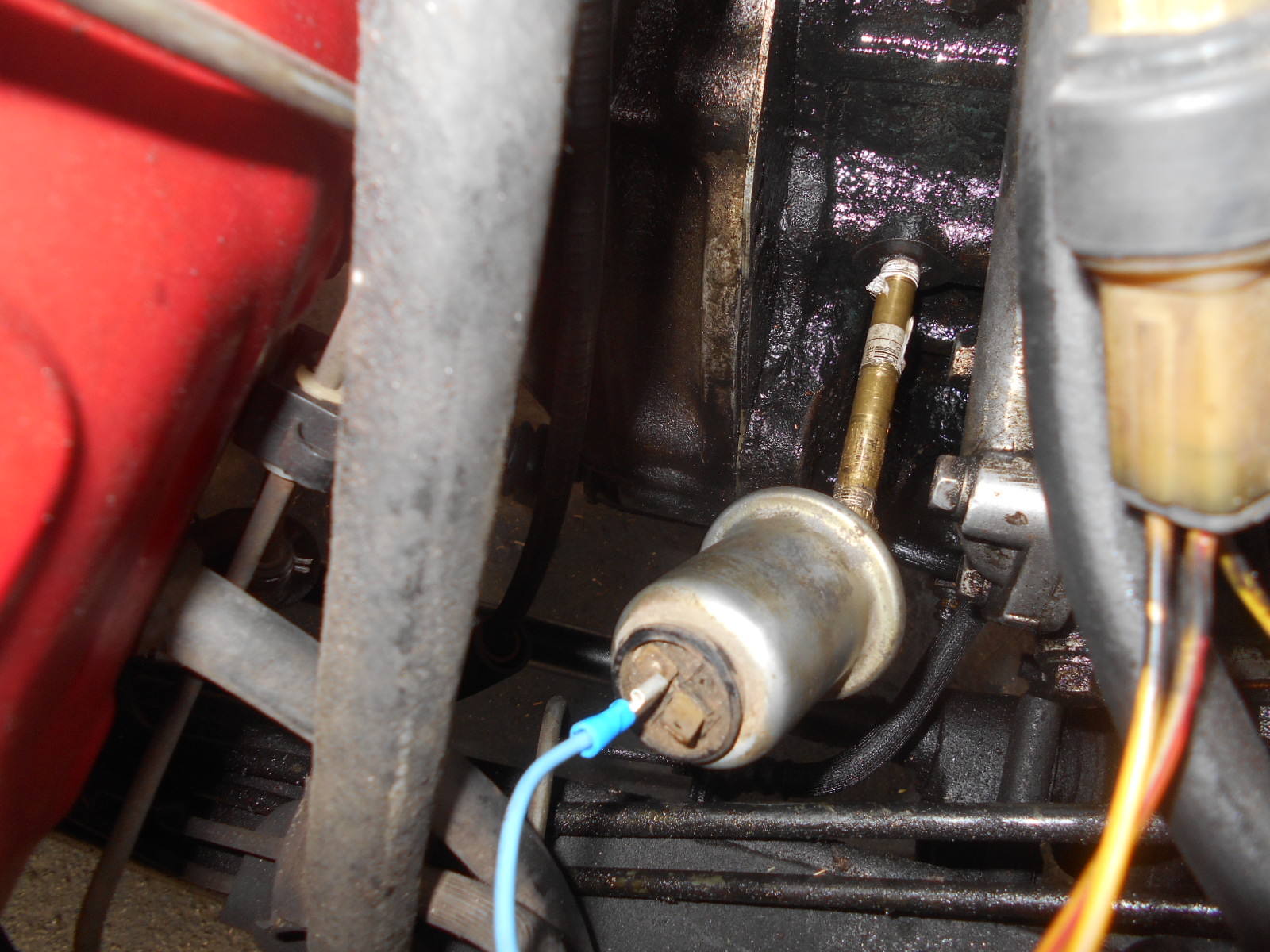

Same sender I had on the other engine, also the same gauge, it showed normal pressures on that engine, when I put this turbodiesel engine in the truck I used an extension coming out of the hole that had the dash light sender, it showed normal pressure there also, but it broke off while I was driving down the road, I am really lucky I didn't blow up the engine, I pulled into the store and got out of the truck and started walking into the store, I seen this huge line of oil on the ground and thought what car did that come from, I turned around and followed the line to my truck, it was me.Sailboat wrote:waynosworld, I think your oil pressure sender may be mismatched to the gauge. Have you looked at that?
Anyway I got that broken off threaded piece out of the hole, put the original sender back in the hole, put 4 quarts of oil in the truck and drove it home hoping I didn't hurt the engine, I don't believe I did hurt it.
So then I bought one of these pancake oil filter adapters and installed it, I plugged all the holes in the adapter except the one that I put the sender in, started it up and rushed around to make sure there were not any oil leaks, got in the truck and seen the oil pressure was pegged at an idle when cold, it isn't pegged when warm, although it still shows way more pressure with the sender mounted in that pancake adapter.

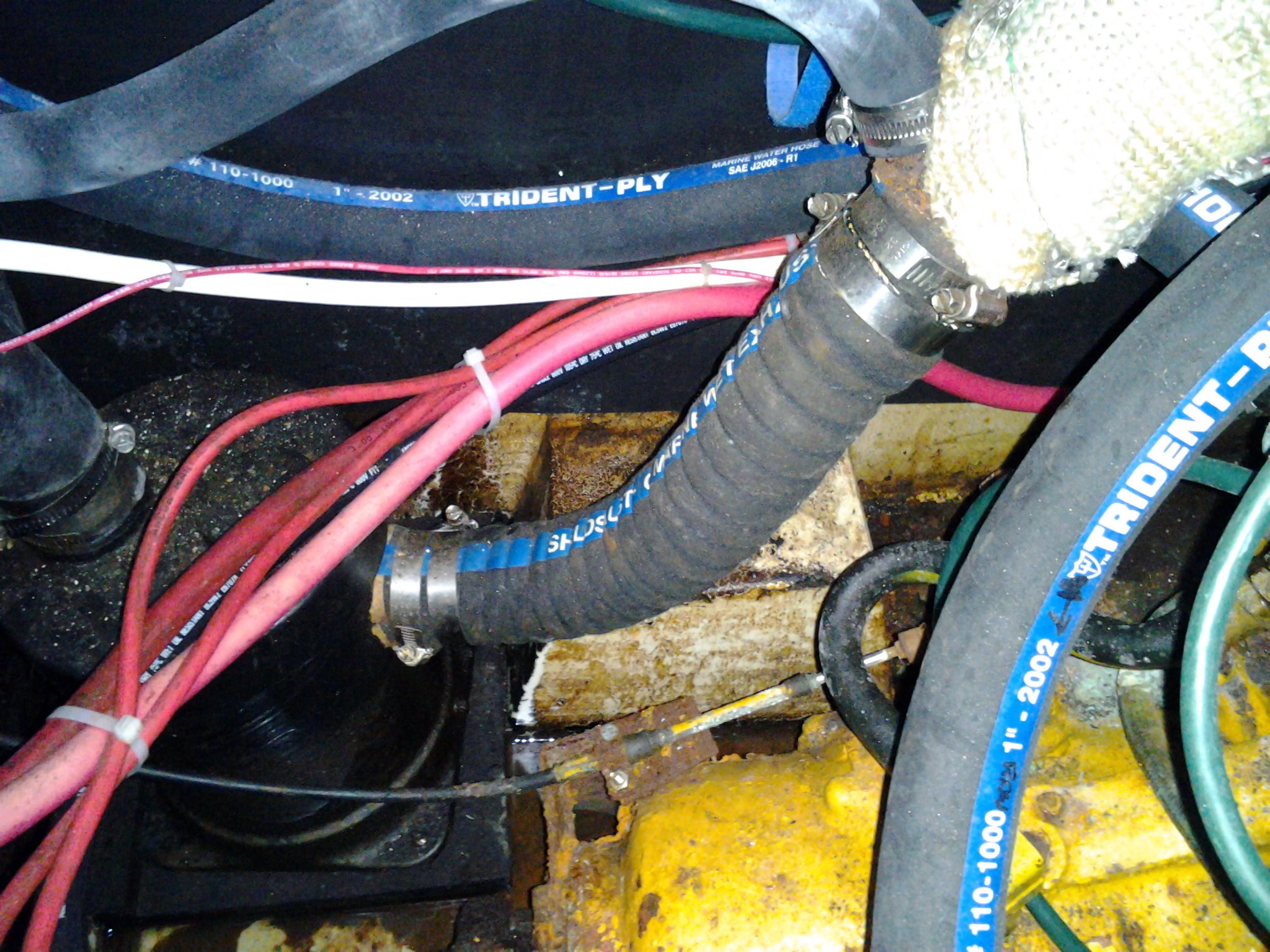

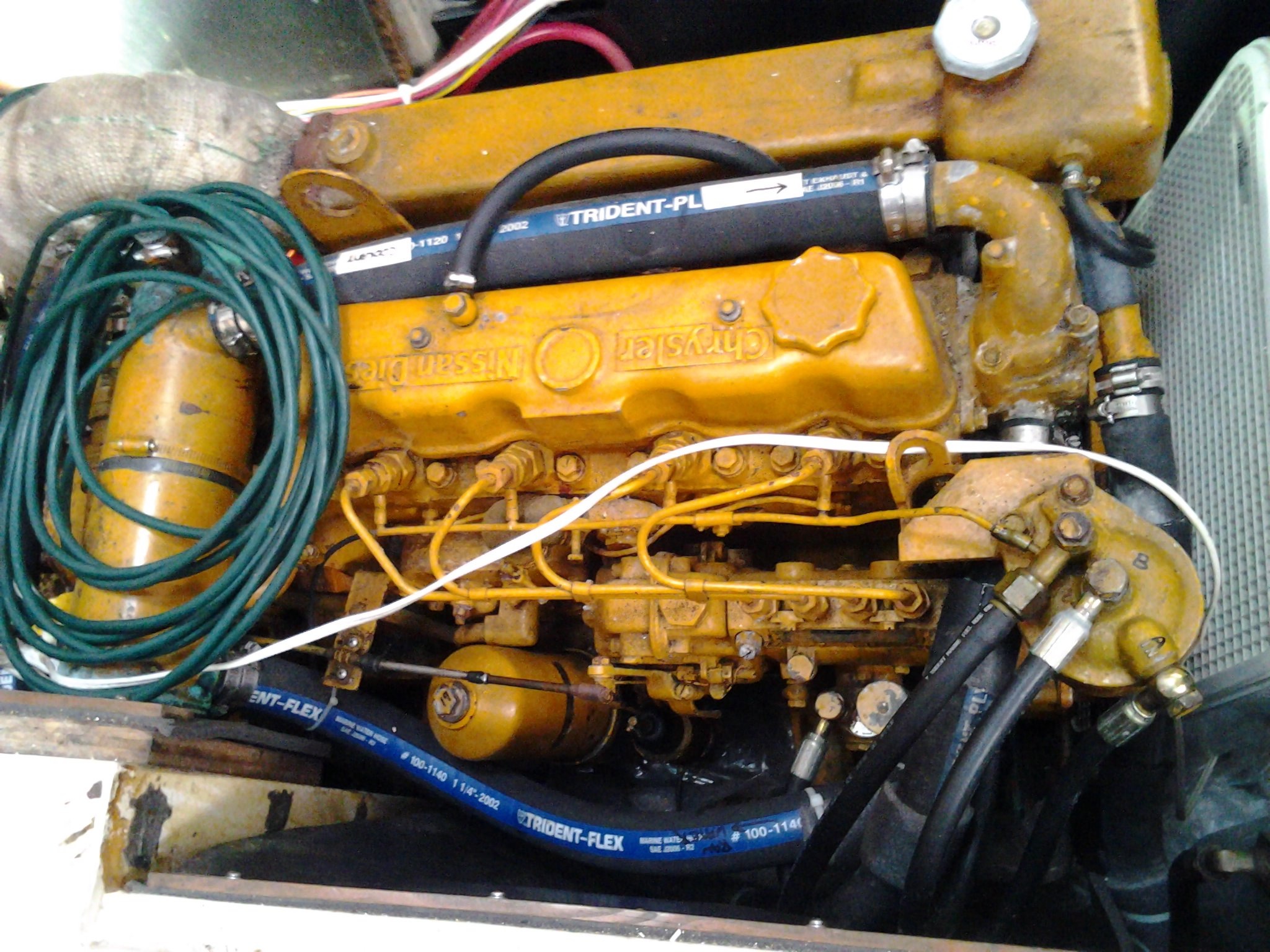

Tom, was this what you wanted (See pics)? I think my set up is already like the one you are heading for. I wasn't able to measure anything, all the fittings are covered and no markings on that reinforced hose. The heat wrapped casting is what I think you were asking about, you can see it in the top right and top left of the photos. Size wise, your basically stuck with the wet muffler fitting size, then will have to bush it to fit the non-cooled (dry) part of the exhaust.
