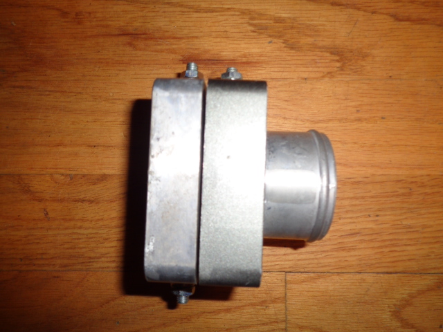

I actually bought 2 different types, the one you bought and had the round end machined off, and another one that is already flat on both sides.

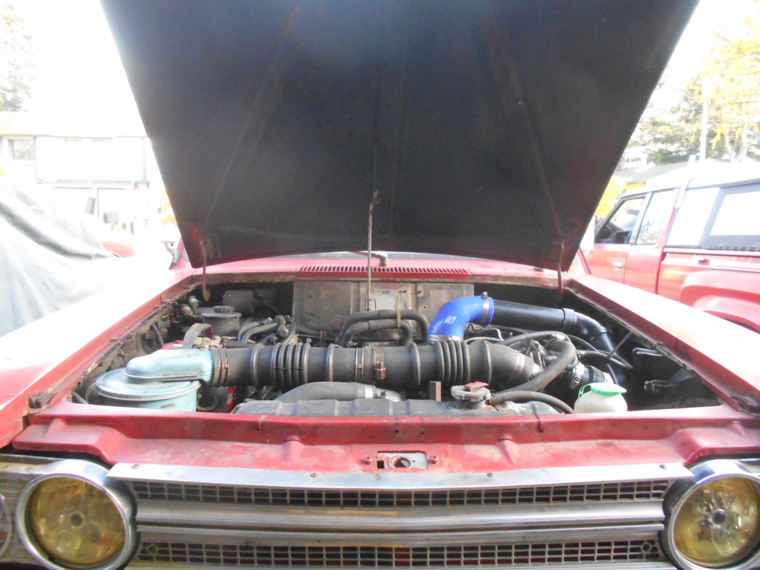

I am not sure how much room I have under the hood on my 521, the hose is not rubbing the hood right now, but it may rub 3/4" higher.
Re: RWD SD25 in Canadian winter?
Mine just clears by about 3/4 inch. That little guy you got may be pretty close. I laid a piece of 1x1 on the top of the air cleaner and closed the hood "carefully".

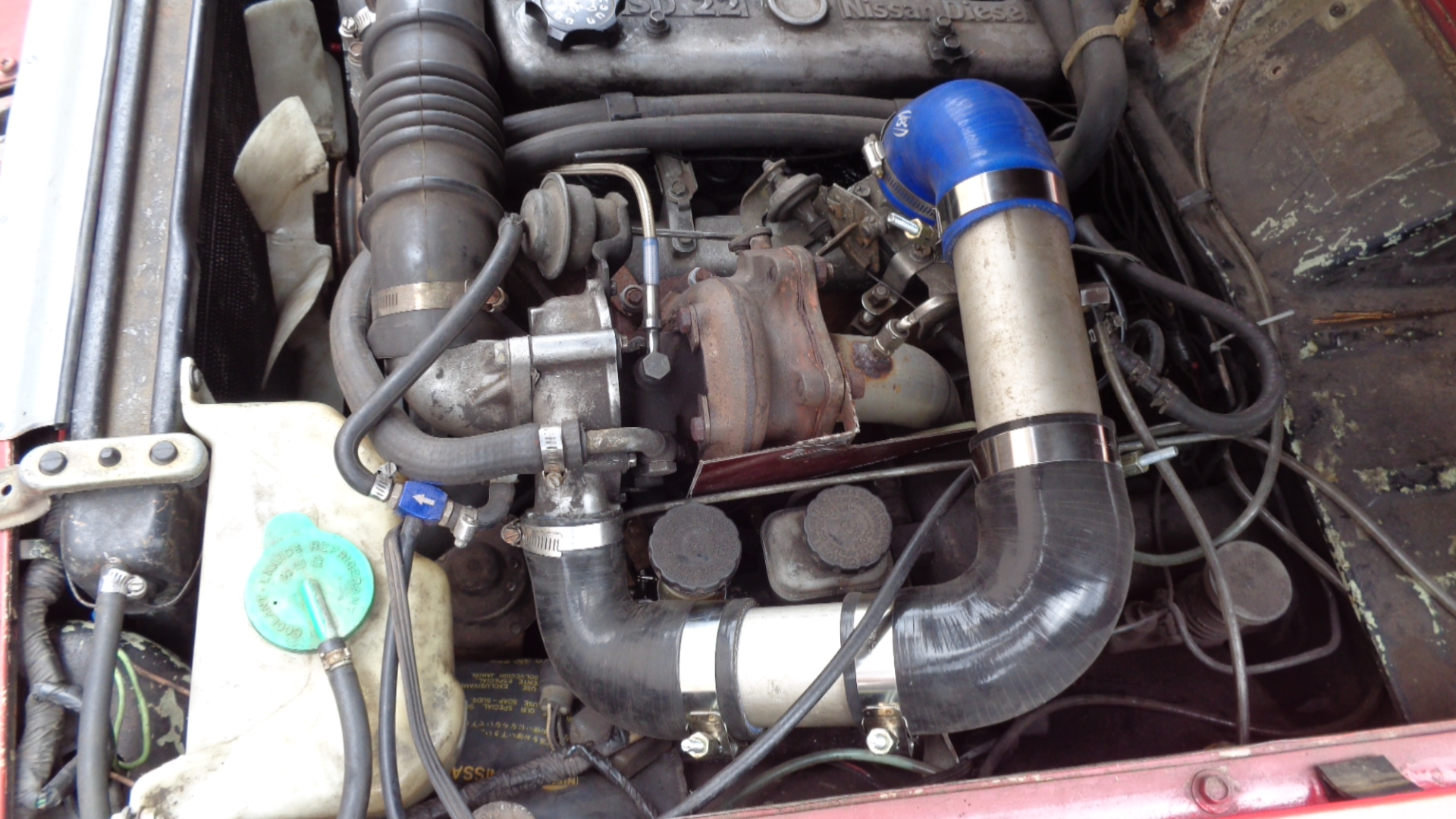

My Datsun 521 kingcab engine compartment is likely a little tighter than your D21.
That blue elbow is close to the hood right now, not sure if I have another 3/4" left, I may have to change things or put the heater between the turbocharger and the blue elbow, it doesn't look like the photo above anymore, it now is like the photo below, I replaced the ABS tubing with aluminum tubing from a hangglider that I scrapped because it was not air worthy anymore.
I see what you mean. The closer to the engine the better, however where you can make it fit I guess is worth a try.
I expect I can trim that blue elbow some to get a little lower but not likely 3/4", this engine of mine turned out to run so well that I don't really want to change anything that cannot be reversed, the difference the turbocharger made is so dramatic, but I would like to drive it year round and it don't like starting below 40 degrees, and at 32 degrees and below it don't try at all.

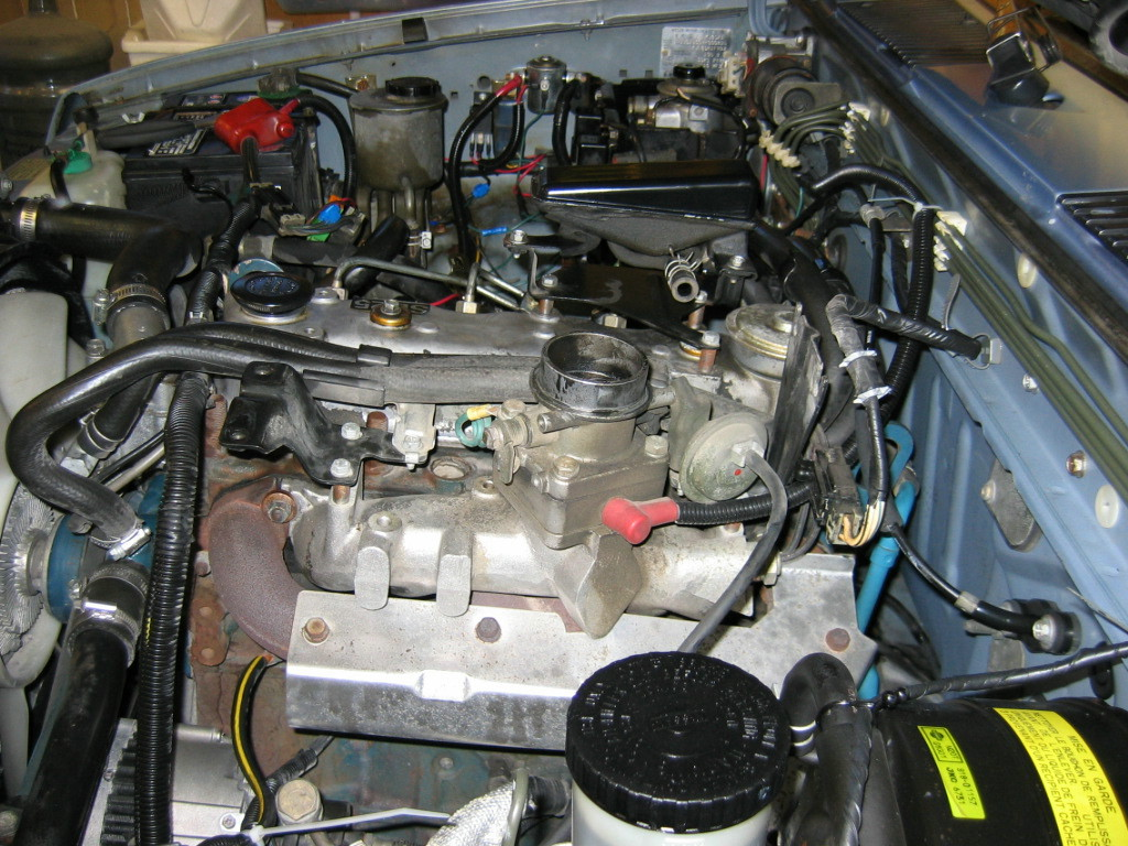

OK, in this photo you have the part that your air filter housing connects to on top of the air heater element, that part is just a hollow tube leading to the intake manifold, correct?
http://asavage.dyndns.org/Nissan/720/Ow ... 51_9_b.JPG

waynosworld wrote: ↑5 years ago OK, in this photo you have the part that your air filter housing connects to on top of the air heater element, that part is just a hollow tube leading to the intake manifold, correct?
That is the entire throttle body. It has the butterfly in it. If you remove the heater under that piece that is what was in the truck. I simply put the heater under it.

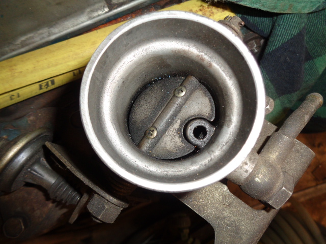

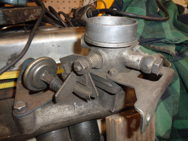

How can yours have a butterfly in it, your throttle cable goes to the injection pump, as you have a VE type injection pump, correct?
That throttle body i see in your photo doesn't have the throttle cable connection that mine has with the Vacuum activated throttle, nor does yours have the vacuum hose connection that goes to the injection pump, below are photos what I have, yours should be a hole straight down into the intake manifold if you have a VE type injection pump, other wise what operates the butterfly?
