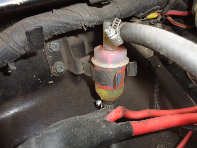

Well I am in your area, I used to have people come over all the time when I had a Craigslist ad up, they came over to either talk or figure out a start/shut down issue, but sometimes they bought parts.
When you lost the fuel filter and removed it using the plastic coupler(pen housing) I suppose there was the possibility dirt could have got into the lift pump screen but that is a stretch, what I have found more often is that people use gas fuel filters in these diesel trucks and sometimes have power loss issues within 10 miles, the nicer the gas filter the sooner the issue, either one needs to use a nice diesel filter assembly, a fuel strainer, or one of them cheap gas filters, but you have to keep your eye on them cheap filters as when they get dirty they can get sucked flat and then can get sucked into the fuel line itself, I should know about all this as I have either seen or had happen to me all these issues.

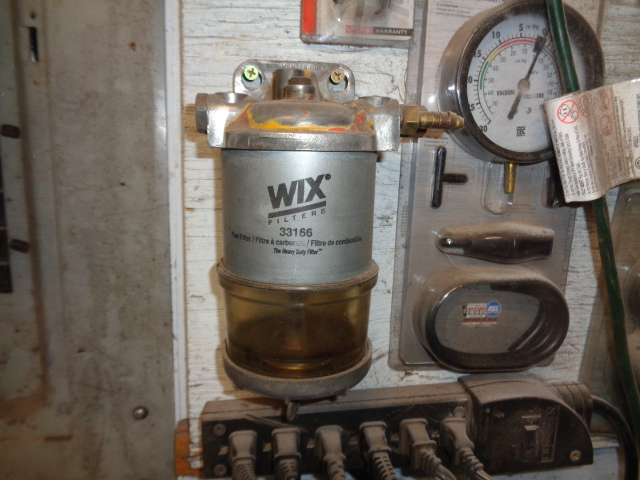

Here is a nice fuel filter with a built in primer pump.

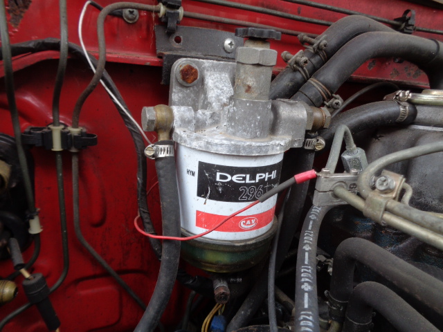

Here is one without a primer pump that is not in anything right now.
And here is a strainer, I do not have room for anything else in this engine compartment unless I start moving things around, since it works fine the way it is I don't care, I use these pre-filters to keep the lift pump screen clean as it is a major hassle to remove, clean and replace the lift pump filter screen for me.
Personally I have not ever seen a stock 1982 diesel pre-filter till recently when I bought a bunch of parts from a guy getting out of diesel trucks, he had a new one in it's box(PTC Filter, part #G2906) which when searched has no results, the guts inside one of these filters is different than a gas pre-filter, it looks more like a strainer to me.
I do not know if a hand primer can cause fuel pressure issues, the only fuel pressure issues I have ever had were caused by the use of gas pre-filters being used, the lift pump filter getting plugged up, or the main fuel filter needing changed out, just make sure the primer pump is locked down when not in use.
