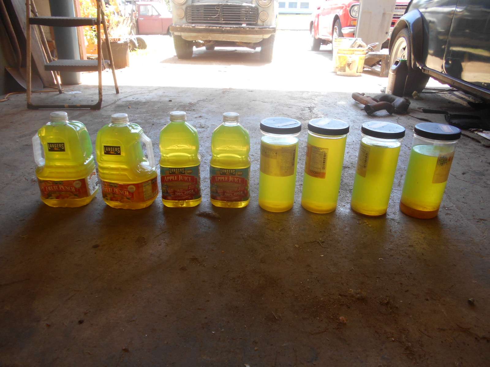

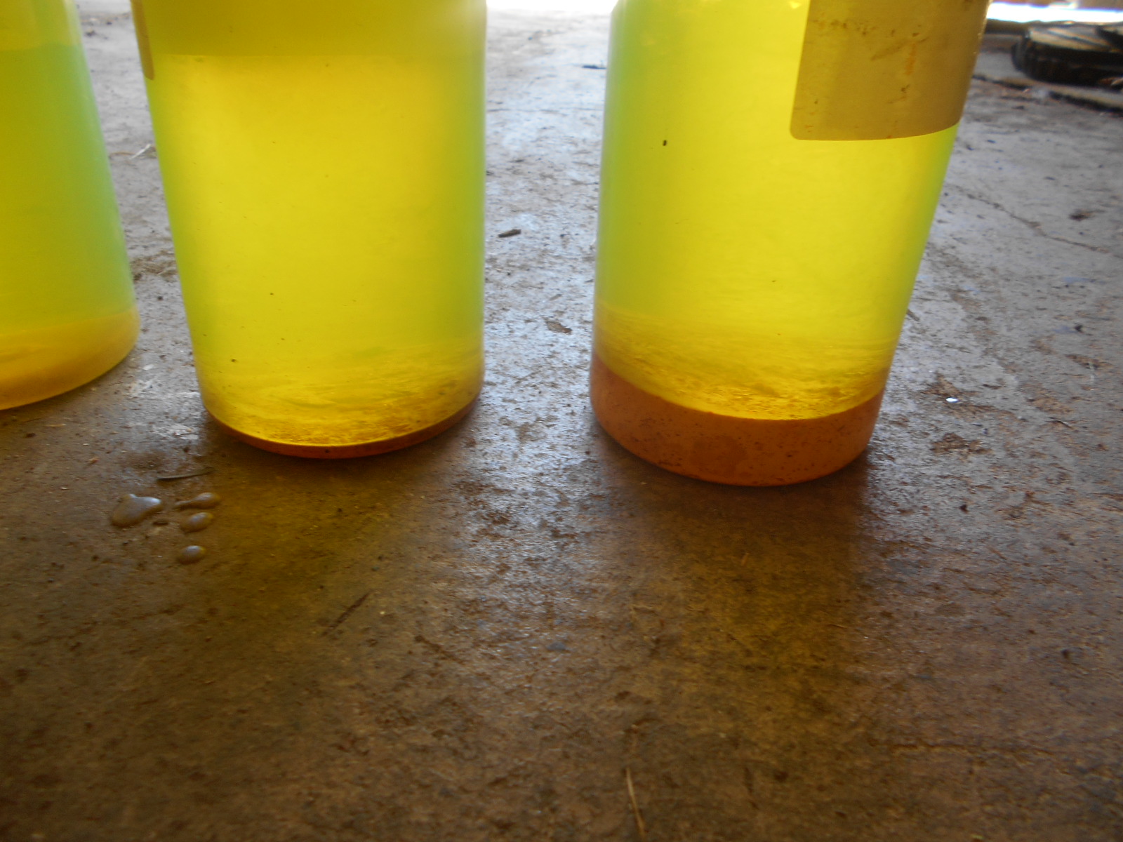

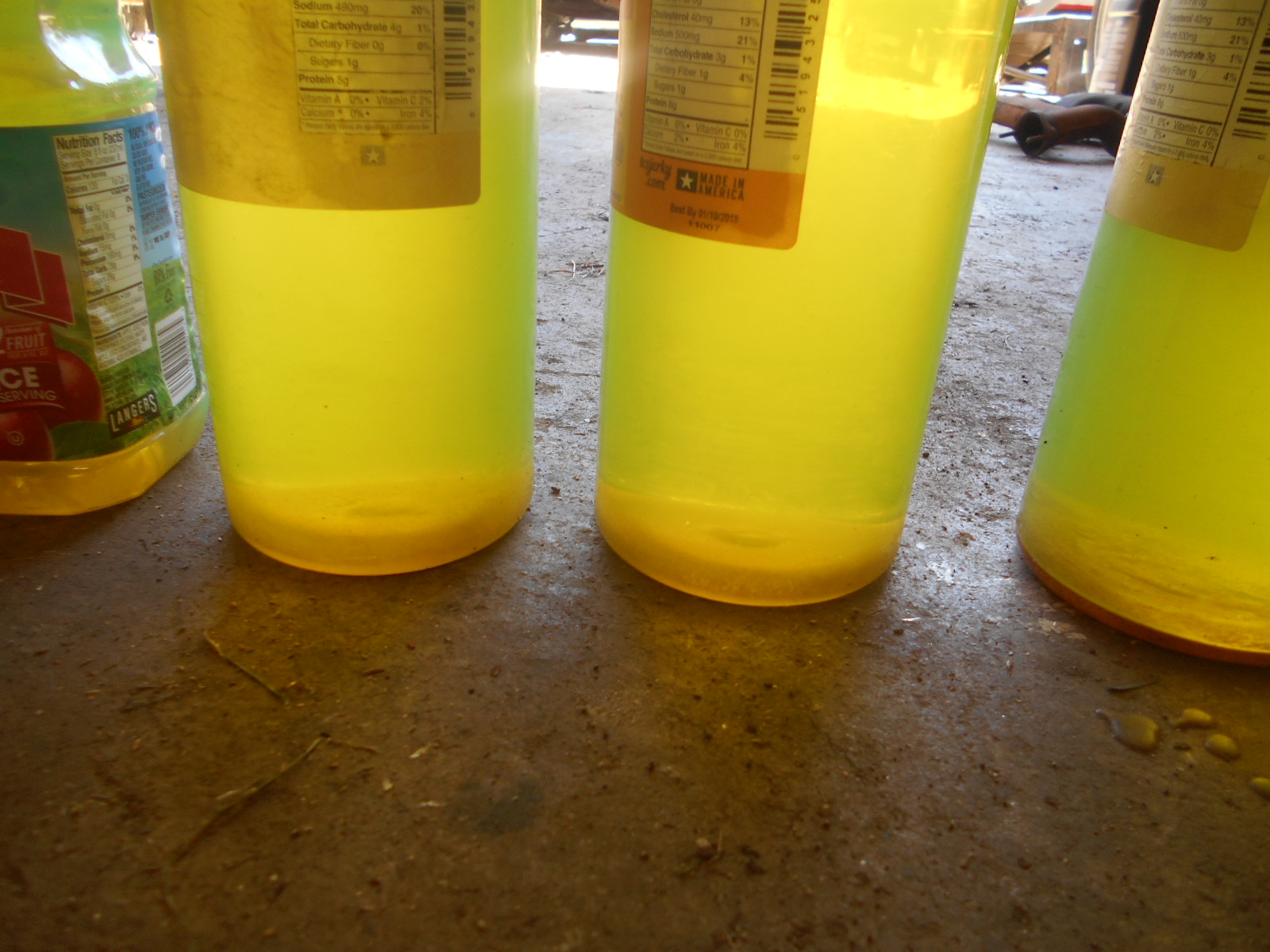

So I let the fuel settle in the containers that I drained out of the tank, even though it appeared to come out of the tank a different color the first couple minutes I have seen no separation except for the inch or so in the right container and the tiny little bit in the next one, otherwise it don't look like bad fuel to me.
I plan on putting this fuel back into one of my diesel tanks unless someone can give me a reason not to.
- DSCN7147.JPG (468.08 KiB) Viewed 5224 times
- DSCN7148.JPG (463.51 KiB) Viewed 5224 times
- DSCN7146.JPG (458.5 KiB) Viewed 5224 times

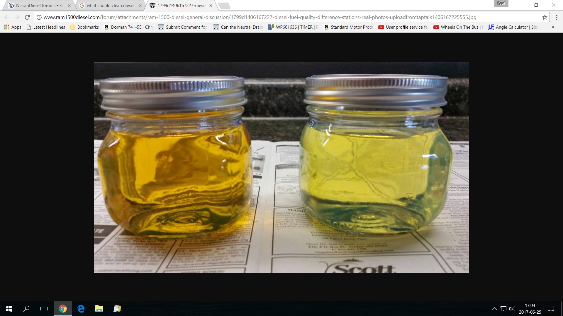

IMO that fuel looks cloudy to me and there is quite a bit of water in the container on the right
Good clean diesel fuel should look like either one of the containers listed in attached picture.
I would not use that fuel in any other engine. IMO that is. It appears to be contaminated with something.

- Posts: 590
That fuel sat for over a week and didn't separate any more than it did right away, the far right two containers had a foreign substance on the bottom, I suspect that is what came out as a funny color(mixed) for the first couple minutes when I drained the tank, after that it came out kind of a clear yellow, them are plastic containers the fuel is in.
I don't need to use that fuel, but I put all the clear fuel in the gas can and put the rest of the contaminated fuel in one container, that one is really ugly now, I will wait for it to settle to see if it separates.
I started over with 5 gallons of new fuel, and when it start losing power I filled it to the top in case the fuel pick up tube had holes in it, that made no difference, the warmer outside, the worse the power loss.

Did you actually wash out the tank or re-drain it ?
As the nasty stuff shown in the container on the right lives at the bottom of the tank and the pick up is close to the bottom of the tank there could still be some of that in there. I still think I would put a "Clean" jerry can with known "FRESH CLEAN" fuel on the floor of the passenger side, run 2 clear plastic lines out the window and take it for a toot and see. Put a clean inline filter on the inlet line if you like, but take everything of your existing fuel system out of the equation. If you still have an issue then move on to the pump and injectors.
In that jerry can of fuel ( should you decide to try it ) perhaps pour some stanadyne lubricity formula as well ( or performance formula)

To answer Don's question, yes, water can remain suspended in a bio diesel fuel blend, as that's what appears he has from the color of it. That may also account for the weird activity of your water in fuel light.
Here is a pretty good video on water in bio fuel blend and straight Diesel fuel.
https://www.youtube.com/watch?v=-lh4qhXc_5s
What you are showing in your bottles is pretty much spot on for water contaminated bio/blend diesel
