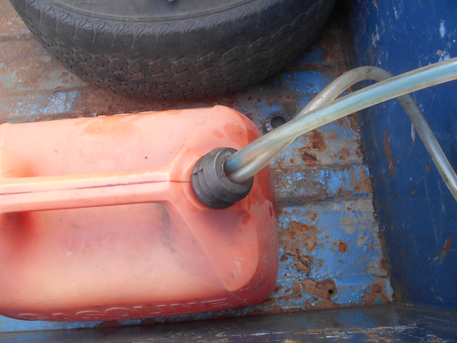

I just stopped by another fuel station and bought 5 gallons of diesel, I already put a clear hose from the hard line to the back of the box, maybe tomorrow I will figure out how to put the hose in the can and be able to drive it without spilling fuel, I will let it return to the main tank, as this is just a test to see if anything changes.
Put the pouring spout in the jerry can and run them through there. It should not spill. Only reason I suggested both clear lines is so you can see whats going on when its taking fuel in and sending it back.
Jerry can could be 1/2 full as long as the inlet line is submerged it will be fine. Use that little electric pump as a primer and once it's running then disconnect it and you can test the lift pump performance at the same time.

So I piped it for both hoses, I used a power brake booster boot to control fuel splash.
It still was losing power, just not as bad of power loss, but it is also only 70 degrees outside, I likely could have kept up 65mph on level ground, but no way on the hills.

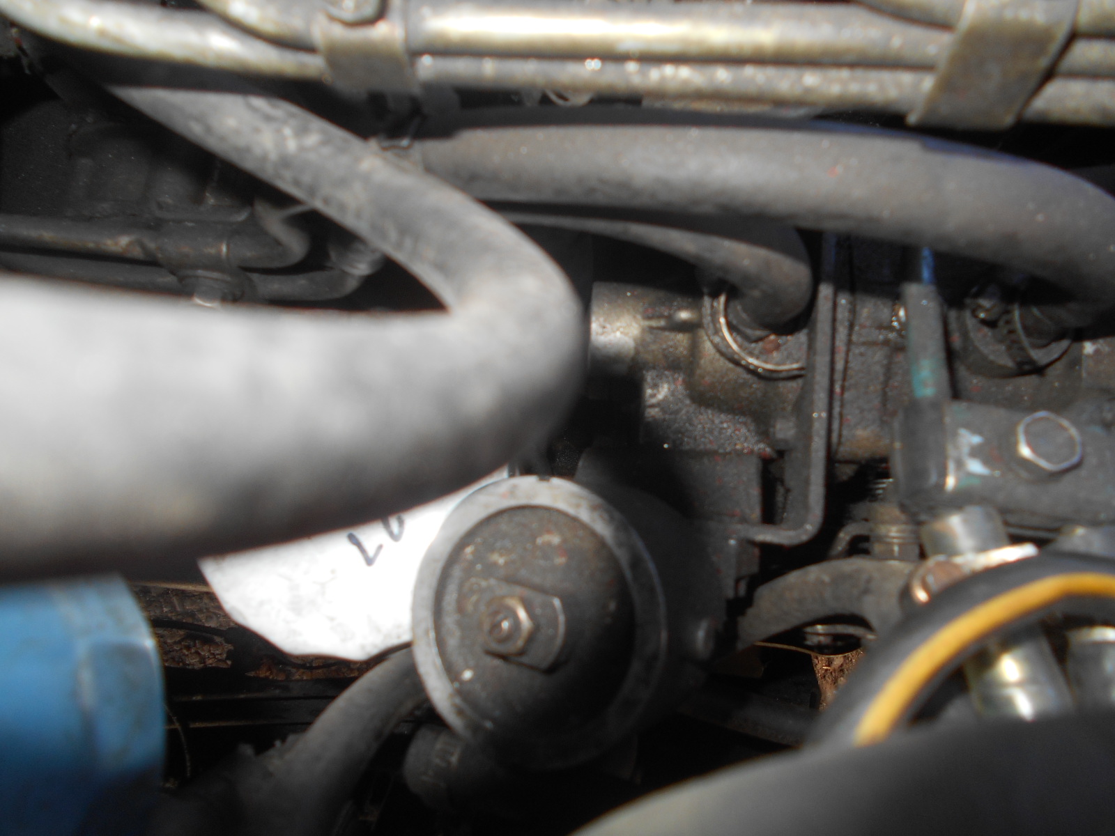

I am wondering if a bad diaphragm could cause this issue, to me I have always assumed that the diaphragm rest position is floored, the IP controller forces the diaphragm/shaft into the start and off positions, but in the run position it floats, vacuum from the venturi pulls the diaphragm to the idle position, when the butterfly is open it loses vacuum letting the spring move the diaphragm shaft moves to a richer position, now when under boost it makes the venturi think it has no vacuum therefore moving the diaphragm shaft to a very rich position, that is why I piped boost to the vent line, to keep the boost in the IP control line from being overwhelmed, basically deleting the boost factor and letting the venturi operate normally again.
Now in my mind if the diaphragm had a hole in it then it would run richer, but maybe I am missing something.

To get to the diaphragm I would have to pull a lot of stuff to be able to get to the screws holding the housing on including the new oil filter I just put on, so I am not going to do anything about it right now, I am hoping for a few days of lower than normal temps to see if I can drive it with the air leak plugged, if it runs good then I will know for sure it is heat related.

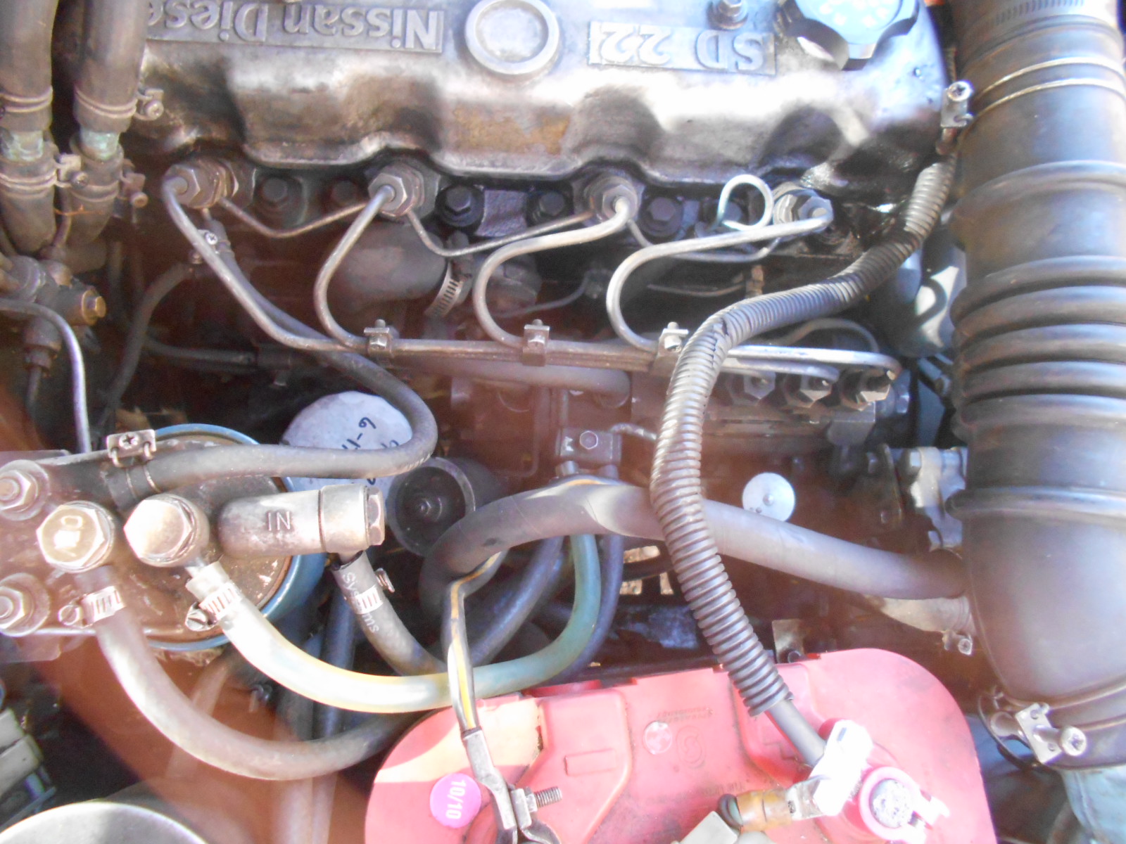

I don't have the equipment to do a compression test, and the fact is I don't really know how to do one, me and this guy over in Portland that is selling his diesel truck on craigslist did two engines one afternoon several years ago, I don't think we did them correctly then either as the numbers were all over the place, could not get the same number twice.
It starts so easily that I don't think it is a headgasket, it doesn't blow any white smoke at all, so this makes me believe that compression is not the issue.
If the diaphragm was easy to get to I would have already done that, but it is very hard to get into that area now.

Compression test is pretty easy to do. You can go through the glow plug hole.
Basically just take out the glow plugs, disable the fuel supply and crank it over with the throttle body plate wide open. I want to say the numbers should be around 350 - 400 psi but I'm guessing.
At one point Al had a tester and an adapter he made for SD engines so you could get in behind the fuel pump. He would loan it out for a deposit. Not sure he still has it. Somewhere on here are the exact numbers your looking for as well.

We used Al's compression tester kit the time we did it that afternoon a long time ago in North Portland, I am thinking the results are posted in a thread on this forum.
