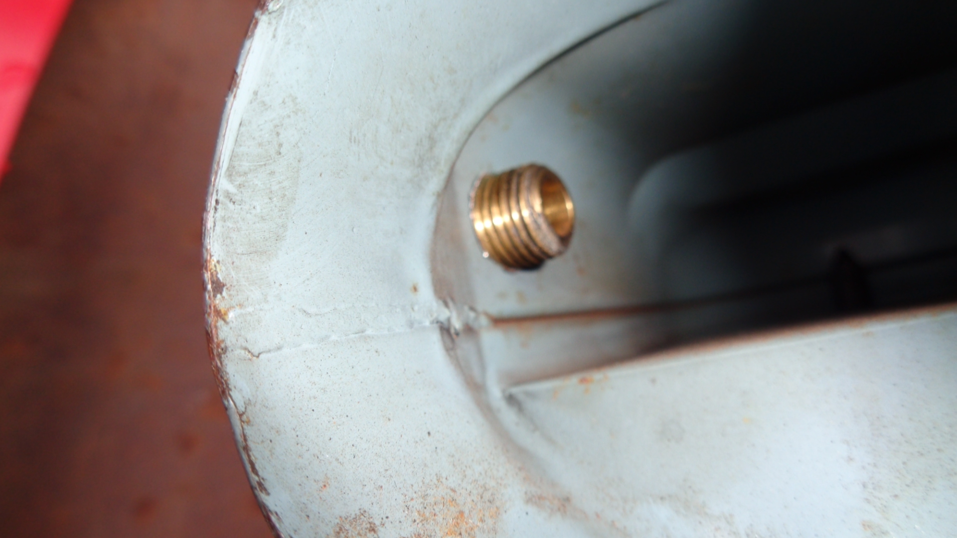

The way it is set up in the air filter is so simple it's scary, it's nothing more than a fitting end sticking inside the air filter neck.

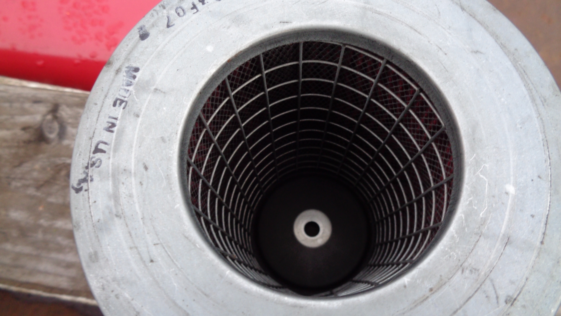

I removed the filter top to get the photo, when I took it out I cleaned the filter also, when I removed the filter from the top and looked inside the filter the screening inside had collapsed inward, sorry I forgot to take a photo of that, so what I did was I added a much stiffer screen inside to stop it from collapsing.
Now I suppose I could add fittings to the inside to pipe it to the middle, and then put a 90 degree elbow on the end with a short piece of tubing on it pointed towards the turbocharger which will create a draft to pull air out of the tube creating a venturi type effect, it would likely pull more propane out that way, but keep in mind that I am not using the turbo that Larry was using either, it takes longer to build boost and it does not create the boost numbers that the turbo produced that was on it when Larry made this setup.
