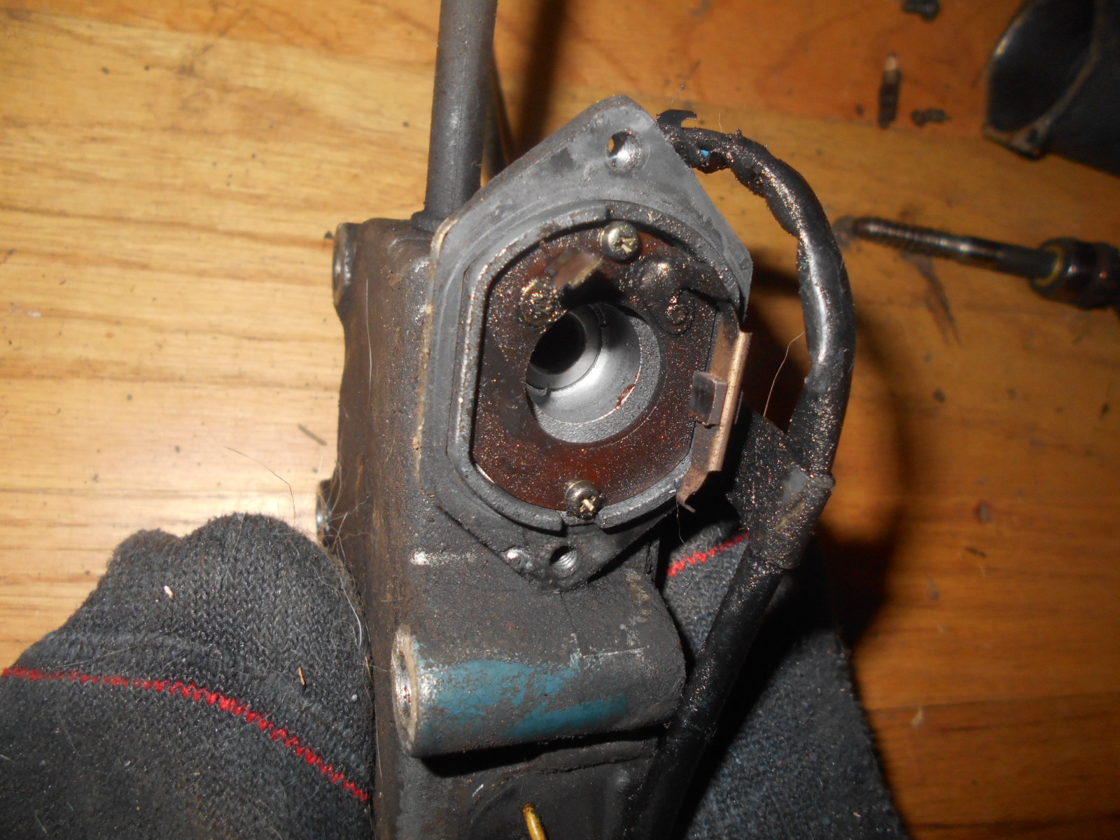

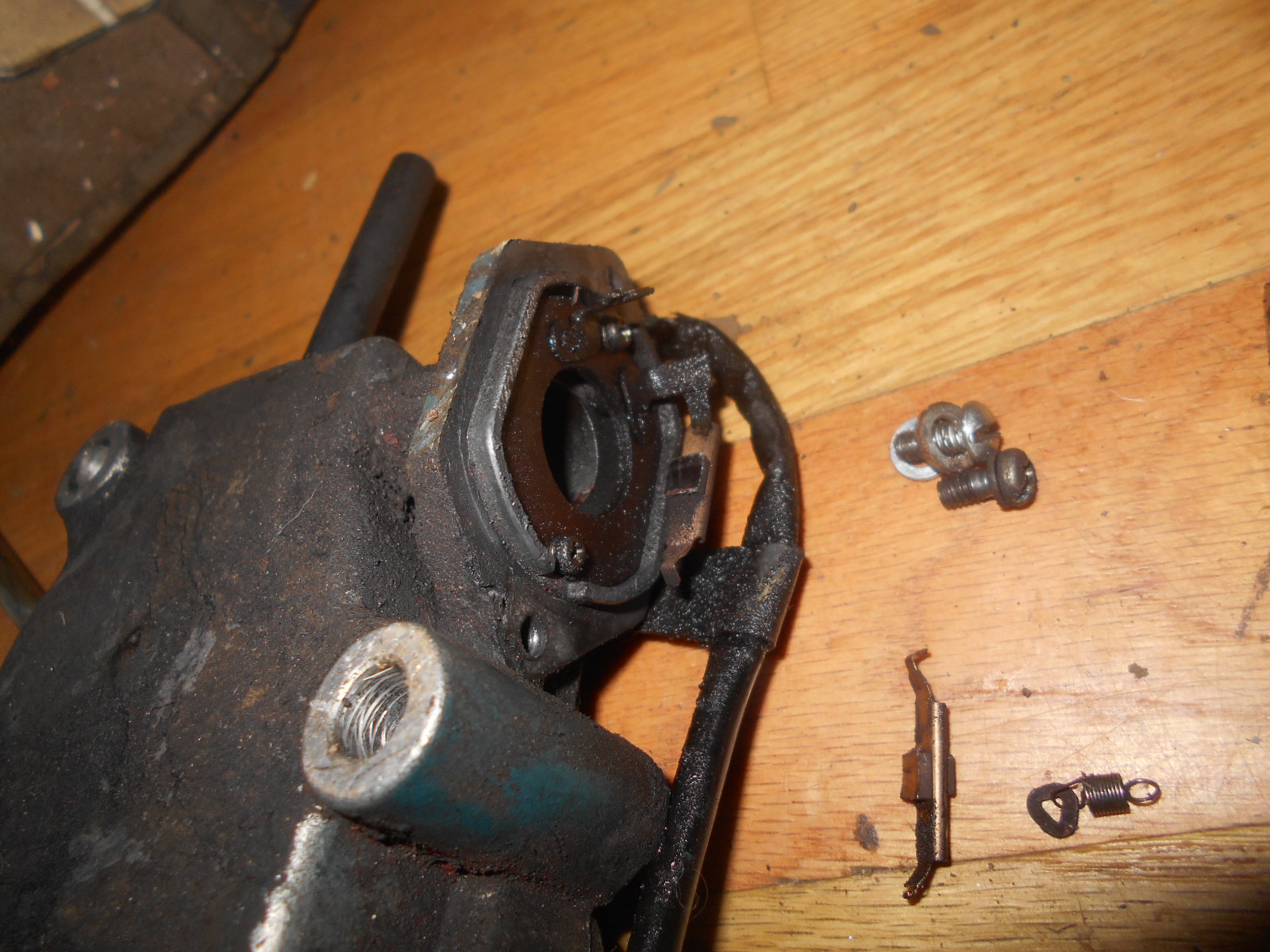

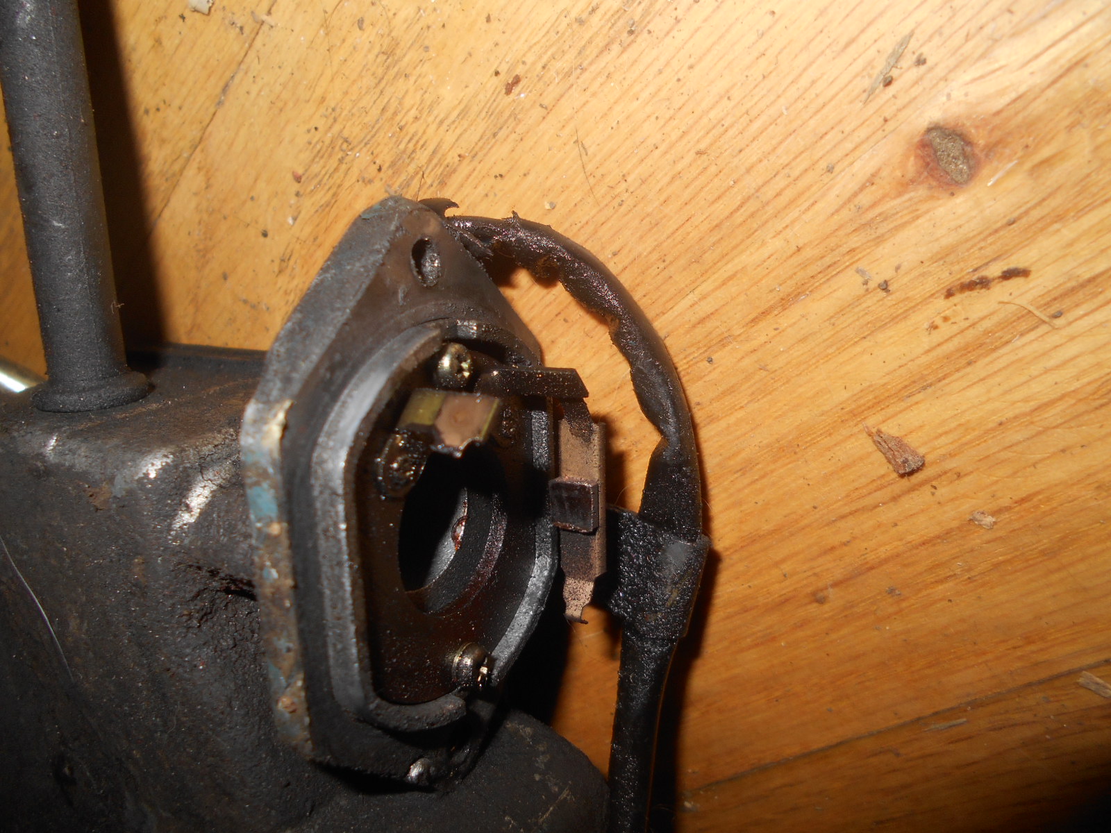

I changed out the IP controller today, when I got the old one out I found the cover was missing one screw and the other one was loose, I found a screw and tightened it up but could not get it to work.

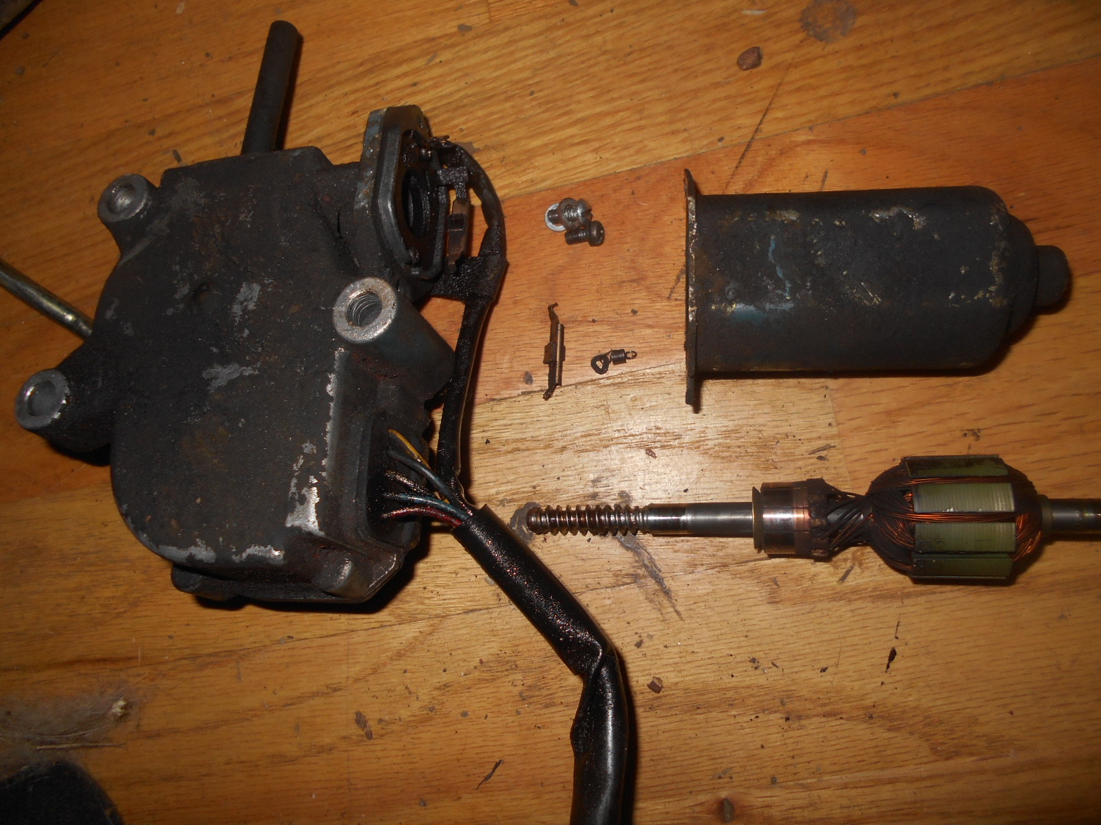

So I took it apart this evening and figured out why I didn't work, one of the brushes broke off and was in the motor stuck to the magnet, or at least it was stuck between the rotating assembly and the magnet.
I pulled the rotating assembly out and found the little spring that held the brushes against the commutator(had to look that one up), at least all the parts are there except for the one lost screw.
I don't think I can fix it myself, I just am not that good, can something like this actually be soldered back together?
I think I see what your talking about being soldered.
Conventional solder is not likely to work for any length is time, but perhaps silver solder might.
If Al sees this he may have an opinion.
Of course if you could find that brush it would be better, but that's unlikely.
If not take the good one off and take them both to someone that does jewelry repair. They use silver solder all the time. Using the good one as a reference they could silver solder the broken one back together.......maybe.
Brazing I think would require too much heat.
As stated. Al might know of a different method.
Edit: just zoomed in on photos and realize you would have to take that whole board the brushes are mounted on to jeweler, (or wherever) and they may be able to silver solder it back in place.
Maybe
Maybe
