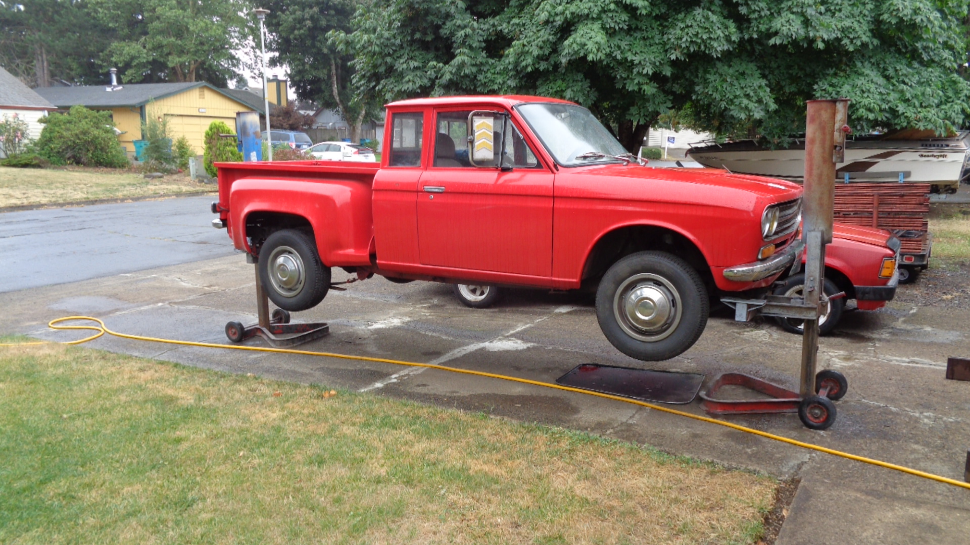

Here is how I work under my truck, I can even sit upright in some places.
It's really quite stable, if I need to install a transmission I get the transmission under there then lower the truck enough that I can deal with it laying on my back after getting it up there above the cross member with the transmission jack.

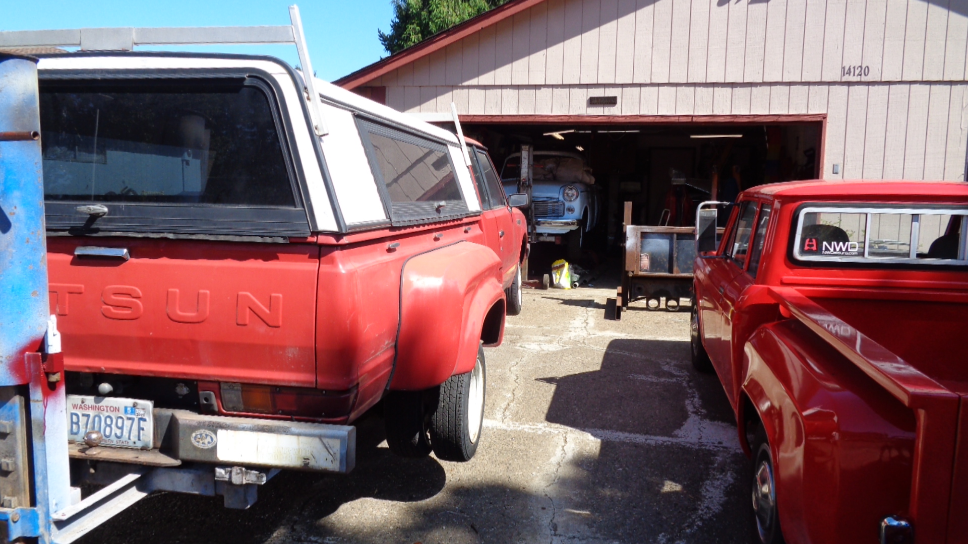

I do not know what made me think of using an air jack on each end, but once I figured it out I bought more air jacks and now I can have 2 vehicles in the air at one time.
See the truck in the garage.

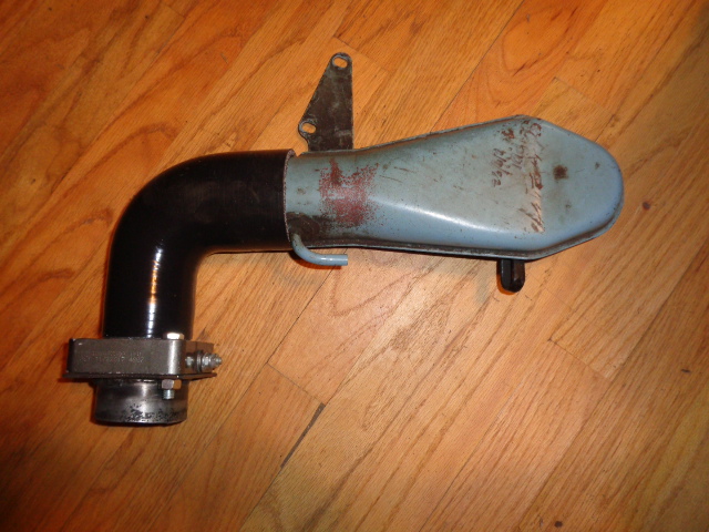

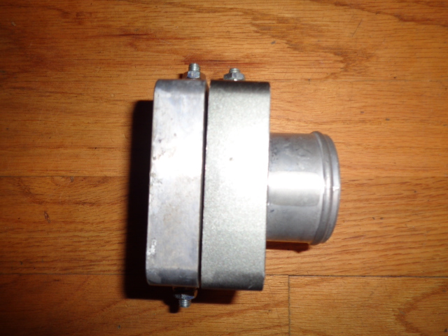

But you could make something like this in the photos below and put it in front of the SD22 metal cover that leads to the hose coming from the air filter housing, but with a straight piece of rubber tubing not the 90 degree bend I used as an example in the photos below.
I don't really know how well it would work that far away from the intake manifold as the air will cool as it makes its way into the intake and cylinders, but it likely is better than nothing.

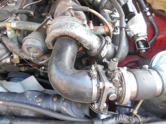

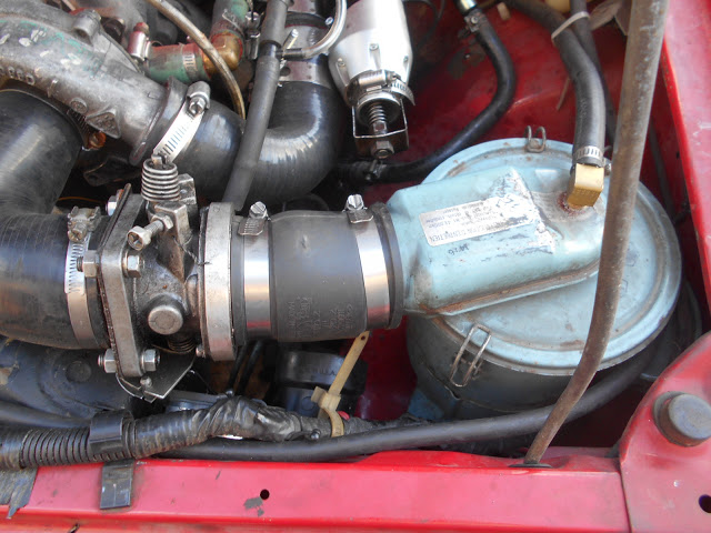

I don't know if you ever read how I setup my 1980 720 turbo diesel as a draw thru, it actually worked pretty good but I have been using a turbocharger that was not meant to be used on draw thru applications, it worked fine except for having the wrong type of turbocharger as when I let off the pedal it sucked oil thru the turbocharger seal and fed it into the engine, I could drive it because I knew how to drive it and what not to do, but no one else could drive it, but it is the reason I figured out how to pipe it as a blow thru, it drove fine with the throttle body in front of the turbo way over close to the stock 720 diesel housing, and it drove normal but was running lean, I could accelerate very fast to 60mph but then ran into a wall, it just didn't want to go past 64mph as it was not getting enough fuel, I went thru all that on this forum in my 1980 Datsun 720 diesel thread, how I figured out how to make it run richer is how I figured out how to make it a blow thru without issues, I suspect I could have got 40+mpg set up that way before I figured out how to make it run richer, but I cannot drive 50/55mph on the freeway, it drives me crazy when slow people are causing backups, I just want to go at least the speed limit, and 64mph don't cut it.
It did not drive weird set up this way above, when I gave it the pedal it went fast until 60mph, when I let off it slowed down, no delays either, but the air being sucked into the turbocharger made that venturi in the throttle body create vacuum even when floored so it ran lean, I figured out if I added a little boost to that vacuum line with a valve it ran richer and it went like crazy after that, and that is how I figured out how to pipe it as a blow thru, by adding boost to the injection pump vent line to make it run leaner.
