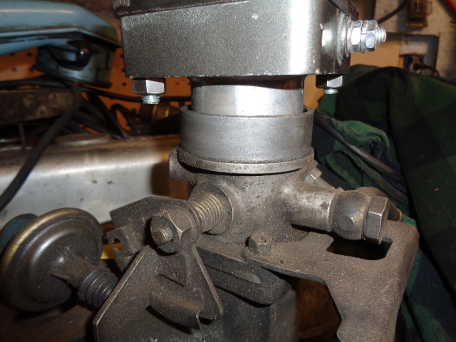

If I had the SD22 I would likely use the one with the cylindrical end, I dropped it into the neck of the throttle body and it is exactly the same size as the throat of the throttle body, so even though it looks smaller in the photos below it is not a bottle neck issue, I do not believe the heated air will be an issue for the throttle body or the rubber hose pieces connected to it/holding it on, as long as they are made for turbo applications or made to be in engine compartments where heat is an issue like radiator hoses, this is the way I would try it first if I had an SD22 in the photos below, if that didn't work I would then make an adapter for the intake manifold.

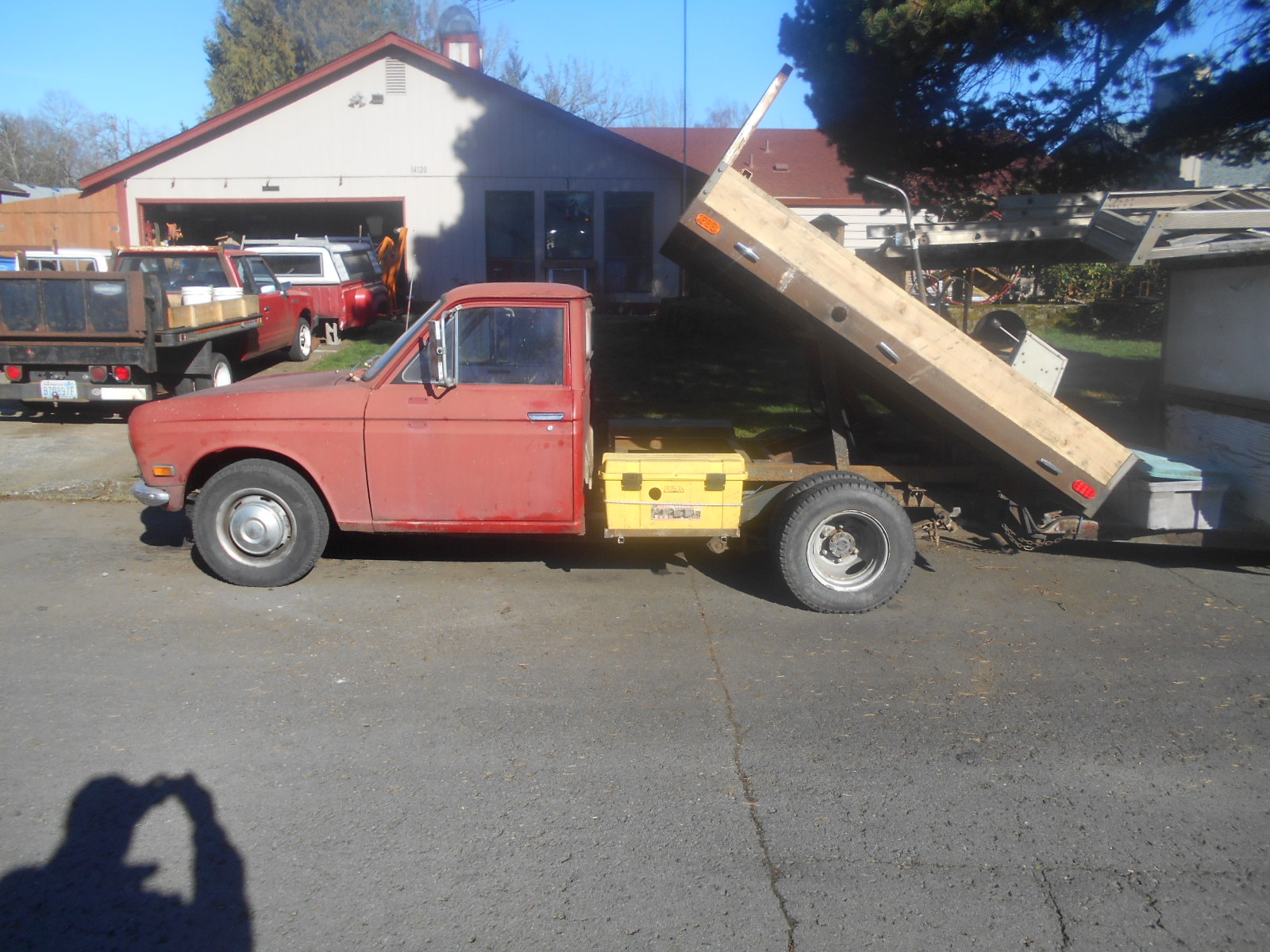

By the way, I meant to let you know where I'm at on the diesel conversion. I have the 1978 King cab (with the rusty floor) setting on the 1982 frame now, but I think already told you that several months ago. It is providing me with a good template to be able to use for measurements so that I can transfer them to the 1973 standard cab before I do any cutting on the 1973.
Like I figured, summer time really slowed me down and I didn't get very much done. I still have the 1973 mostly in one piece yet. Since I already had the SD-22 motor and transmission setting in the 1973 before you gave me the 1982 frame I left the 1973 mostly alone and am currently working on getting a radiator for it. I had to raise the cab an inch to get the transmission to set under it. I didn't want to do any cutting and welding on the transmission hump. Last week I had to lift it another inch to be able to put a complete 2000 Altima radiator, AC condenser, and electric fan in it. After I get that set under the hood hopefully I will be able to lower the cab back down some.
Currently the 1982 frame, and the 1978 King cab, is setting under a tarp outside. At least it has been mostly dry so far this winter as that has been very helpful to me. I've got the woodshed about ready for the frame, but I need to get some wood split and in the shed before putting the frame in there as it will make access for getting additional wood in difficult. We heat with wood and go through up to six cords each winter (old house and not well insulated).

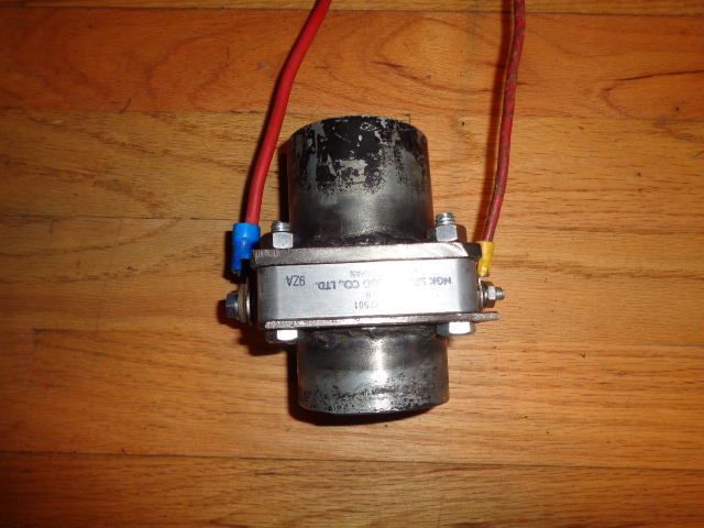

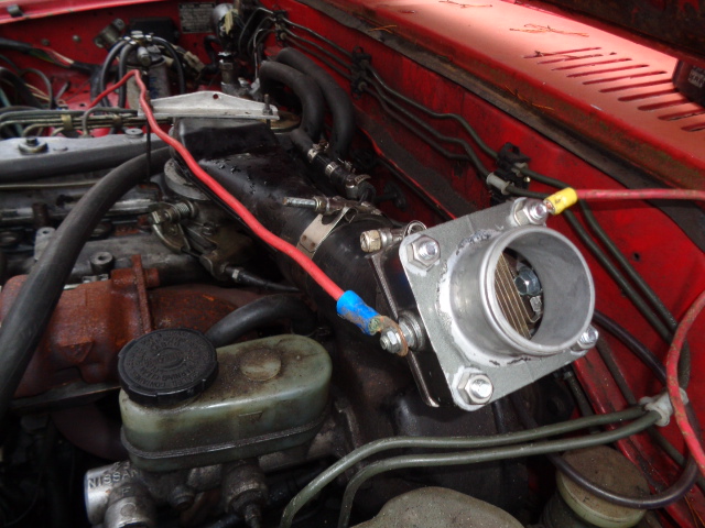

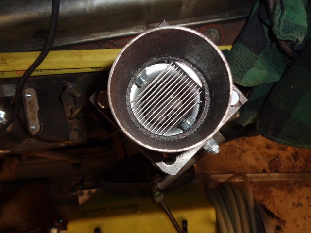

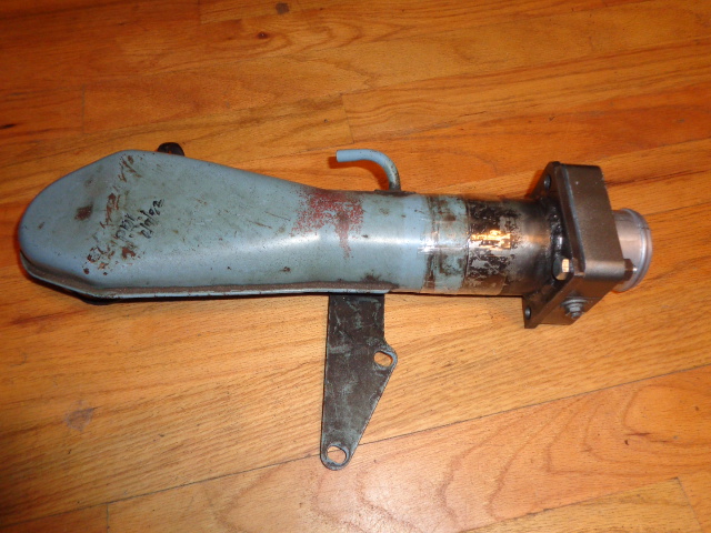

Personally I would buy the new short flat heater and make the ends from the proper size metal tubing like I did on the one end(black end fitted to the snorkel) in my last post, the radiator type fitting is only 2 inches across, I bought it first as it was the only one on ebay, well I figured out a better worded search and found that new one with no radiator type fitting and it was cheaper so I bought it also.
Like I said before, I put that radiator end of the heater into the top of the throttle body and looked down thru it, the inside of the holes are the same size so it is not a bottle neck, but if I use that one I will do the same thing Plenzen did and have the radiator end machined off to look like the new one I bought, if I had seen the new one in that first search I would not have bought the used one.
I suspect that it might work on the end of the snorkel but I don't know it will, if the pedal is floored when trying to start it hot/warm air will get thru, in the end I also suspect the closer to the cylinders the better.

I thought about that also when I mentioned using turbo tubing to put everything together, turbochargers get hot yet that tubing doesn't melt.
Fact it I would guess that in the summer everything gets hot in the engine compartment, I suspect hotter than the heater will make the snorkel, the heater will only be on a couple minutes, and the cool air entering from the air filter as it is very cold(the reason for the air heater element in the first place), that air will cool the sheet metal.

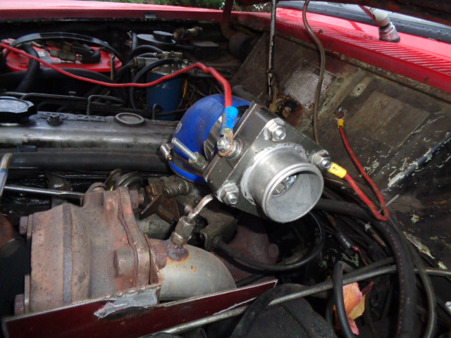

I decided to test the heater and start the truck at the same time, I decided to disconnect the turbo and pipe in the heater with the radiator type fitting on the one end, this is what I did in the photos below, I connected a ground wire and a power wire, the power wire went straight to the positive battery post, I only had the heater powered around 3 minutes total, it did not glow like the new one did. I cycled the glow plugs twice(took a couple minutes max), and then I started it, it didn't miss even once, it just ran, the snorkel didn't even get warm, neither did the turbo hose, but again it is 52 degrees outside, a true test on starting it will be when it is below 32 degrees which is not supposed to happen in the next week, last nights low was 45 degrees, I will try starting it again the next time it gets near freezing, next Saturday/Sunday are supposed to get down to 37 degrees for the low, I will try it then, it has always missed a couple times when I tried starting it when it was that cold.

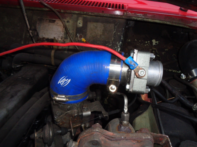

So I just had to see what would happen, I disconnected the turbo piping on the 521 and installed the heater on it, I connected the power, turned the key on, got out and looked at the heater and it was slightly orange, got back in and when the light went out I started it, it missed a couple times but was idling smoothly right away, but again it is 50 degrees out right now, the blue turbo 90 degree pipe didn't even get warm, the metal housing of the heater was only slightly warm, this made me curious, so I stuck my fingers near the inlet of the heater element while is was still powered/heating while it was running and all I could feel was cool air being sucked into the hole, the wires were not orange anymore either, I stuck my finger as close to the wires as I dared and could not feel any heat, just cool air being sucked in, I disconnected the power and sparks flew as it lost contact with the positive post, I do not think heat is going to be an issue.
Actually I am thinking about putting the new air heater element close to that spot right now if I can get it to clear the hood, all I have to do is put my ends I already have on it and wire in the relay, I will likely have to cycle the glow plugs twice to warm the heater up though as it needs a couple minutes to get it glowing orange.
Maybe find a means to keep it powered after initial startup to just help it smooth out. Kind of like a slow glow system. Not sure how you would do that. Maybe put it in switch ( with a relay) and a light and after 2or3 minutes shut it off.

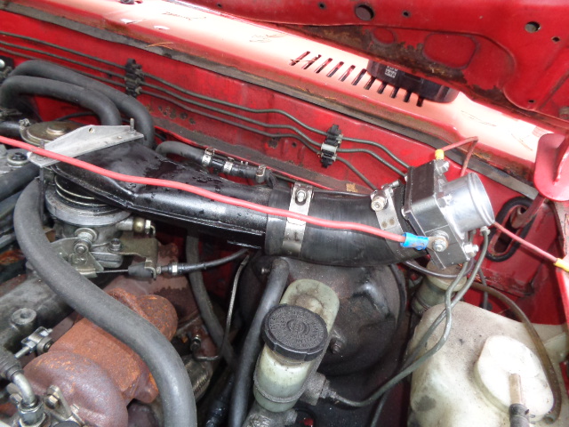

I started the 720 engine this morning when it was 34 degrees outside, the neighbors roof was still frozen(white), I cycled the glow plugs twice and the heater was on around 3 minutes, everything was set up like I had it before in post 217, it started right away, but it missed a few times before smoothing out and it idled fine, but I have that stock idle adjustment choke type cable the Datsun diesel trucks had stock, it was idled up to around 1200rpms when I started it, and it started on the first try like if it was 50+ degrees out, I need to plumb everything on this 521 truck the night before it goes into the 20s so I can just go outside and start it without fiddling with stuff, that will be the only way I know this heater will work piped this way for sure, as i know it will not want to start at all in the 20s, as I have tried in the past and gave up, I had to plug the block heater in and wait for an hour before it would start.
