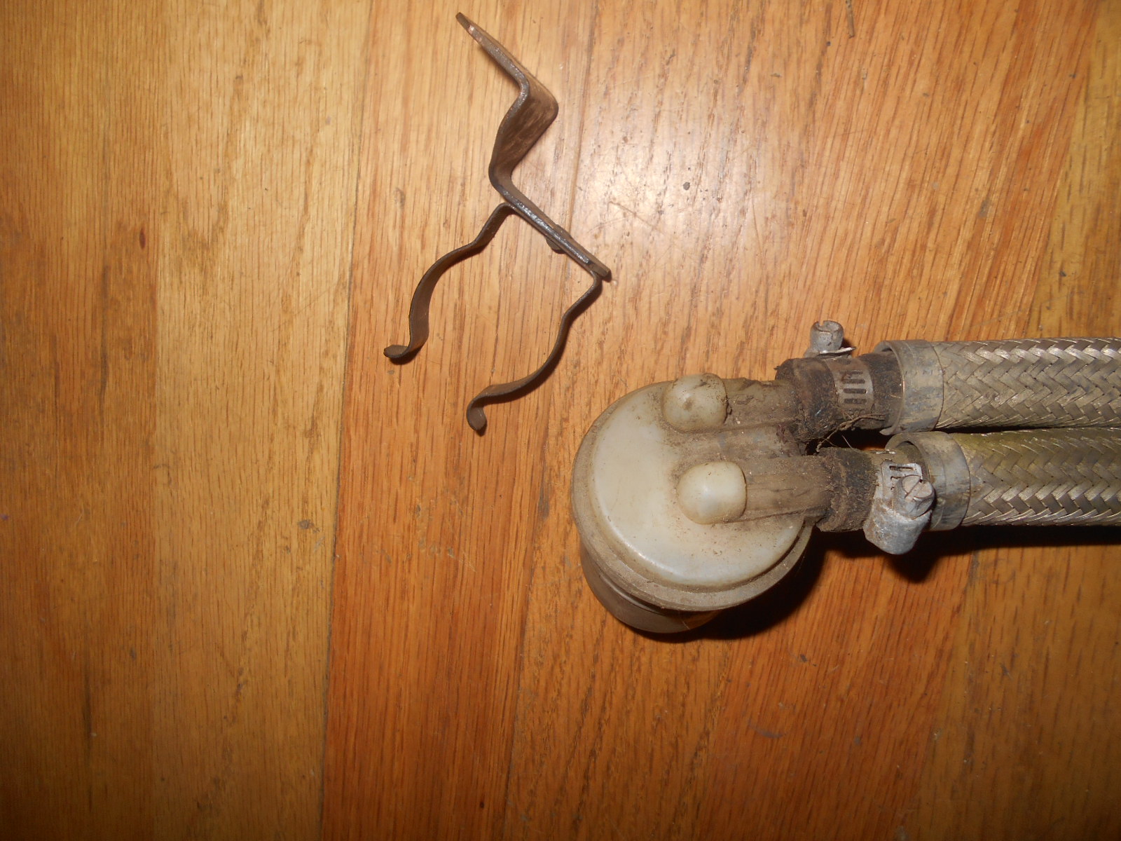

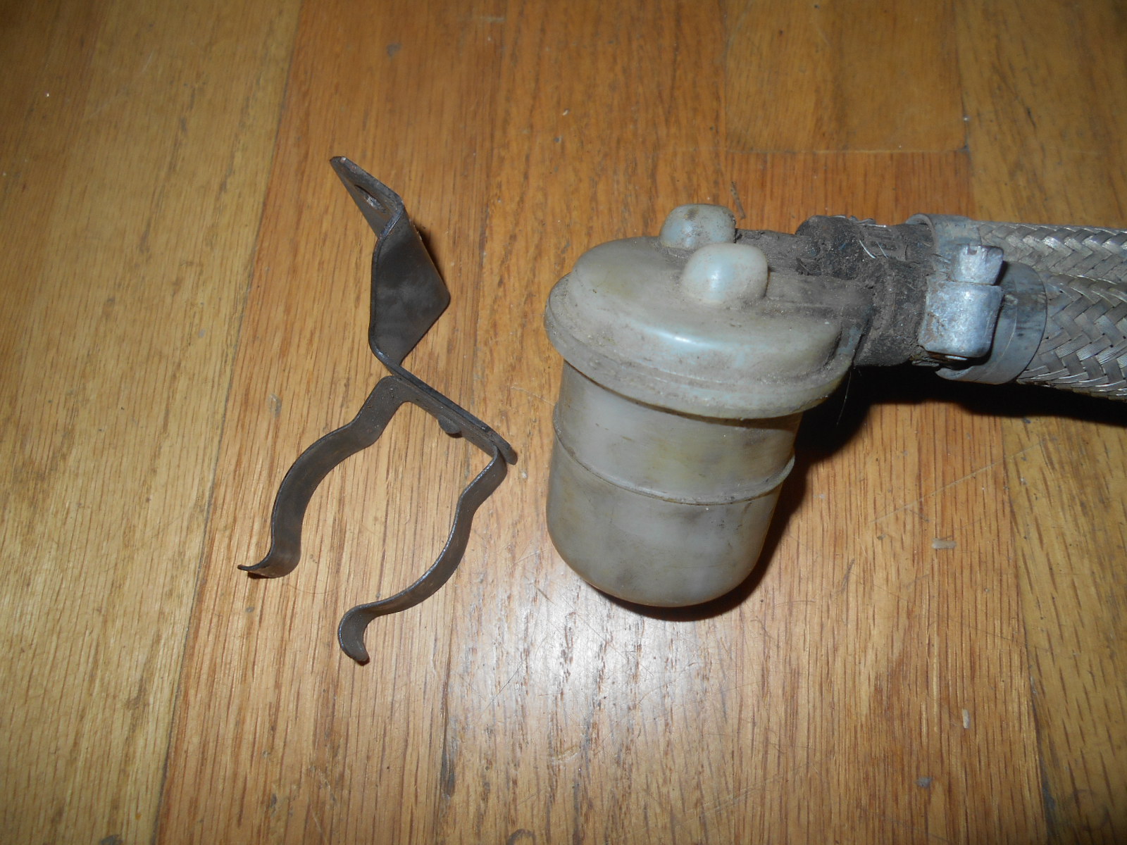

I made it back, barely, it started missing around 10 miles from home on the return trip, now I had just changed the pre-filter a while back on one of the first turbo test drives, so I started thinking it might be the main fuel filter this time as when I let off the pedal it could kinda catch up and run good if I was light on the pedal, well i did make it home but I did have to let it run just above idle in a parking lot a few minutes a couple miles from home.
Well I pulled in the driveway and before shutting it down I popped the hood looking for fuel leaks, I looked down at the pre-filter and the element inside was almost sucked flat, I shut it down and before I could get back to look at it again it had expanded half way back to normal size, a couple minutes later it was almost normal looking, that filter didn't last long, maybe 3 tanks of fuel.

I am using them cheap see thru fuel filters as pre-filters, the stock 720 diesel engines in 1982 also used the semi-clear filters on the firewall in a clip, what should I really be using, I do like the clear ones as I know right away if my fuel issue is that, I would not have that info if I used a metal cased fuel filter, as I could not see the element inside.

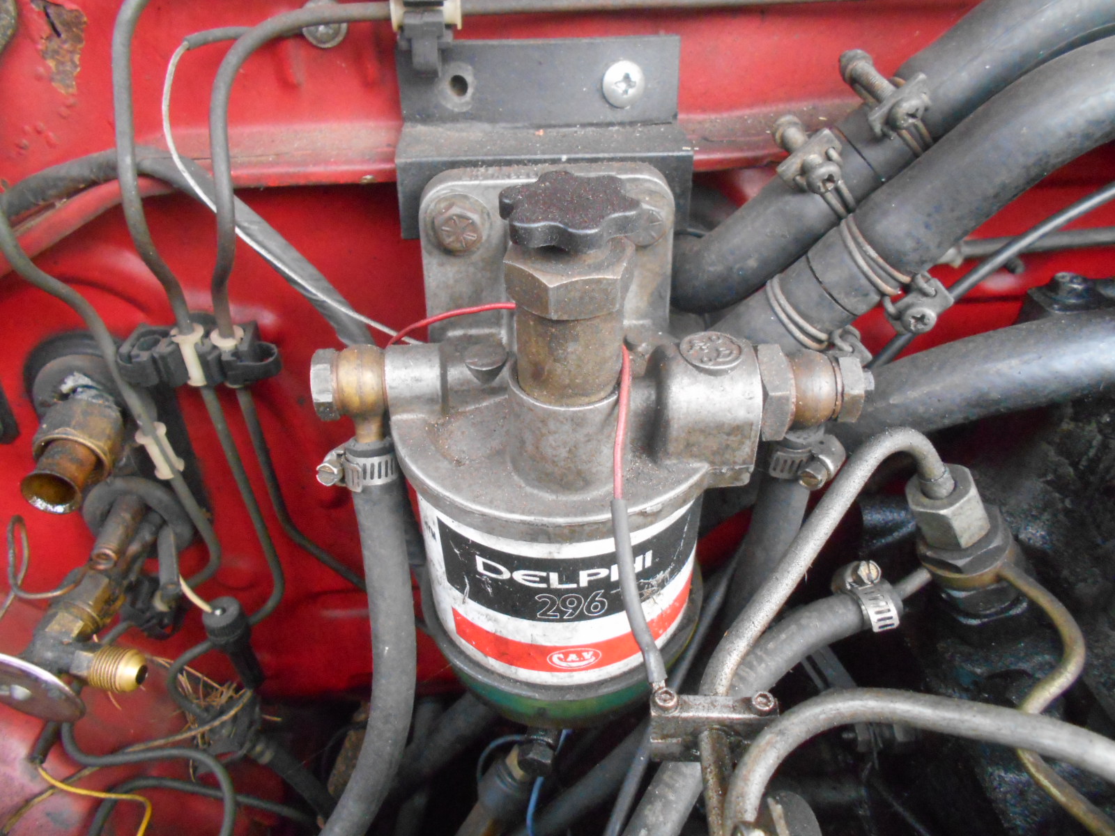

The 720 has a huge delphi 296 fuel filter/assembly with a primer on it like the one on the injection pump, where would I find one of them?

I have no experience with the Delphi 296 fuel filter that you have, so I am of no help there.

Yes it is a gasser style filter with the paper element, I was thinking about that last night, the 1982 pre-filter is what I need to pipe into the system, it would be a lot easier to change also when put in the stock position, right now my pre-filter is down by the side if the injection pump and is real hard to get to.

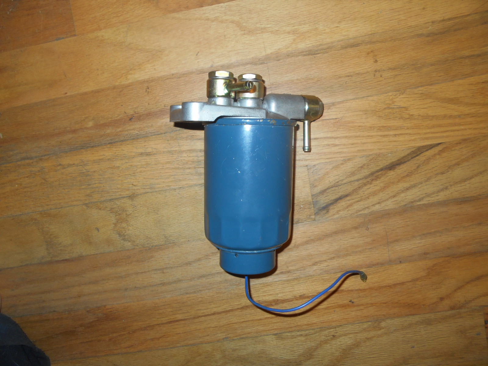

WIX 33792 is not a pre-filter, it is actually a cartridge fuel filter, I am looking for a pre-filter like the one in the photo below, does anyone have a part number for this pre-filter as I was at the auto parts store today and they are clueless and I brought that filter in the photo with me.
#54
I found my own answer, I need WIX 33214 fuel filter(pre-filter), it was just about the first filter I found on ebay for a 1982 Datsun 720 truck, I should have searched ebay before going to the parts store, so now I will take what they sold me back and I likely will find what I wanted on there store shelves in the filter section.

That filter and mount that you show in the pic looks the same as what was in the 1973 pickup. I looked for a while to find out what kind of filtration media it has, and finally found the information on a Wix website. Wix lists the 33214 as having a cellulose filtration media. It will be interesting to see how that works out for you. I did find a crossover chart that lists NAPA 3214 and Hastings GF157, and many others, that are supposedly the same as the Wix 33214. It sure would be great to have a filter that will fit the stock 1973 filter clamp/location.
I looked up the Wix 33792 filter, and it is not what I thought it would be, definitely a drop in cartridge filter. I did some more looking and the Wix 33972 is what I should have listed. I transposed the 9 and 7, so definitely my bad.

It's just a pre-filter to filter the fuel before it goes thru the fuel pump, my 1982 Datsun 720 diesel had it and it looked stock, I also seen the same filter on other 720 diesel trucks, I pulled this filter/hoses from yet another diesel frame I have in the back yard.

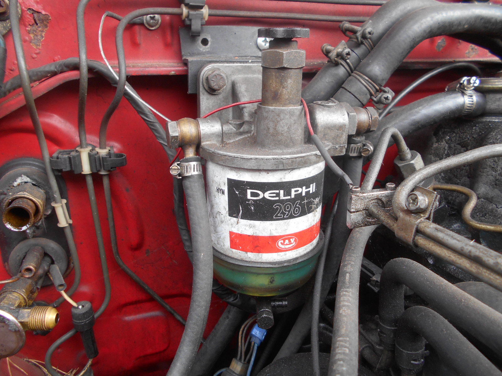

The main fuel filter is just after the fuel pump, it then goes from the main fuel filter(photo below) to the injection pump.

I looked at the engine compartment this evening and came to the conclusion that there is no room for the fuel filter clip on the firewall, I really do want to put it in approximately the same location it is in the 720s, but it appears I am going to have to move something, you can see in the attached photo the only space on the firewall has the clutch thing with the bleed screw on it and the brake switch/junction and lines.

That picture you posted of the blue Nissan assembly is not a filter but a water separator. I have a brand new on in the box. It's made to allow water to collect in it and there is a float inside that will rise with the water level and turn a light on in the dashboard. That's what the wire is at the bottom.

I'm a dumb ass. That picture you showed of the Nissan filter is different than the one I have in the box. I just went and looked at it.
insert red face here . :oops: :oops: :oops:
