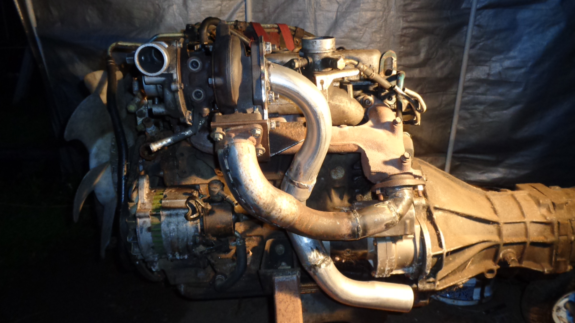

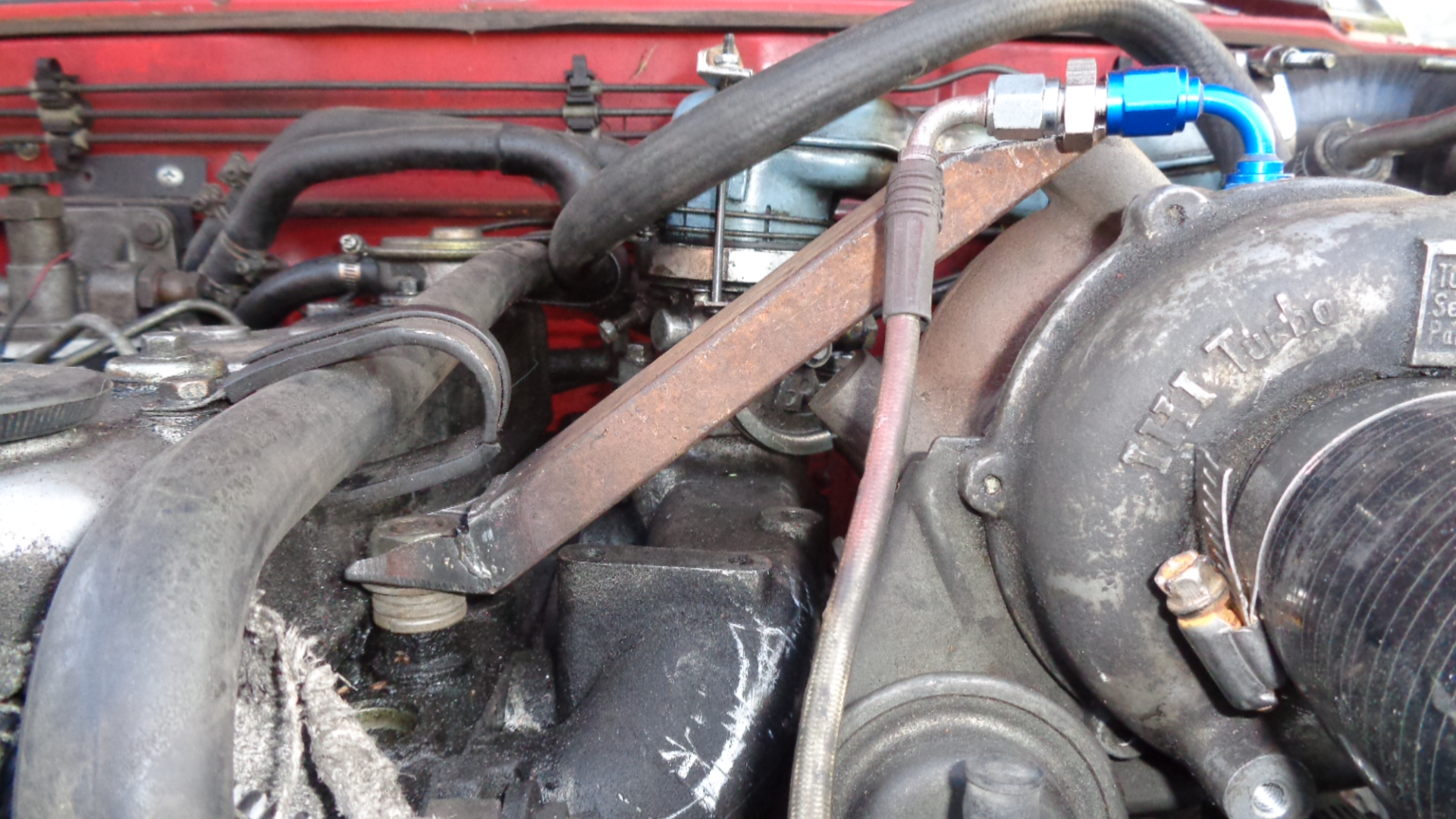

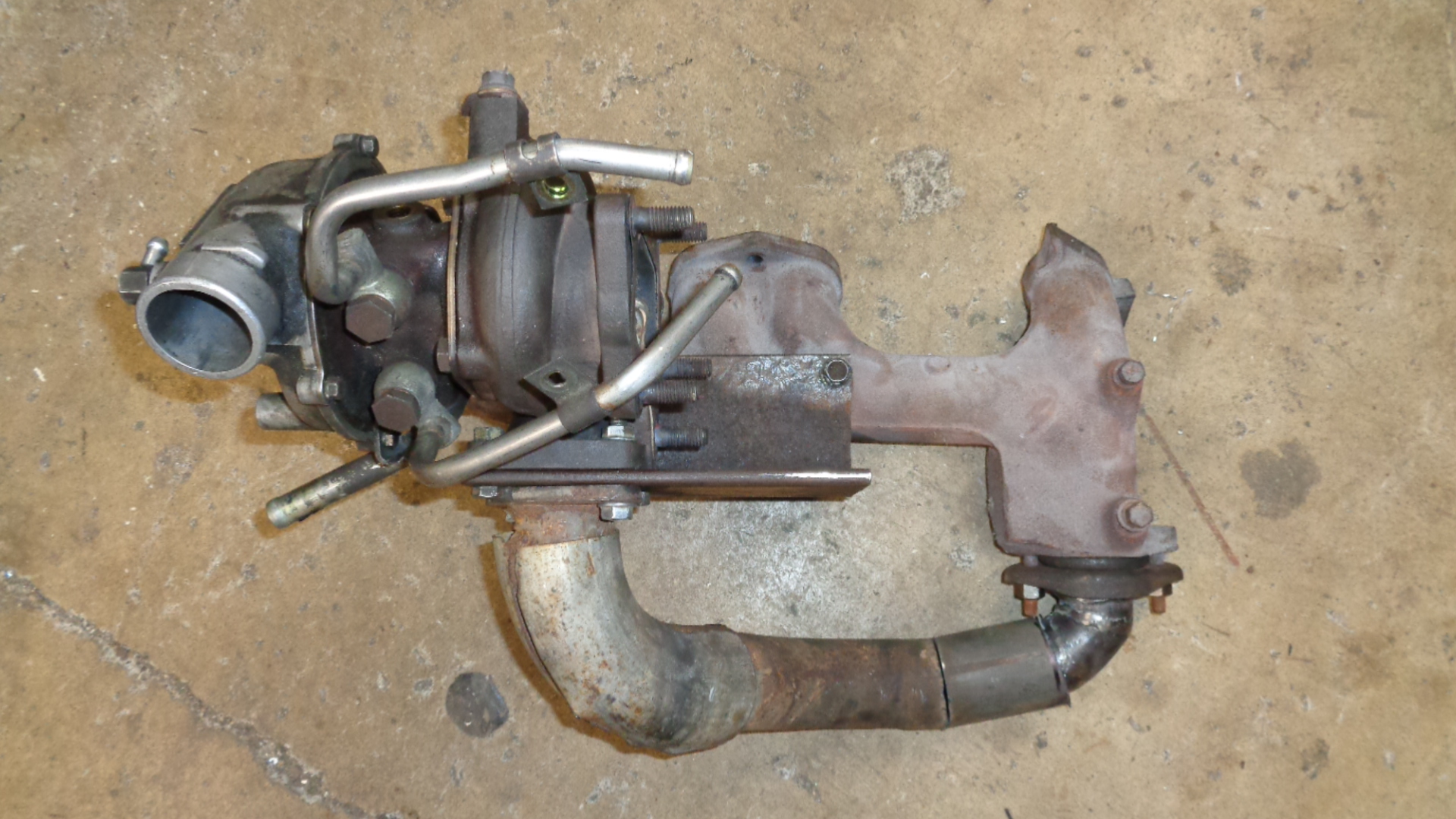

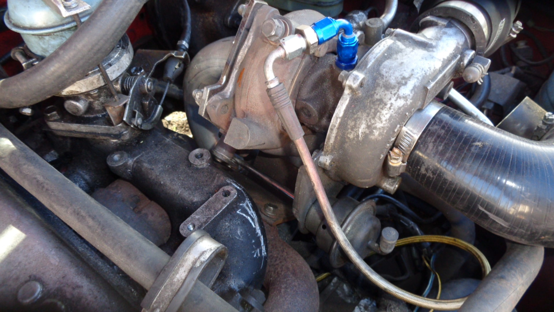

The diesel mounts are an inch or two farther forward than the other engines put in the 720, an adapter plate will likely work, but I have never went that way myself, I always use the 720 diesel kingcab frames and wiring harnesses in my builds.
The total movement of the rack is nine sixteenths of an inch which includes the fuel cutoff position and the engine start position, that doesn't leave a lot of movement to control the engine RPMs, and a very small amount of movement is all that is needed to make a big difference as far as the rack is concerned, the way I look at it is that the engine is controlled more by the amount of air it gets rather than how much fuel it gets with this basic inline injection pump.
There is a guy in Australia that modified his inline injection pump to a mechanical throttle, he basically said that either it was floored or it wasn't, he raced/drifted his engine so it didn't matter, but in the end he converted over to a VE type injection pump.
I actually tried to do what he did to his inline injection pump, but it didn't really work all that well, and I could not figure out how to make it work off the key(off/on using key), so I gave up.
I also tried an inline type injection pump for a stationary engine or marine application, but I could not get it to run properly, so I gave up.
The way it was with the throttle body in between the intake and turbo, it ran alright but was always running way to hot(EGTs), I could not even go 70mph without the EGTs going over 1400 degrees, in my opinion the reason it ran so hot was that the rack was always floored, and it really didn't any more power than a stock SD25 engine without a turbocharger, but it did get up to hiway speed a little faster, now the guy on here with the turbocharged engine(the bomb) figured out how to do it the way above(throttle body in the stock position) by adding boost to the injection pump vent vacuum hose using a valve, he said it worked, but I didn't really have the option to ask him any questions about this.
My only issue is the vacuum issue I have posted about, I have way more power than my other lighter SD25 powered Datsun 521 kingcab, and this 720 weighs a lot more than a stock 720 as it has been lengthened to except a longbox on a kingcab frame, and it has adapters and dually wheels on the rear, I believe it will go faster and get better mileage, but in the end I drive both of them by the EGTs which do get high if I have my foot deep into the pedal, it just takes longer for the non-turbo engine to get there.
I hope you can figure out how to control the IP rack the way your thinking, but I think it will take a very sensitive master as the rack movement is going to be less than three eights of an inch total, as I mentioned, I believe that these engines are controlled more by how much air they get than how much fuel they get, and all that boost did was make the IP think it was floored all the time in the stock position, but engine rpm was still controlled by how much air it would get.
I was having a lean fuel situation at first, but once I found out how "the bomb" turbo guy did it, I added boost to the vacuum injection pump rack line, what that did was at an idle there is vacuum in that line to pull the rack to the idle position, but when I give it pedal and get boost, it helps the rack move to a richer position, the more boost the richer it gets.
But again I have the vacuum issue when I let off the pedal, I have not been able to completely fix this issue, and I know it is an issue, as when ever I take the system apart, or when the intake tubes blow apart from so much boost, oil gets sprayed every where in the engine compartment on that side.
Right now I would just get the engine in the truck and get it moving down the road without a turbo, you may be happy with it the way it is, not a lot of power, but they get good mileage if the drive train is set up right, you need a 1980+ 5 speed transmission, and a 390/370 gear ratio in the rear, I have SD25 engines, I run 330 gears in the 720 turbodiesel, and 350 gears in the 521 kingcab diesel without the turbo, I have the torque to turn them kind of gears.

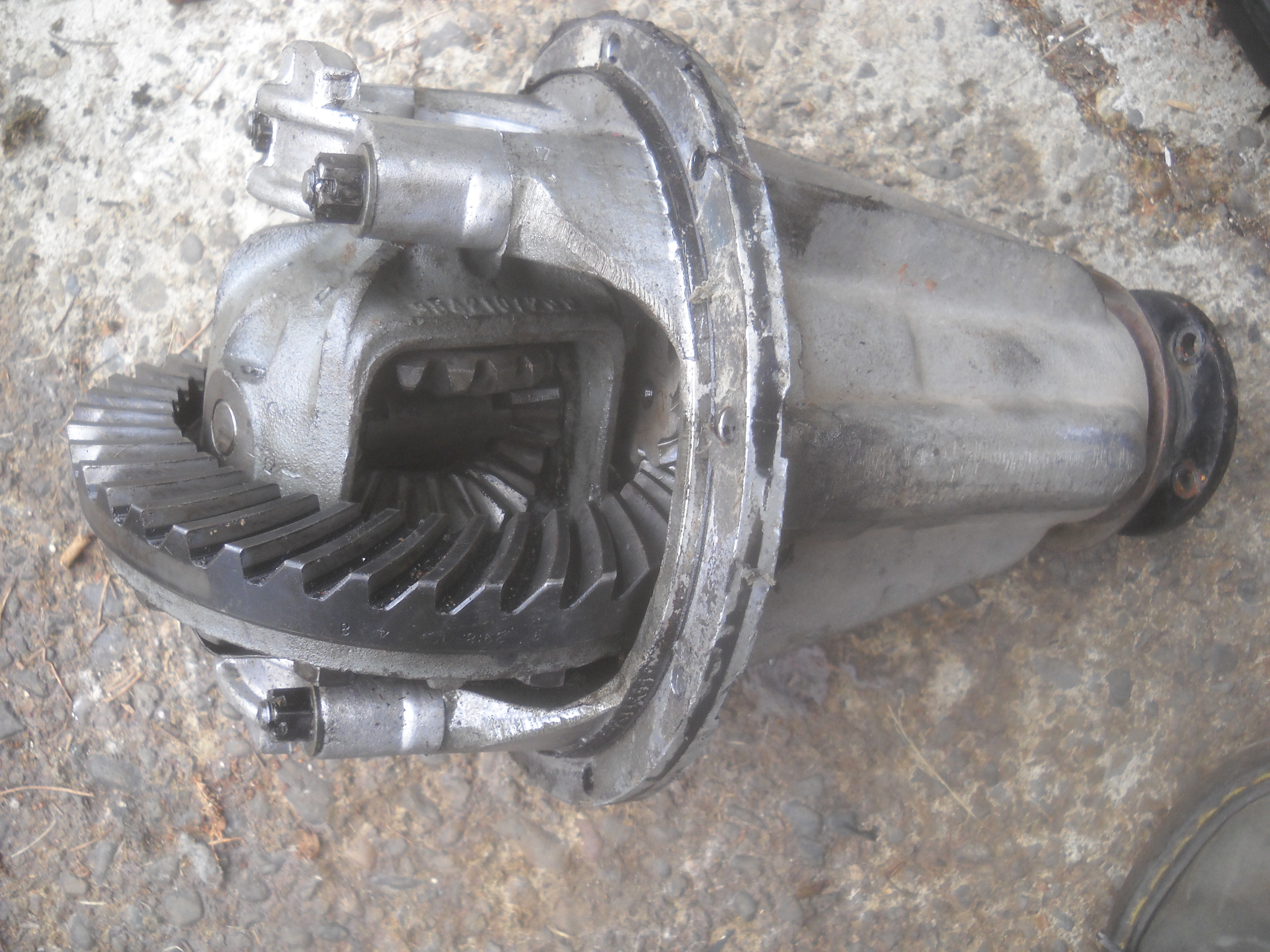

I haven't looked at the rear end yet. So the rear end gears are in a carrier, like the Toyota Landcruiser/pickup? That does make things a lot easier. All I need then is to find a carrier that has the correct gearing.

Below is a photo of a Nissan drop out pumpkin.

handcannon wrote:I haven't looked at the rear end yet. So the rear end gears are in a carrier, like the Toyota Landcruiser/pickup? That does make things a lot easier. All I need then is to find a carrier that has the correct gearing.

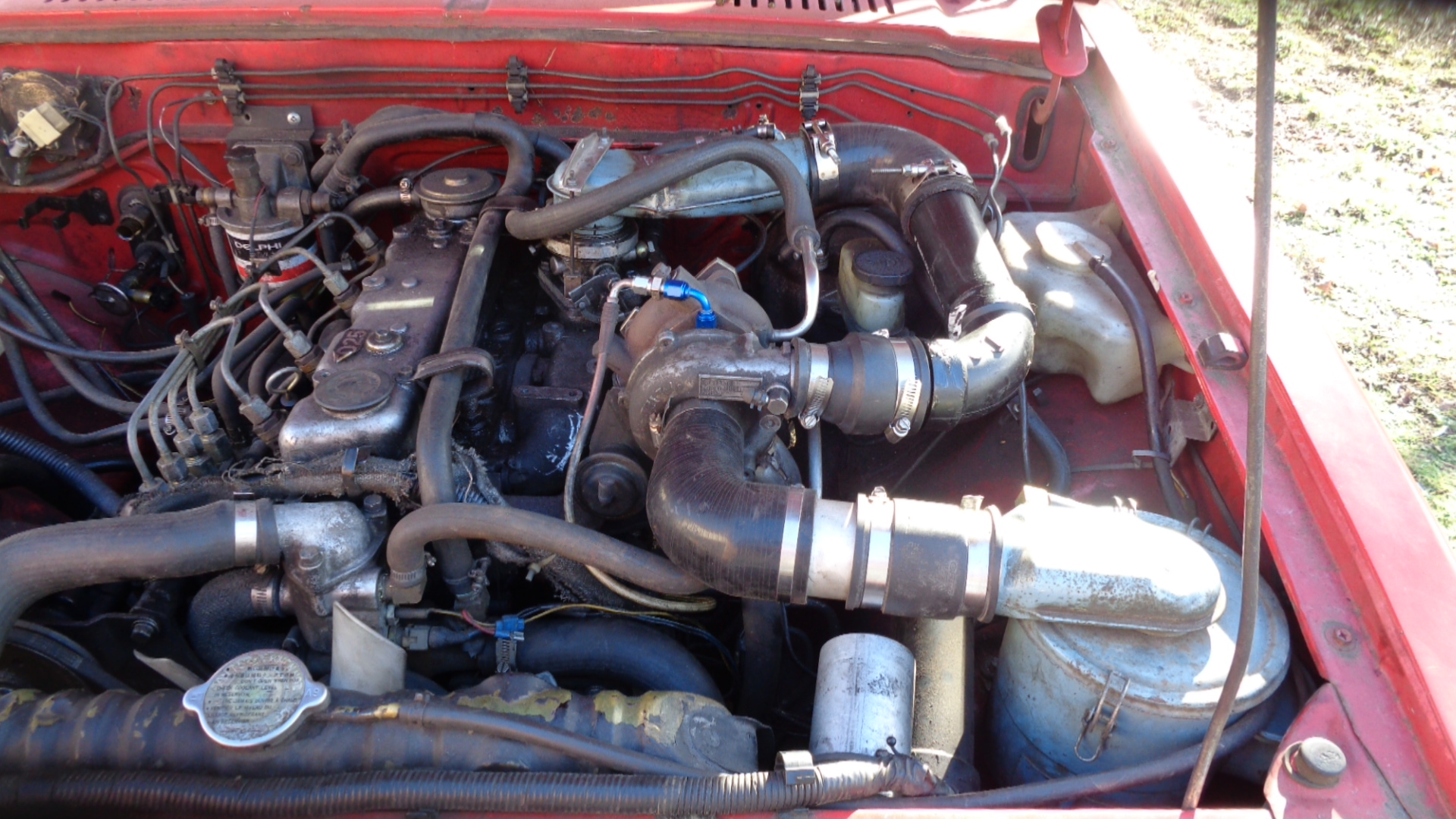

Ok, so as many of you know I figured out how to turbocharge my 521 that has an inline pump and it runs great as a blow thru, this truck I tried and tried and I could not get it to run properly the way that Larry had it set up as a blow thru, I tried a different type of pump at one point, in the end I made it into a draw thru and fought it till I got it to run decently, but I never felt it was good for a long trip with the vacuum pulling oil thru the seal issue, but I did finally get the power I was looking for.
Well yesterday I looked at this truck and thought I didn't need the lower turbo manifold to see if I could get this truck figured out, so this morning after breakfast I went to work on this one, and it actually didn't take that long.
It is now a blow thru, I didn't need to even use a valve anywhere on it this time as it has an adjustable waste gate, so I put the throttle body back in the stock position, piped everything like the 521 and started it, adjusted the idle a couple times till I had it below 900rpms and I took it for a test drive.
The EGTs run a little warmer than the 521(couple hundred) and I did seen slightly over a 1000 degrees, but otherwise it ran as expected, actually better than expected, Larry had the pump turned up so it is getting more fuel all the way around, I said this before, this engine has grunt/torque, it puts me firmly in the seat when accelerating, it's a good thing I put all the tools I was using in the truck before I left as I needed them, I seen 20psi boost more than once on the hiway when I put my foot in it, the second time it blew the intake piping apart at one of the connections, so I pulled over and put it all back together, I then adjusted the waste gate to 15psi and continued on.
This truck has way more power at lower RPMs and it will kick the 521s ass everywhere except maybe at fast hiway speeds, when I try to drive 75/80mph in this 720 I keep maxing out the boost at 15psi and I really don't like it, at the same speed the 521 is at 5/6psi boost and it will go faster which I am comfortable with, but 15psi plus boost just cruising down the freeway on level ground bugs me, it likely has something to do with the intake vane being larger.
Now I like having the 15psi boost when getting on the freeway, but it's not there all the time when accelerating, I let off and shift gears and such.
In the end/big picture, it was a complete success, it acted like the 521 and didn't have super hot EGTs, I am happy with the results, it did exactly what I was hoping for, it drove normally like the 521 and doesn't have vacuum issues anymore, so this is a repeatable setup and it doesn't need control valves to adjust to get it to run properly except for the waste gate which would have to be tinkered with on any turbo conversion.
My 720 is so much heavier than the 521, yet this 720 will leave my 521 behind off the line, but on the freeway is yet to be determined, turning that pump up does make a difference, although I don't know exactly how it was done other than a diesel injection shop did the modification.
I could hardly believe I seen 20psi boost, I thought I had it adjusted lower than that, as a matter of fact I am sure I had it adjusted lower than that, everything I do to this engine lately makes it run better and better.

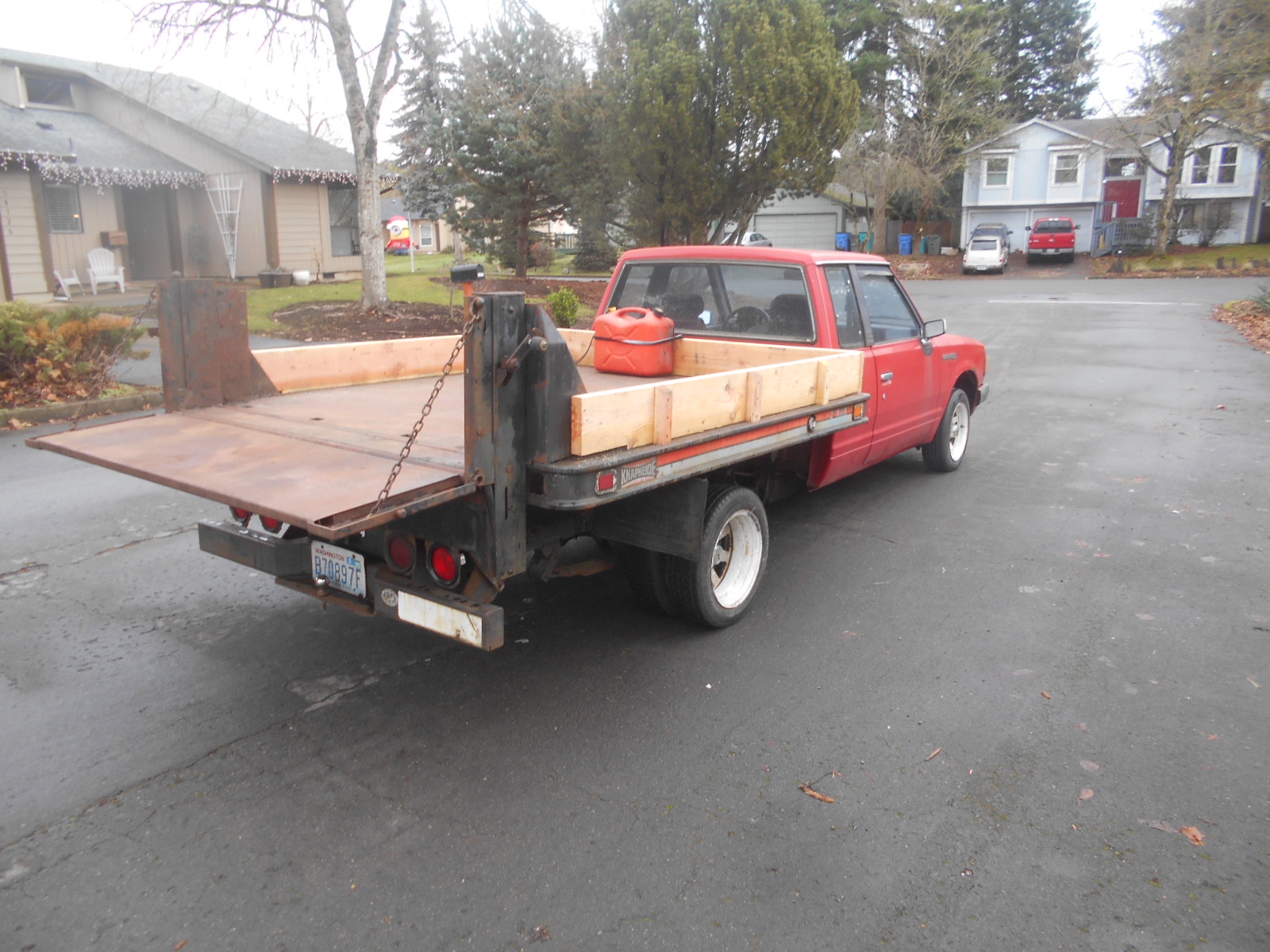

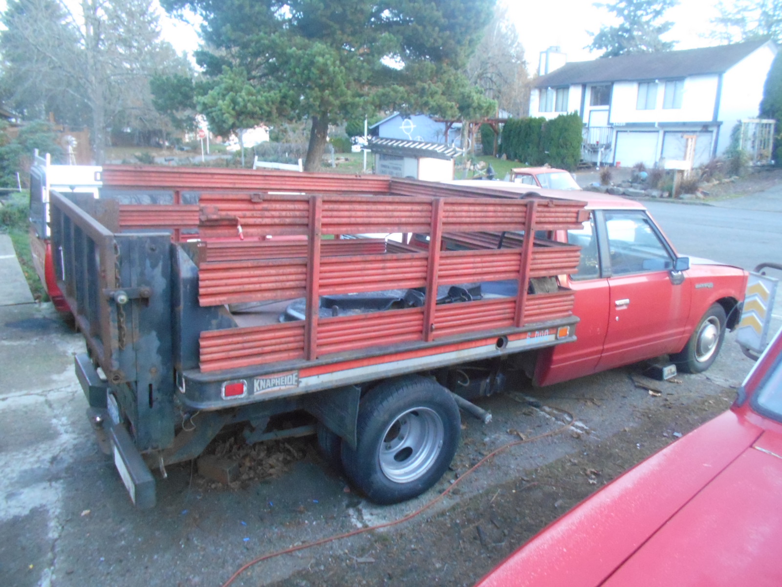

Well I am turning this into my work truck for a while, as soon as I deem it reliable I will be doing a major conversion on my 521 work truck which has a gas hybrid engine.
I pulled the dually box off and put a Knapheide flatbed on it, I have all the lights/marker lights working on the flatbed that count, they are LED lights, I am thinking I might like these lights, might convert over to them on the 521 work truck also as the regular lights rust and quit working every few years, these LED lights all work after sitting in a field for years. I replaced the power brake booster oil line as the one in the truck had kinked, I am hoping it didn't ruin the vacuum pump, the brakes were not working all that great.
I also figured out a couple other things, one was my glow plug light had quit working properly, well it turned out to be that the plug in the alternator had fallen out, that was the reason the volt meter only showed 12 volts all the time, that is now fixed.

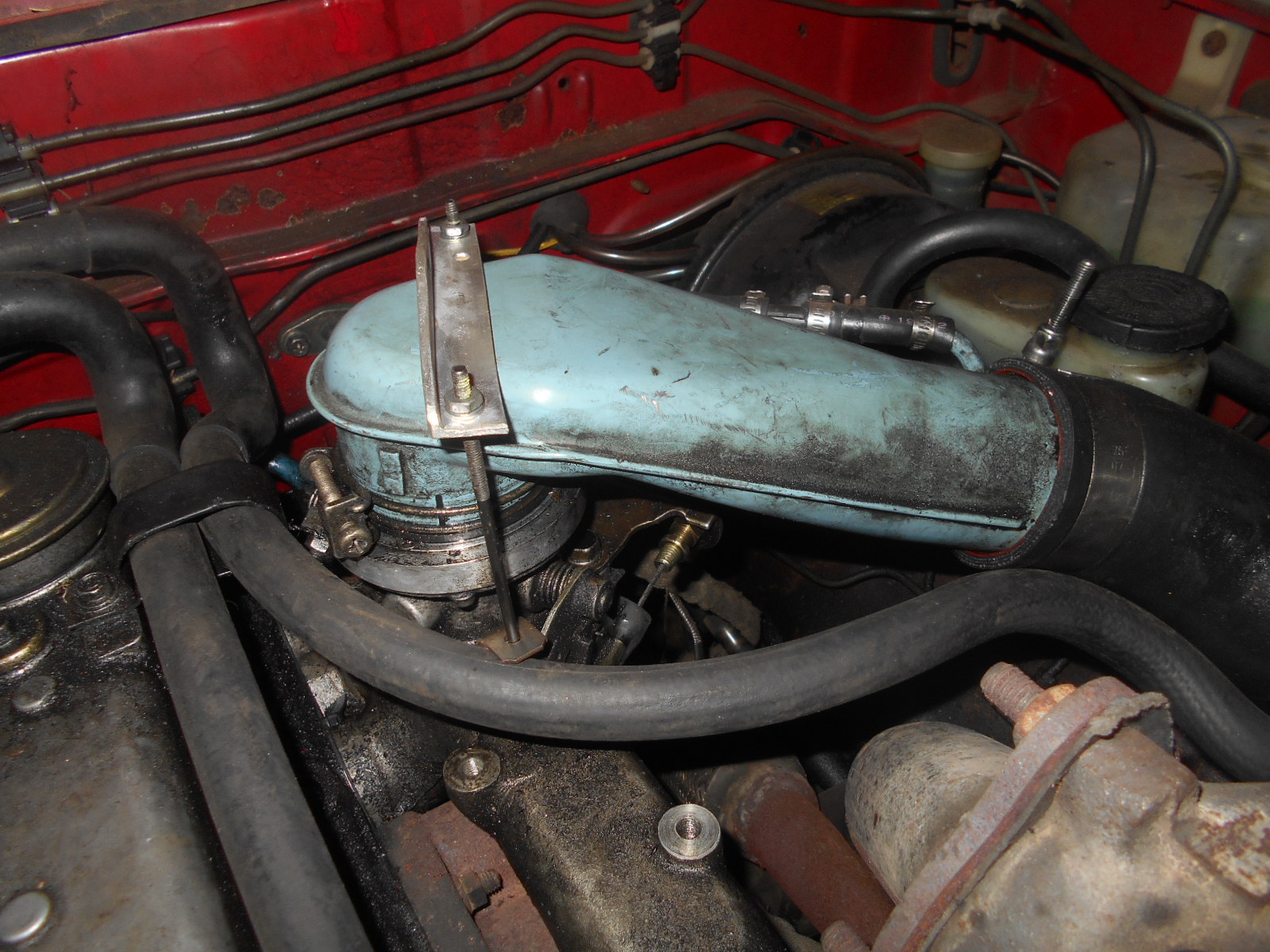

I made a new bracket to hold the intake housing onto the throttle body, I was using zip ties and one had broken, since I plan on using this as my work truck for a while I want it to be dependable. This flatbed also has a Tommy Gate that works great so far, that will make it easier for me to get the debris in my wheel barrow into the truck, as normally I throw it in the bed a shovel full at a time, but I have started using a wheel barrow recently as I am getting old and walking a shovel full of debris around a house 20/30 times is tiring. I am planning on making my 521 work truck a dump bed, I have everything I need, I just have to do it, it will take a while as I also will be using a 1980 Datsun 720 wiring harness in it.

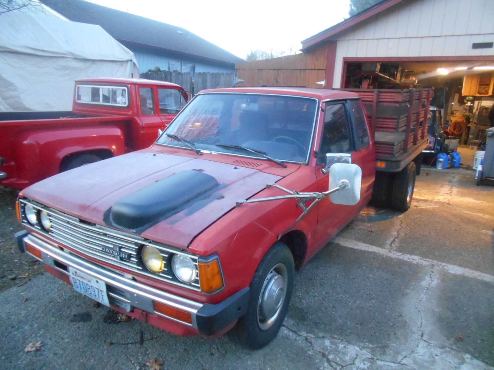

Re: 1980 Datsun 720 turbodiesel
This is what it looks like today, I have used it once for work so far as the 521 work truck would not start, I ruined a starter trying to get it to start, but after replacing the starter it started right away. (insert shake my head here).
The rear suspension is too soft, I don't like it, but this is temporary till I get the 521 work truck cab/bed over onto the new frame that has a dump bed assembly. It has a working Tommy Gate but until I have the trailer light wiring set up to this truck I likely will not have a reason to use it, as I need my pressure washers hauled around in the trailer to make a big enough mess to warrant the need to use a wheel barrow which would warrant the use of the Tommy Gate.
With these wheels on it the truck is not near as smooth, but I didn't trust the adapters I was using to mount the dually rims with that much weight, so aftermarket wheels is the way I went, the engine runs awesome right now and starts easily even when cold outside, not cold like some of you guys talk about, but cold enough that the 521 turbodiesel doesn't want to start without warming up the block before trying to start it.

Ok, so I got ripped off by the guy that was supposed to make the turbo exhaust manifolds, 4 manifolds are gone.
I decided I wanted the good hood back on this truck, so that means I will have to lower the turbocharger, I was having an issue with this turbo, since LarryR modified it, and I have been good enough to make the system airtight, either the turbo is on bypass 100 percent of the time to keep it under 10psi, or I am decelerating, I decided to use another unmodified turbo and make my own setup to get the whole thing under the hood.

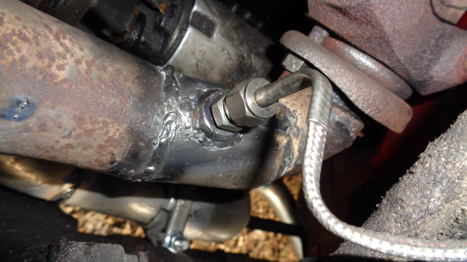

So far I have drove it once without a functioning EGT gauge, it runs and drives now, and today I took the exhaust pipe going from the stock exhaust manifold exit to the turbo out and put the bung in the pipe I made last night and I now have a functioning EGT gauge, but I didn't drive it today.

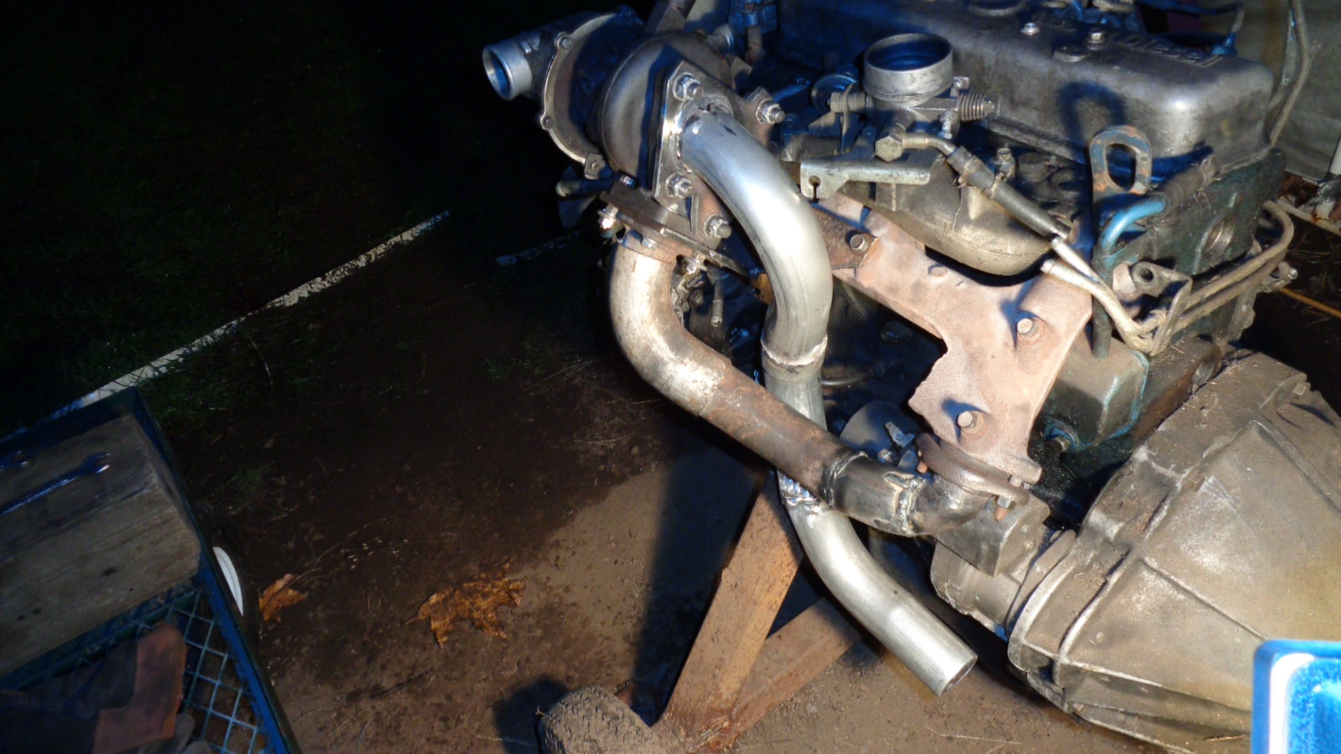

I am just going to post photos without text, I will try to keep them in the order I took them. I added a brace to the top of the turbo to the second headbolt/stud.
You can see that I mounted the turbo on a 90 degree piece of angle iron bolted to the to top bolts and the front bottom bolt on the exhaust manifold that originally held the heat shield, that all the weight is on the exhaust manifold is the reason for the top brace.
Its late so I will answer any questions tomorrow after I drive it and see how things have worked out.
