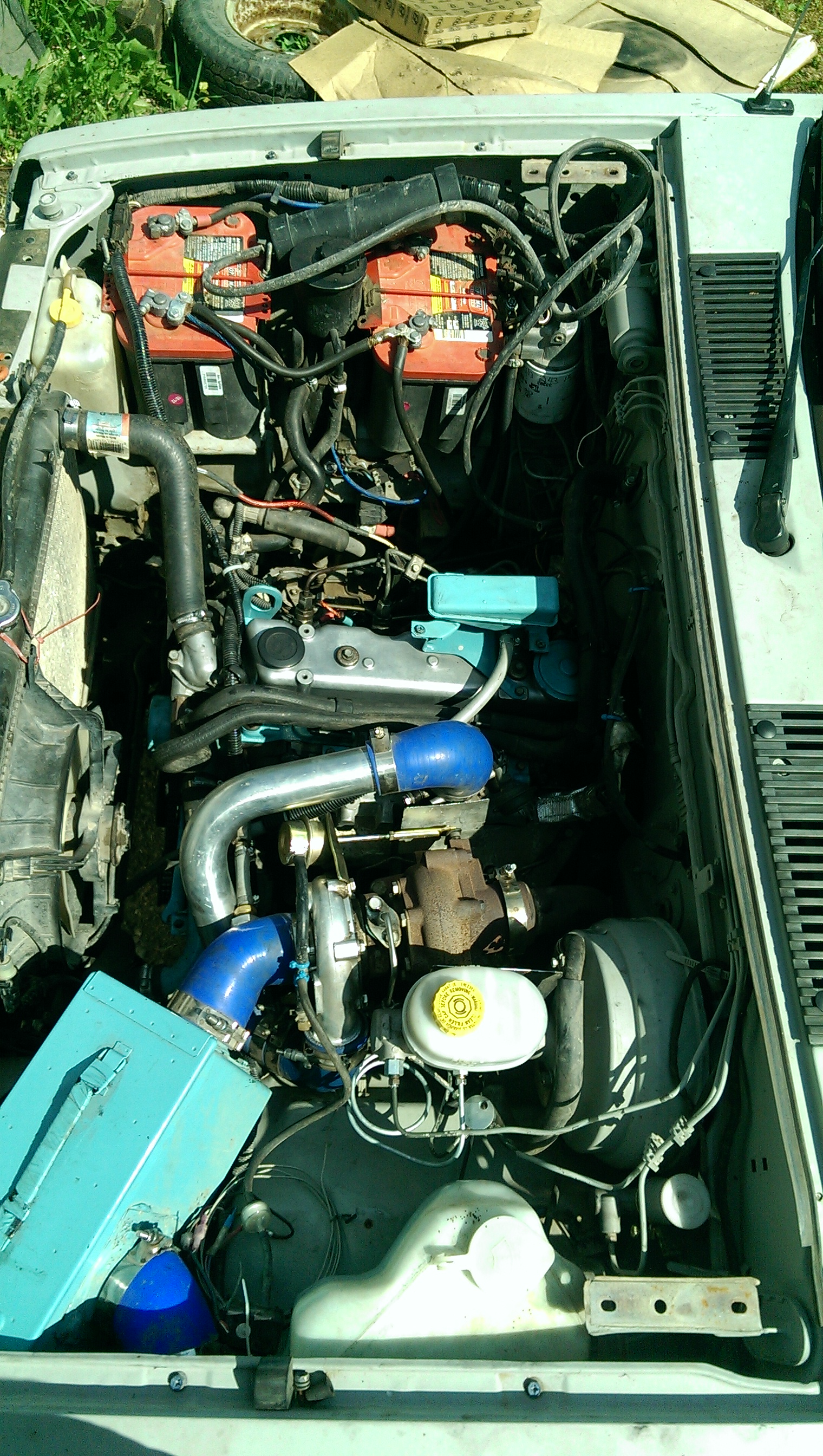

elminero67 wrote:I'm curious as to how well that contraption worked and how long it lasted?
Are you talking about the contraption in the photo I posted?
I looked it over a lot after I bought it, after I had the engine running on an engine stand with a stock intake/exhaust, I put it back on and tested it, it ran like the stock setup, it might have revved a little faster, it was hard to tell.
But the former owner had done something that was a sign of an issue, the same issue that all the other attempts at turbocharging an SD22 I have seen had, they were all unable to build any boost because the turbo was to big, and I think this setup had the same issue, because the waste gate was wired closed, you can see the wire in the photo.
There were two of these SD25 crate engines bought from Nissan at the same time, one went into a Datsun 521 which had a pole building collapse on it with several other collector vehicles when to much snow gathered on the roof 5 or so years ago, and the other was put into a Datsun 620 and drove for years until the owner died, and the kids pulled the drive train out of it, and scrapped it because it had rusted beyond repair, this is the engine I bought.
I thought with the waste gate wired shut that it was not worth chasing, so I never put that setup in my diesel truck, as it drove fine without the turbo compared to all my SD22 engines, I can drive 80mph all day long on level ground, so I just left it alone and played with my many other projects.
Fact is it is goofy looking with the exhaust outlet welded shut, and the new outlet in the front with all the runners pointing towards the rear, it must have had shit flow having to go backwards in that exhaust manifold and then having to make a 90 degree turn just to get to the turbo vane.
Larry was going to do the same thing, he came over to my house and bought an exhaust manifold from me to do just that, seen mine and wanted to buy it from me, but I told him I would not do it that way, and told him how I had seen someone on here do it with a curved pipe from the stock outlet, and he went home and did just that.
By the way, the turbo Larry used is a lot smaller than the turbo on the setup in the photo, and it works great, at least that is what Larry tells me, I don't drive this Volvo because it's not in my name, and I plan on scrapping it, so it will never be in my name, so I don't drive it, I will transfer the drive train into a 720, or whatever vehicle I decide to build for it.

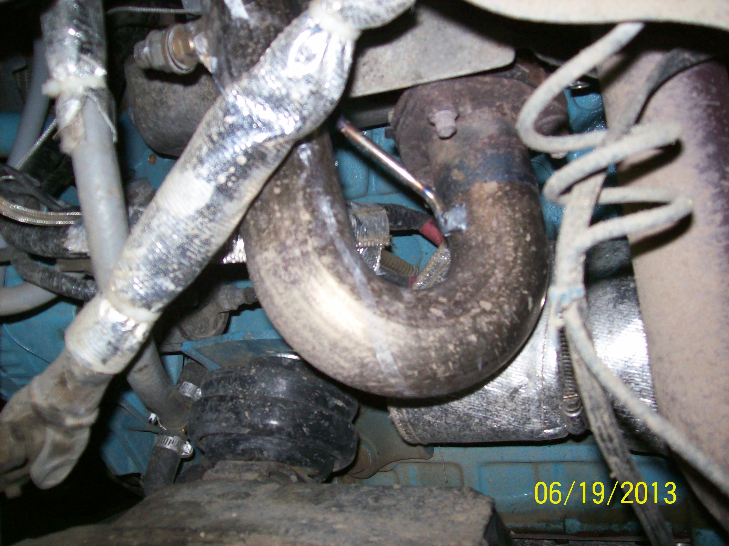

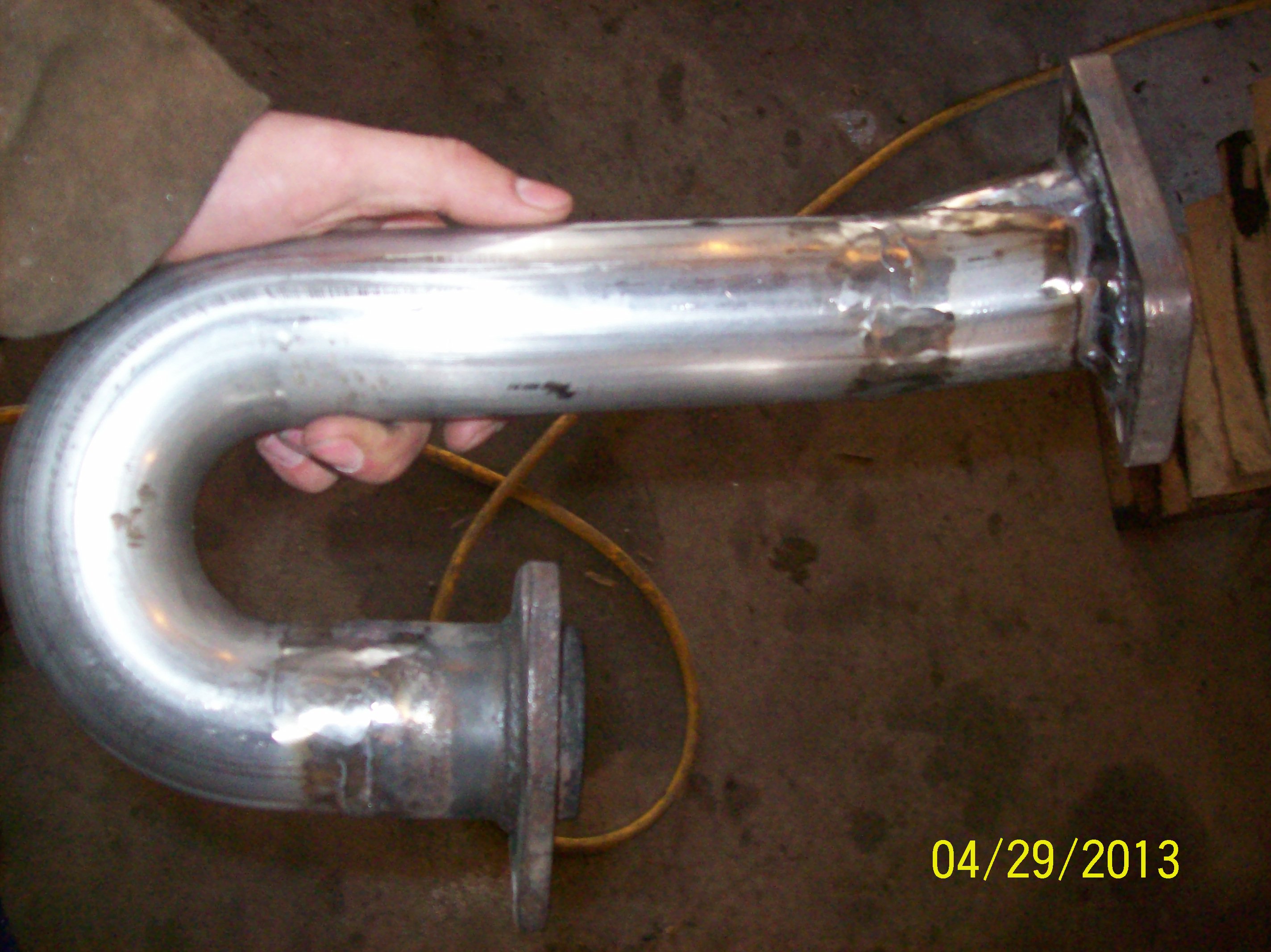

Can you post a photo of the "J" pipe again, I cannot find it anymore, it was what I told Larry to make when he came over to my house to buy an exhaust manifold to do the same thing that the old timer did when he made the exhaust manifold I have, it was a stupid way to do it, but it was done a long time ago, before all these forums we have now to help each other, and pass along good ideas.

the pipe I used is 2inch radius 2in exhaust pipe. Other then the flanges I believe I used only that pipe with some skillful measuring very little material waisted. I added some bracing across the bend radius to help stabilize and strengthen the pipe. I also added 2 braces from the exhaust manifold heat shield bolt holes to the upper flange area to prevent any twisting or vibrations from exhaust and intake from breaking welds. I also removed the factory donut to the manifold in favour of a flat bimetallic gasket which gave me a nicer flat surface for the manifold to j-pipe flange. I was more worried about function over form with the setup. I would like to make another j-pipe when I go to a smaller tb25 turbo.

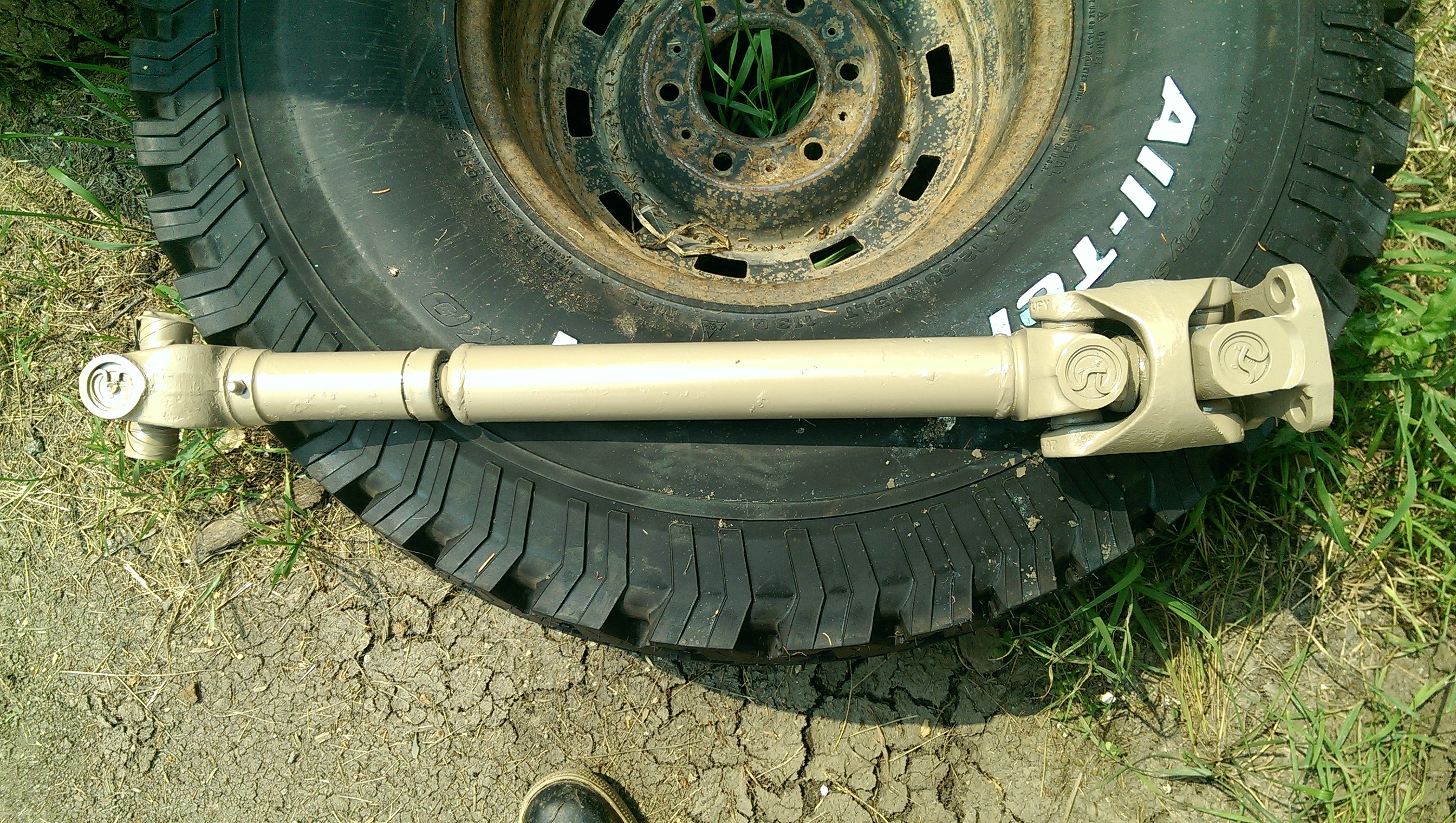

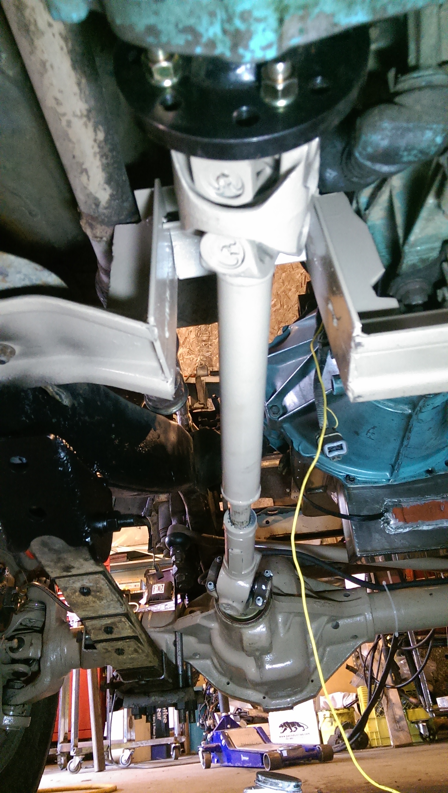

I had the wagoneer drive shaft shortened 5in to bolt up the front axle, and I installed new u-joints with a new 1310 cv flange I got locally.

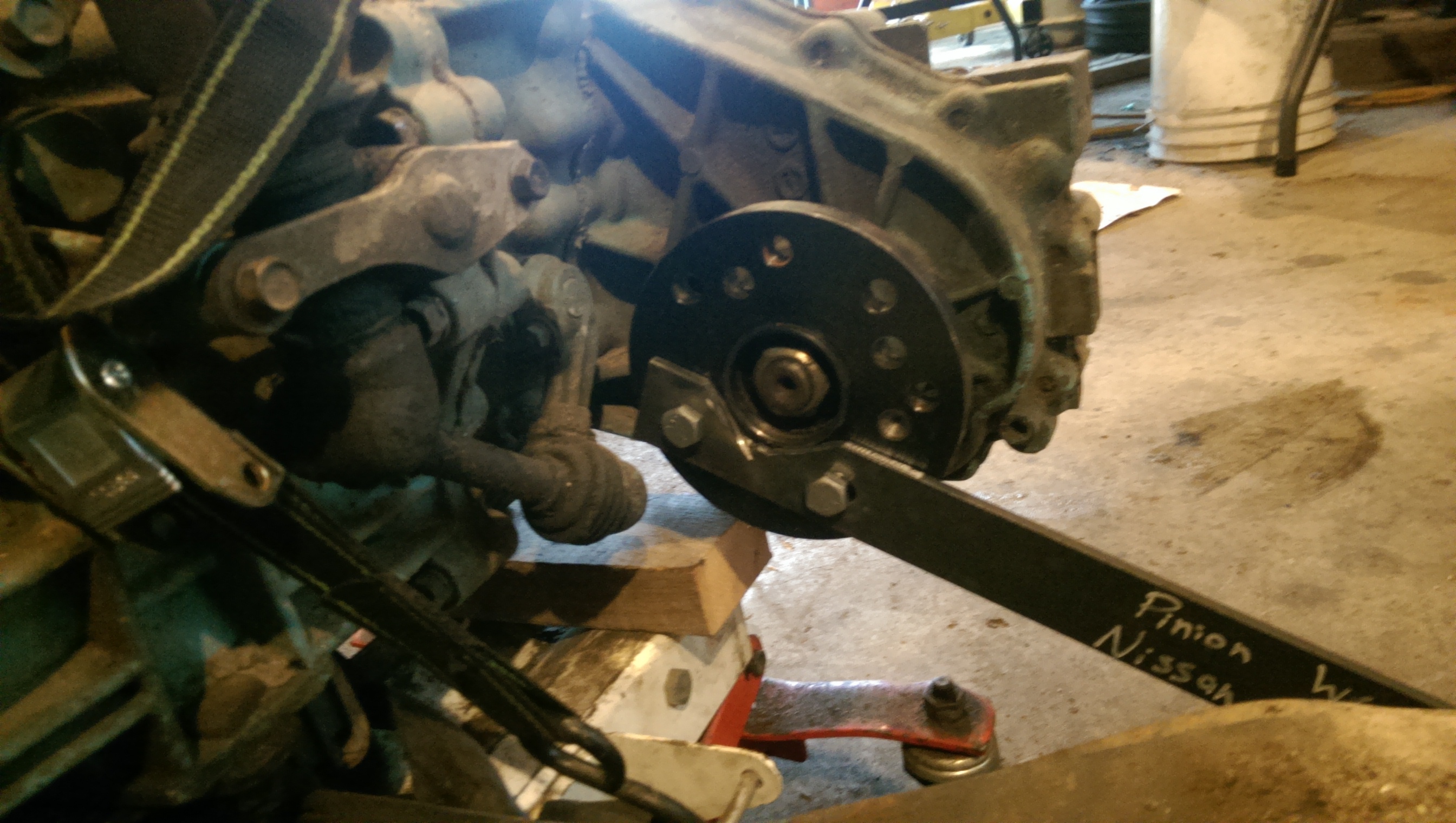

I had to make pinion flange tool for swapping the rear gears of the h233b nissan axle to 5.13. Ironicly with slight ovaling of 1 hole it bolted up to my new 1310/1330/1350 cv flange adapter from ruggedrocks.com. now the tx-10a transfercase accepts domestic drive shafts

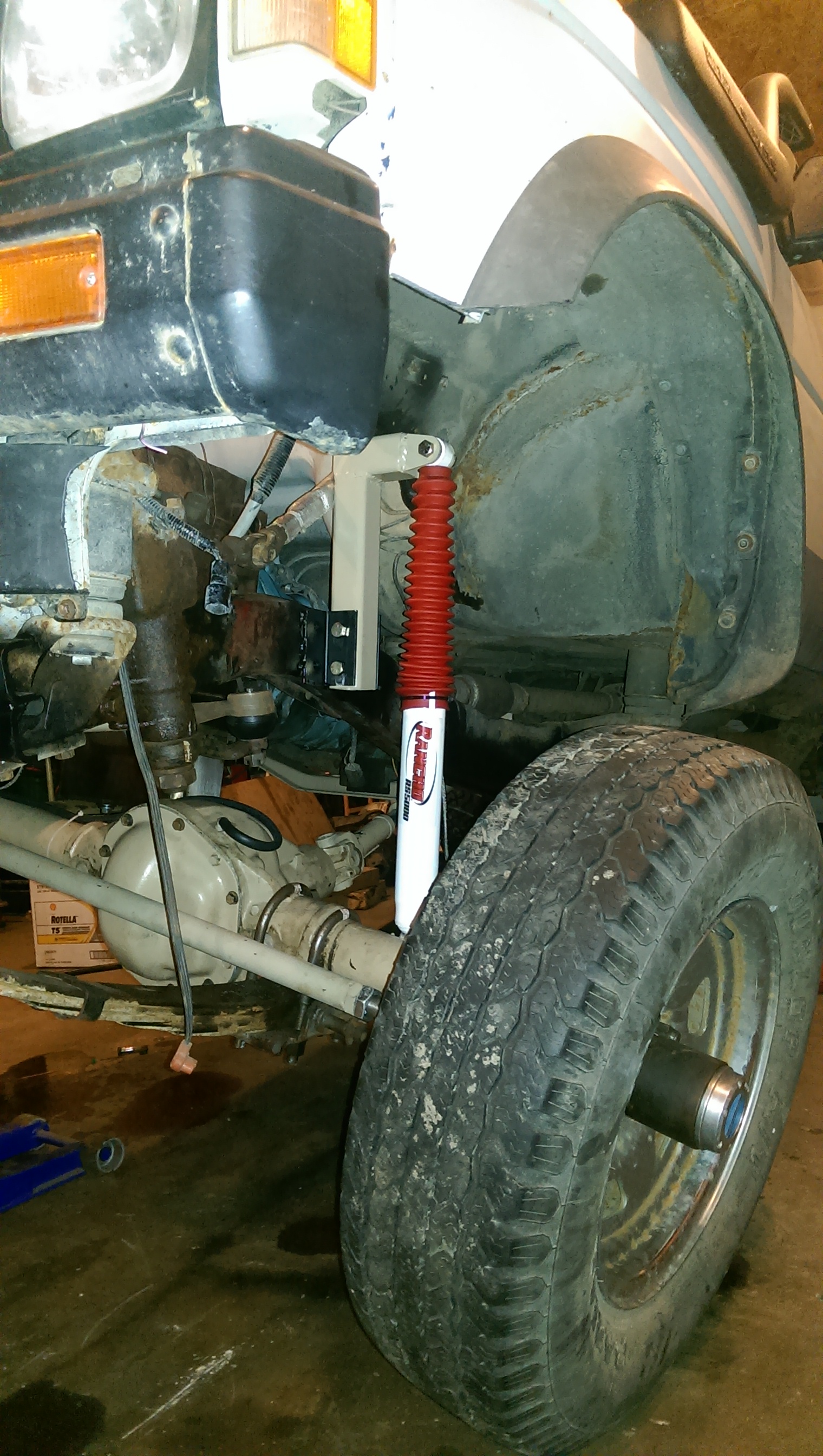

made up some shock towers using 3/16 thick 2x2 and some 3/16 2x2 angle iron welded to the frame. this allows me to remove or change my shock tower position. using rs5112 rancho shock up front 10in travel. used the stock wagoneer shock mount on the axle and a shock mounting tab from ballistic fabrication, Grade 8 hardware of course on absolutely everything. it took some screwing around to find a tower placement that offered very little binding on the shock.

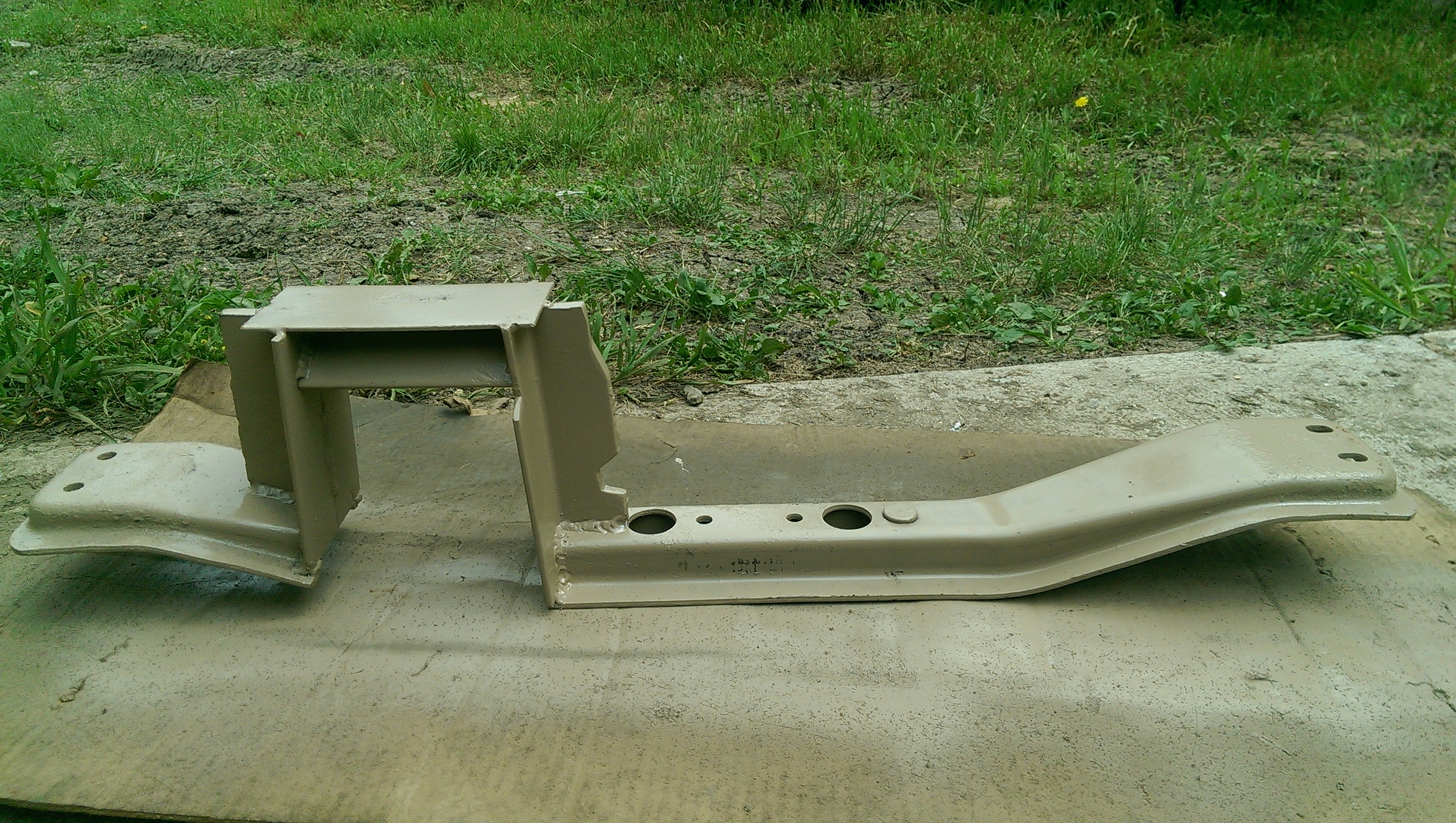

modified the front trans cross member to allow the drive shaft to pass below it.

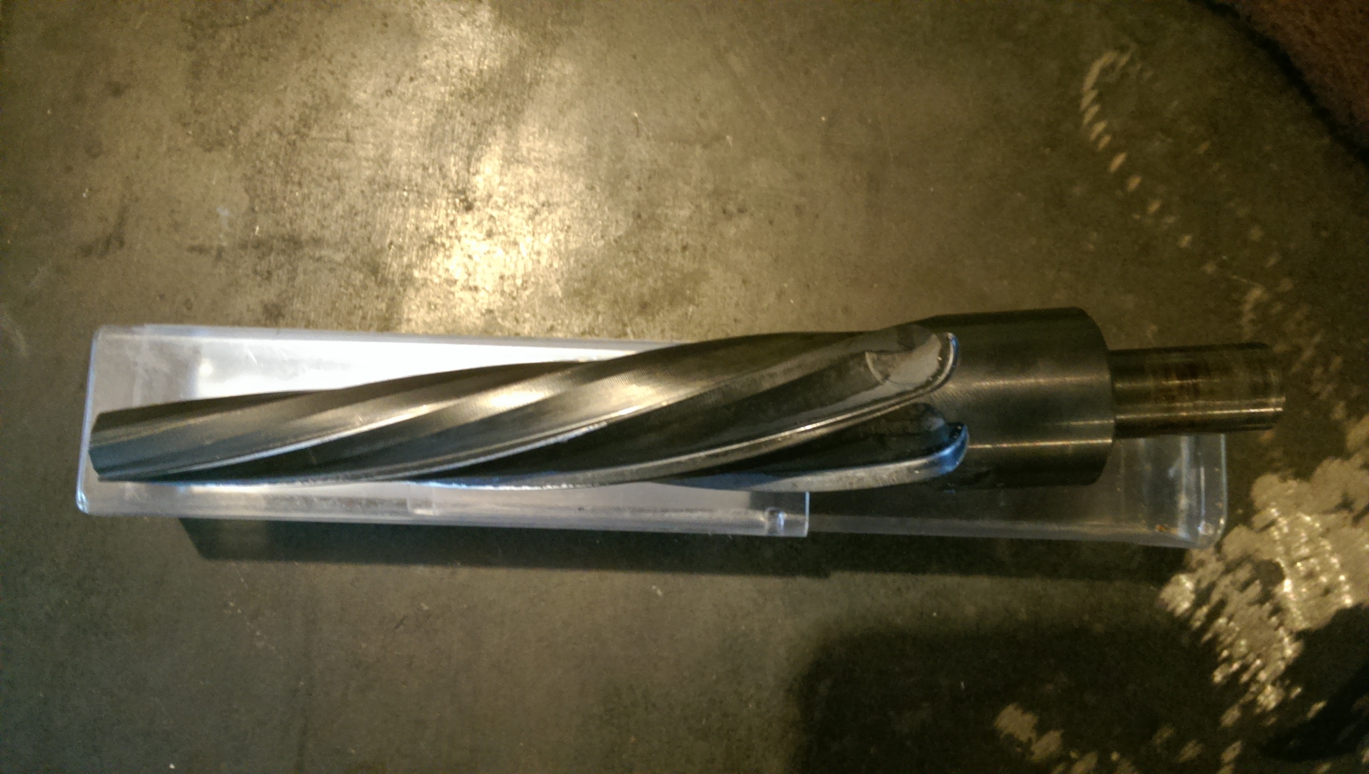

here's what the reamer looks like. Its also needed to ream the stock pitman arm on the nissan steering box as they use a narrower taper. my truck has the big shaft steering box stock in 92

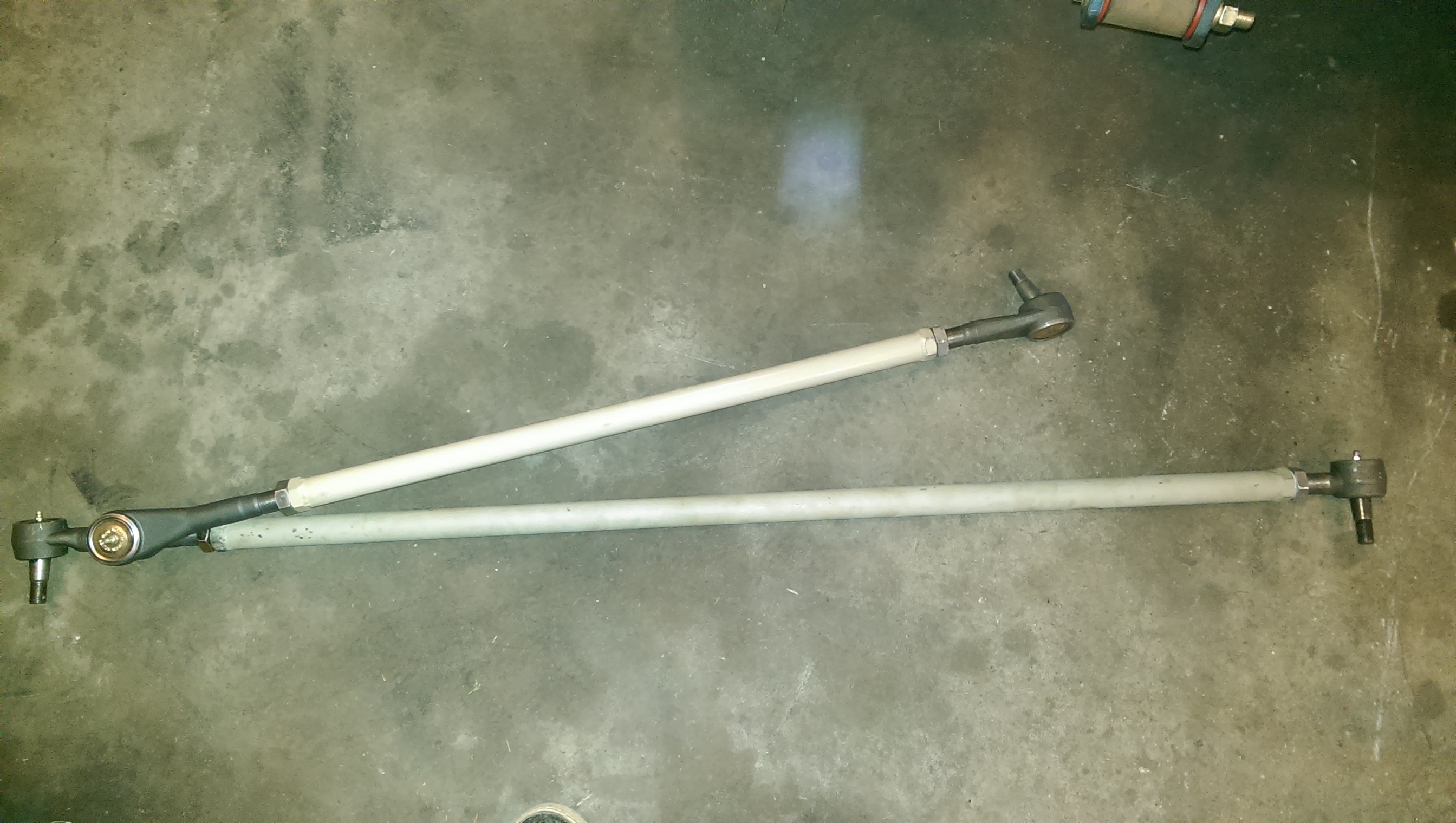

made up a heavy duty steering system. using 7/8in 18tpi threaded bungs from ballistic fabrication, es2026R, es2027L, es2234R, es2233L, ,some 1in ID .120 wall DOM tube, and you need a 1.5in per foot tapered reamer to ream the es2233L joint. I tig welded the tubing and bungs together

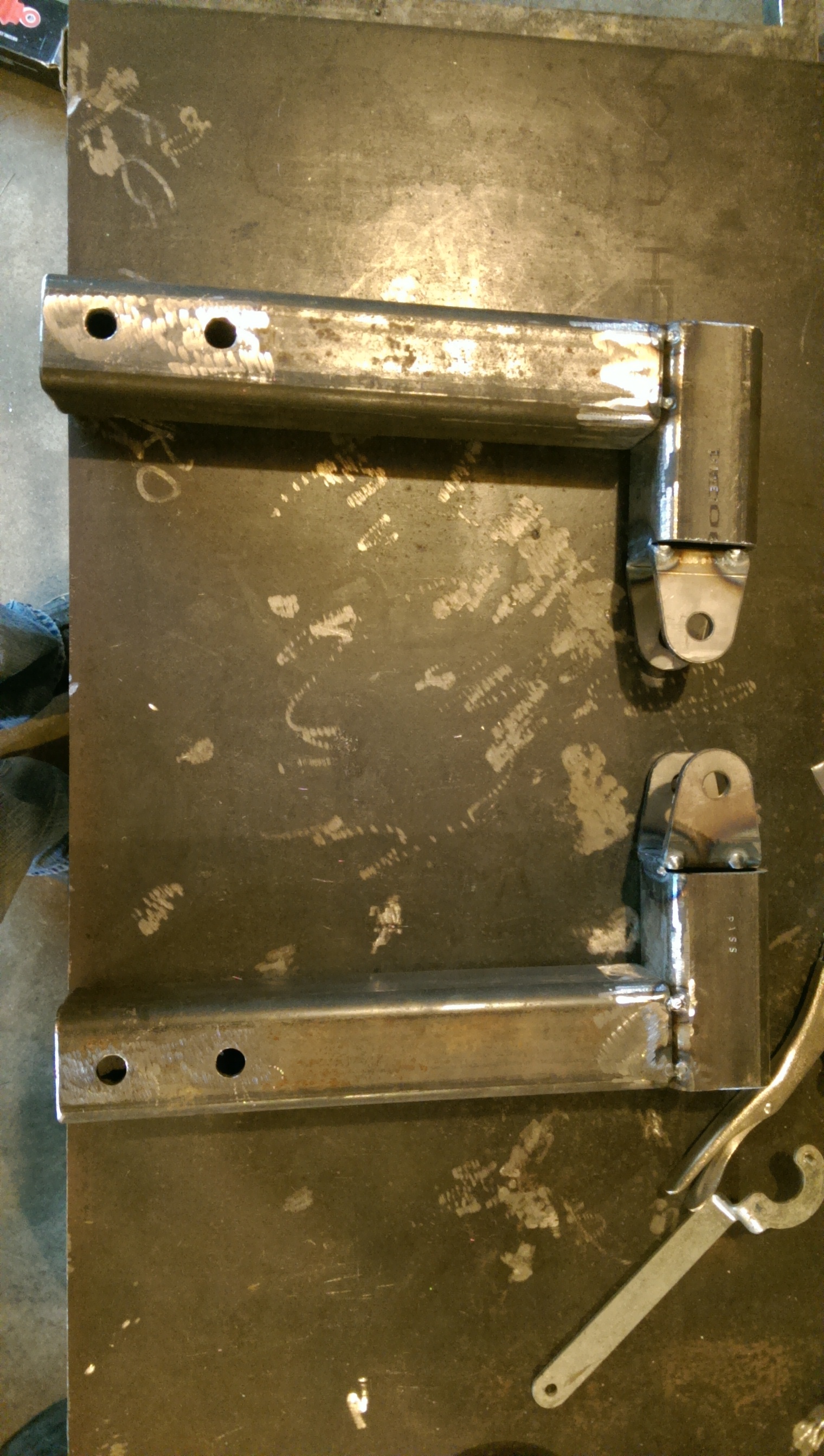

made a front hanger from a piece of .250 wall 2x2in tubing. I then tig welded some bushing perches on it from ballistic fabrication

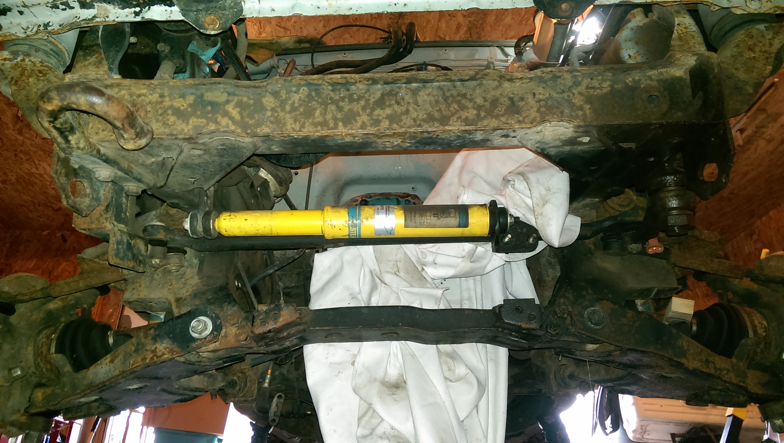

here's what the front end looks like stock

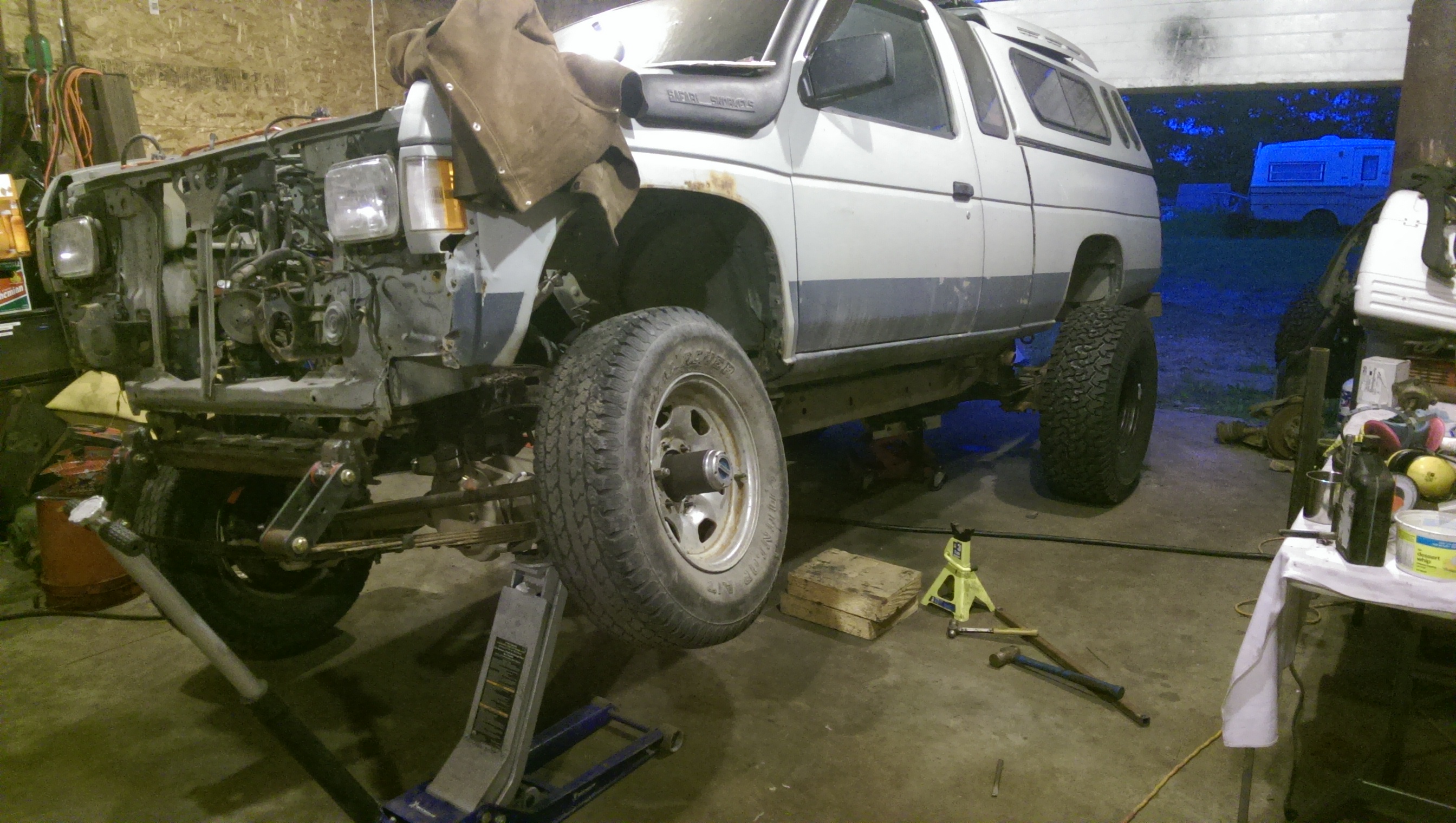

removing the engine this many times pissed me off so much I found a dana 44 axle from an 82 jeep wagoneer for the front end. now removing engine will be possible without removing tires

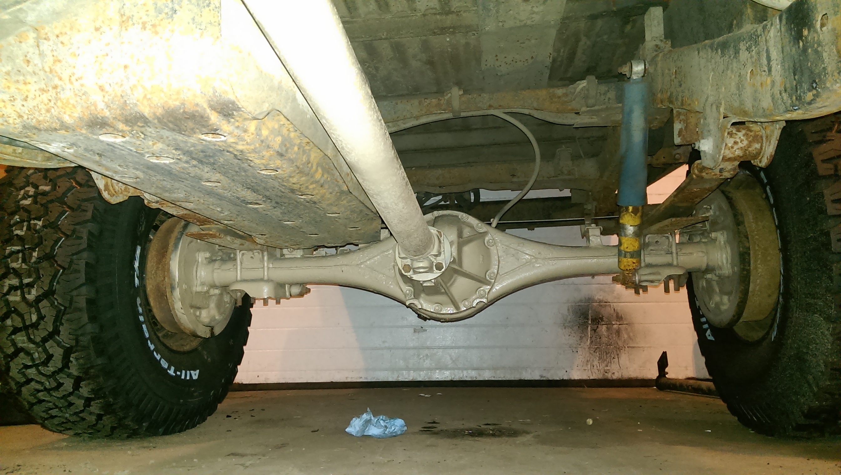

if anyone has the h233b rear axle in there truck dont even question its reliability. THEY ARE BEASTLY. the h233b axle makes everything on the dana 44 look like a chew toy. for those who dont know the dana 44 was in mid size to full size trucks and suv's. the h233b is playing with stuff like dana 60 territory (1 ton and up) extremely beefy stuff, specially in a 1/4ton. I was amazed when I set the h233b ring gear beside dana 44. the nissan gear is almost 1in. bigger in diameter and has at least double the gear contact width, not to mention the gear thickness being almost double.
loving the 5.13 gears and 35's. lots of clearance and good power on the highway. running 6psi on stock fuel with hot pipe. I also noticed something interesting. because I was overrunning the engine with 31in tire on 4.37 gears this resulted in higher egt's. With 31's I saw 1100-1200 peak then drop off to 1000f on highway. now with gear change I have not seen the egt get higher then 1000f ever and on highway it drops back to 800f. weird to see a 100-200f drop without an intercooler just from engine load change as a result from gearing. I've also noticed solid axle doesnt seem to rob as much power with the hubs locked in driving in 2wd. the IFS front end always seemed like there was abit of drag slowing you down, which i can only think the cv axles? just more joints and more parts turning I think. either way I'm pleased with my results so far
I should also mention I extended my wheelbase forward approx 2in to make room at the rear of the wheel wells for turning/tire clearances. factory fender is only 33in wide. so I hacked off the front section of the fender and trimmed down the flare to match. as far as I can tell my current hieght is equal to the rear with 3in lift from helper spring and longer shackle. this has not been modified from previous. Also without the body lift I would not have the clearance in the rear to stuff a 35. at some pint if I do further suspension modifications I may remove the body lift. But as currently the accessibility to the engine and other parts it offers is valuable and it also gives me more room to fit spare fuel tank and other things while keep the nice flat d21 bottom... FLAT. so we will see what the future brings haha

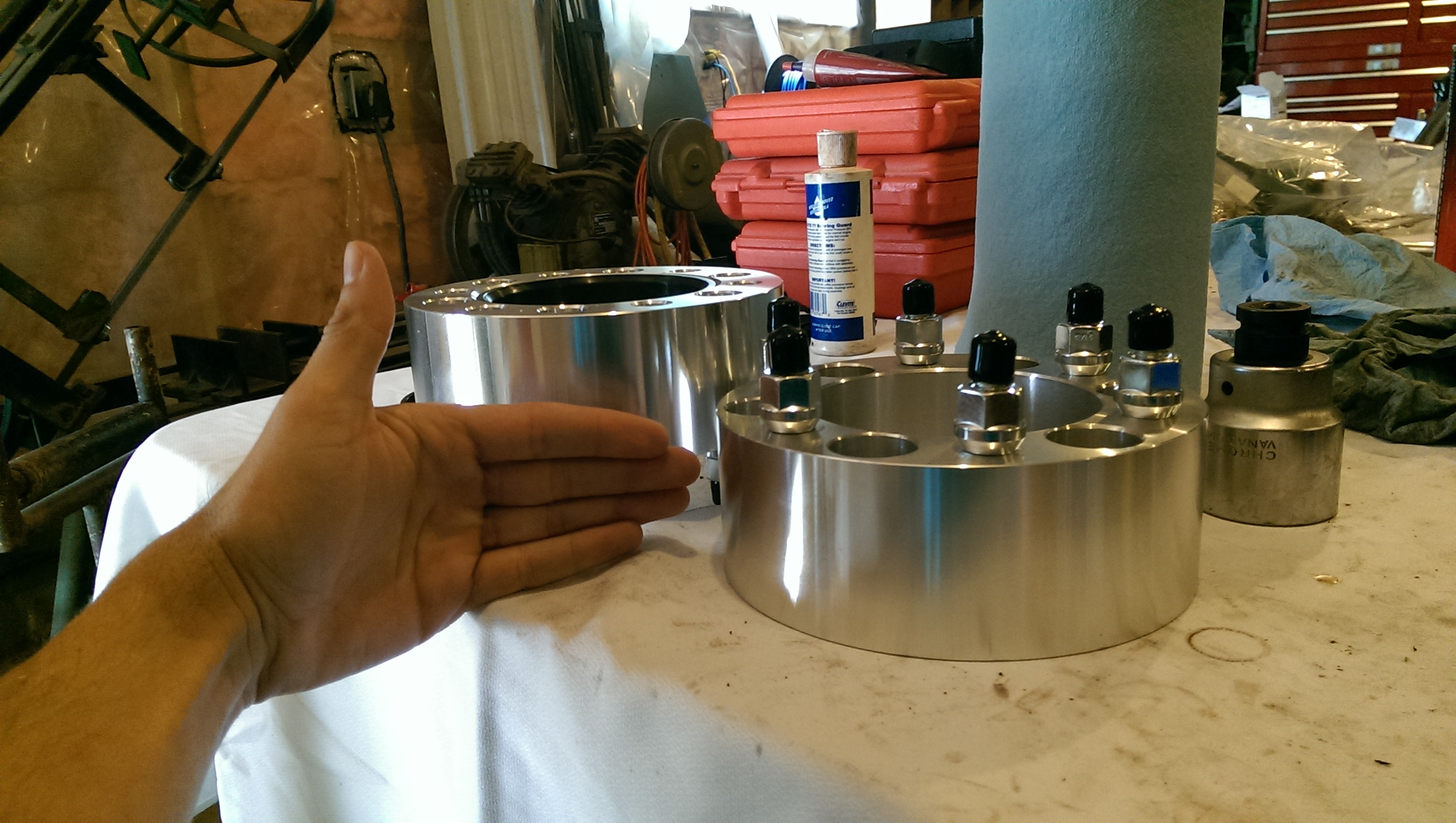

heres another shot of that hub spacer. I ended up having to taper the outside edges to clear the turning mechanism inside the bolt on half of the lock

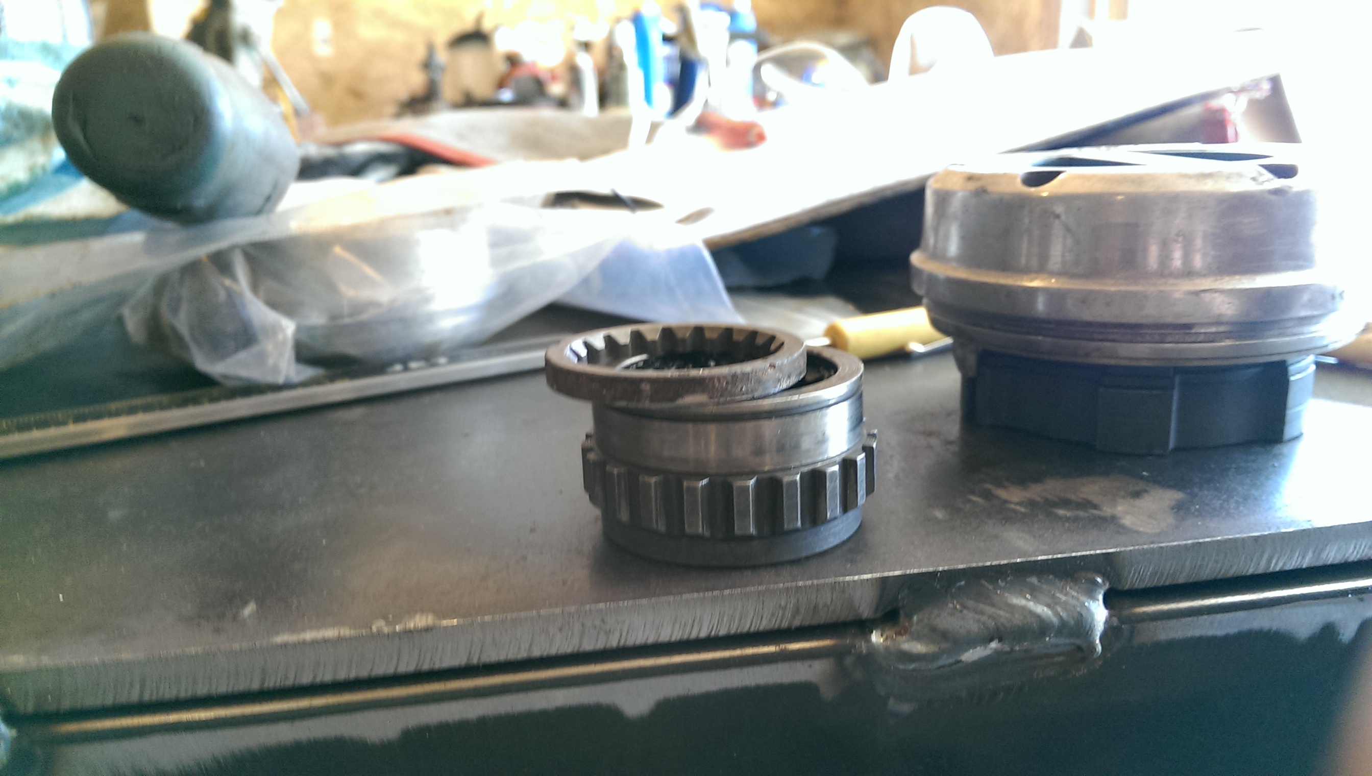

the superwinch hubs i found at the junkyard for free (nice score on that) didnt fit my outter axles properly. there was about 1/8th inch space between the snap ring the axle lock. which allowed axle to slid back into contact with the inner "c". this is not good. so I used the 19spline sleeve from the old locks that I had to cut off from rust. I made a small spacer out of these as the superwinch hub lock has a special low profile snap ring so what ever spacer is used NEEDS to fit in the axle splines to not slide over top of the low profile snap ring

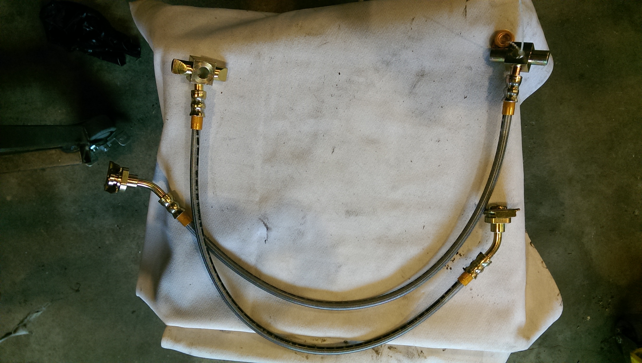

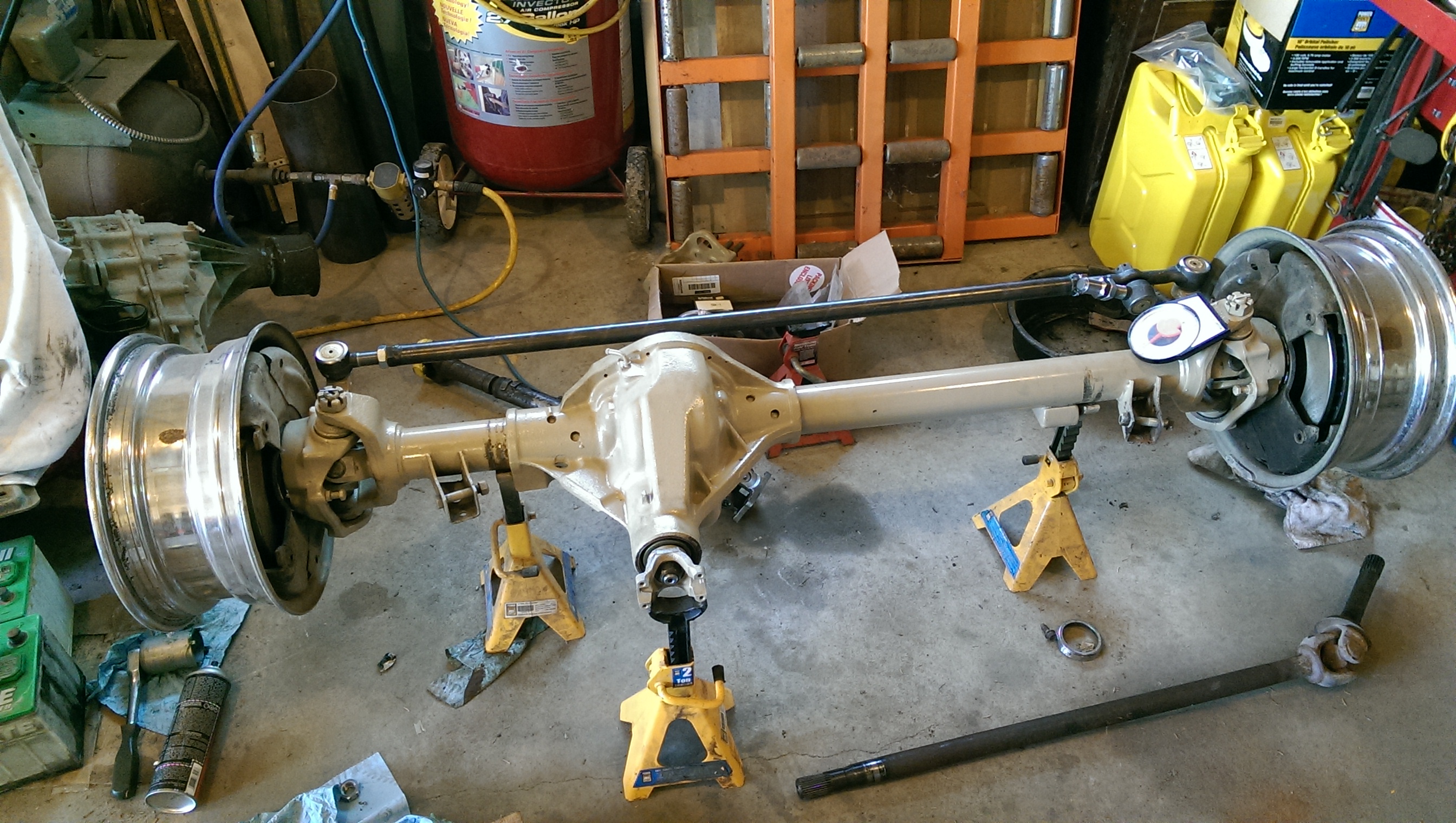

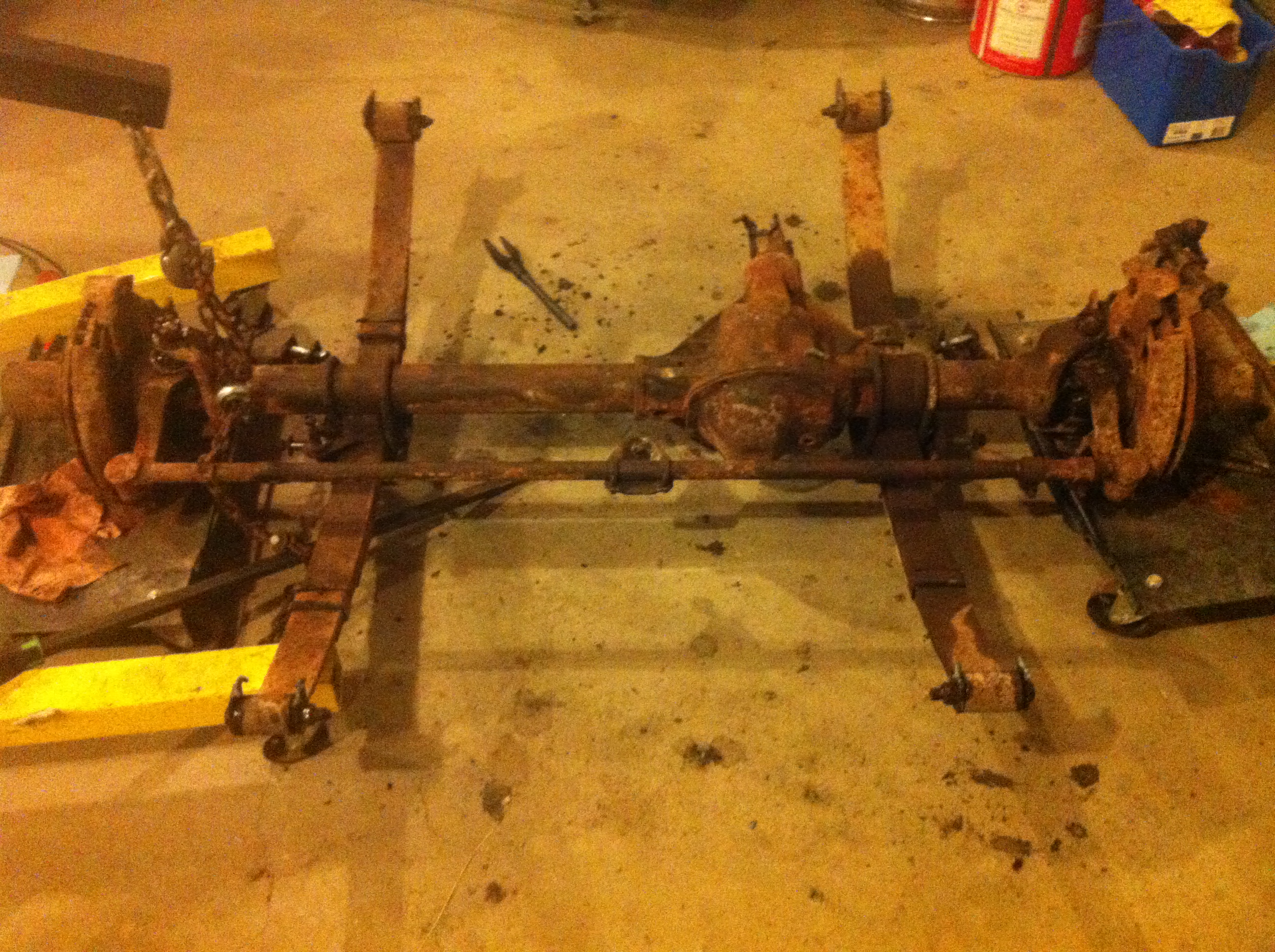

heres a shot of the rear axle back together and painted. had to make some new brake hard lines as mine where rusted very thin.
heres a close up of the shock towers minus the mounting brackets.

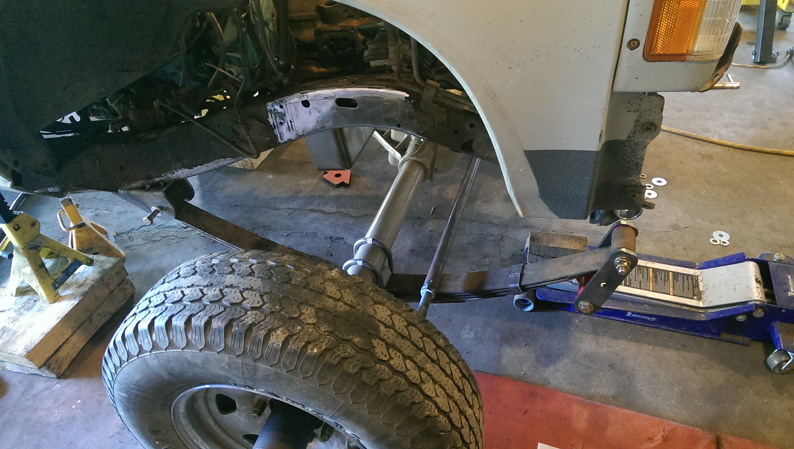

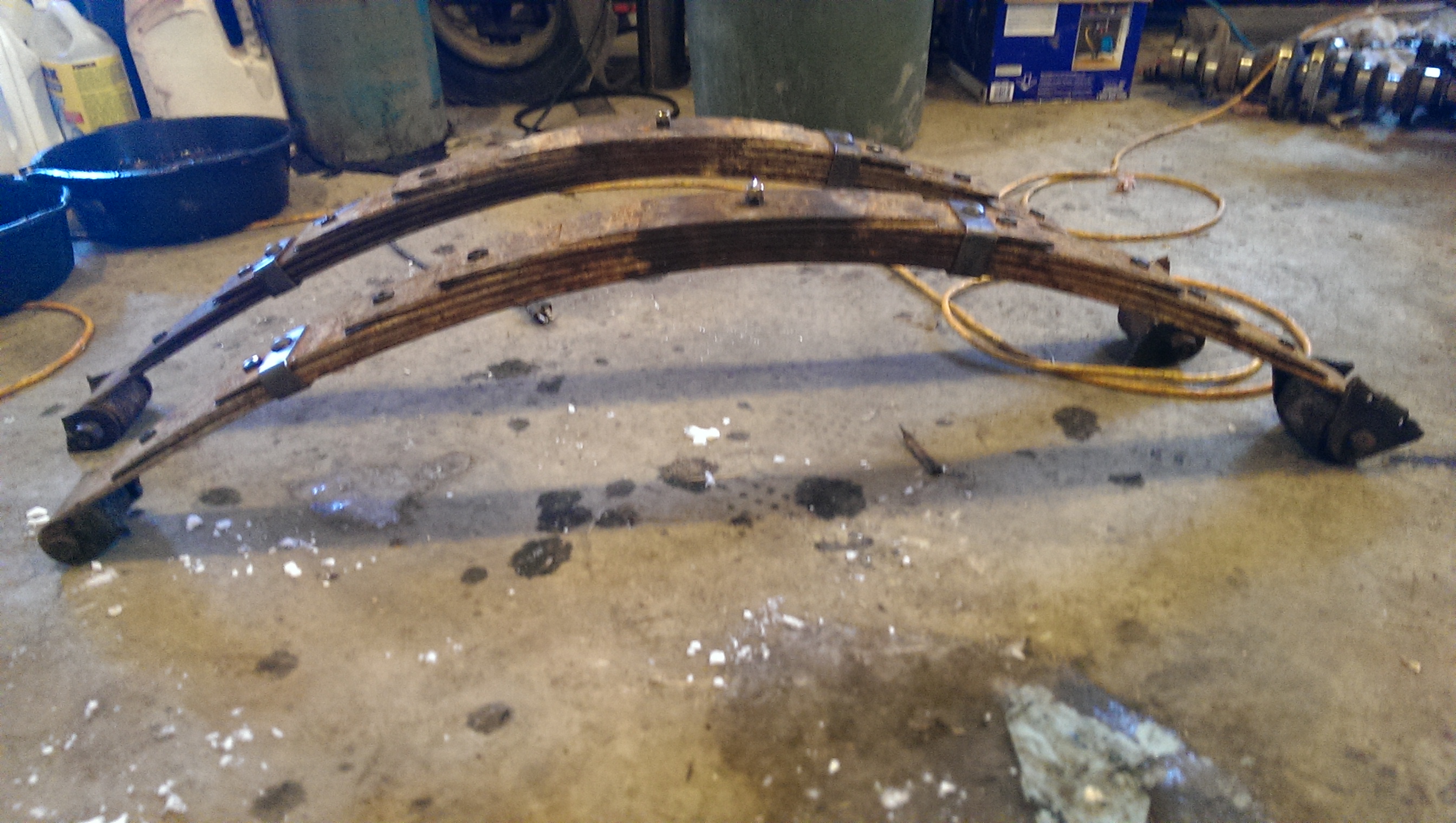

heres the 6 leaf pack that was on the wagoneer stock. I had local spring shop re-arc and re-pad the springs so I could put poly bushings in

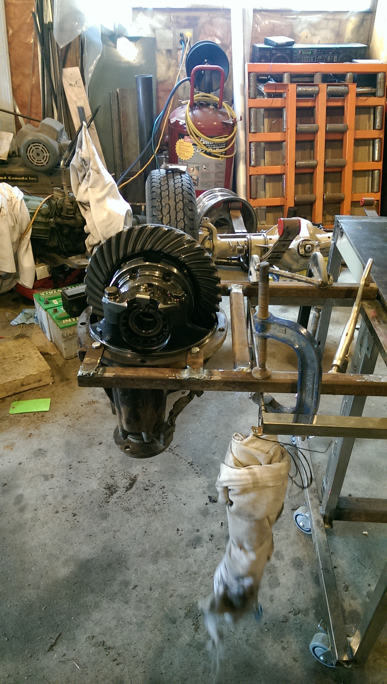

heres a shot of the h233b carrier out of the housing. just like a ford 9in or toyota 8in only... bigger... lol. I made the carrier holder, pinion wrench and carrier bearing wrench out of scrap steel and some welding.

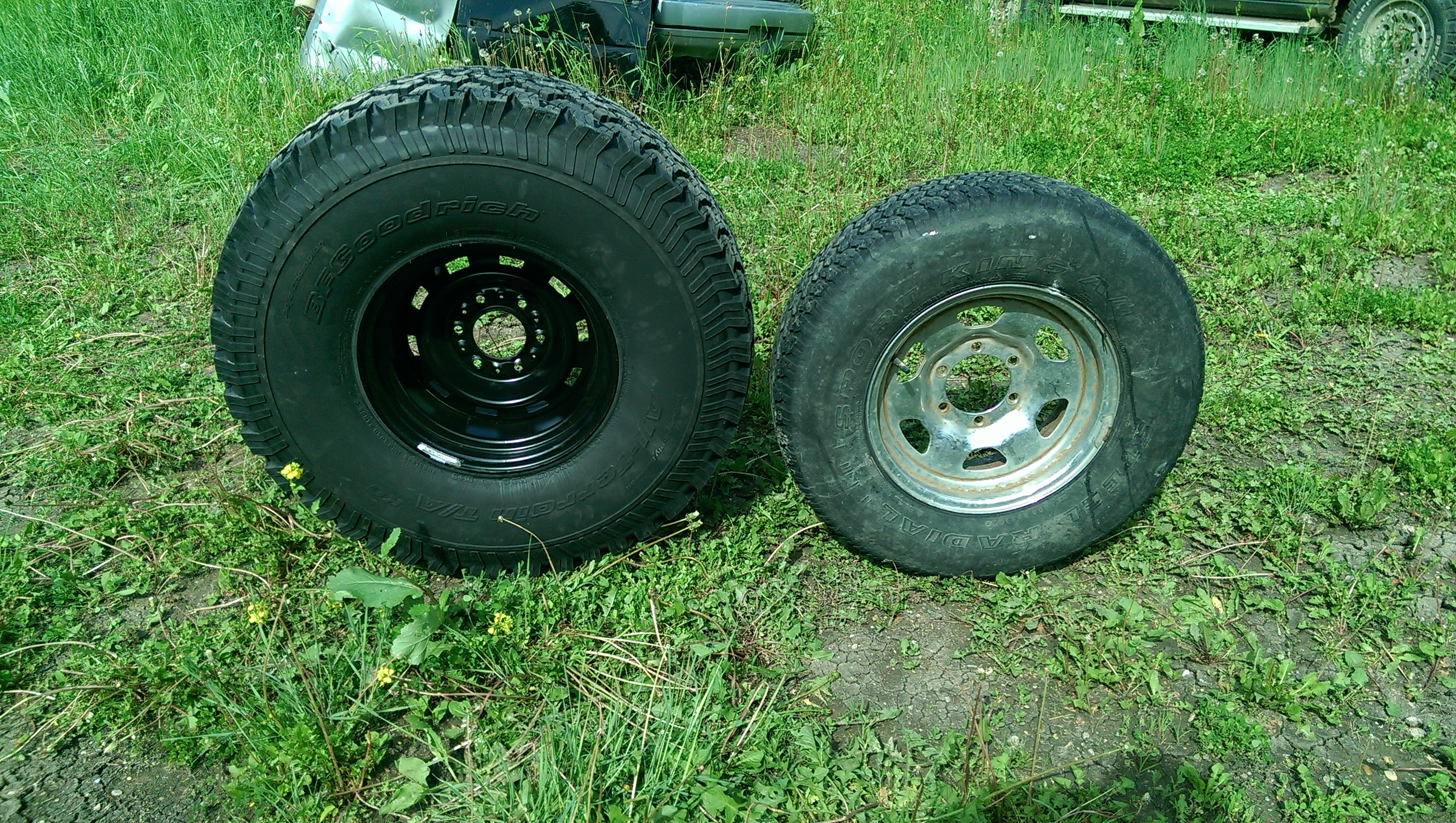

225/75r15 on right and 35x12.5r15 on left

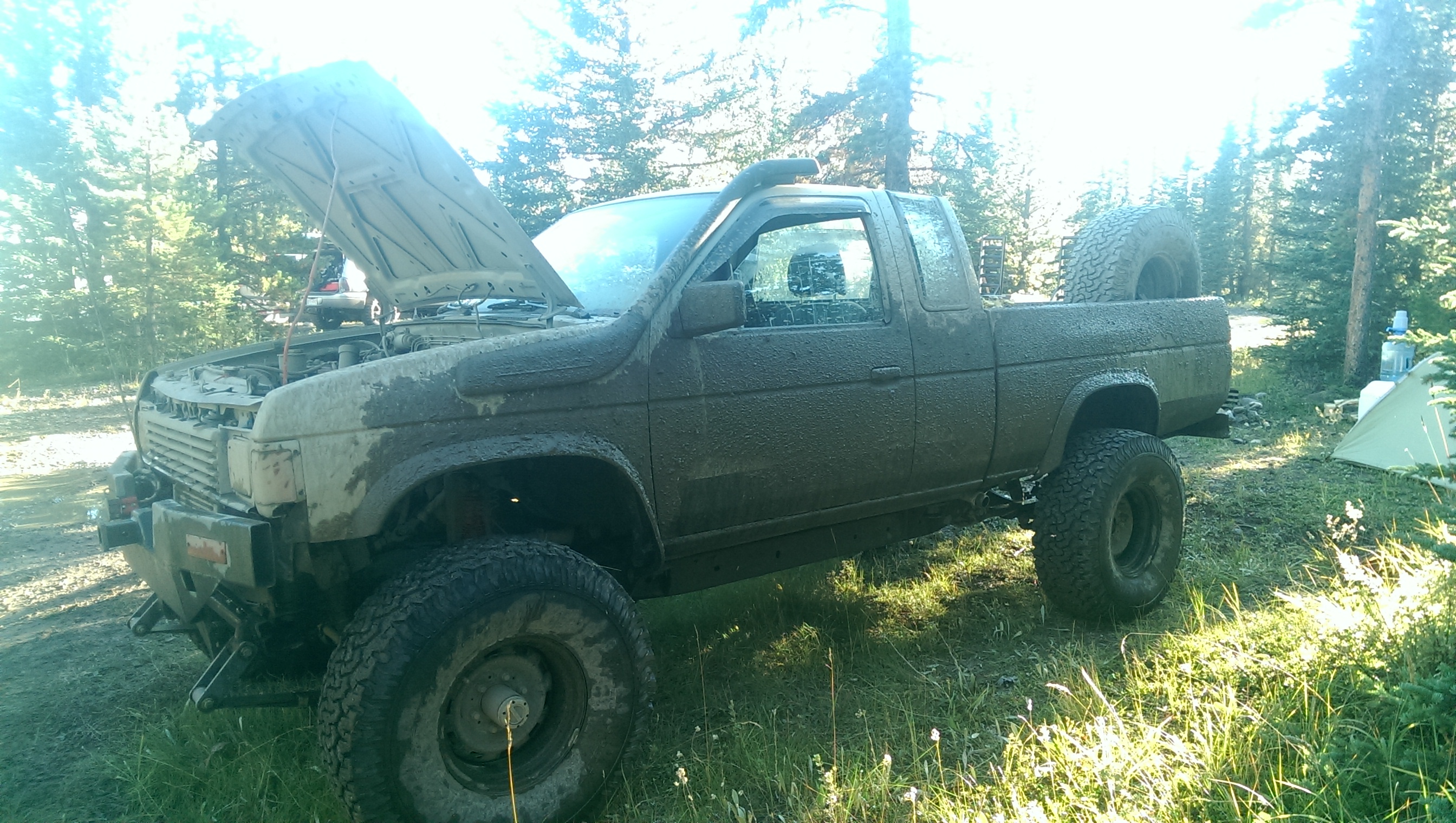

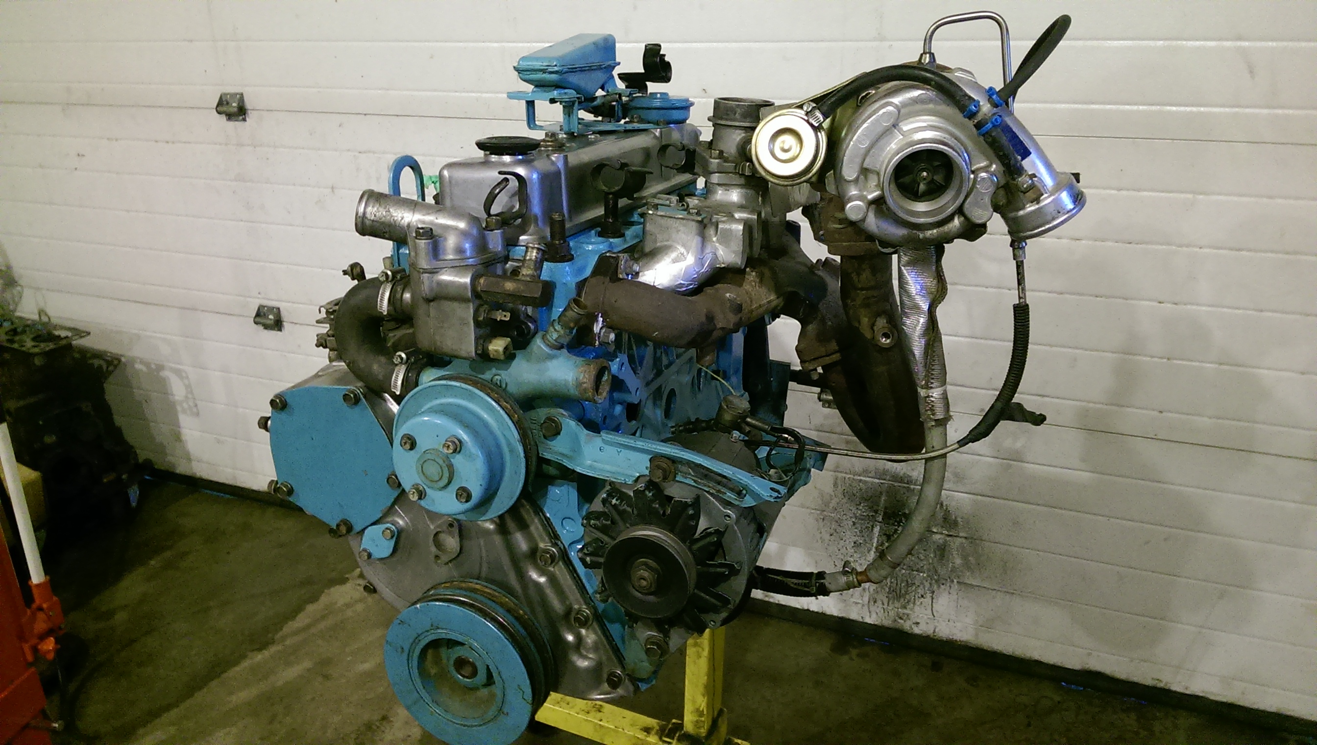

engine shot all installed again

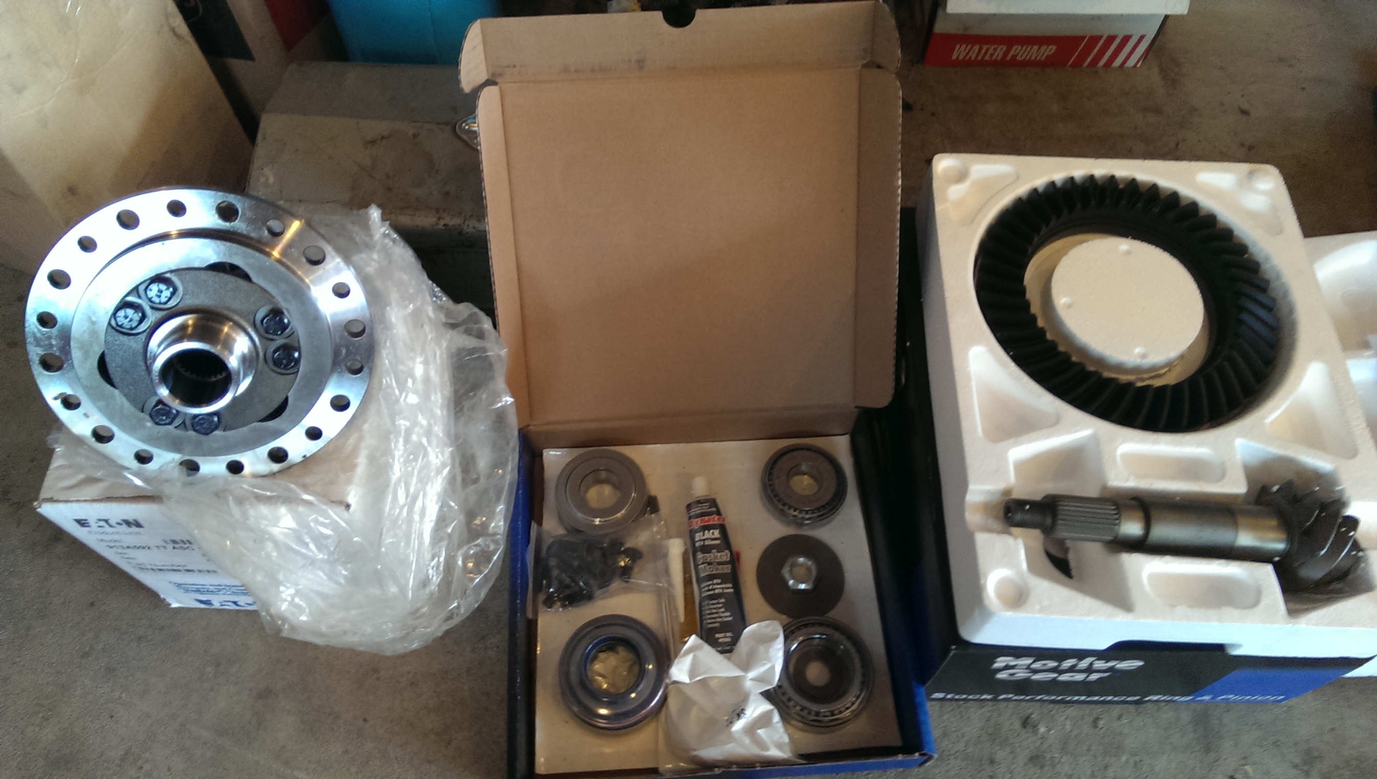

heres a shot of the motive gear set and detroit true trac that went into the dana 44. I needed a new carrier after 3.92 gears and for 100 dollars more over an open carrier I got a torsen limited slip.

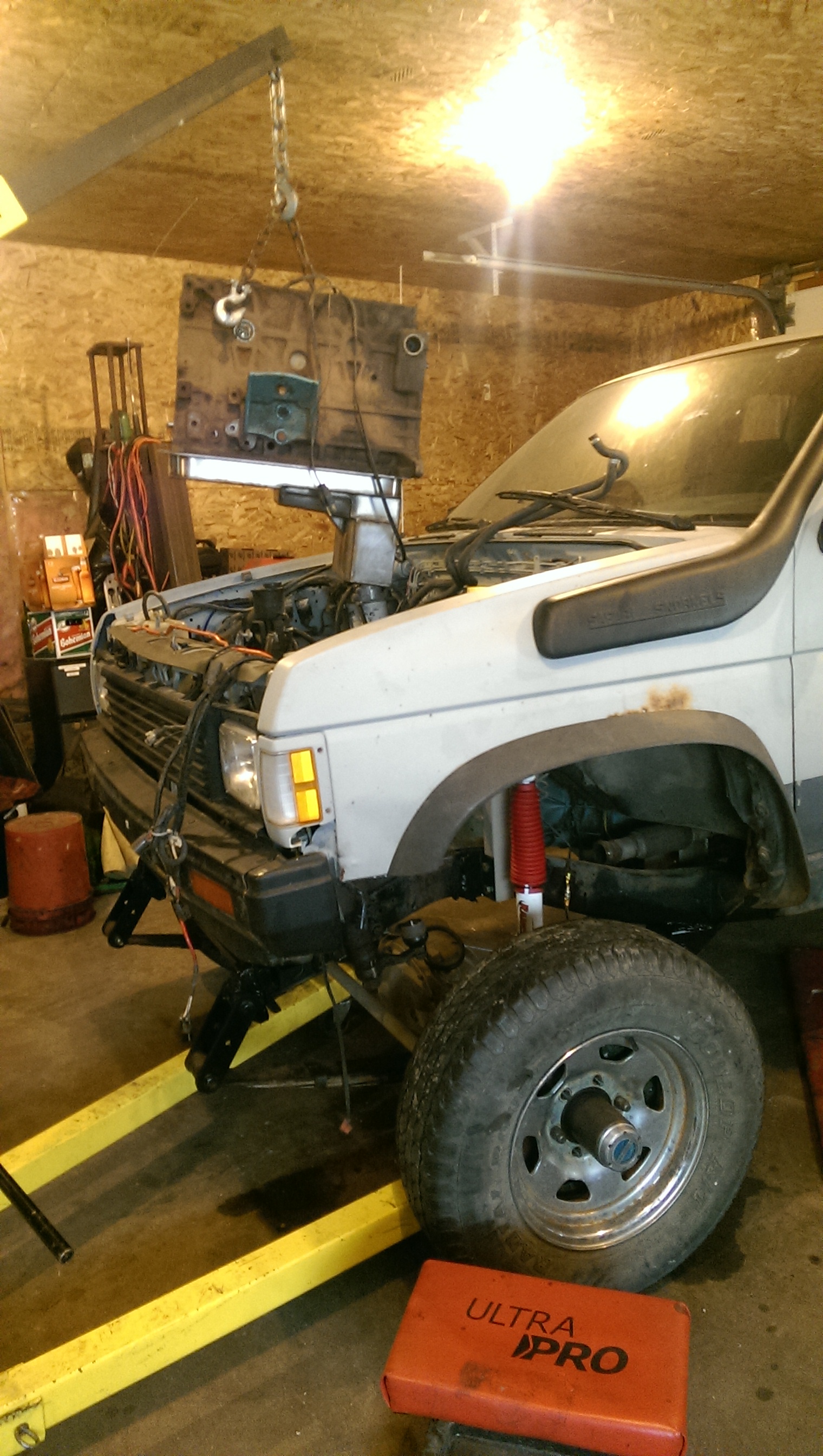

removing the mock up block without needing any jacks under the truck or removing any driveline parts..... ahhh breath of fresh air lol.

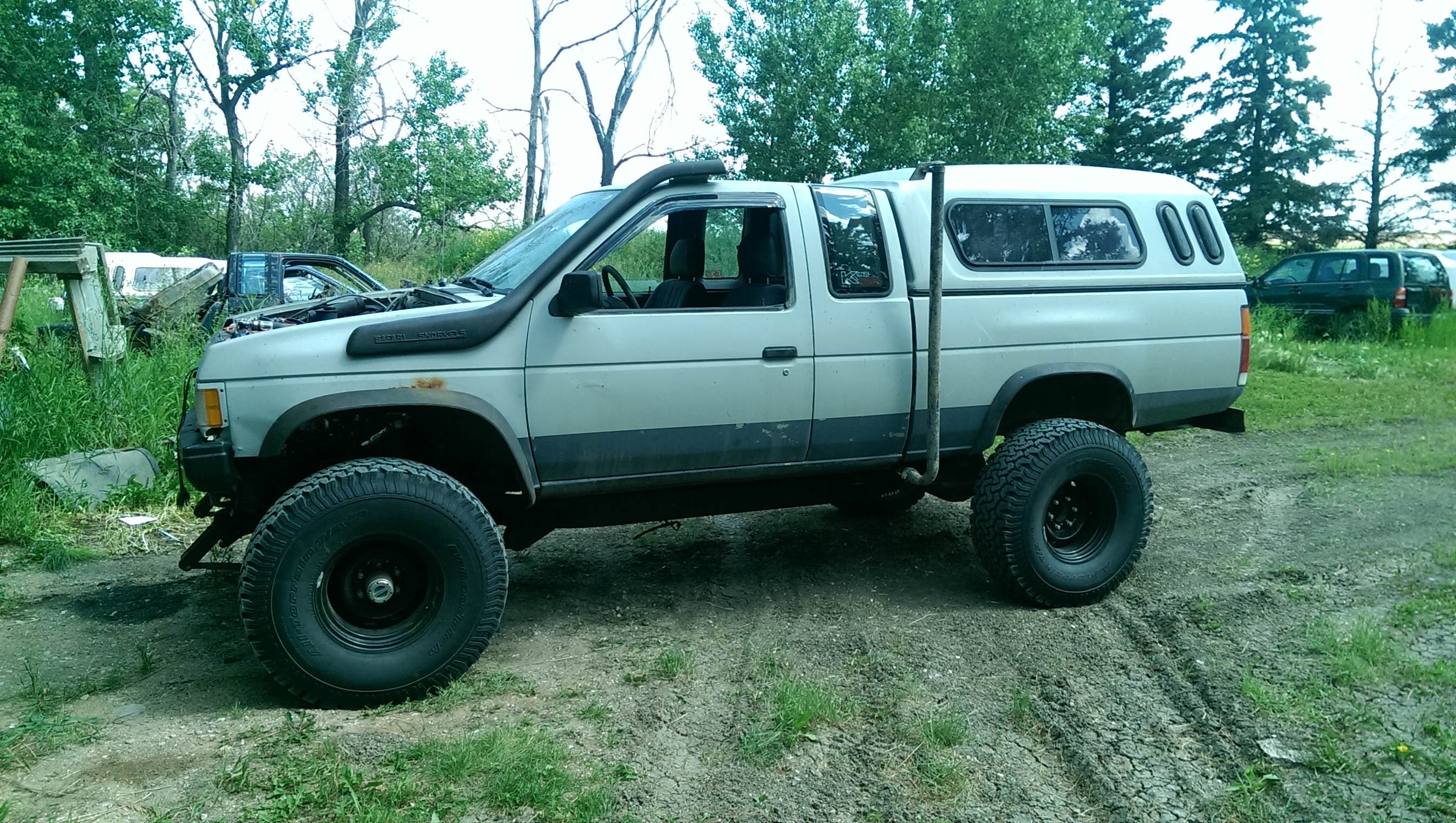

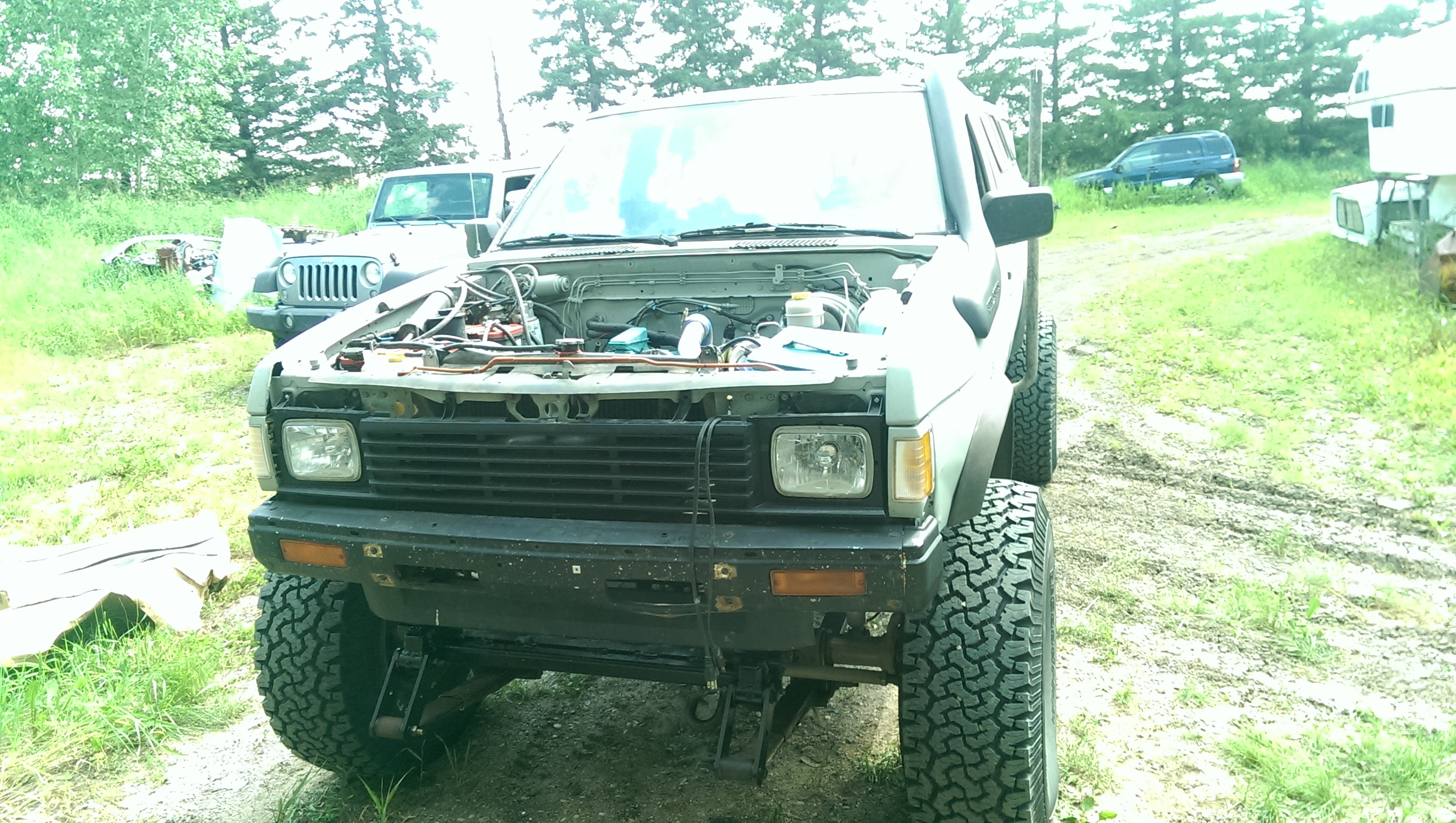

got the motor in and bf 35's on
everything is installed

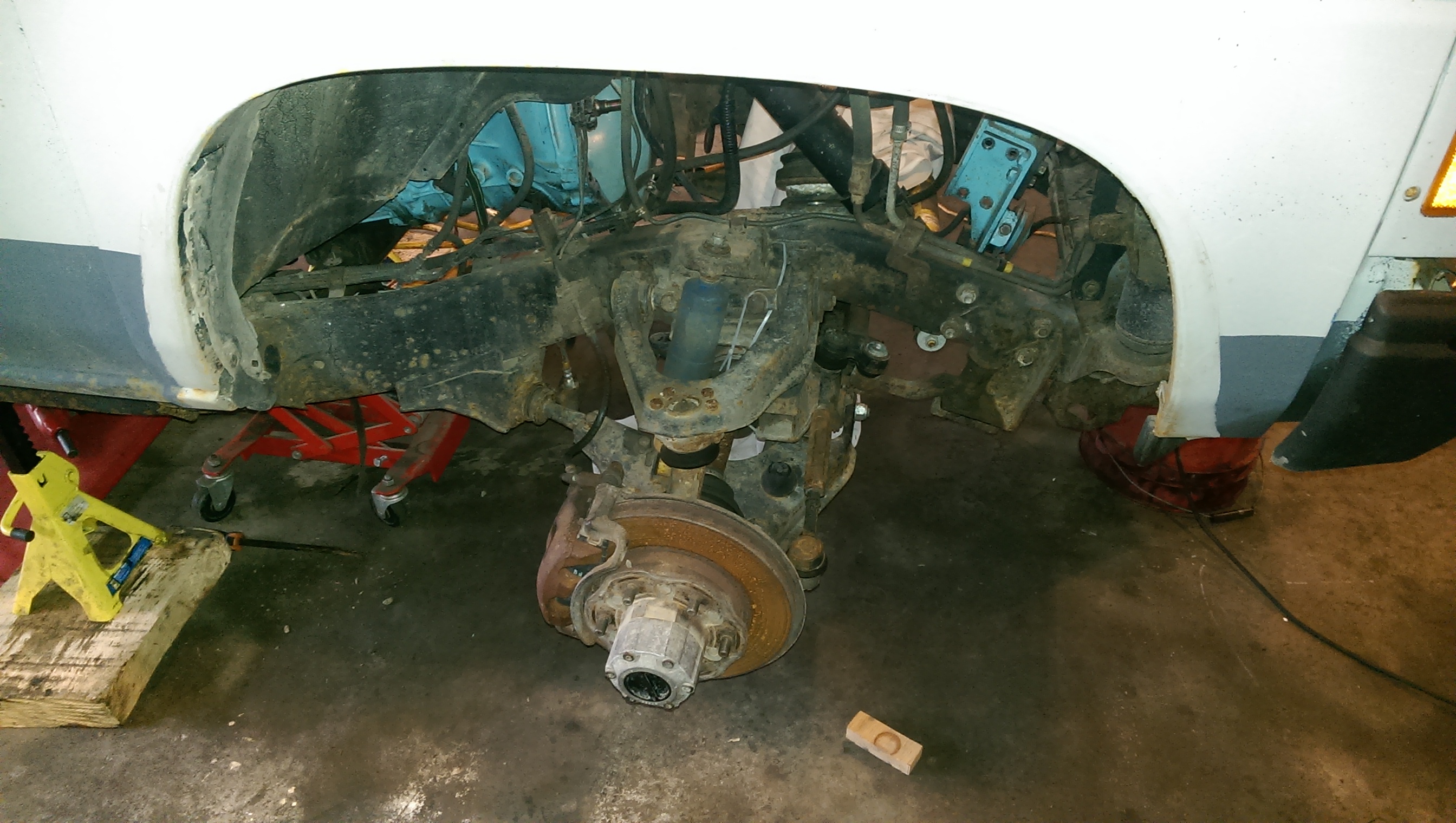

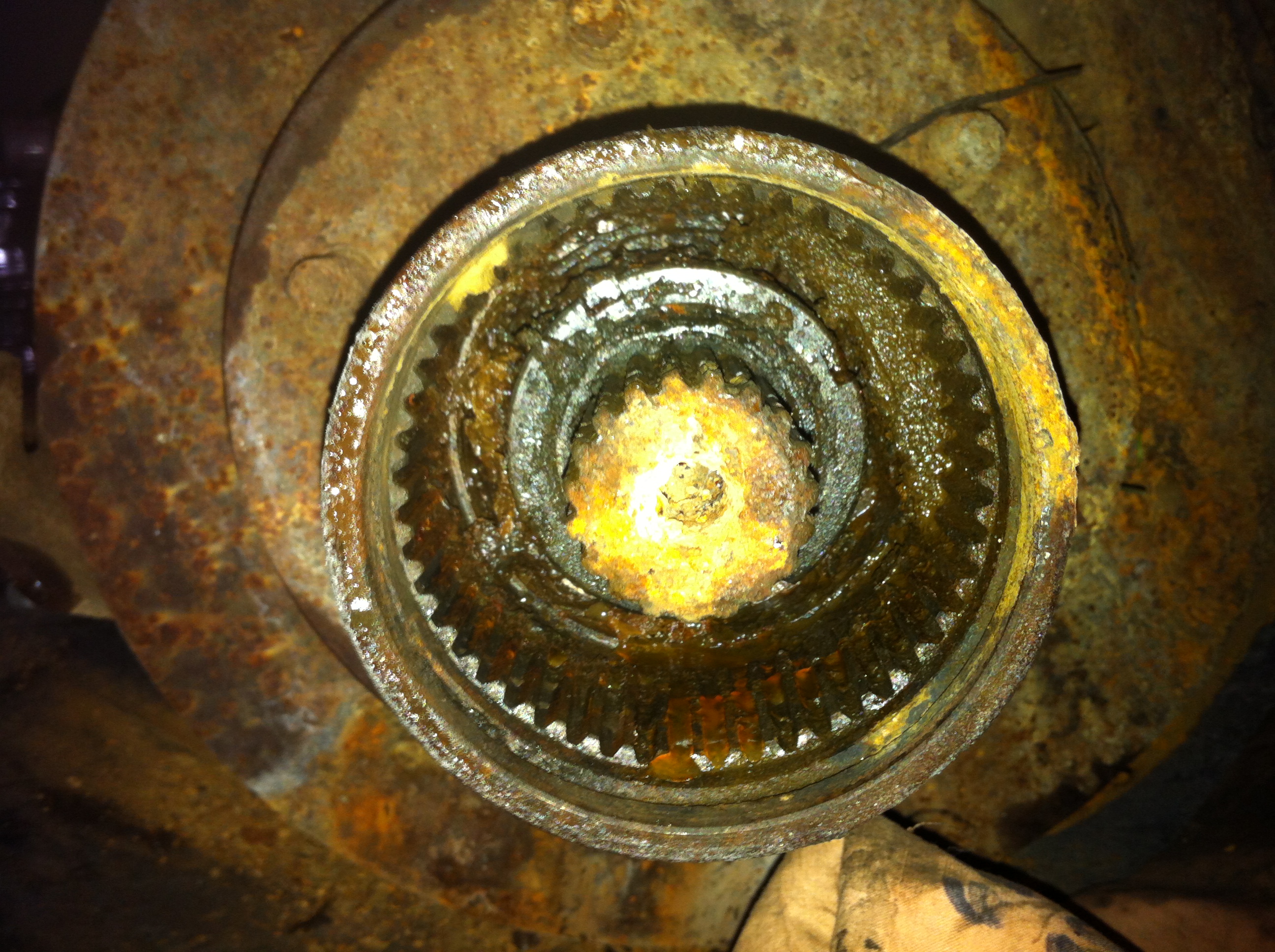

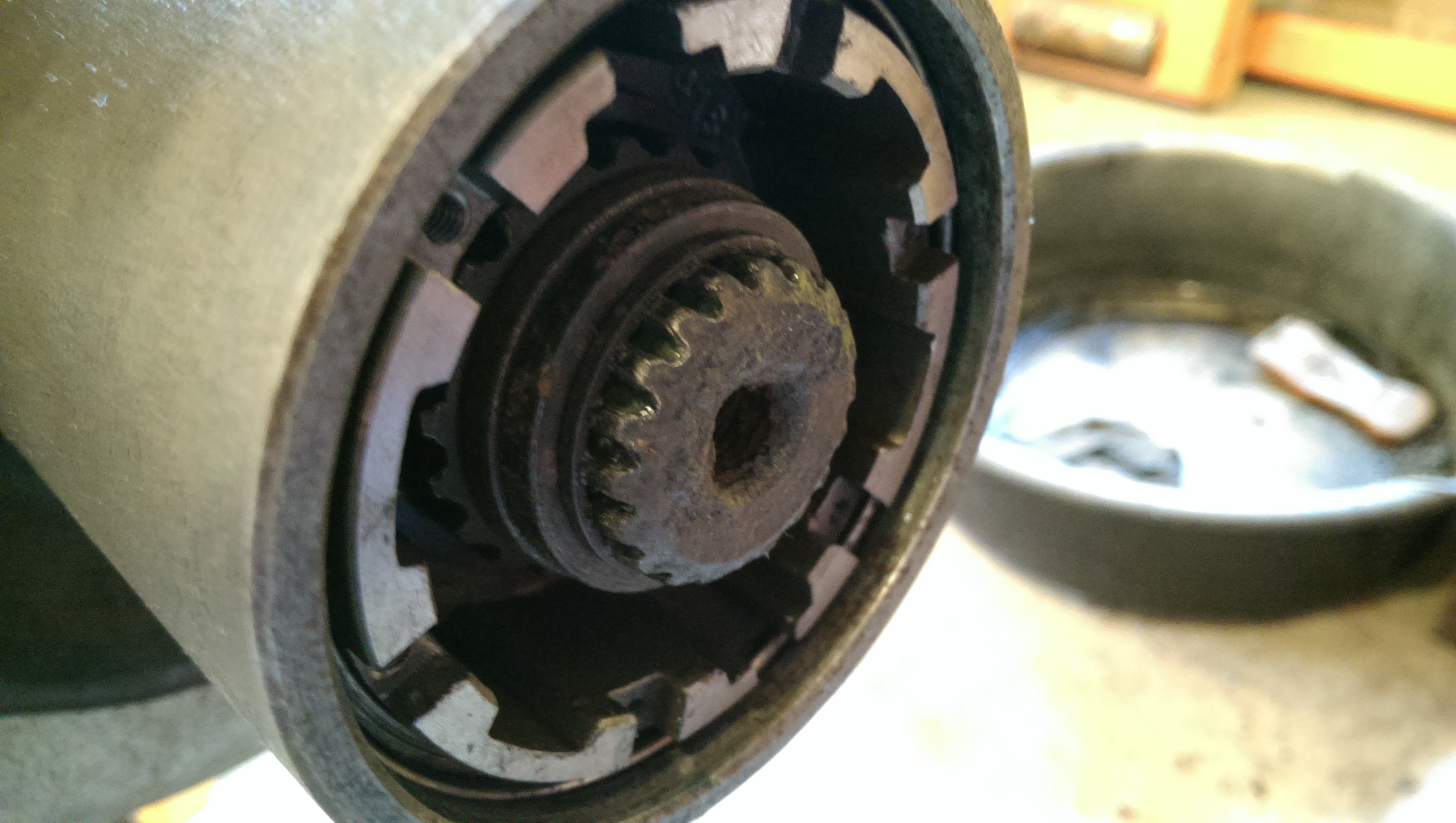

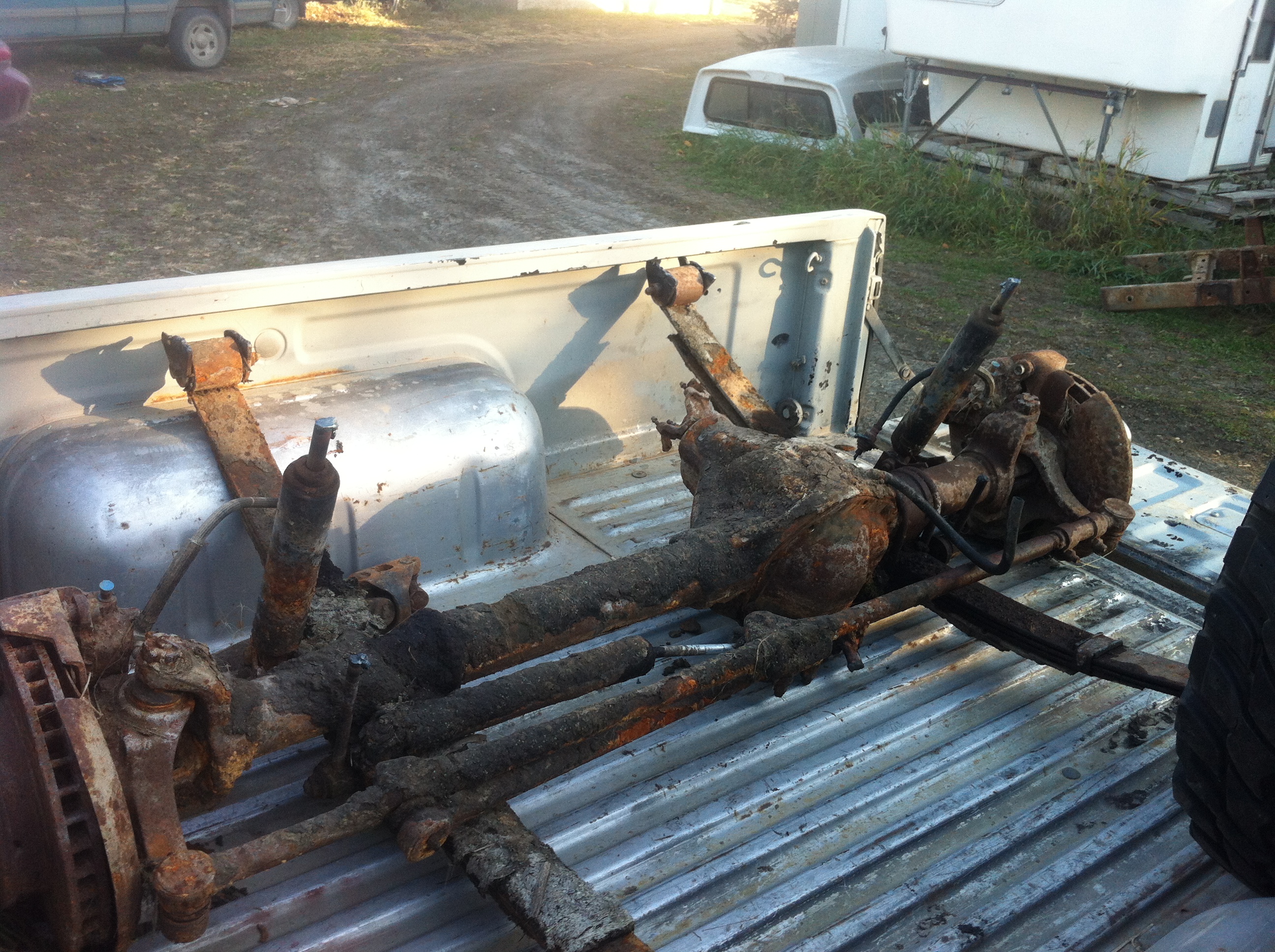

heres some shots of the front dana 44 as I found it. Got it from a local junk yard who had it sitting partly in a slew for better part of 15 years. just about everything from the knuckle out was junk from rust. ended up using spindles and hubs I foundin the junkyard on an 87 chevy 1500 4x4 with gm10 bolt up front. the "c" out on these are dana. so I got some clean spindles that had a nice seal surface, flat top knuckle, some random axle spacer hardware and a set of super winch hubs for 50 bucks. so that solved all my issues with rusted our spindles on the jeep axle. I put on new brakes, pads, seals, and calipers got reman for 35 bucks each. I left the inner spindle bearings that where in the gm spindles as they were in nice shape as well as the wheel bearings. I also installed new ball joints and axle seals. After looking at the cost of the swap and the availability of parts. I wish I would never have spent the cash fixing the front end in the truck the first time. even with the locker if I had swapped to the stronger r200a front axle and gotten cv axles. I would have maybe spent 500 less. and I would still be dragging the truck through everything needing more lift even if I could stuff 35s and run them with the r200a. now i can just get lift springs and i get more flex. plus i can roll under the truck now and take my oil pan off or take the starter out without a bunch of #%^* happening lmao

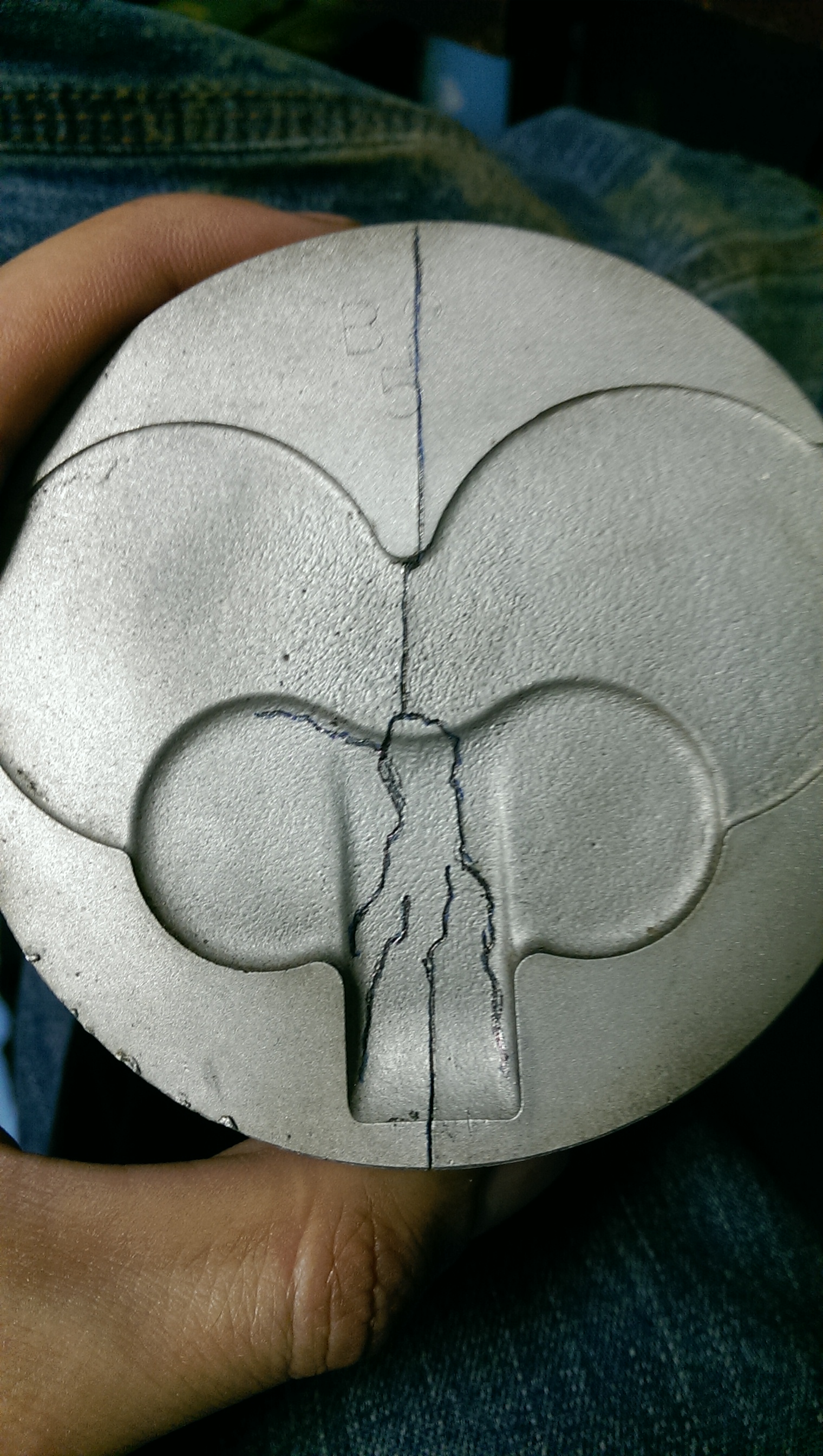

this is why you dont give ether (starting fluid) to a diesel. if you are not extremely carful and dont unhook the glow plugs expect your pistons to look like this afterwards. cold weather is a curse of idiots with diesels out here. if it doesnt start when its -20 call in sick haha

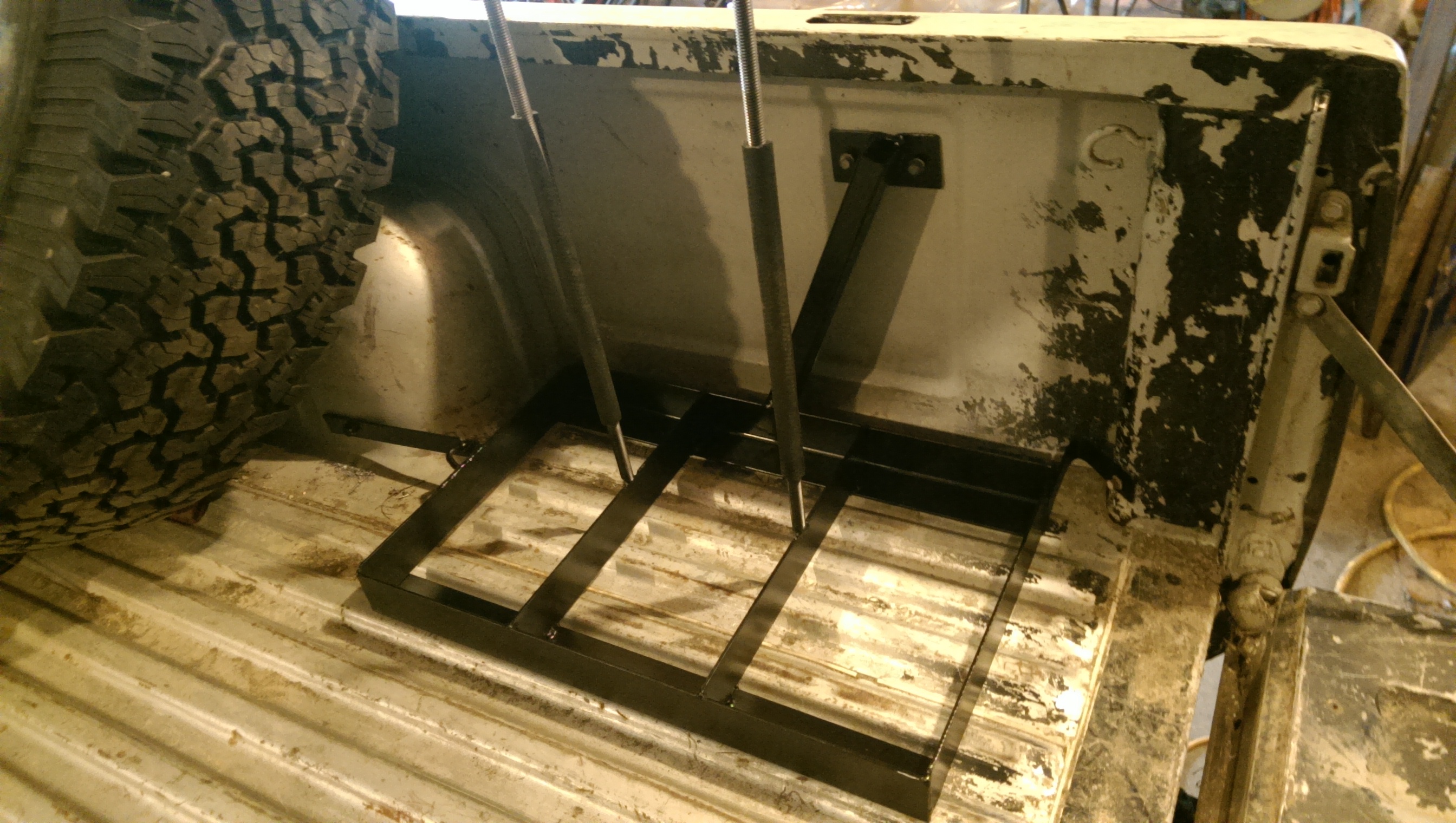

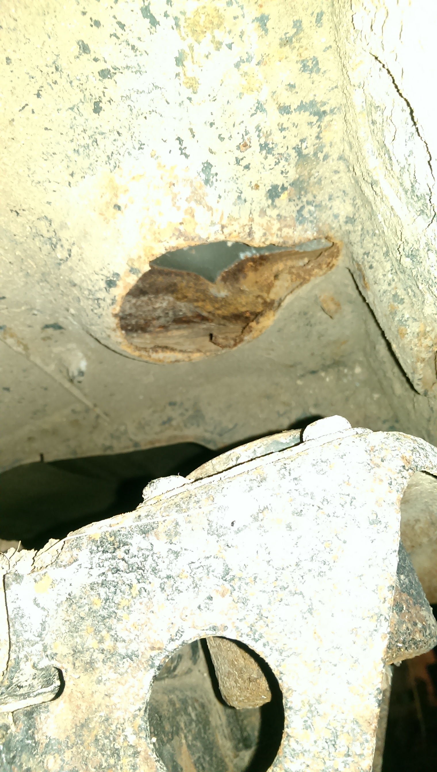

my rear drivers side cab mount collapsed. no doubt because i have like 100lbs of tow gear and air compressor plus me all sitting basicly on the corner
welded a new plate in for support.
painted and looking good.... for awhile lol

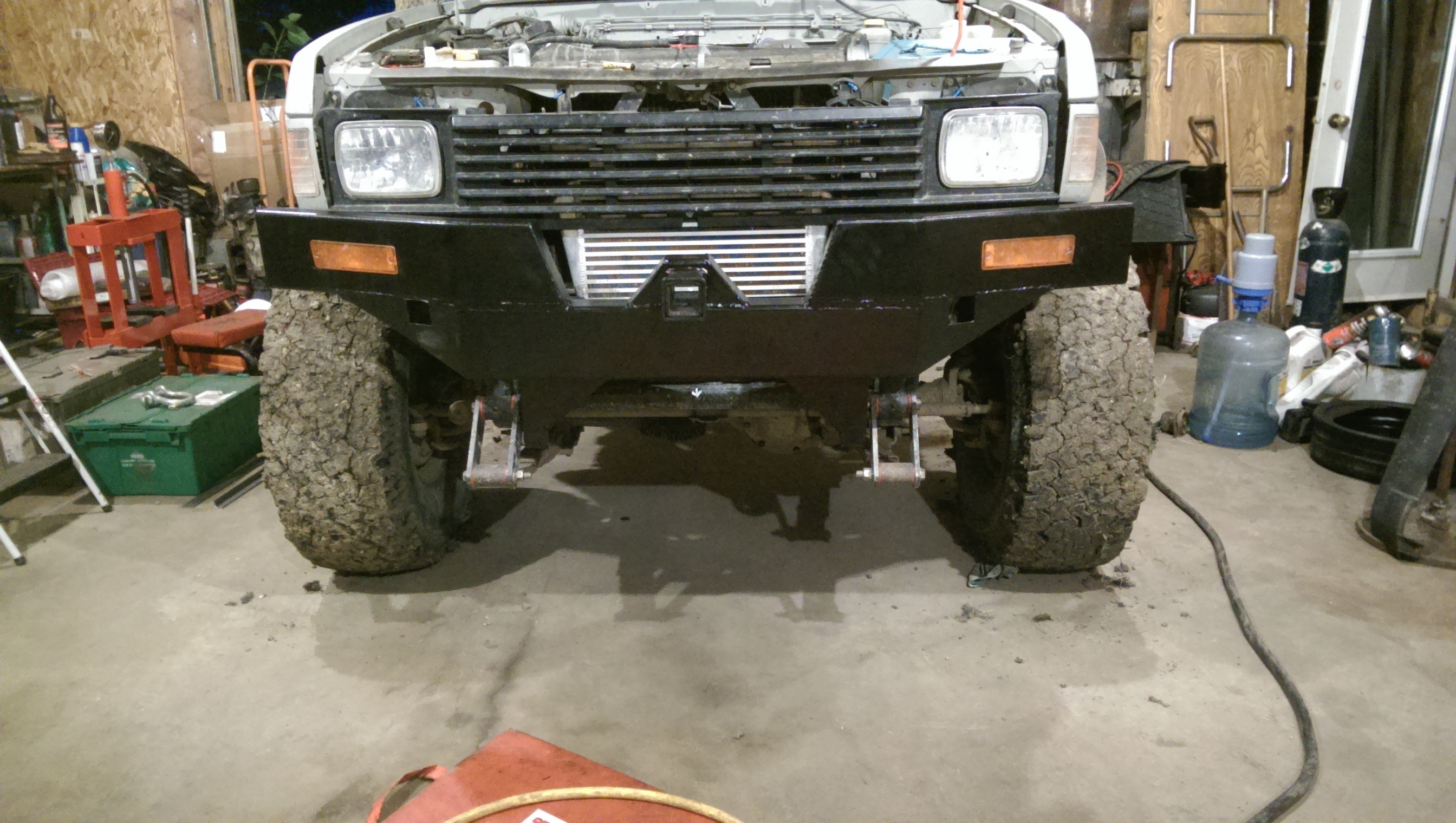

started making a front bumper

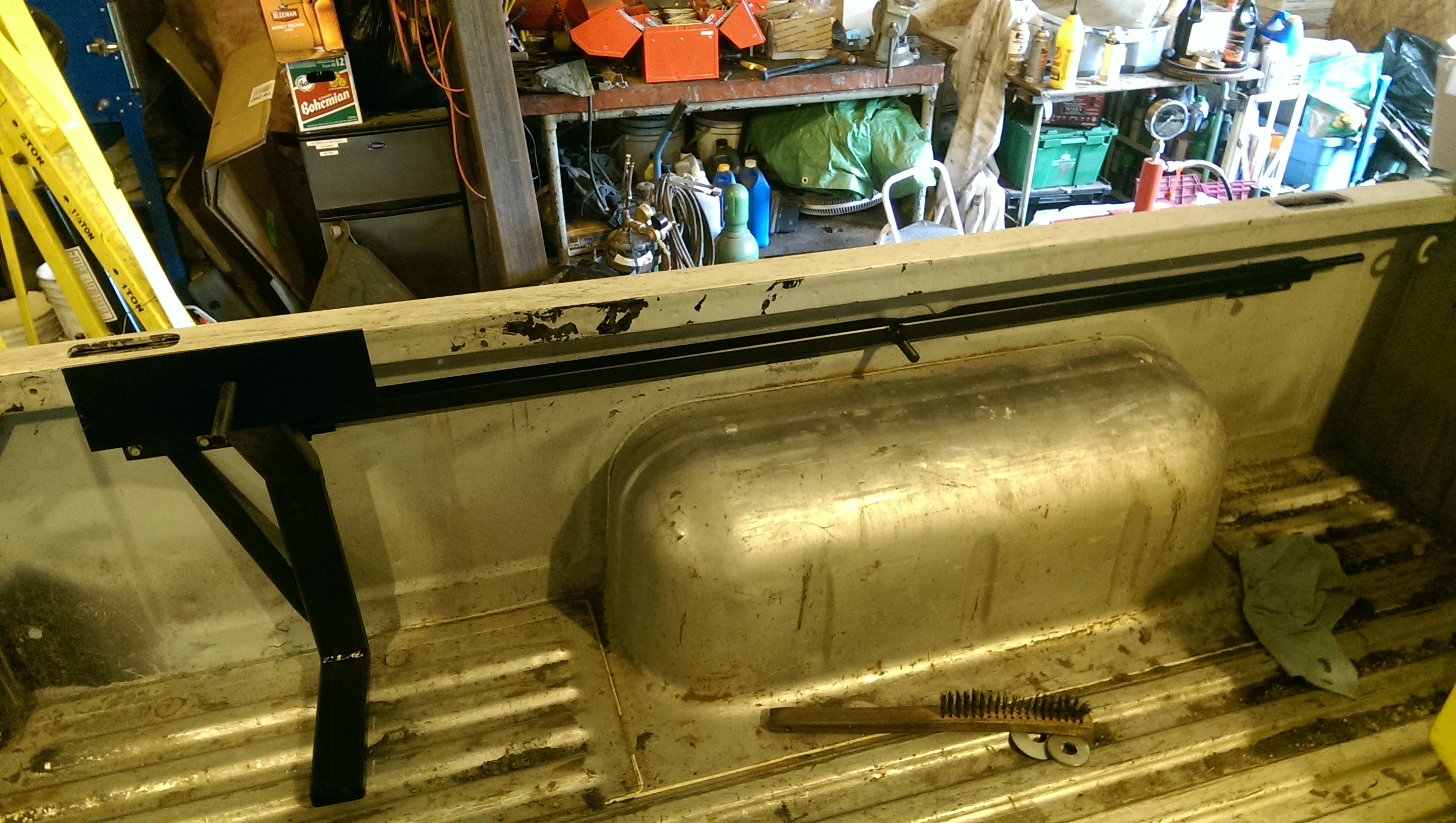

made a spare tire and hi-lift jack mount for inside the bed of the truck

heres some action shots of the beast. took it to waiparous alberta in the ghost lands offroad area and did about 100km of some very nice trail. everything held up awesome. I cant speak enough about how happy I am with diesel offroad. it never misses a beat and the torque is always where you need it. The little toyotas would have to rev up as they made steep climbs or they would power out. the little sd25 just kept on at 2500rpms it didnt give a shit whether the water was part way up the doors, climbing rank hills, or decending down some very steep inclines on very strange angles.

I figured I'd make a quick update. I have added some fuel to the system. I turned the IP fuel screw not quite 1/4 turn. I am again impressed with the results. I have a moderate power gain and I'm seeing my average temp on the egt's drop. even at 5psi and stock fuel I'd peak temp around 1100F. Now I peak around 1200F which should still be in the safe zone. But now the temps drop way back soon as I stop accelerating. I'm doing 110kmh (70mph) at 800-900F which is nice to see. Also around town the power gain is nice I can shift to next gear more often which reduces egt's and rpms. I also see full boost about 200rpms sooner which is also nice to see. So I will turn the screw abit more once I get more feel for the truck and see some mpg results.
I realized also that I forgot to give the reason why my intake valves lost there valve last in previous posts. the valve margin was concaved meaning the valve margin wore into the valve seat. It was noticeable to the eye. Whether it was the valve seats being past hardening or the valve either way they have both been replaced with nissan parts now.
