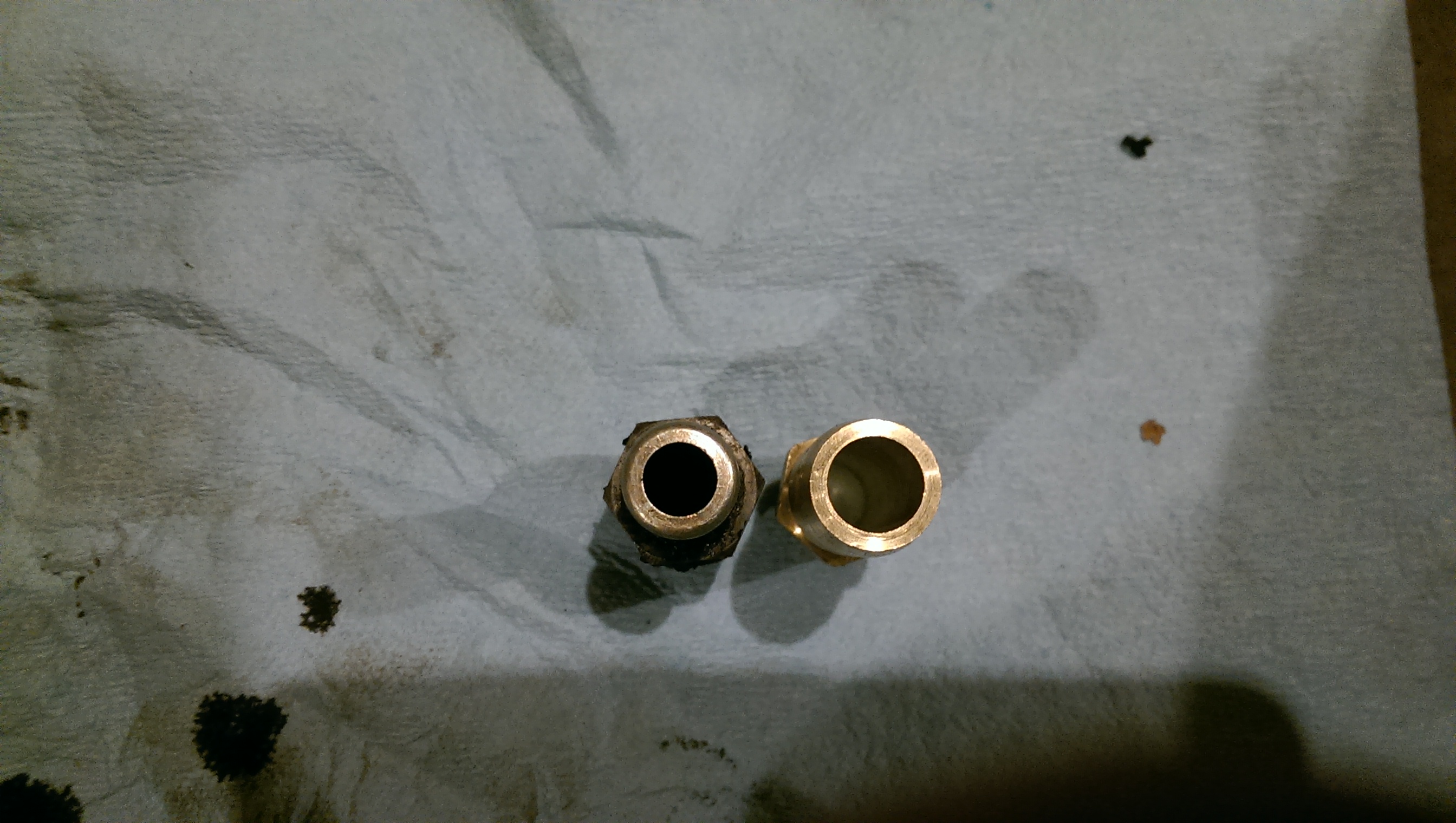

Just a quick update since its been awhile. I update my turbo drain line to a 5/8id hose and the brass fitting is straight through with no bottle neck. This seems to have have helped turbo compressor leak as it is now the least it has ever been. So I stress again the importance of good turbo drainage.
Also after having my fuel screw a half turn. My temps were under control and smoke wasn't to bad but seemed like it was hard on fuel compared to before. Now I'm at 1/3 turn and smoke is good, power is still pretty much the same as half turn according to my butt dyno and my fuel mpg seems to have improved again.

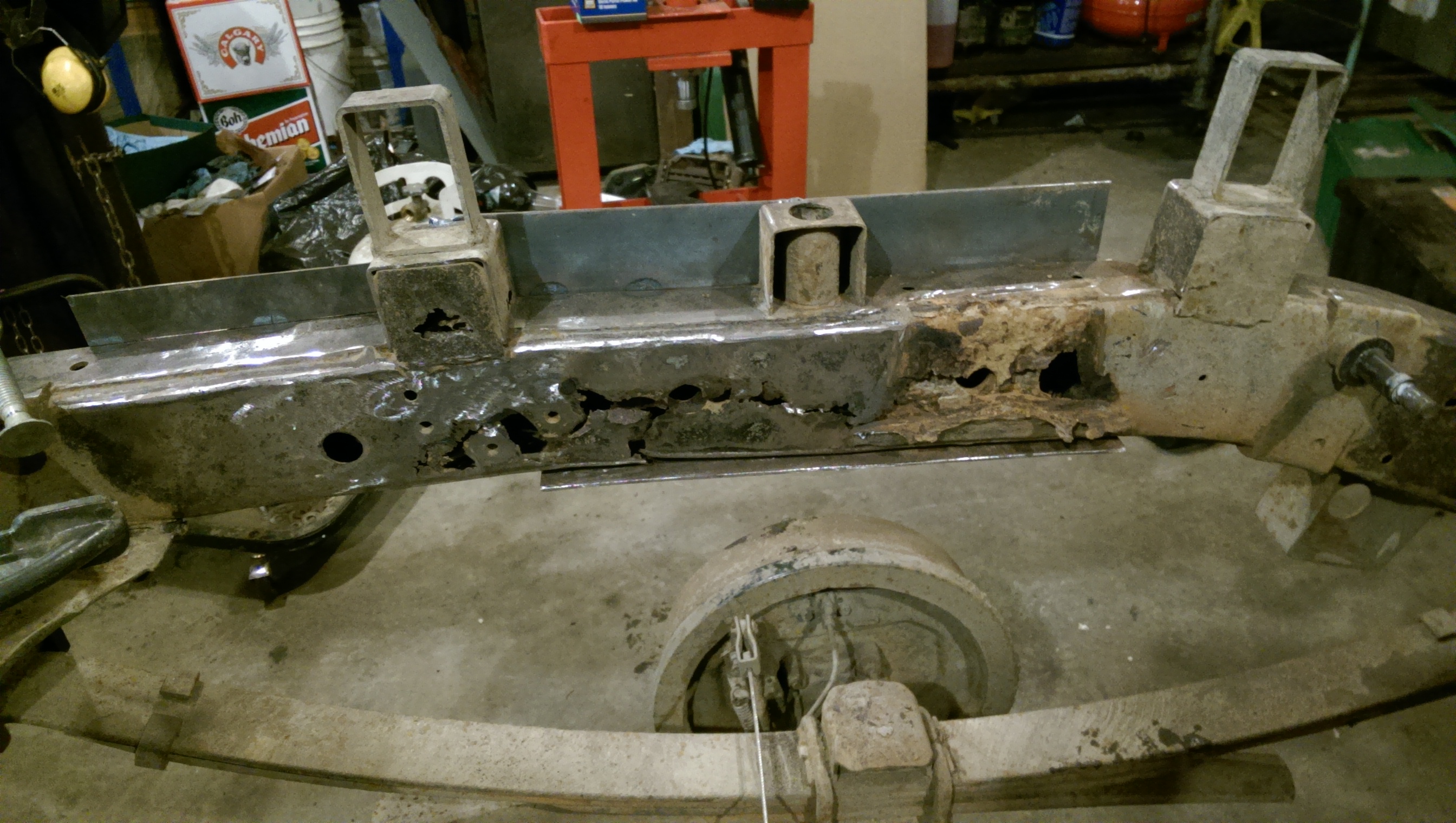

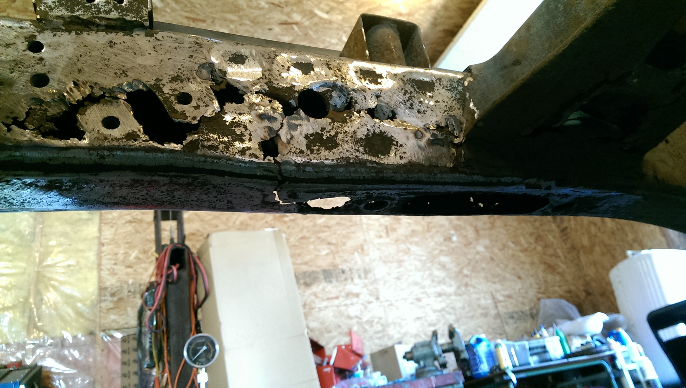

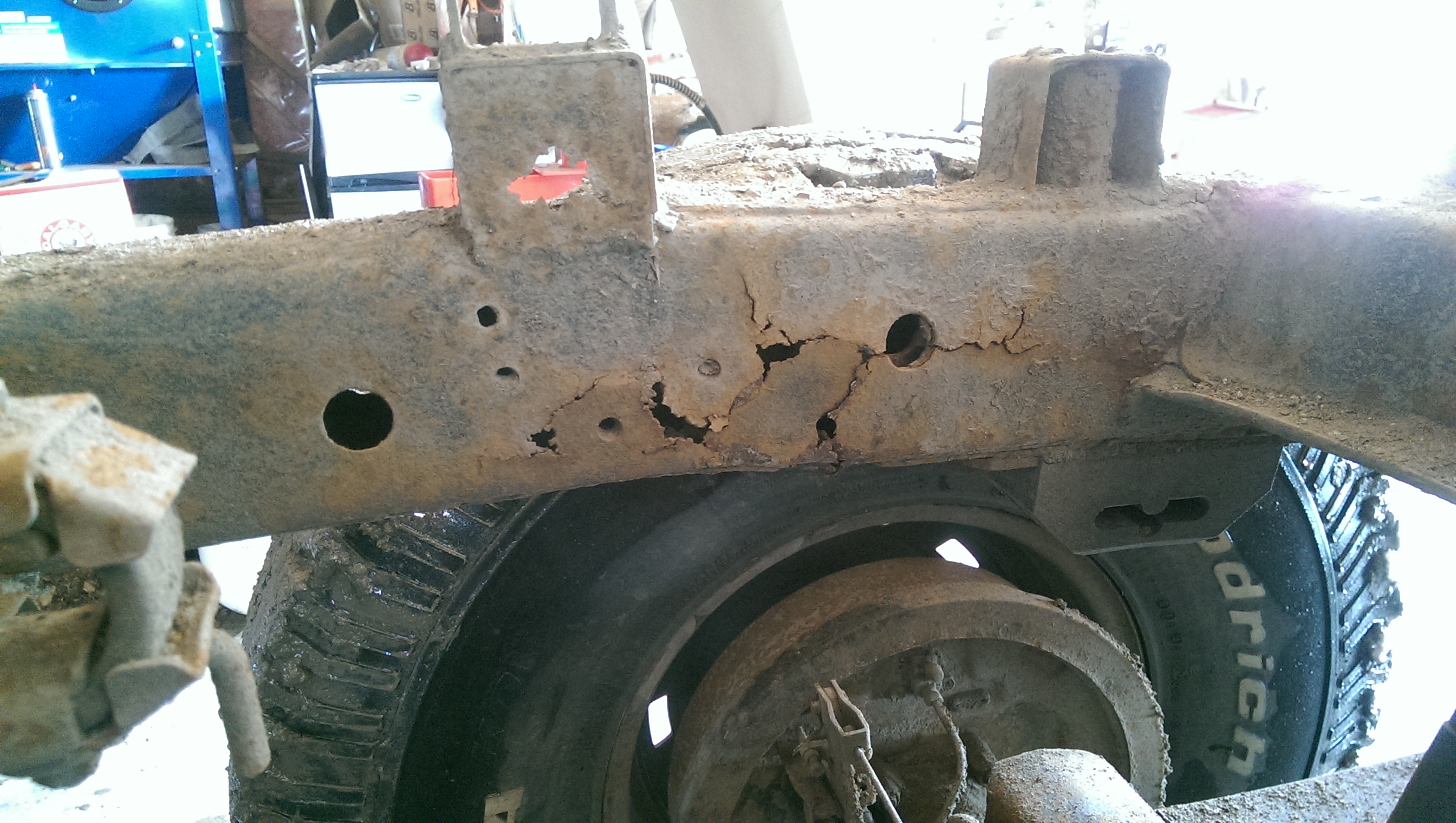

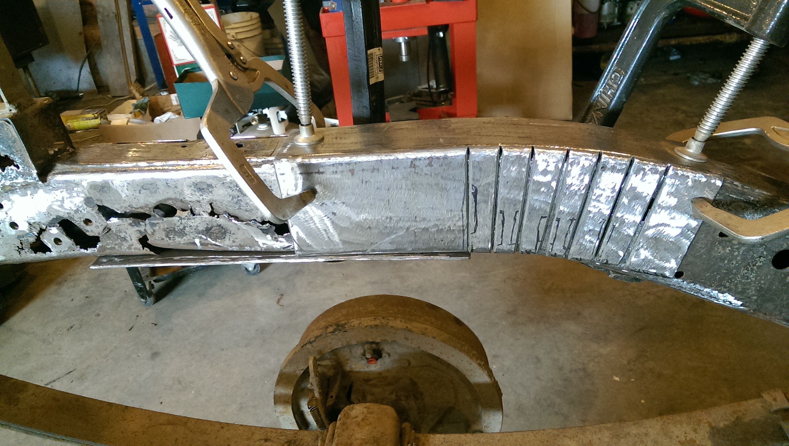

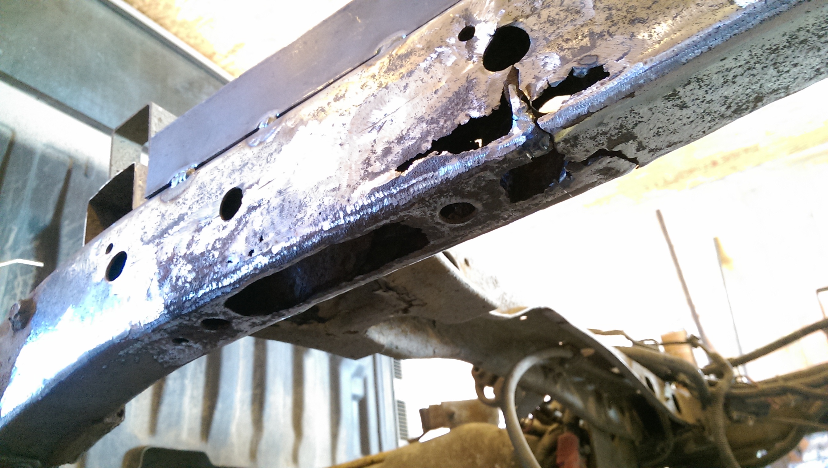

ya that would lead to quappelle valley i guess lol. I have many updates since then! doing that river crossing looks like spelled the end of the rusty frame rails haha
broken frame
broken frame

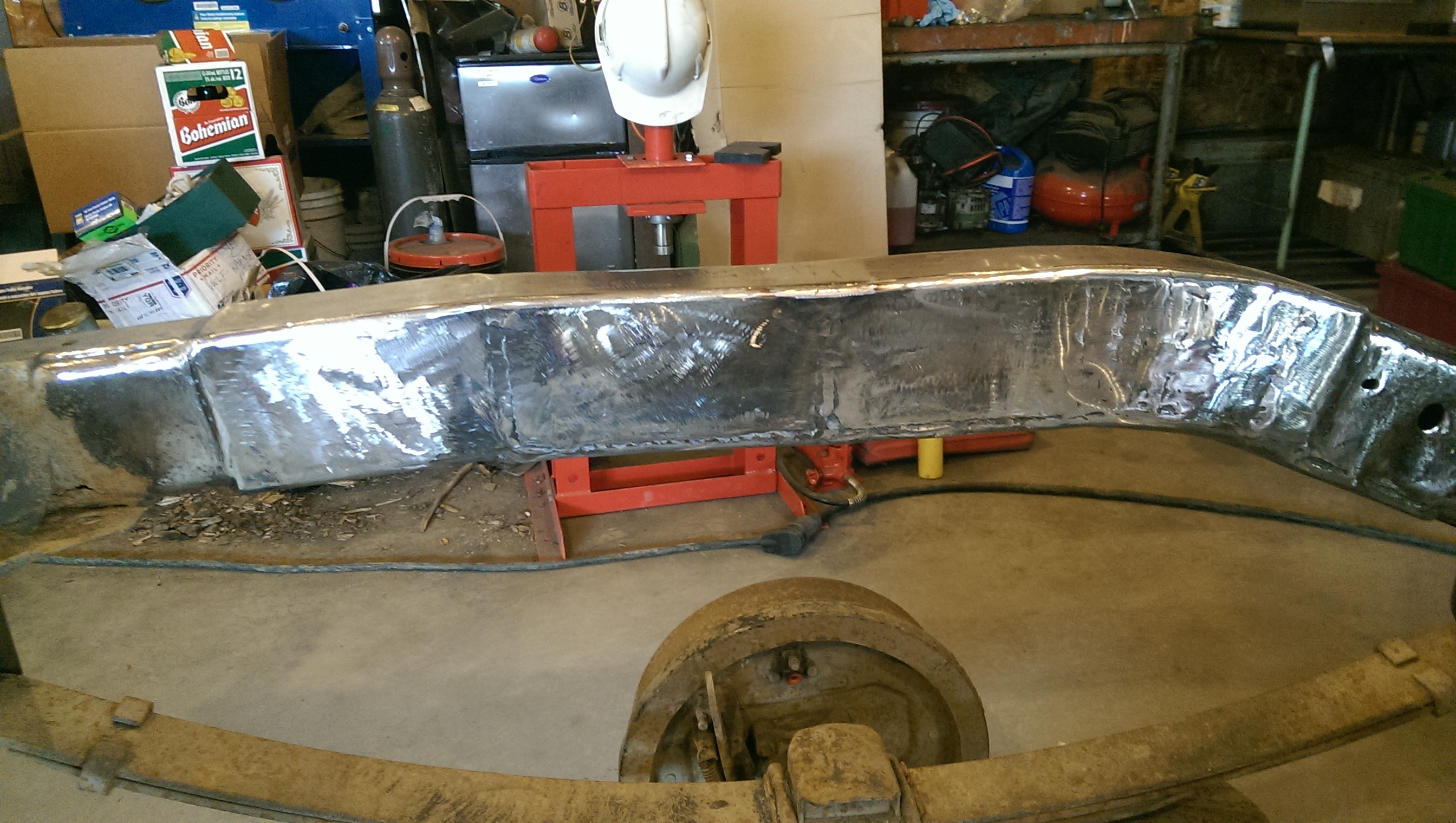

used some 3x4 rectangle tube and cut the seem out

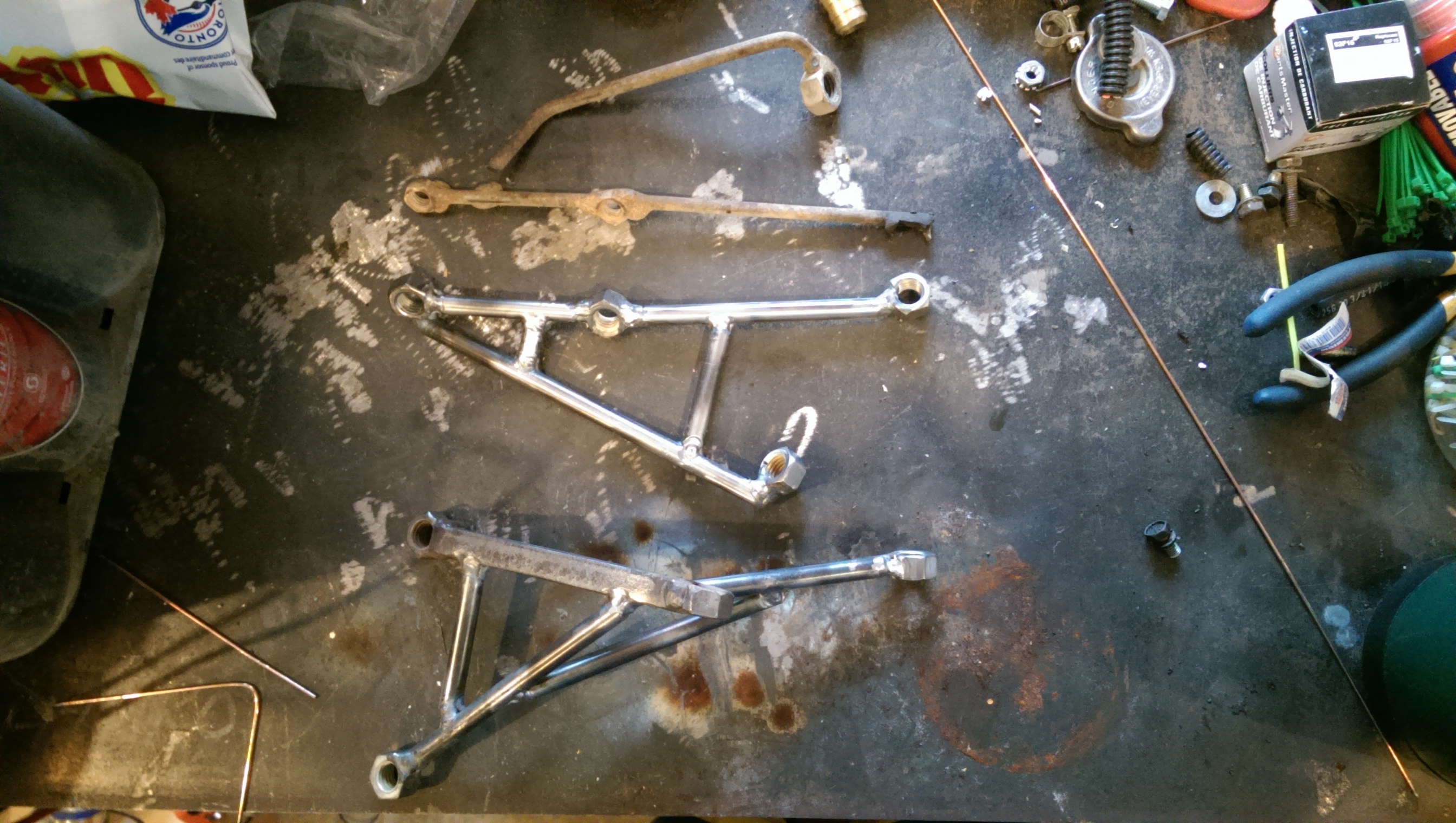

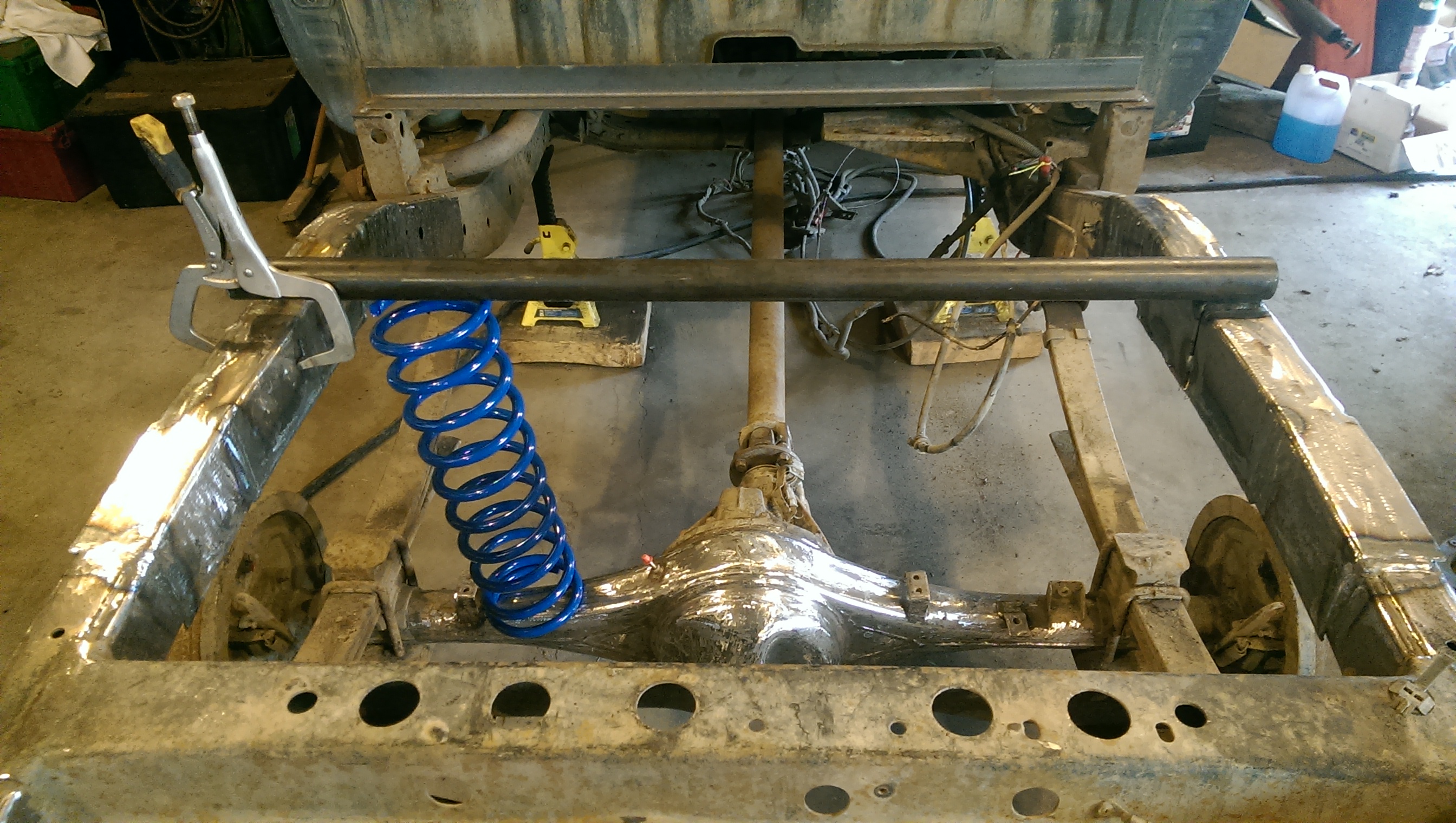

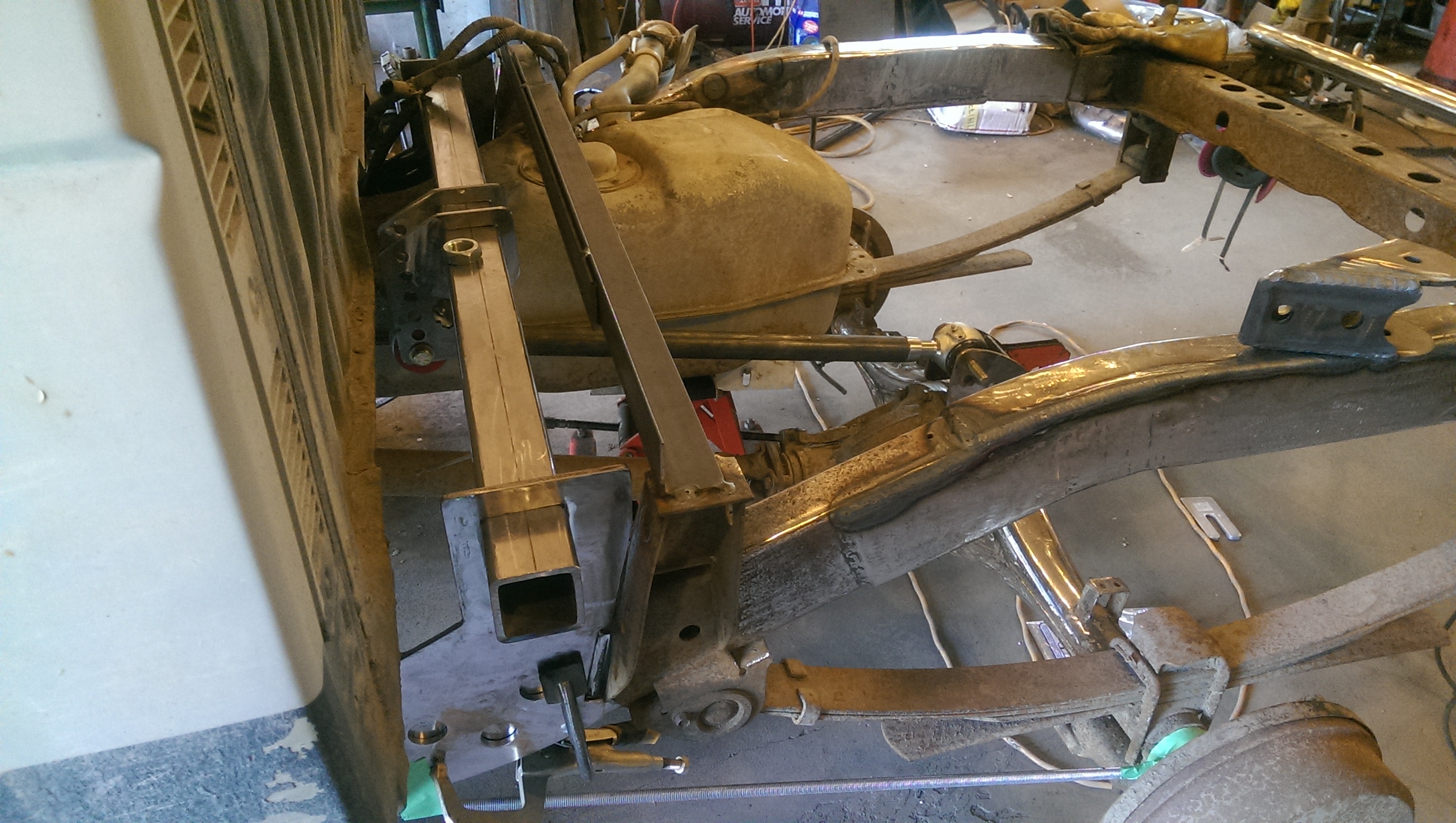

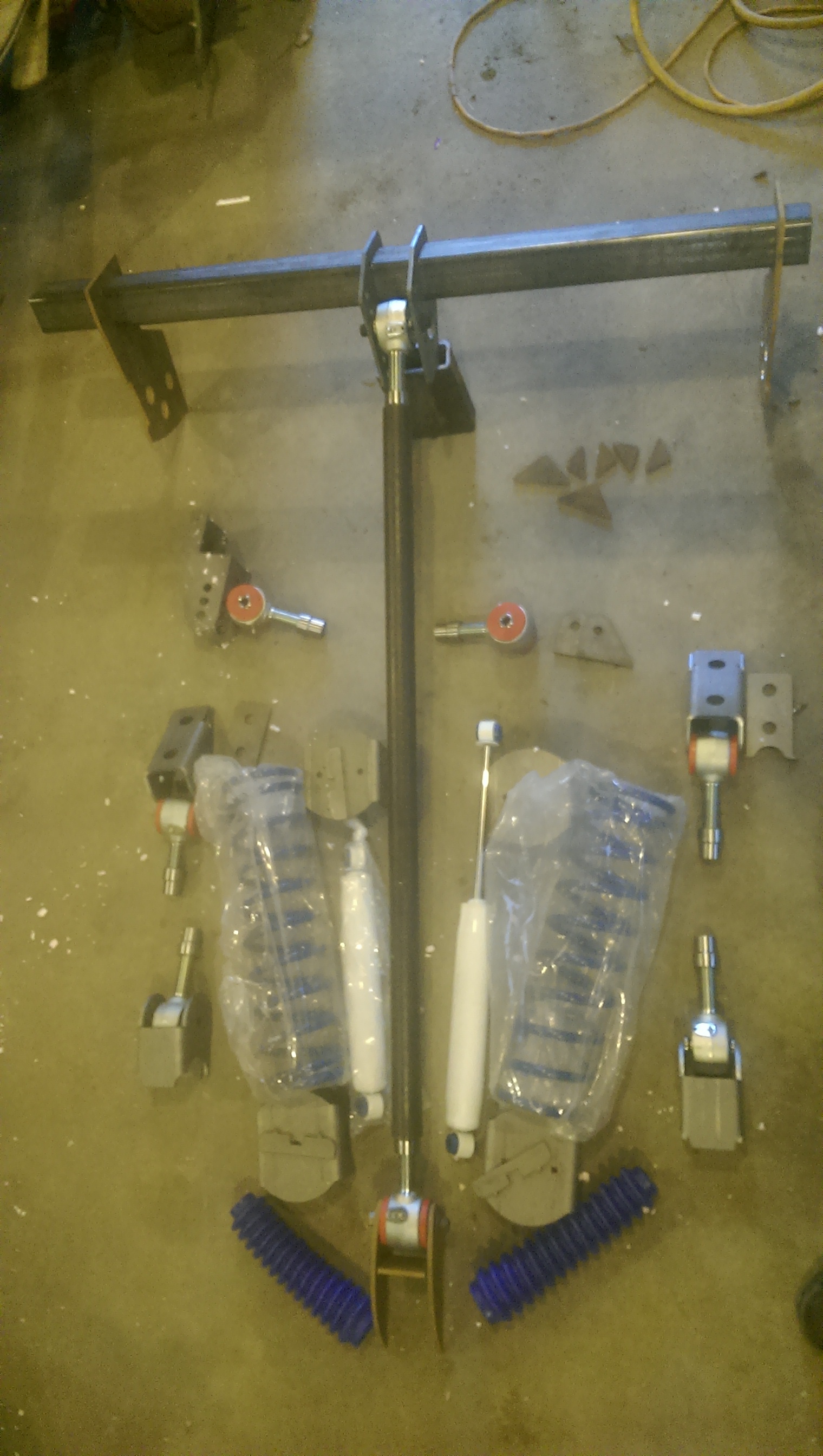

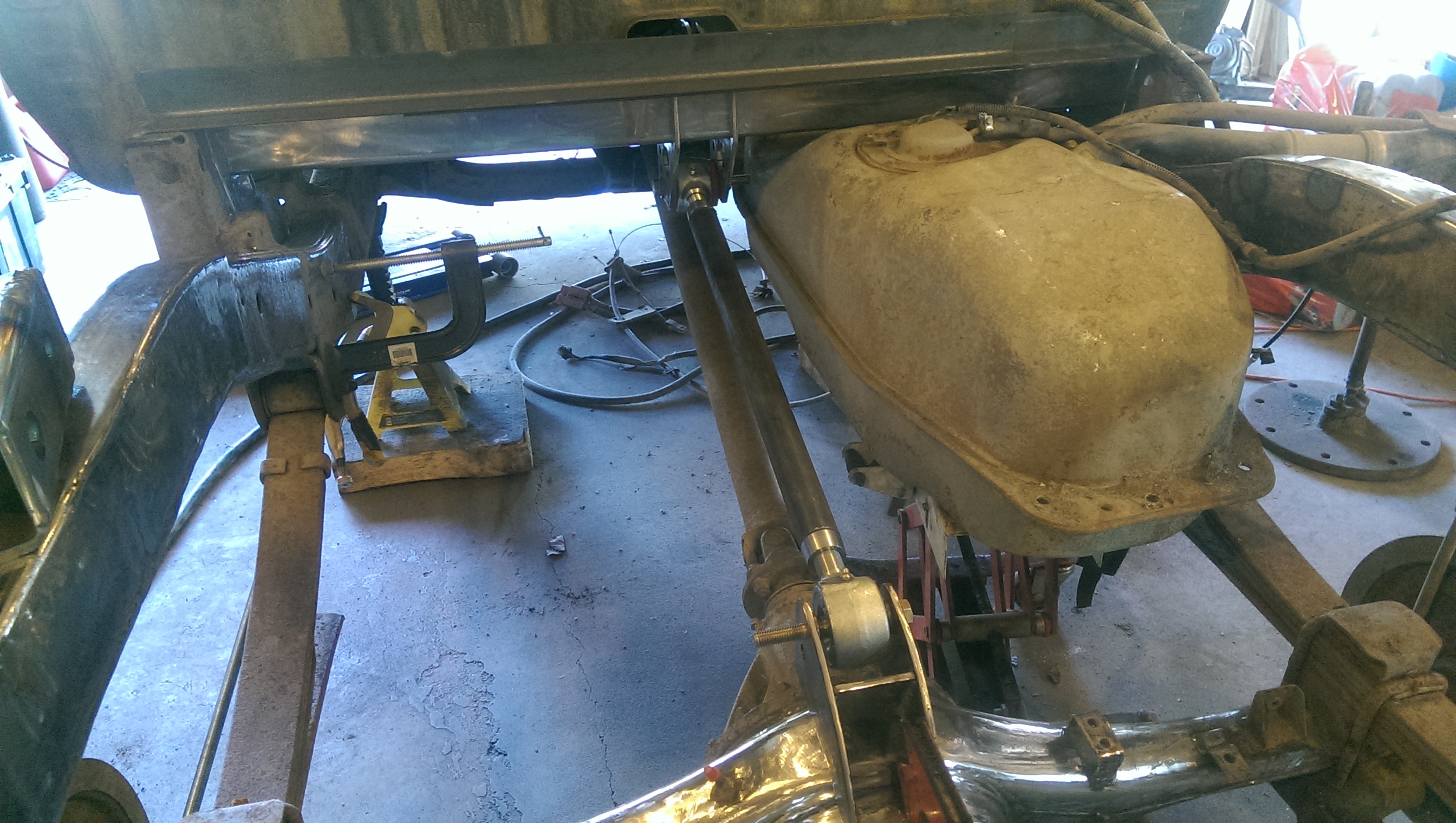

so I decided since I was doing major frame surgery now. That I should probably ditch the rear spring over axle leaf springs which are just punished from those 35s and diesel torque. I was going to install a ladder bar system that I was designing. but after seeing how extensive the rusty frame is. I decided to ditch them all together in an effort to gain more flex and better ride. The 2 leaf stock spring pack isnt really up to any serious job but light loads and pavement driving.
so I have started to design a 3 link suspension system for the rear. I'm doing my best to design this around "self-JIG" design. so people with a welder and little experience with suspension can install this kit.

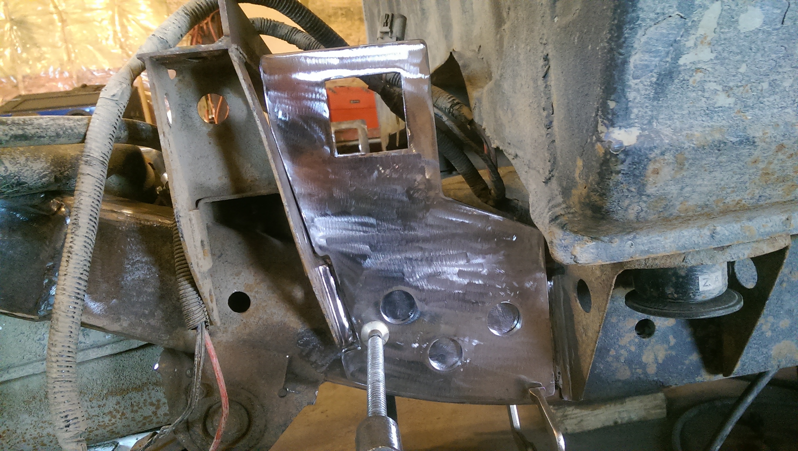

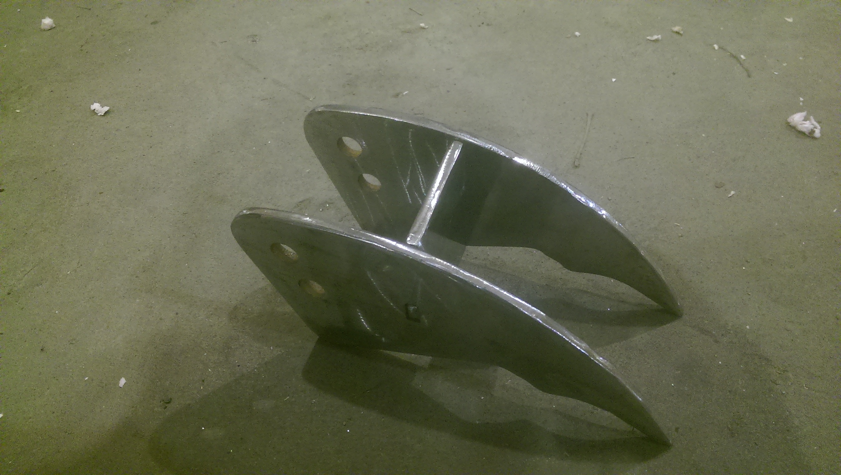

also decide to make some new turbo brackets as my motor mounts seem to be going bad already. the tempo motor mounts cant hanlde the torque loads. when I dropped into the river i think my exhaust touched my brake booster and I broke some manifold studs and turbo brackets.

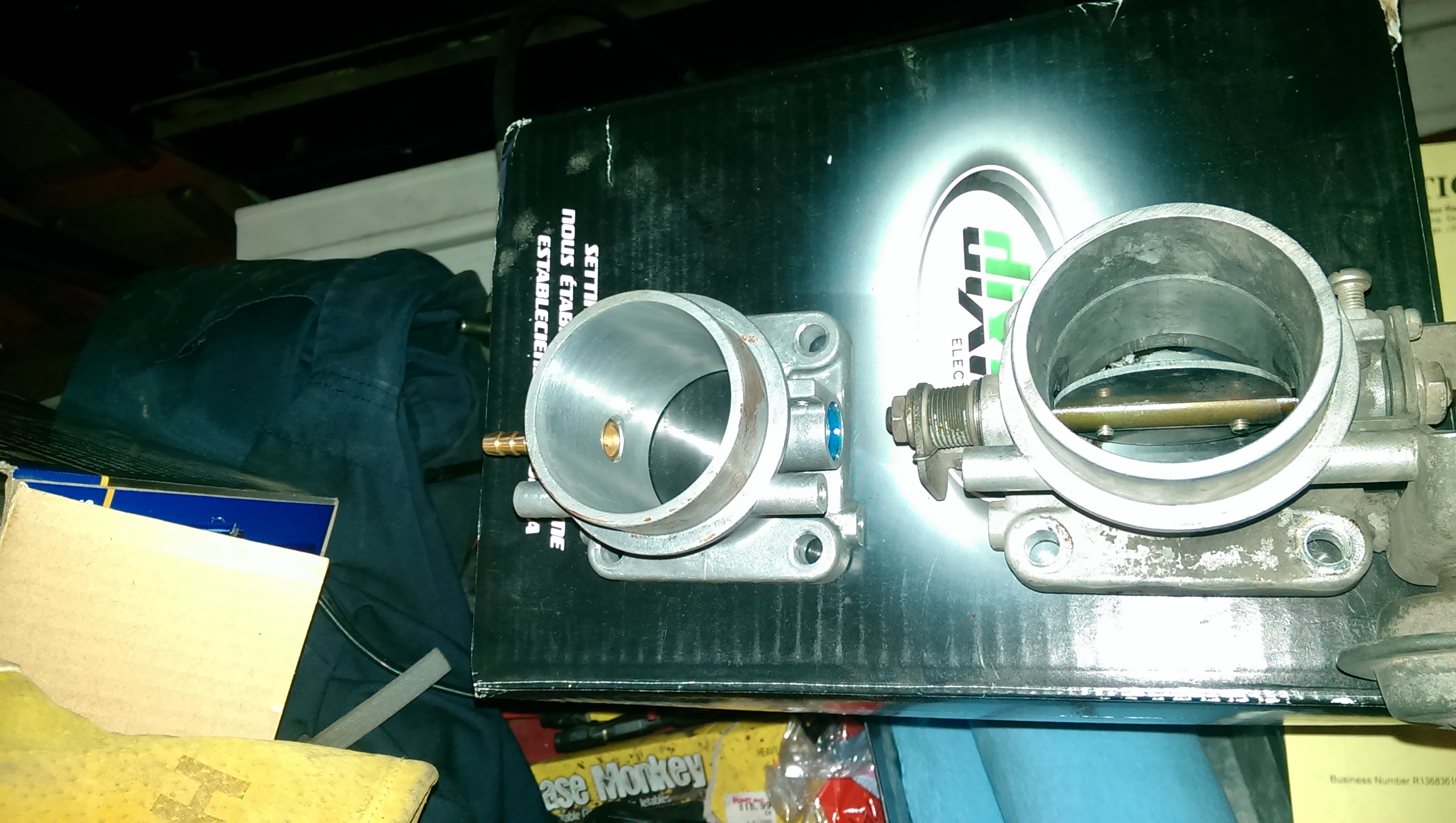

So while I was in there making heavier brackets I decide to ditch my throttle body blade and all its crap, I machined the throttle body out to a full 2". I then used the old throttle shaft for my boost sensor line and possibility of LPG (propane) fogger can be added.
My biggest reason for machining the throttle out and relocating my wastegate line is a couple reasons.
1. intake pressure drop happens after the turbo and its bends. intercooler often causing most drop. and pressure drop means volume change also.
2. in effort to move that "volume" of pressure drop closer to the motor enlarging the throttle body has now given me largest surface area inside the intake manifold. So as each valve opens the "average" pressure drop should be lower in this area due to insreased surface area and volume. so back at the wastegate this should compensate for intake restrictions while also giving me a larger area to sense my boost pressure.
I'm hoping with the throttle body modified this will again improve my boost performance in lower rpm.
1/2in drain from alternator I was using for turbo drain. beside new 5/8 drain

if anyone is still reading this thread. the suspension works great. very stable and far exceeded my expectations for handling for no sway bars on a tall truck on highway and hard corners. suspension seems to flex and take everything in stride very nicely.
on 2.5in lift rancho leaf springs up front
