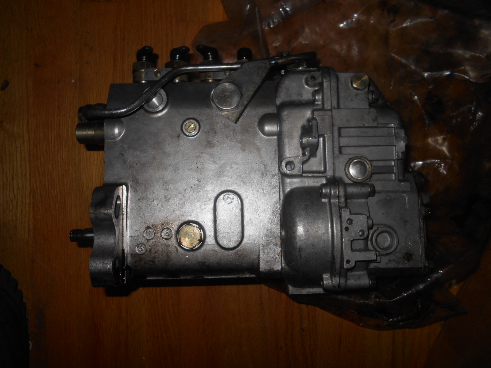

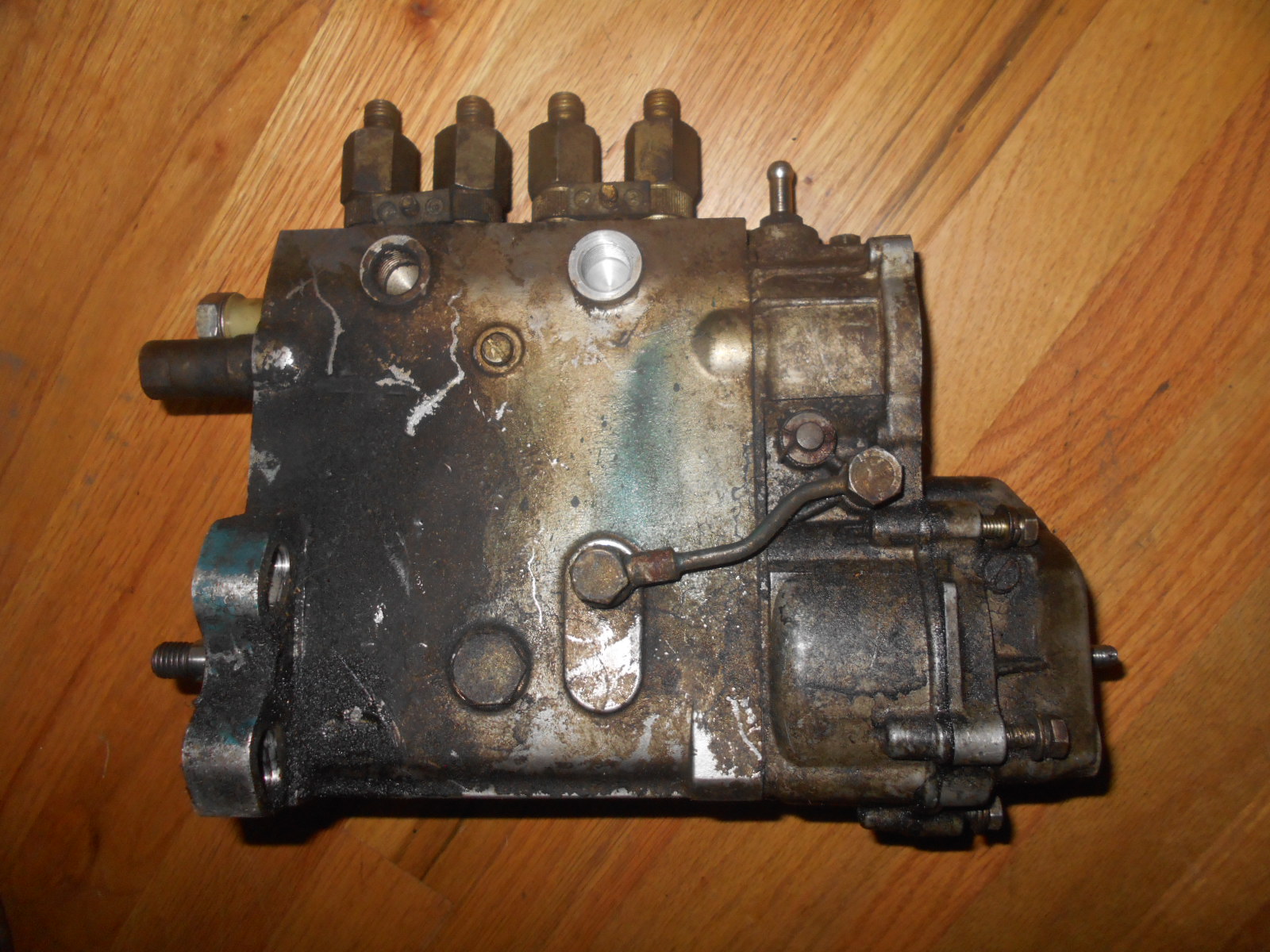

So I remembered this morning I have this other inline injection pump set up for a boat, compressor, water pump, I could not get it to run properly on my SD25 in the 720, I thought what if I change the back half to the vacuum style, so I pulled it out, the front looked the same, but the back is missing an oil port/line that the automotive engine type injection pump has, does anyone know what that oil line does/lubes, can I use the pump without it?
I cannot get this site to load a photo for some reason.
Here is the new injection pump without the oil line or oil port. Here is the injection pump that has the oil line/port.
