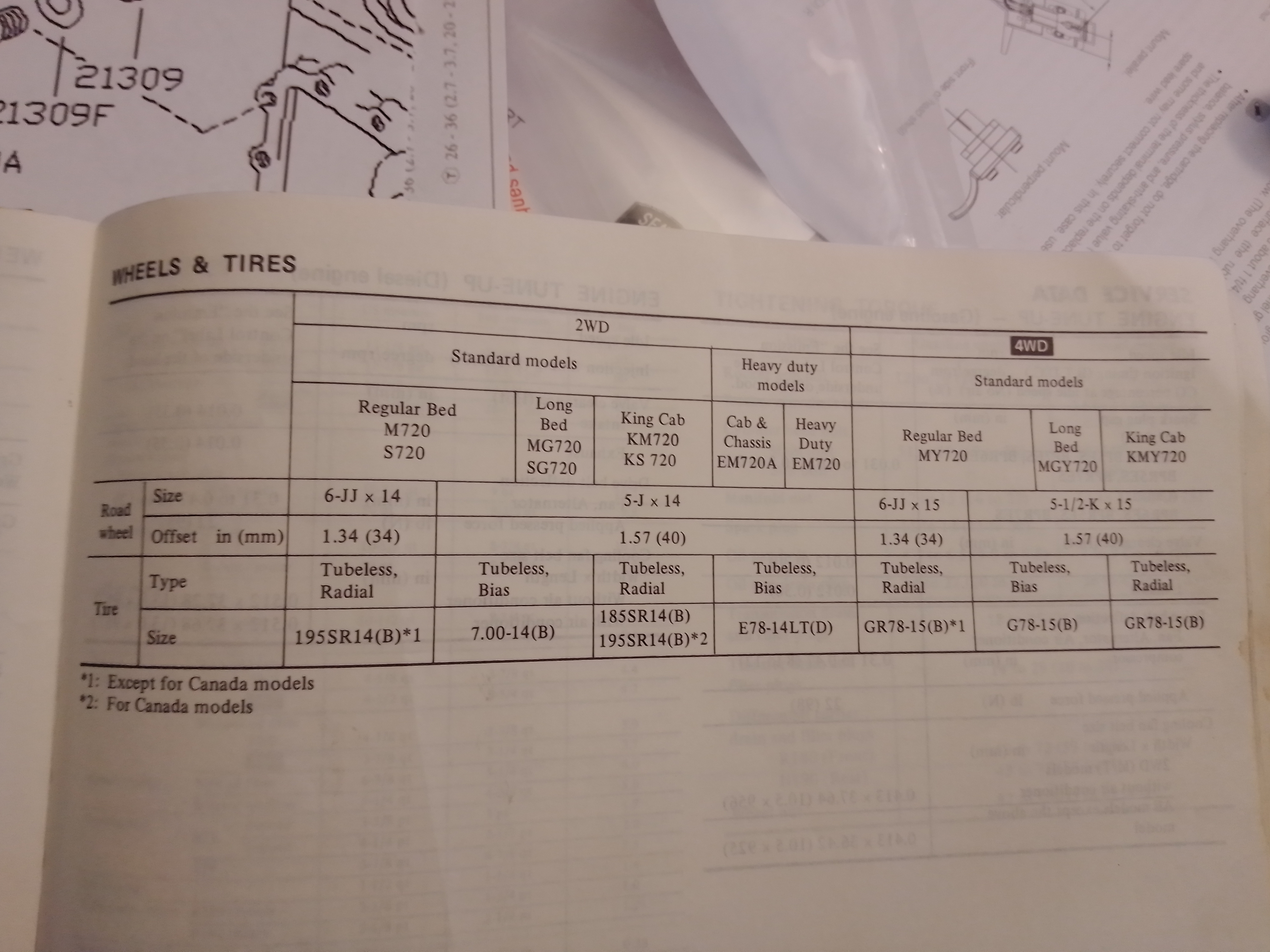

Re: Wheel & tire questions
Heres a picture from my manual. Pick your model!
- IMG_20191124_134445[1].jpg (2.19 MiB) Viewed 35352 times
