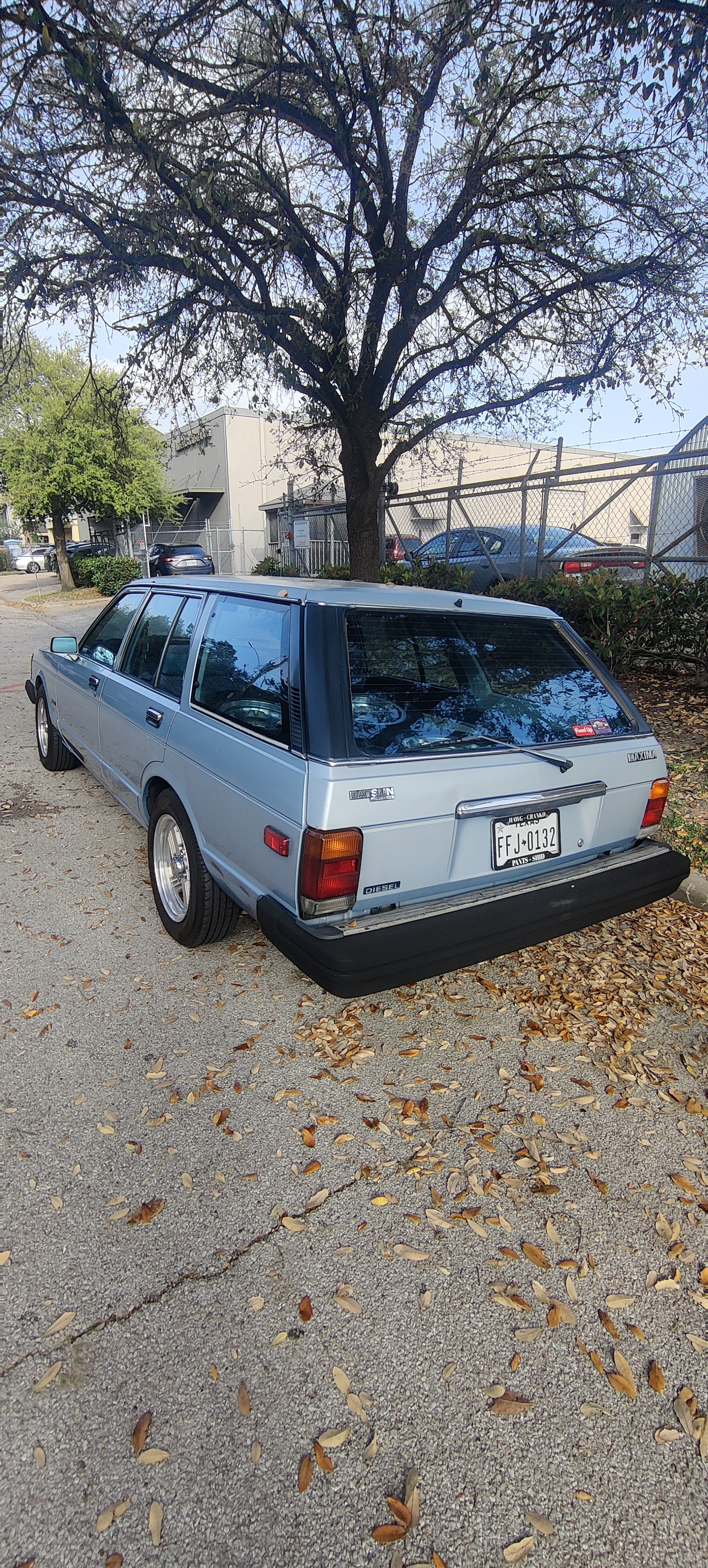

I decided to post up my "New to me" rig in here. I know I am late to the party but I have been wanting this specific vehicle for 5 years. I also own a 1977 280Z (Which I will NOT be taking the V07 Crank).
I just finished doing the IP pump belt and tensioner, all the belts, coolant flush, and suspension refresh.
This car was originally a Austin Texas Car (currently I am in Houston). The mileage is 253k but the odometer is questionable and bouncy. I was informed that the LD28 in my wagon was replaced in 2011 with a NOS longblock (The engine serial isn't correct so I can see that)
The first owner definitely loved his maintenance as I was provided a box full of NOS stuff ( GP main relay, 3 GP resistors, fuel filter water sensor, 3 OD switched despite having a 82', and more misc)
Overall, I would love to do the L4N71B swap if I could even source the diesel one. I also plan on putting a tach in with the tach mod. I just want to keep this tank going for as long as I can!
My 1982 Nissan Maxima Diesel Wagon

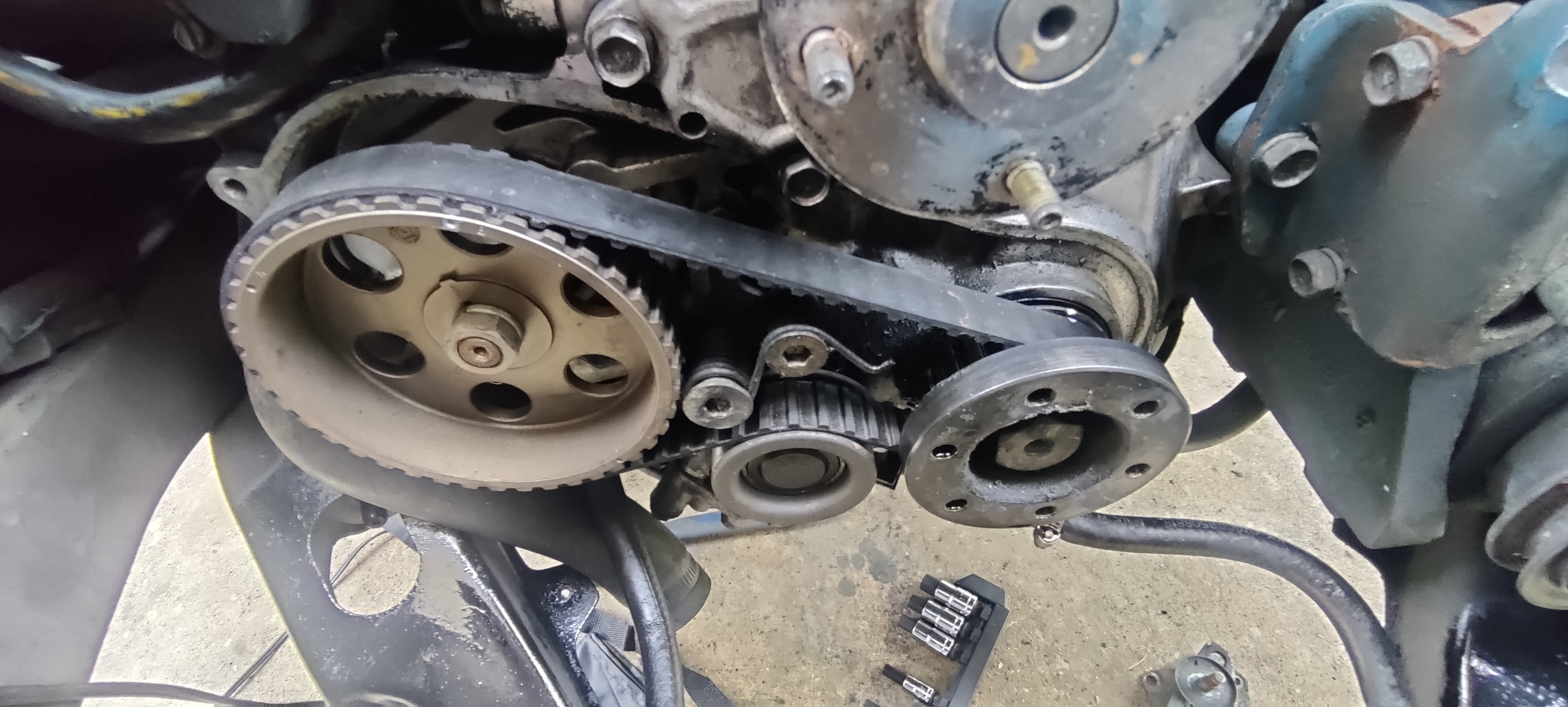

IP belt was in great shape for approximate "70k miles". It even had the original part number which tells me It has never been changed. Tensioner looked brand new as well, but I still replaced it with one from Amayama from a LD20. (It took them a week to even find one)

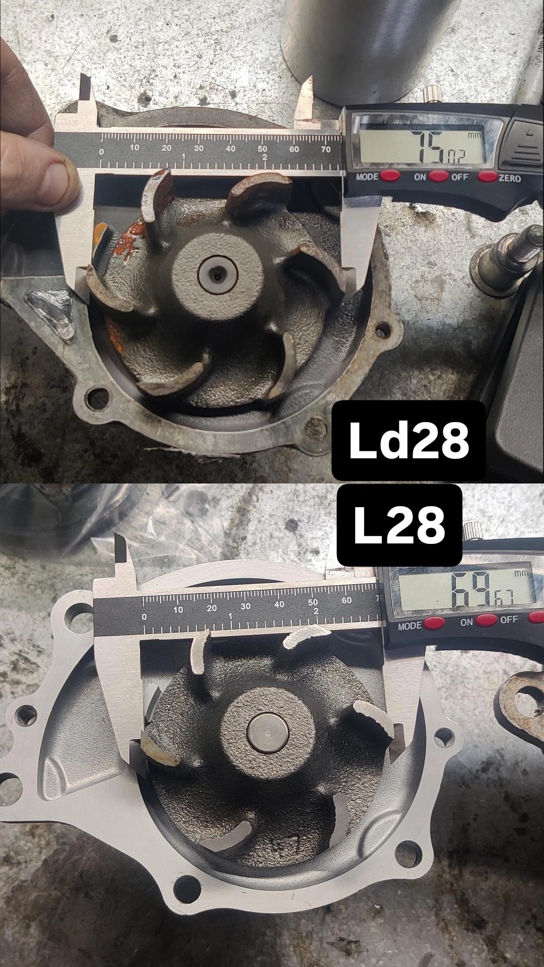

I also replaced the water pump since it had a leak from the weep hole. It was also factory. but sadly I had to replace it with a L28 pump instead of the LD28 pump. I will include the measurement difference I found between the pumps below.
