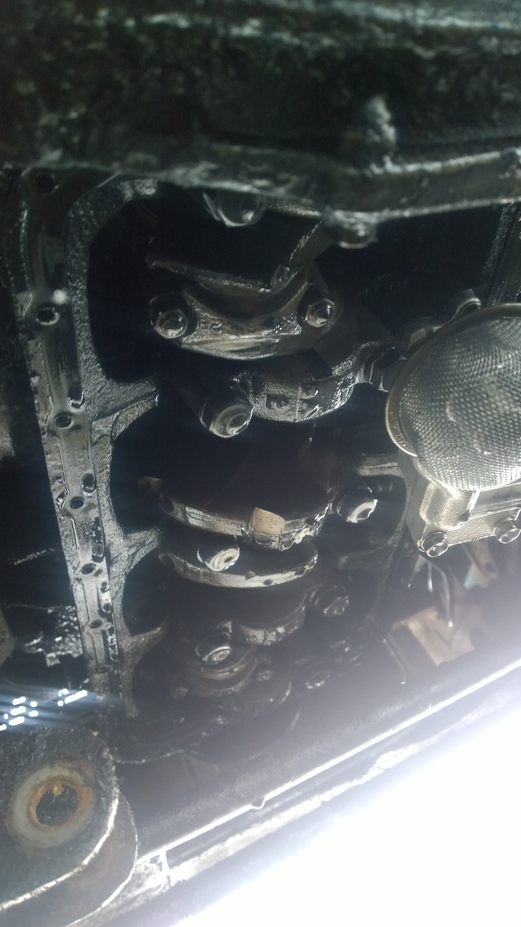

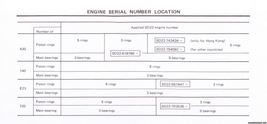

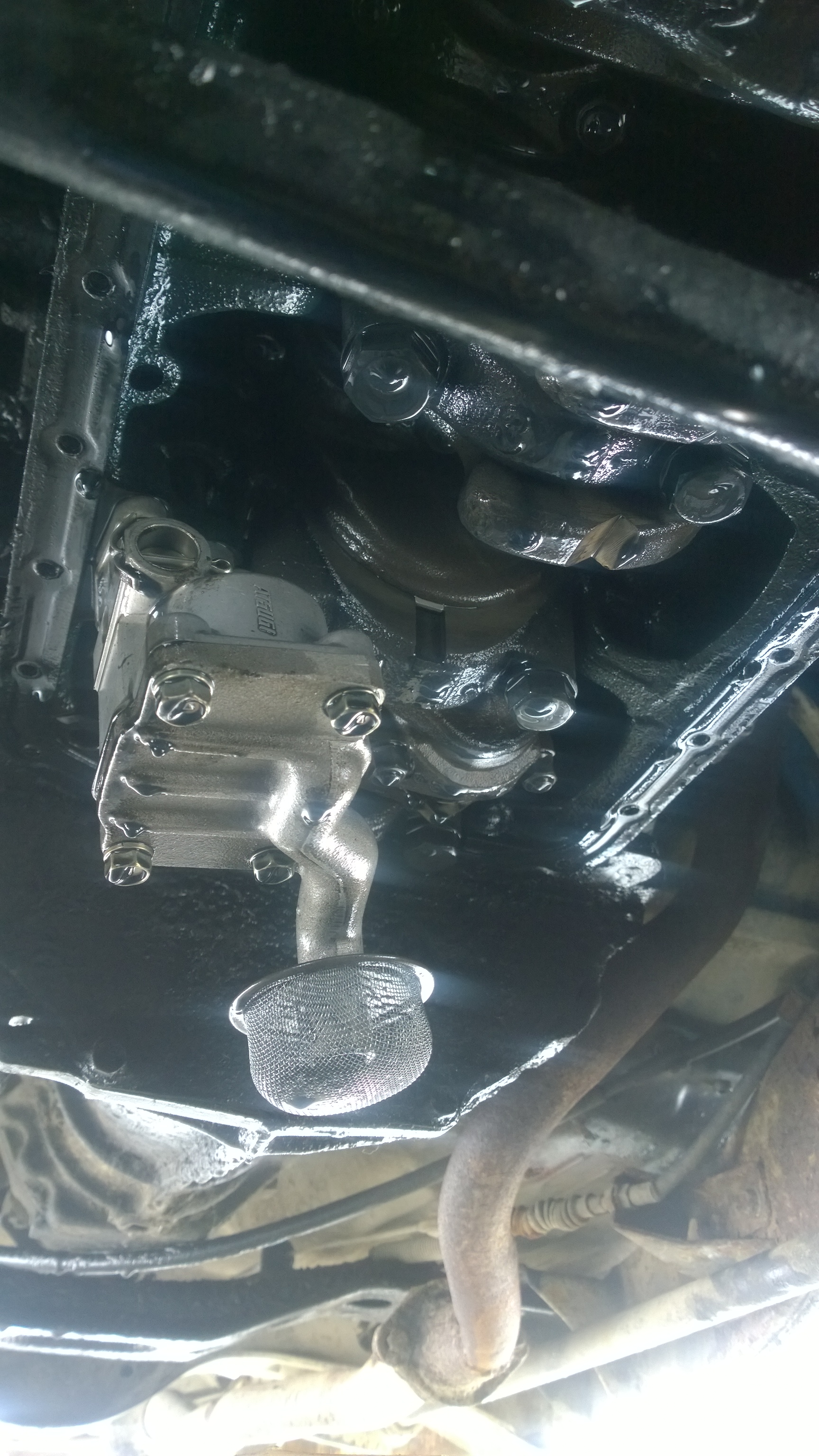

So, after some scavenging on this forum I found that these engines are featuring 3 main bearings, according to a user. But further investigation revealed that the SD22 engine also features 5 mains on some markets and in different ranges of vehicles.
Because I was curious whether mine has three or five mains, I simply took down the the oil pan and took a look for myself. And guys, mine has 5 bearings. Check out the pictures.
C__Data_Users_DefApps_AppData_INTERNETEXPLORER_Temp_Saved Images_139511_2NC5XVNYRHOGW1453651196.jpg
C__Data_Users_DefApps_AppData_INTERNETEXPLORER_Temp_Saved Images_139511_2NC5XVNYRHOGW1453651196.jpg (258.29 KiB) Viewed 32655 times
C__Data_Users_DefApps_AppData_INTERNETEXPLORER_Temp_Saved Images_139511_F7DWK1Z677ED1453651196.jpg
C__Data_Users_DefApps_AppData_INTERNETEXPLORER_Temp_Saved Images_139511_F7DWK1Z677ED1453651196.jpg (408.09 KiB) Viewed 32655 times
I will be posting this to the thread were this was discussed.
And also, thanks for your inputs!

Appears there was a serial number stamping relocation occur in May of 1980.
Just wondering where your engine number fits into that chart you supplied. ( I found the same webpage )

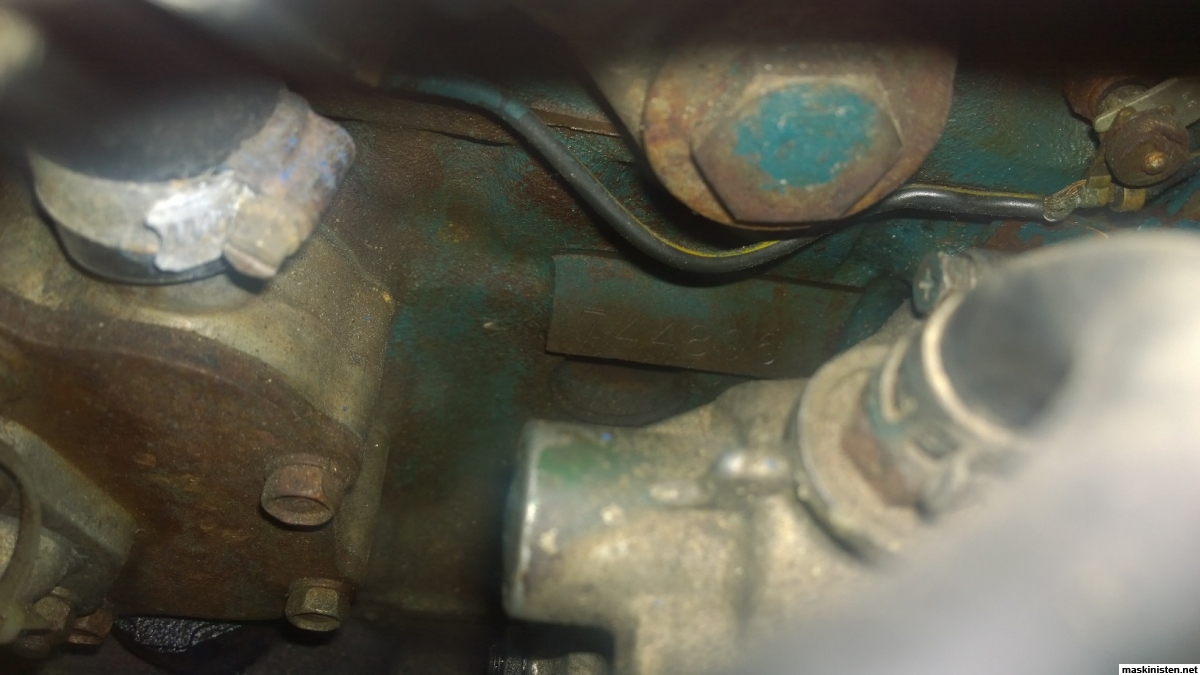

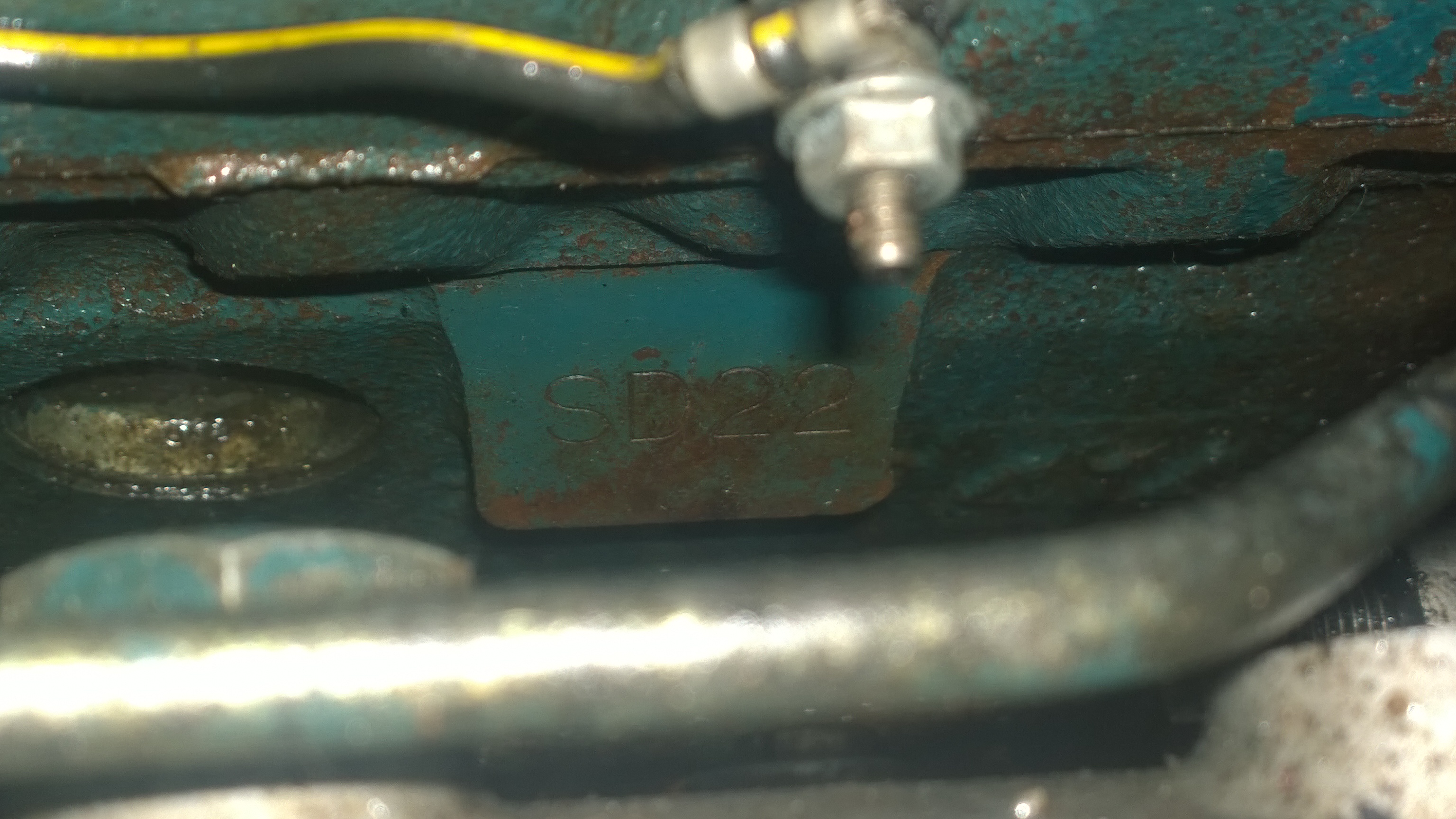

Can you take a photo of the number that's stamped on the block just under the #1 injector on the boss ahead of where your ser. please?
Thanks

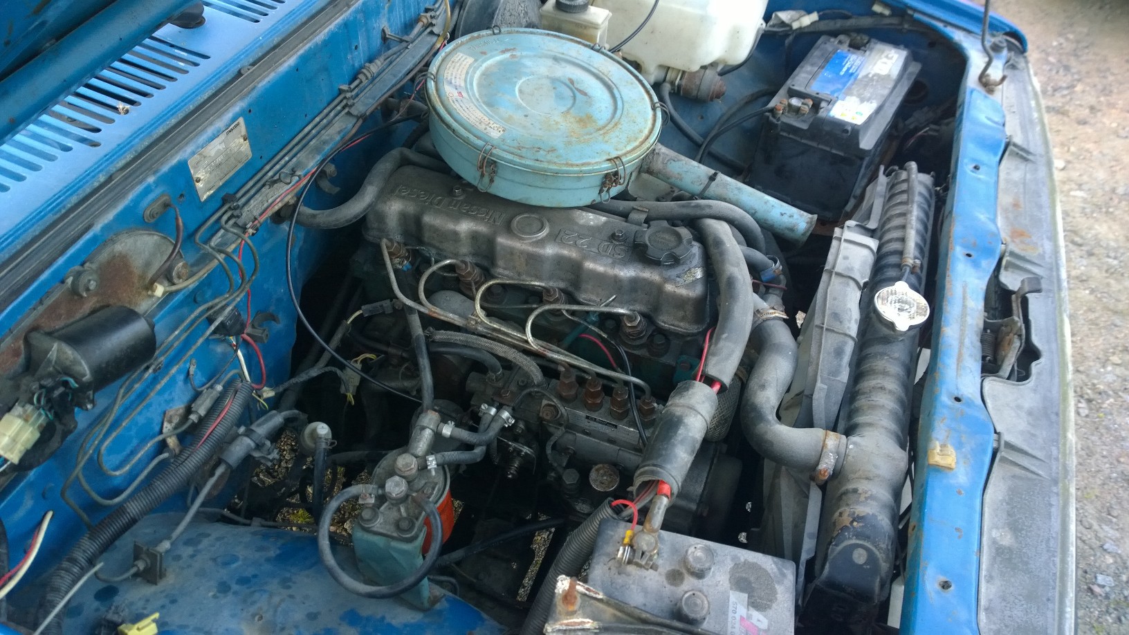

Of course! Here you go!

Again,,,,,,,,
Very interesting
It would appear that any of the SD22'S in 720 trucks whose serial number starts with a "7" have 5 bearings?
I only assume that because of the chart you included and your engine number starts with a 7, it would appear that from 703579 and on have 5 brgs. ( thats a guess on my part )
The other thing I notice is that some of these engines are "regional" as to where they were sent and can only assume that because your in Sweden then that may be the case.
You say yours came from perhaps an 84 720 That is just about the time that the SD25 started appearing in the 720's in North America. Could be that those higher engine serial numbers were being used in the European destined 720's.
This was the same kind of thing with the D21 diesel that I have. They were sent to Canada but not to the US.

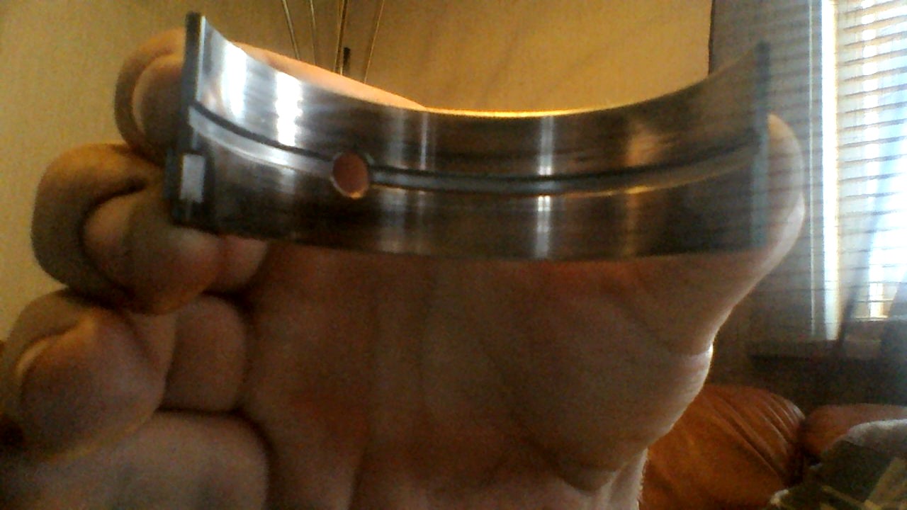

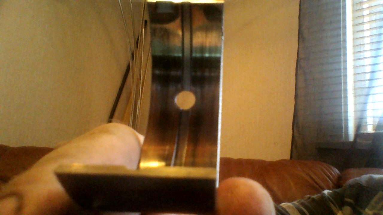

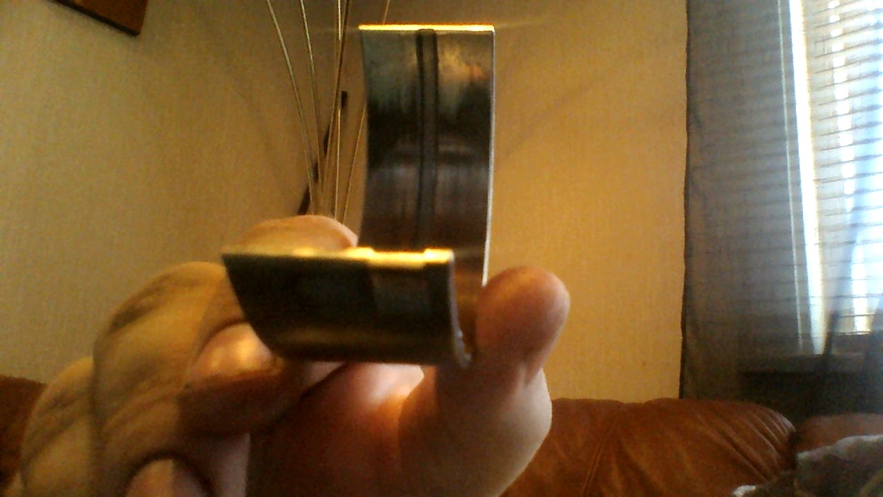

just of curiousity I took off a bearing cap to get a picture of what condition the engine was in, whilst I have the oil pan down for service. And I encountered this...
I don't think it's terrible, but it is definitely in need of a little overhaul.
