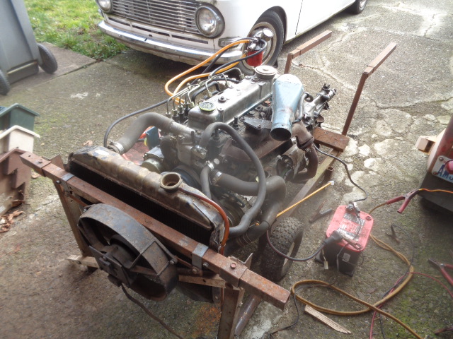

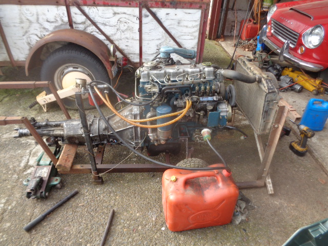

Yes I have tested engines on my stands I have made, this one is for the SD22/SD23/SD25 engines.
This engine sat for years after I bought it on ebay, I was told it was rest fired before put on ebay, I smoked the forklift glow plugs trying to start it, they are not made for a 720 glow system, then the glow plug wiring messed up and only the #1 plug was getting power, once I figured out that and it still would not run properly I pulled the injection lines off the injectors, turned it over and not all the injectors were squirting, so I removed that injection pump and put another one on the engine and it started, I was lucky to have an extra injection pump.

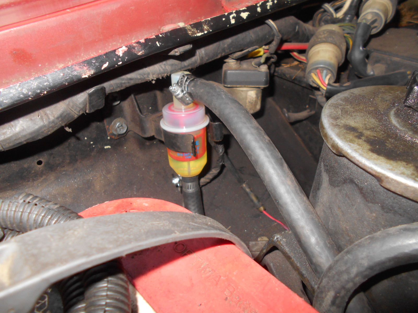

I asked about the pre-filter because of that screen in the banjo fitting on the bottom of the lift pump, that screen is delicate as it is plastic, but if the lift pump is working and you get fuel to the fuel filter and the rest of the system it is likely not plugged, I use a pre-filter screen in my diesel truck I daily drive, I do not have room for a real pre-filter, this is my screen pre-filter.
I cannot really tell you what you should do on the testing, if you were close enough I would come over, but you are across the country, one really needs to understand these engines, otherwise one is guessing, since you said it fired with either, then I am assuming that at least one glow plug is working(maybe all are working), so I do not know what to say next, sounds like it is not getting fuel, like I said 16 years is a long time, I expect if it was me I would likely remove the injection lines and see if the injection pump is squirting in every hole, but I am not there to make this decision, it's a big decision, maybe see if you can get the other engine running, maybe doing that will help you to get the engine in the truck started.
