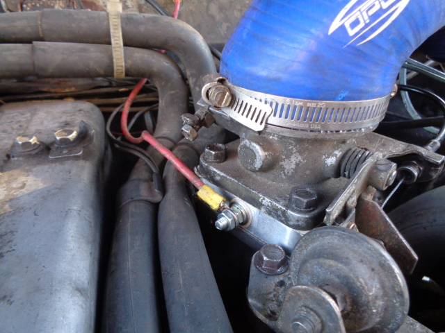

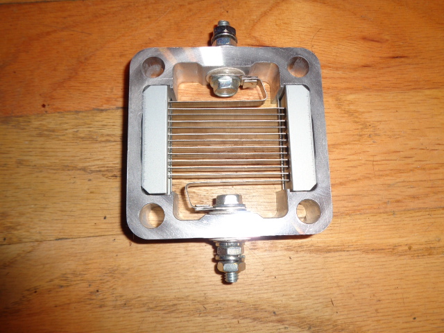

There are a lot of things that help starting diesel engines, especially when it is cold outside, I use an air heater for a tractor, I installed mine for winter use, this is what it looks like.
Here it is installed.
The point here is this is like the heated air blower except permanently installed, I have heard stories about people using torches to heat the air in tractors, they just let the intake suck the fire right into the intake to get it started when very cold outside.
I used to be able to start these engines in a parking lot that had sat for more than a year because the owner could not get it started, I started all engines before buying them, unfortunately I have not bought any in years now and have forgotten a lot, I never used either to start them back then.
It sat for 16 years, it's always tough going when the person trying to start them does not really know a lot about them.

Re: Help nissan 720 sd22 diesel
Yes indeed.
I installed the identical one in my 87 SD25 20+ years ago.
Worked a treat. A must here in the Great White North at Dec/Feb temps at -25C.
There were 3 spares that went with the truck when I sold it 2 years ago.
Mine were a Yanmar Industrial Diesel part number. Actually made by NGK.(who knew)
They are durable as well. Will take a full 25 -30 second preheat.
