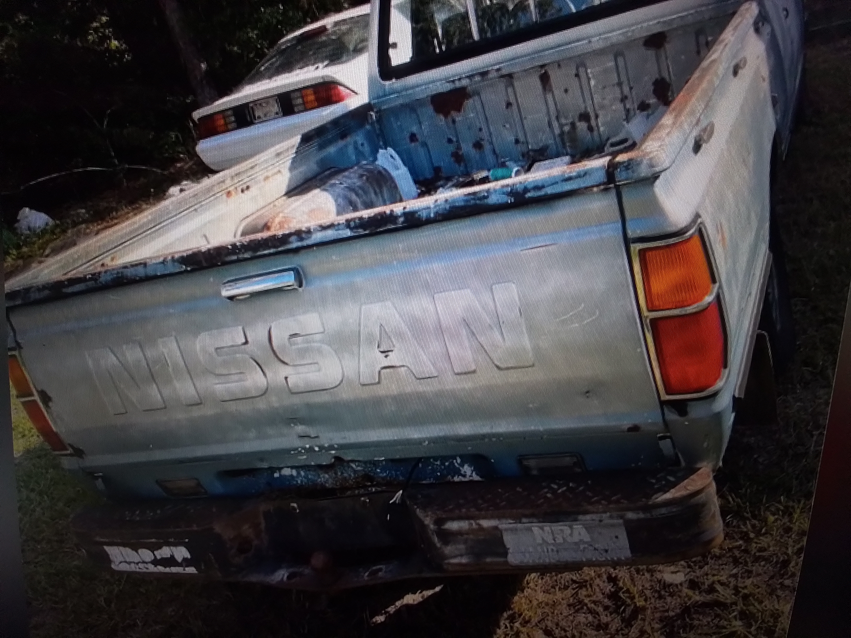

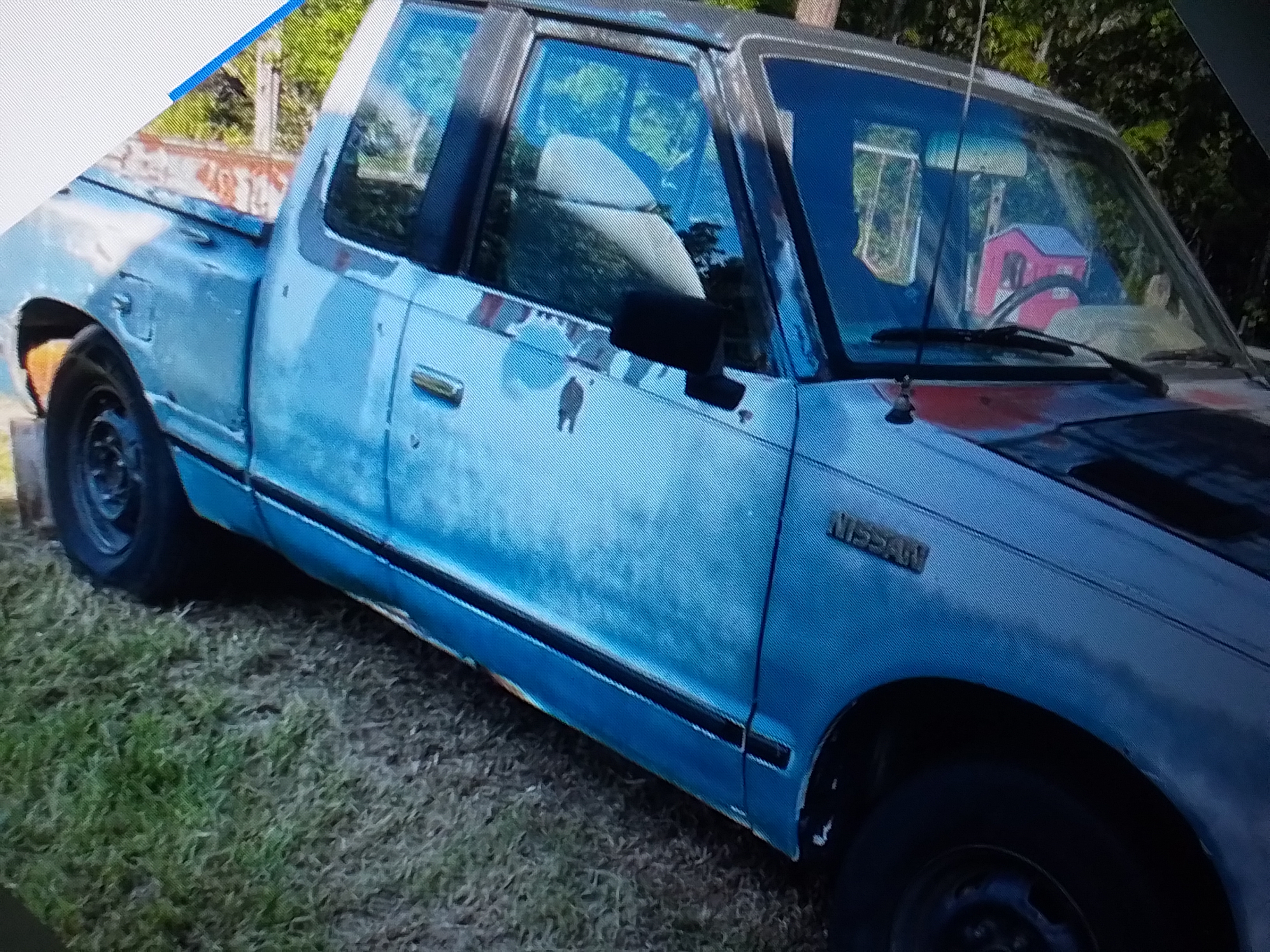

This is what looks to be a North American made truck (1983.5). I'm tying to find out whether this is an sd22 or sd25 diesel? He says sd22.

- Posts: 916
- Been thanked: 6 times
Re: Help nissan 720 sd22 diesel
Should be stamped on the block below the cylinder head by the alternator I think.
IIRC there is a boss there with it stamped into it.
Does it have the inline fuel pump on it or the VE style distributor style ?
If it has the VE style pump it's an SD25, although I think there was a thread on here from years ago with someone stating they had an SD25 with an inline pump allegedly.
P
P
