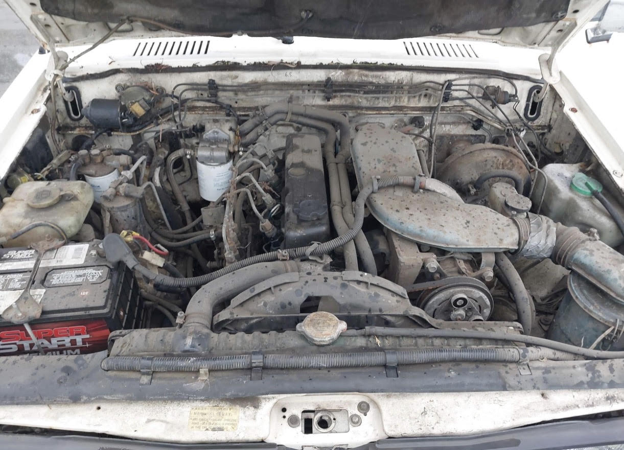

I got a lead on the power steering, in my inbox from a guy in washington state, from the Ratsun webpages, says he has one on this pic he sent, gotta catch up on the rest of my emails, looks like there may be more pics, wonder what year that is, haven't seen an air cleaner like that on my other four rolling carcasses -ha

- Richmond-Yelm Washington-parting out 1982 Datsun 720 diesel with an SD-22.jpg (179.64 KiB) Viewed 7 times
