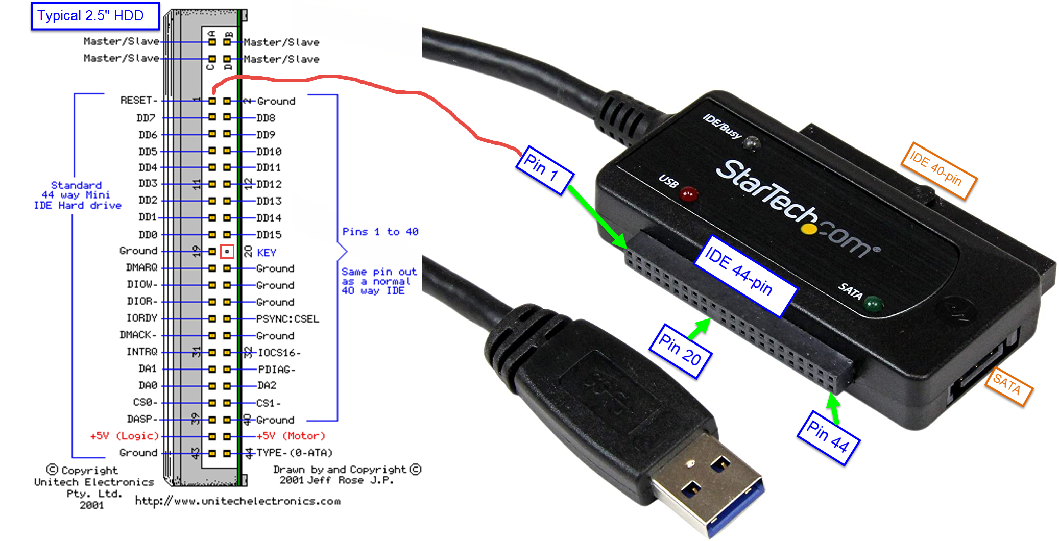

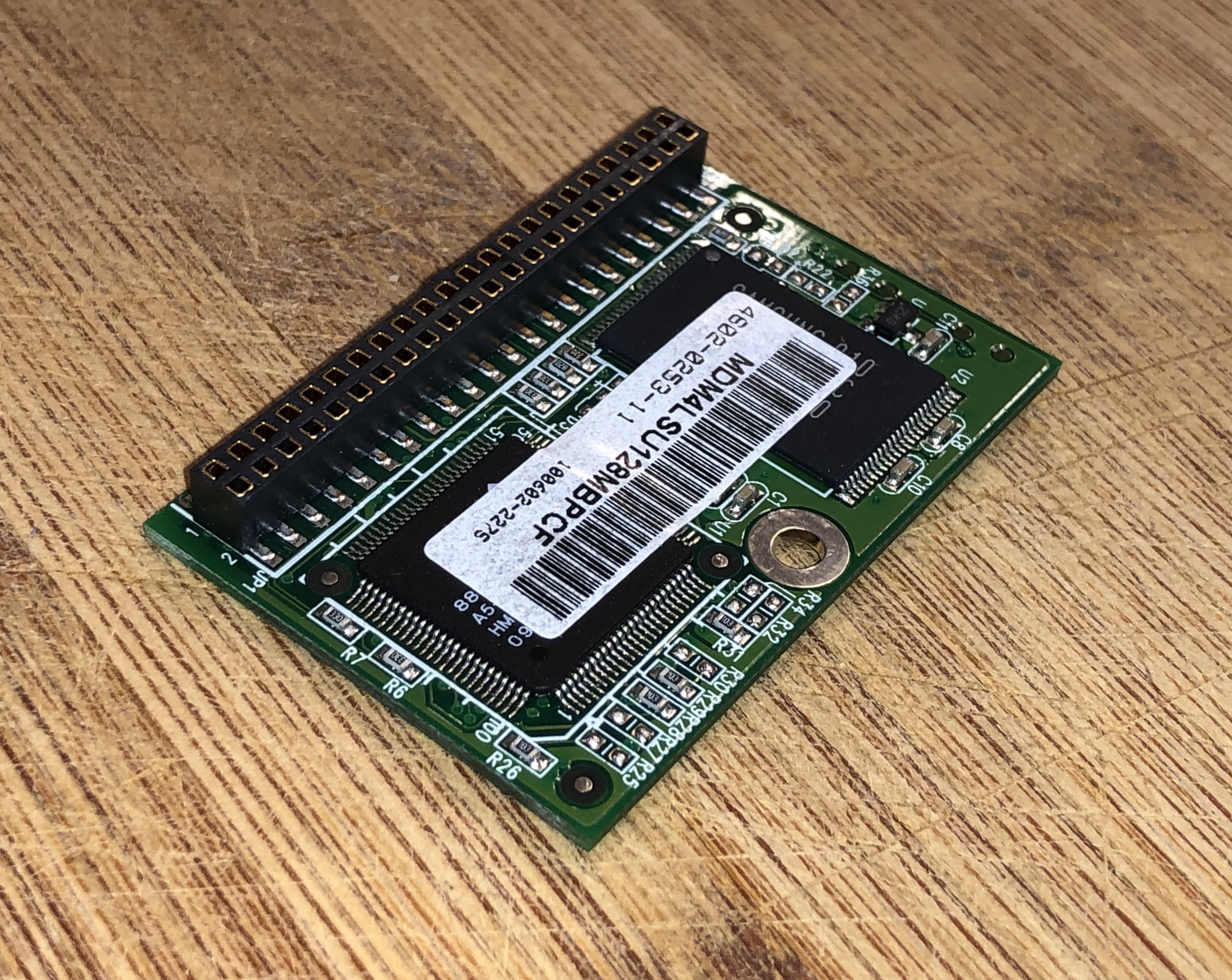

"Gender changer", you say? Not so fast. You cannot just use, say, a header row of straight-through pins (I tried: smoke!). Here's the N4100Pro DOM:
Thecus N410Pro DOM
Thecus N410Pro DOM
Look at a typical 2.5" 44-pin HDD's pinout, and how it mates to the StarTech Converter:
StarTech converter, and IDE HDD pinout

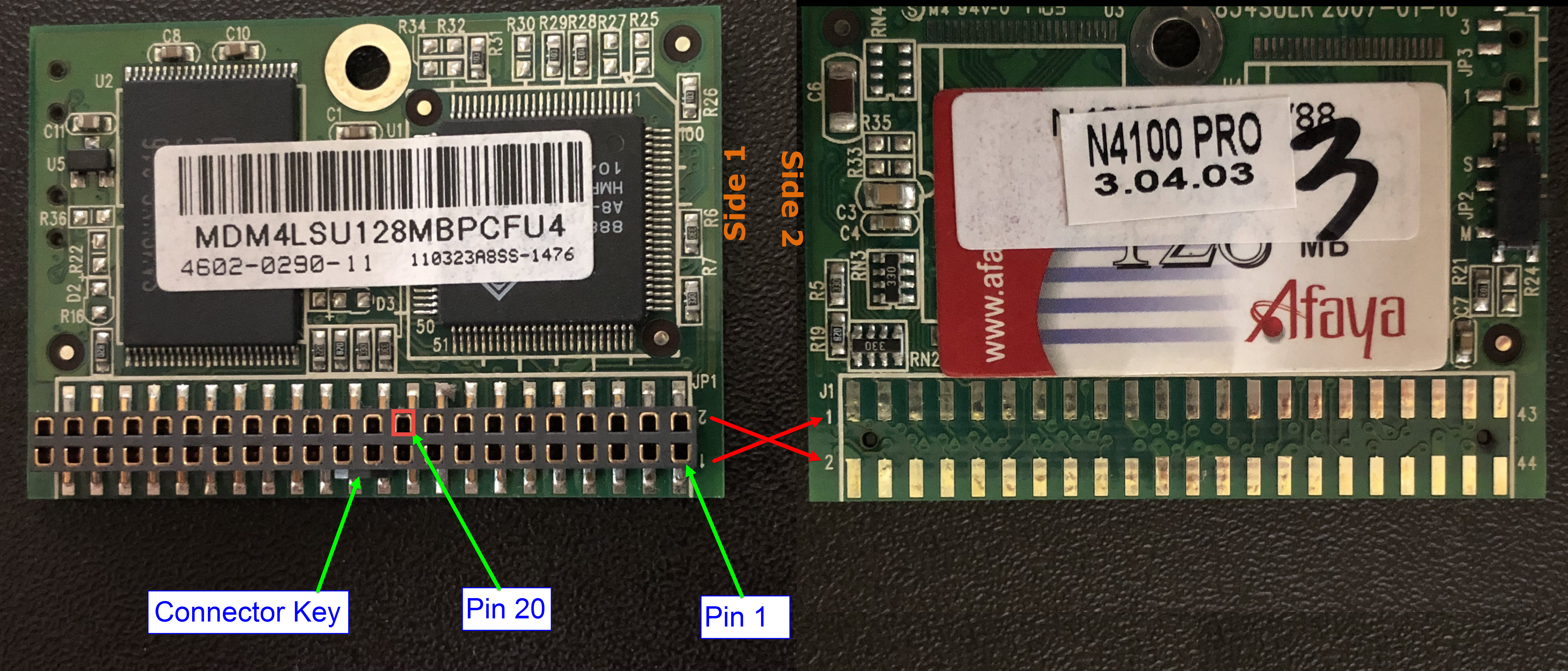

But Pin 1 on the DOM is on the wrong row. On this DOM, the top & bottom rows are reversed from a standard 2.5" HDD, AND the solder pads on the back of the DOM are also reversed. Tricky.
Thecus N410Pro DOM, Front & Back showing header row reversal.

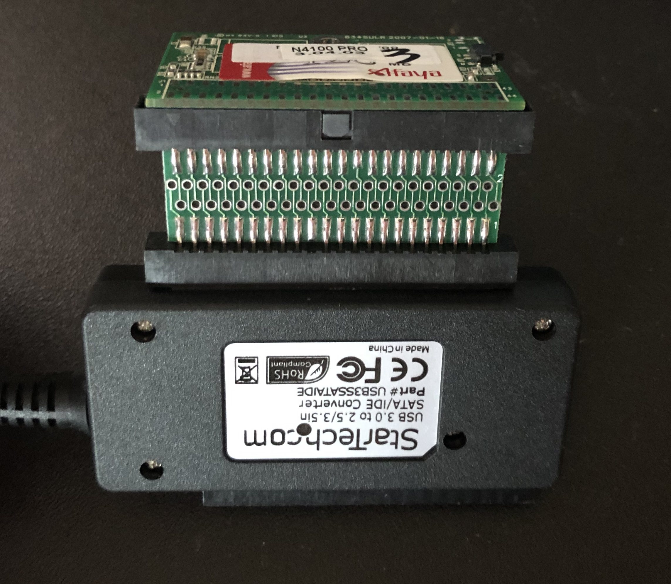

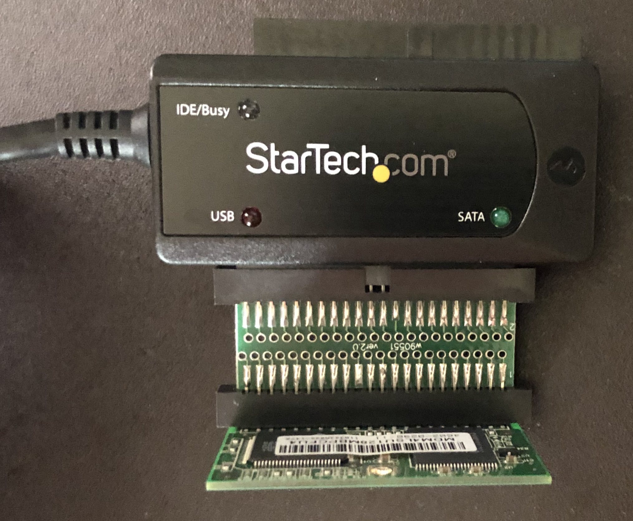

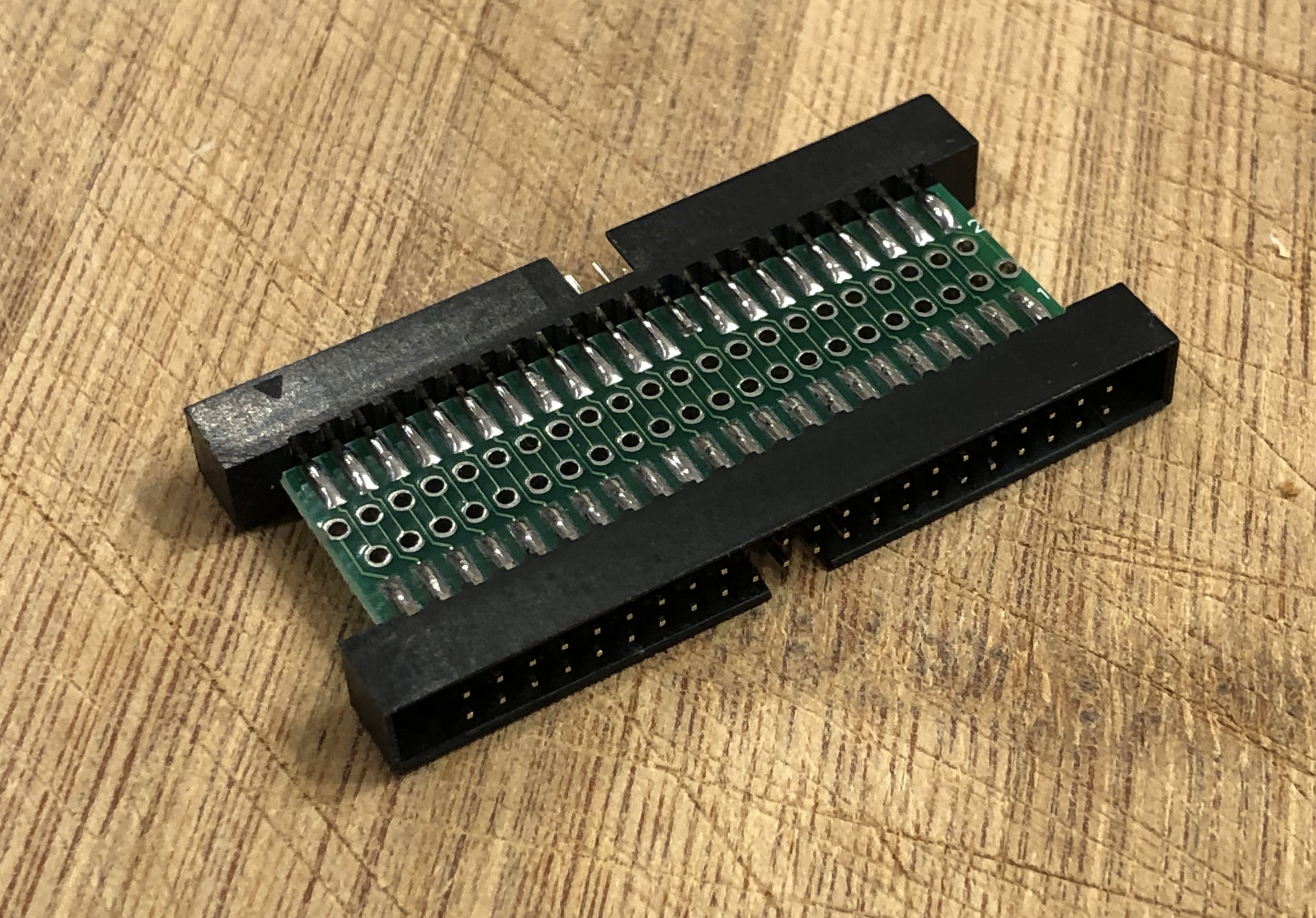

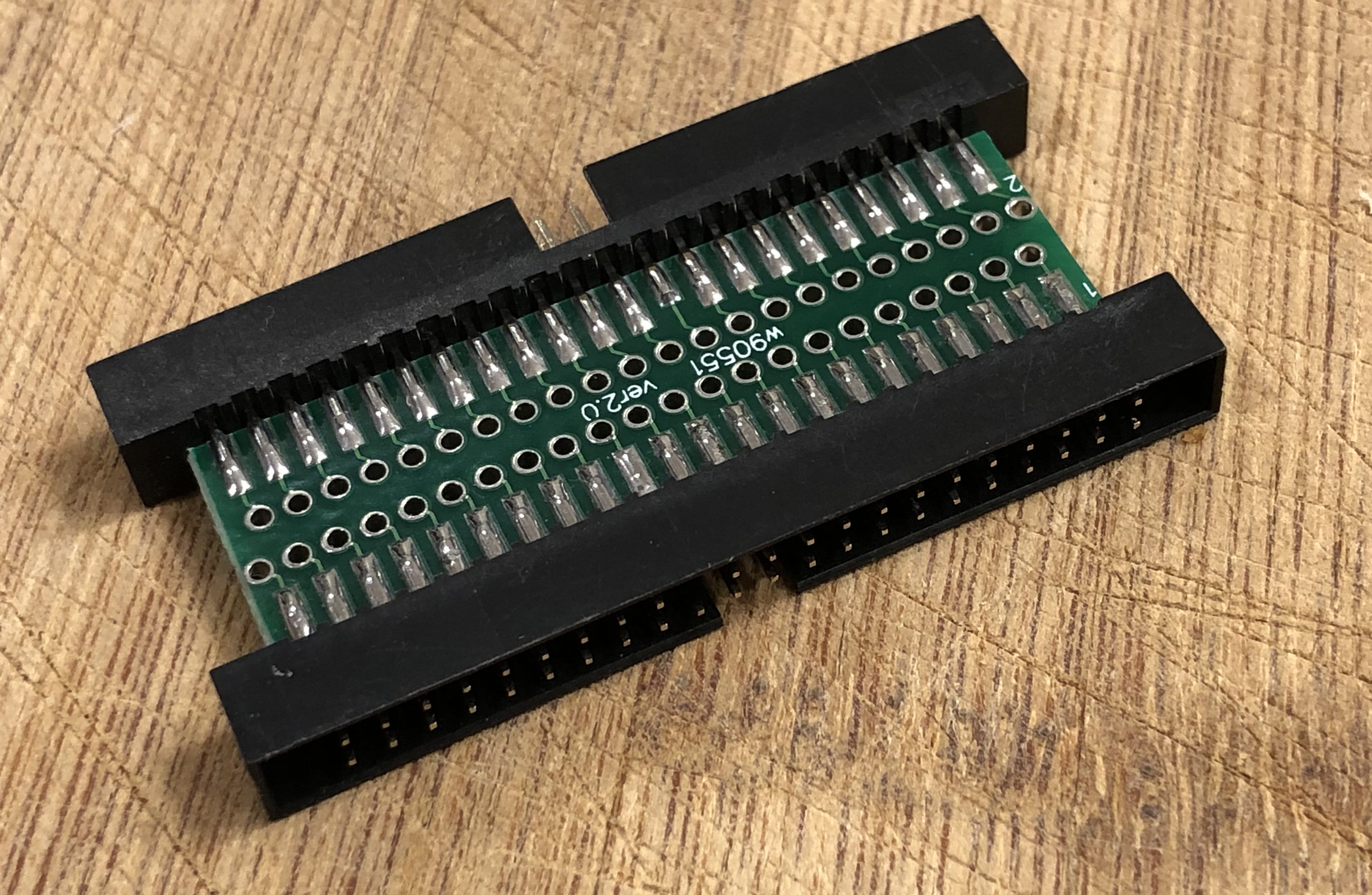

The way to connect this DOM to the StarTech Converter (or anything other than a mainboard that's wired for a DOM, I guess) is this adapter: Amazon JXSZ 2.5" IDE PATA DOM 44-Pin(43pin) Male to 44-Pin(43pin) Male IDE 44pin M-M Adapter
JXSZ W90551 44-pin IDE DOM adapter @ Amazon
Thecus N410Pro DOM, Adapter, StarTech converter
That JXSZ W90551 adapter flips the rows of the header as it changes the gender. Try to find that adapter anywhere in a hurry . . . at this time, it's almost unobtainium if you are in a hurry. I waited three weeks to get one via Amazon, and it is the perfect tool for this job.

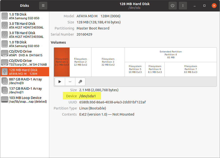

After getting the physical connector to read/write to the DOM sorted out, and obtaining a spare DOM, then I had to read from the DOM with the newer firmware, write to a file, then swap DOMs in the StarTech converter and write the file to the DOM.
To read from the source DOM, I first used the Ubuntu GUI utility Disks to find which disk name Ubuntu gave it when I plugged the converter into a USB port. These days, Linux enumerates disks sort of alphabetically, eg /dev/sda, /dev/sdb, etc. There are many, many ways of determining what identifier Linux assigns to storage media, with the lsblk command being one of the easier ones. However, with Ubuntu's adoption of snap packaging and runtime environment the system now adds "loops" to /dev ; my system has around 29 of them, this makes reading lsblk output difficult and error-prone. Give me a GUI and a nice picture instead. This screenshot shows the Afaya/Thecus DOM selected in Disks, with the "/dev/sda" highlighted:
Linux GUI "Disks" utility
Using that, I know how Linux labelled the Avaya/Thecus N4100Pro DOM in the StarTech converter that's feeding the PC via USB. Below is how I read the contents of the DOM and write it to a file:
