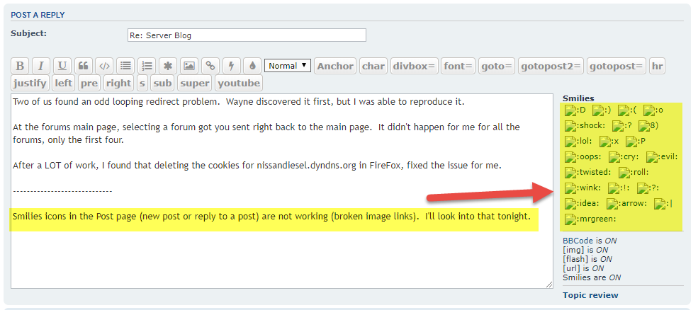

Re: Server Blog
Posted: Sun Mar 17, 2019 7:37 am
by asavage
Two of us found an odd looping redirect problem. Wayne discovered it first, but I was able to reproduce it.
At the forums main page, selecting a forum got you sent right back to the main page. It didn't happen for me for all the forums, only the first four.
After a LOT of work, I found that deleting the cookies for nissandiesel.dyndns.org in FireFox, fixed the issue for me.
Smilies icons in the Post page (new post or reply to a post) are not working (broken image links). I'll look into that tonight. :twisted:
Smilies
Posted: Sun Mar 17, 2019 4:31 pm
by asavage
Smilies are fixed. An over-ambitious rule in my anti-probing ruleset was blocking the images directory. I'm kinda surprised that attachment images and avatars were working.
