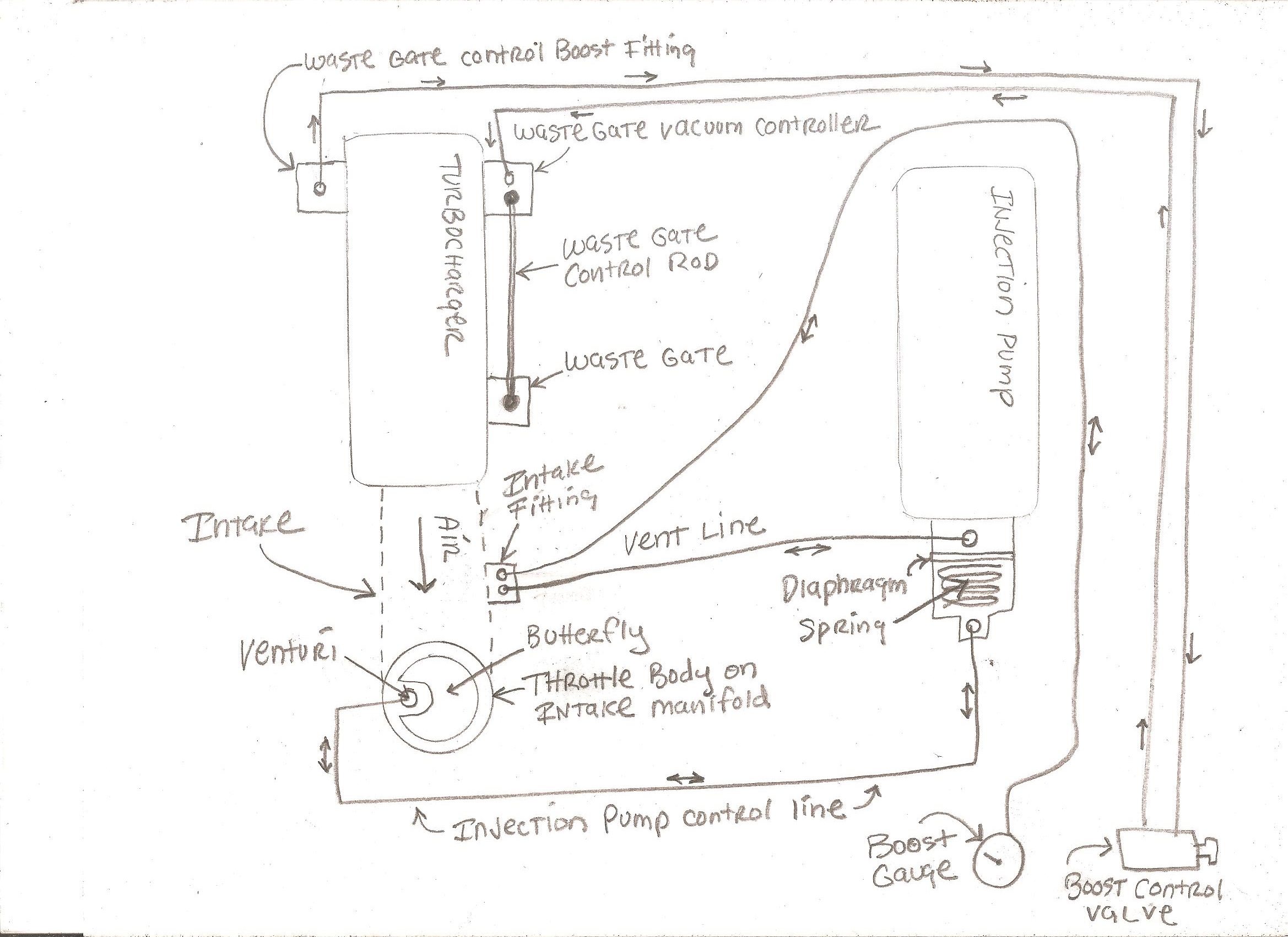

handcannon wrote:I for sure will be waiting anxiously for when you make that diagram so I can know just how you plumbed the lines. I can attest to just how difficult it is to picture how you plumbed the lines for a successful turbo install. When you do get the time to diagram the install please note the direction of flow for the air, or vacuum.
Everything is stock except for that vent line, there are two rubber lines that come from or go to the inline injection pump depending on how you look at it, one of them lines is the injection pump control line that goes from the throttle body to the injection pump, it is a vacuum line that is controlled by a venturi in the throttle body, when the butterfly is closed in the throttle body while the engine is running that venturi creates vacuum in that line which pulls against the diaphragm spring bringing the injection pump to the idle position, now you must understand that the diaphragm spring in the injection pump wants to be in the floored position when there is no vacuum, the other line is the vent line that basically goes to the airfilter, the air in that line goes back and forth just enough to let the diaphragm move back and forth, so what I did was tap into the intake tubing between the turbocharger and throttle body and I put that vent line there along with the line going to the boost gauge, so when under boost the vent line is under boost, but the injection pump control line is also under boost, so when one has their foot deep into the pedal the diaphragm spring wants to be floored, but when you let off the pedal the venturi in the throttle body creates a lot of vacuum pulling the injection pump back to idle.
If the butterfly in the throttle body is only a little open, the venturi creates less vacuum so it only lets the diaphragm move a little towards a richer position, if I didn't pipe the vent line to boost, the injection pump would be floored most the time because of boost, and the engine would run very hot EGTs(exhaust gas temperatures) because of being rich all the time which is the issue I was having with the 720 turbodiesel when it was piped as a blow thru, it ran stinking hot all the time.
It's complicated, but it is not complicated as except for the turbocharger being there all the lines except the vent line are not changed, only the injection pump vent line is piped to a boost source and it sees boost when there is boost same as the injection pump control line, when there is boost it sees boost, so when there is boost, both sides of the diaphragm see the same boost and cancel each other out, so then the venturi in the throttle body works as it should.
Posts: 645
Has thanked: 9 times
#32
Ok, so here is how I piped the lines.
handcannon

Thank you very much for the reply AND diagram. That really helps me understand what you did. I was wondering if this is what you did, but there was still some question and confusion on my part.

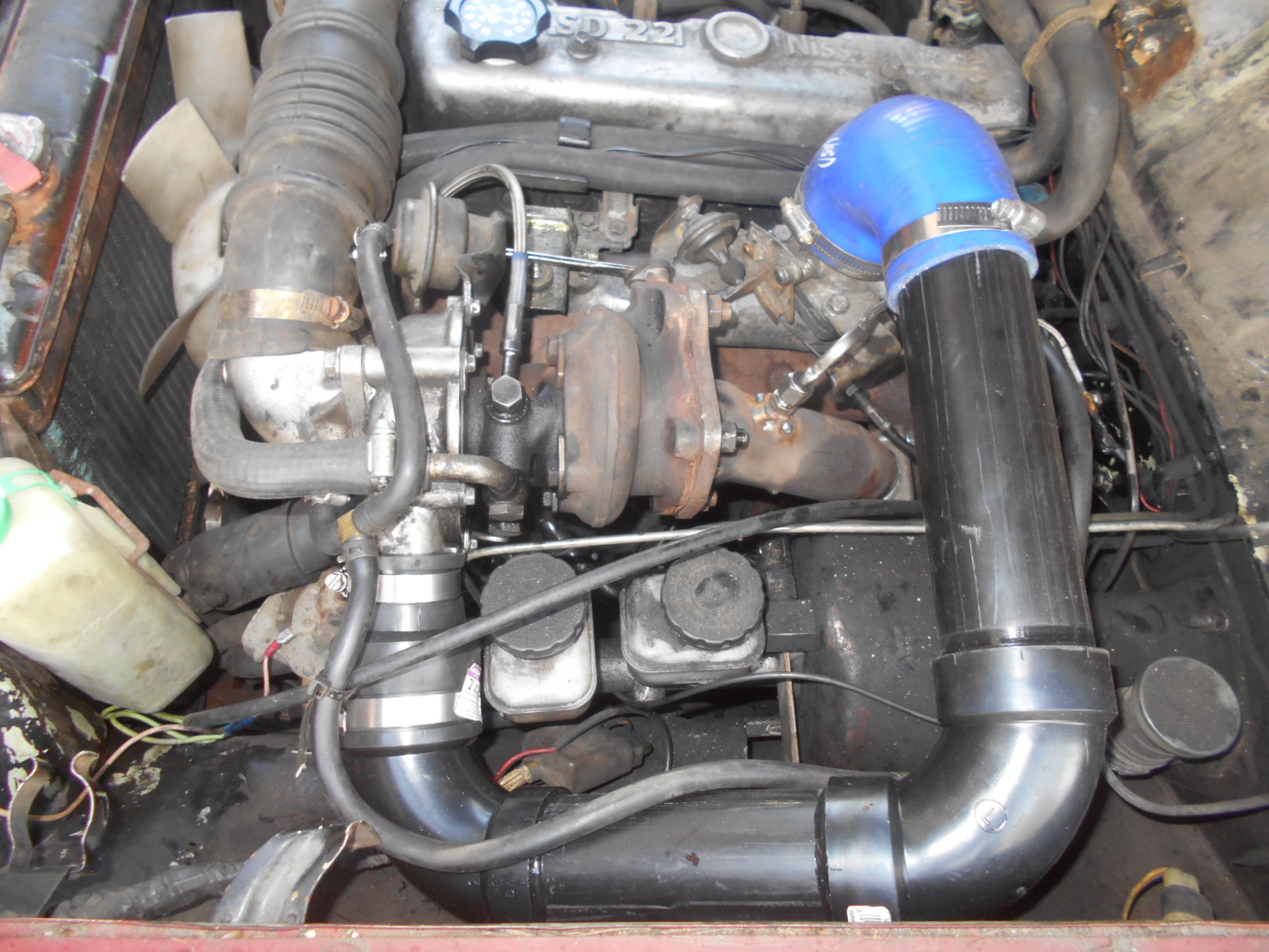

The turbos I am using are supposed to be for around 1600cc engines, I have SD25 engines I use them on.
Every thread I have read recently(5 yrs) about an SD series turbo build had too large of a turbocharger and they could not build any real boost, they maybe could get 2/3psi, that was it, the home made turbocharger setup that was on the engine I bought has a 2 1/16th inch intake throat on it and the waste gate was wired shut when I inspected it, but it was not really that pretty of a setup either, it was backyard made, that is why I didn't even look at it for 5 years, as far as I was concerned there was nothing worth using on that setup, but when I removed the turbo and adapter, I thought that maybe the home made turbo exhaust manifold might work as the flange hole was huge, so I made my own back yard mechanic adapter for the Subie AWD turbo and it worked great.
Keep in mind I have 2 different SD series turbo engines now, but the one Larry built was modified, he put a larger inlet vane in the German turbo so it built boost at lower RPMs, he also had the injection pump turned up(made richer), and I have had nothing but issues with that setup, it ran hot all the time till I made it a draw thru, but that created other issues, but I didn't know then what I know now.

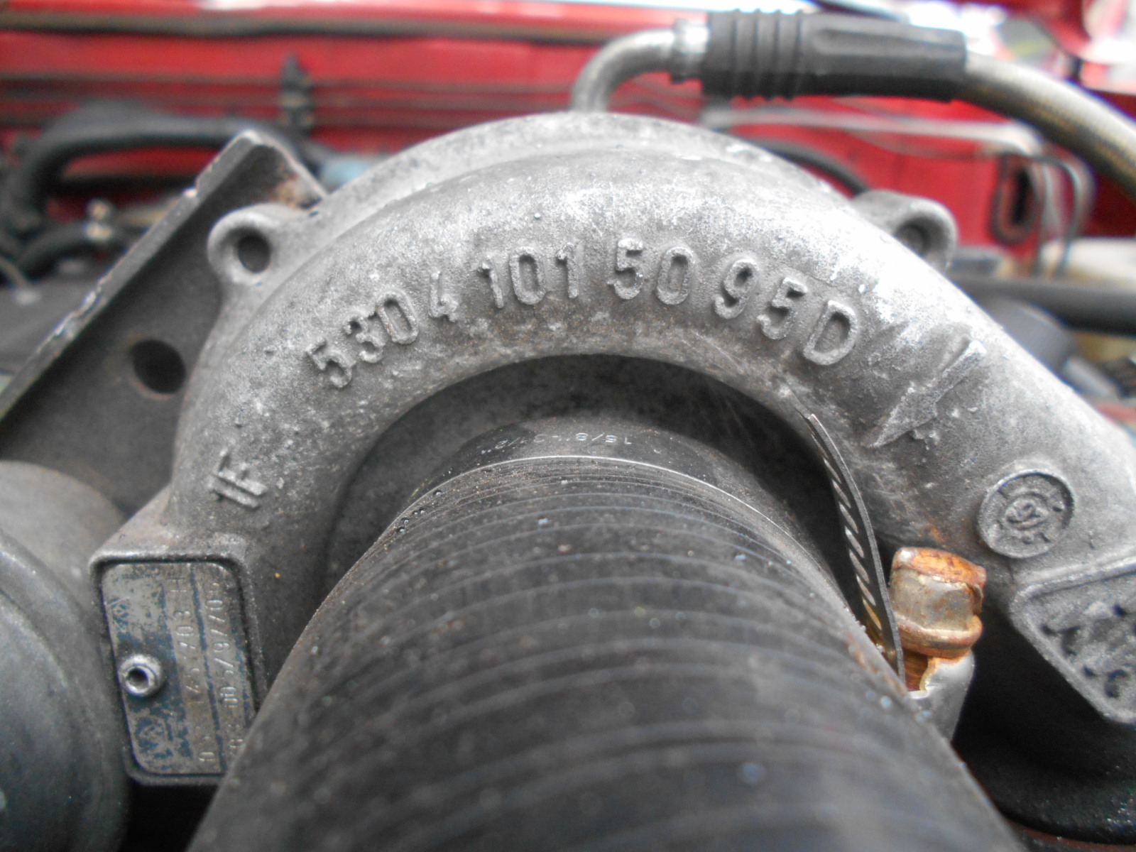

This turbo engine is using a Subie AWD turbo I found in a wrecking yard several years ago, as I recall it was a 1600cc engine, it was a small SUV looking vehicle, sorry I don't remember the year, but this one is unmodified and it works great on my SD25 engine, it doesn't have the grunt that Larry's turned up injection pump has, but it goes down the freeway awesome, it acts like a normal SD series engine off the line, but once it start building boost it like a different engine, on one of the test drives my friend rode with me, he has a 720 diesel, he said it was fast and now wants to do the same thing.
To get the numbers off the Subie turbo I will have to take the front compressor cover off, I really am not interested in doing that, it runs great so I want to eave it alone and enjoy it, but I did take the inlet hose going to the airfilter off and I measured the inlet size, I was very surprised to see it measured out at 1 7/8ths inches inside diameter, but I recall it being on a 1600cc engine.

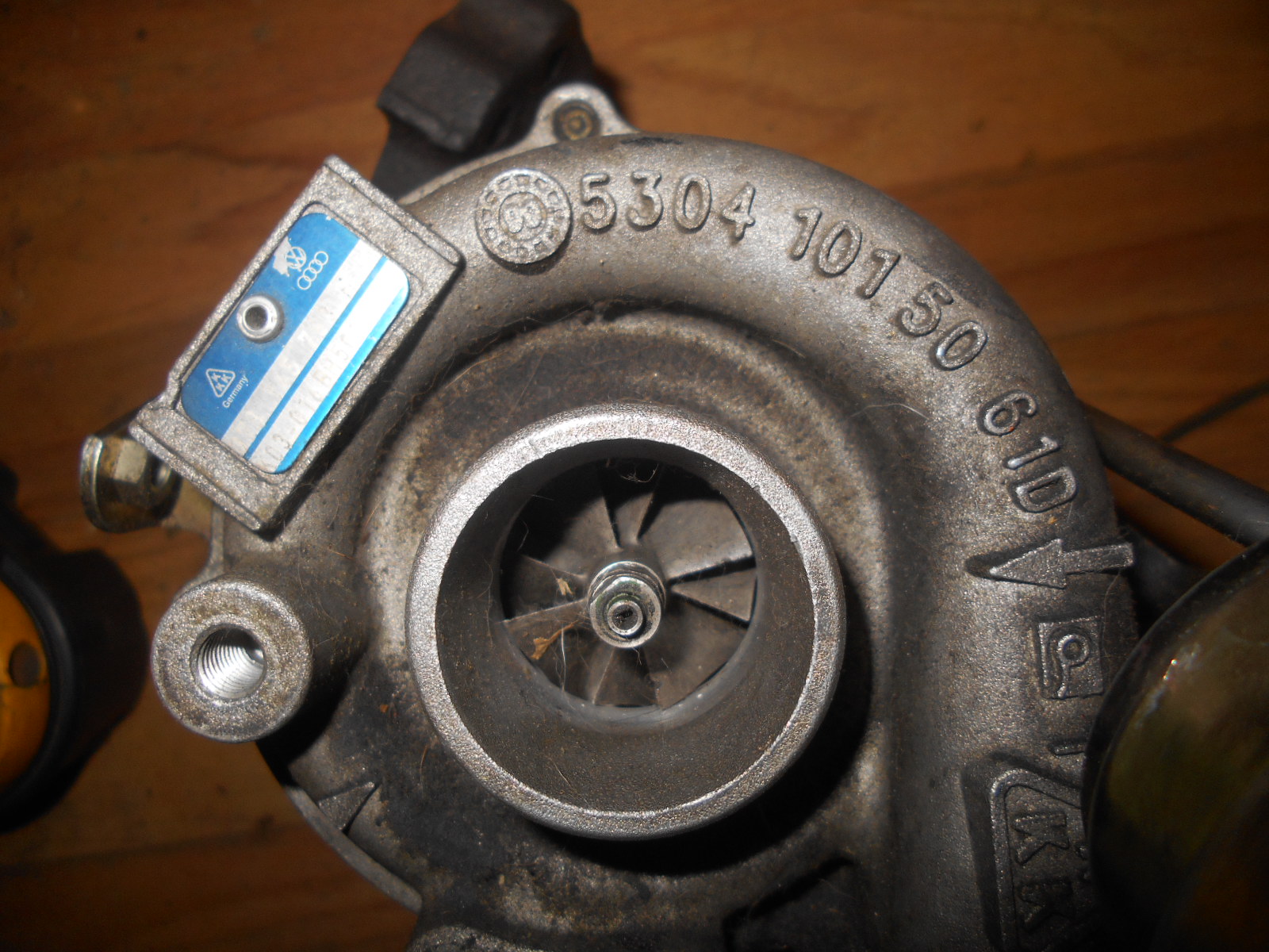

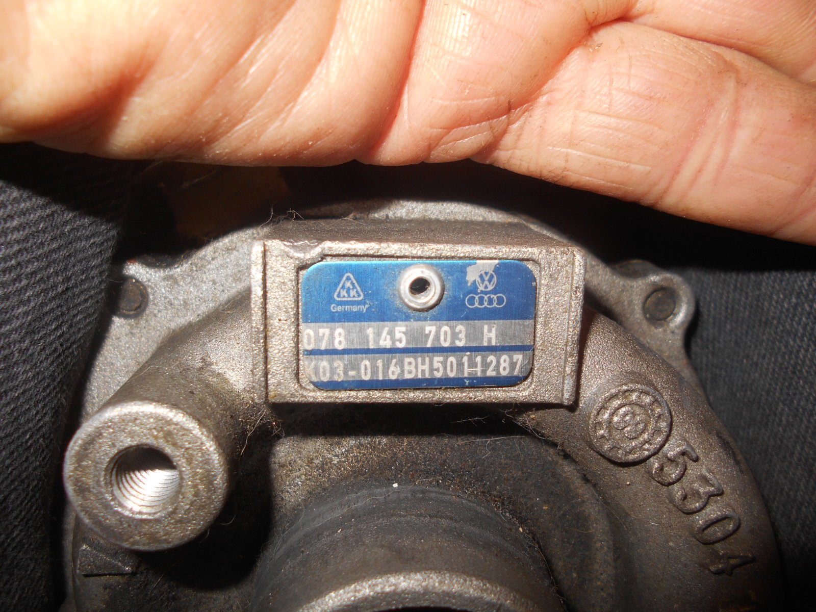

Here is a couple photos of the German turbo numbers I have on the 720, it builds plenty of boost but the one on my engine was modified, the Subie turbo exhaust vane appears to be larger than the German turbo, I never really noticed this before.

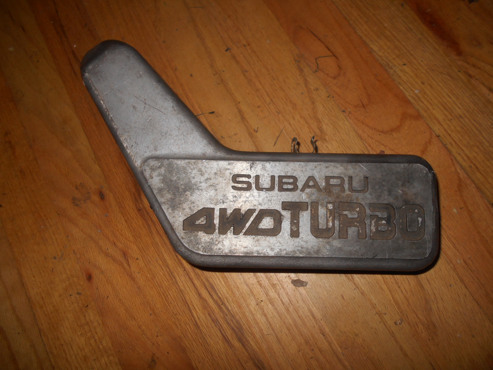

The aluminum intake pipe is from the Subaru AWD turbo I used on the 521, I wonder if that will help identify the Subaru I got the turbo from.

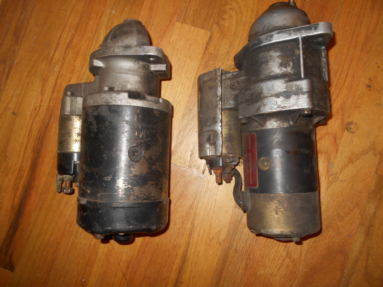

This engine has the big boy direct drive starter in it, it is huge compared to the gear reduction starter.
Everything is in the way of me getting to the top starter bolt now, but the big thing in the way is the exhaust pipe going from the turbocharger to the underside of the truck, but the turbocharger and the booster/master brake cylinder are in the way also to get the starter out of there, you can see in the attached photo there just isn't any room.
I can remove the engine case breather tube from the housing from the bottom, that is not a big deal, but the frame and torsion bar are an issue to drop the starter out the bottom, it has to come out the top, but you just made me think..............
What if I remove the torsion bar on that side, I wonder if I would have the room to drop the starter out, but the starter is not what is bad, the top bolt hole in the transmission case that holds the starter in position is stripped out, I will have to remove the transmission to fix that, which is not something I am looking forward to.

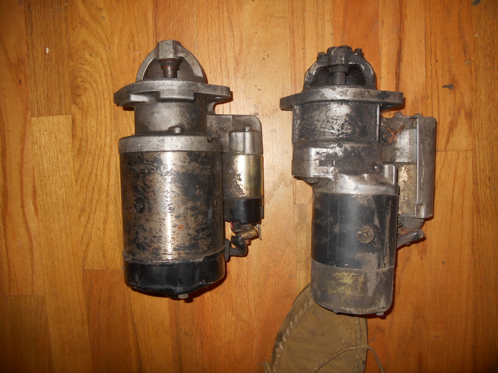

This starter topic brings up a question I have. Does anybody have pictures (or links to pictures) of the two starters side by side? I don't know what I have, DD or gear reduction. Currently I don't have the motor in the pickup, and now might be the time to make changes, if needed. I keep saying that I will get the motor in this summer, for the past two summers. I'm actually at the point of taking a lot of measurements, so hope is much higher for this summer. I'm planning to put the SD-22 into a 1973 Datsun 620 that my Dad bought brand new.
Posts: 645
#40
Direct drive is on the left, gear reduction on the right in both attached photos.
