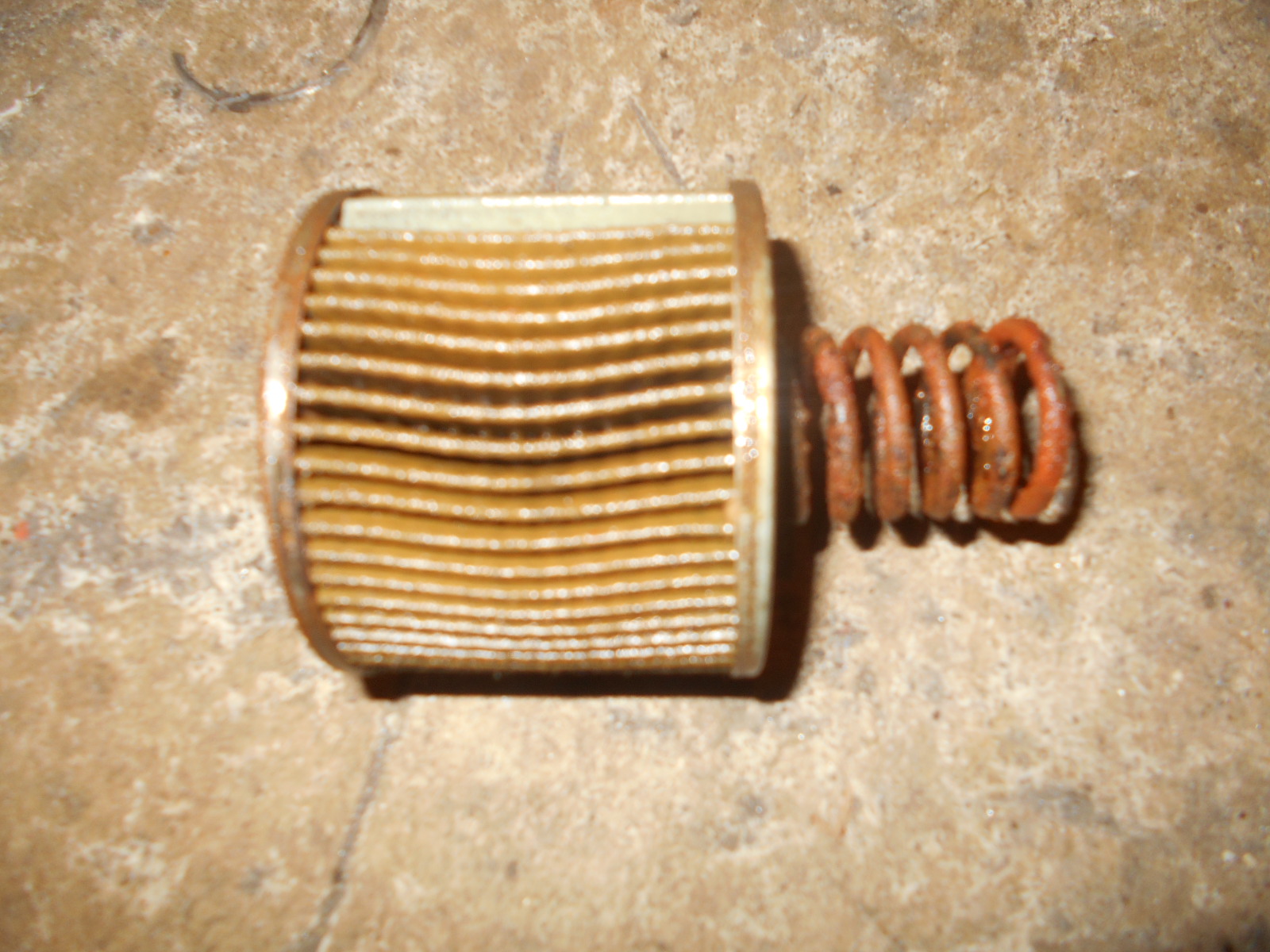

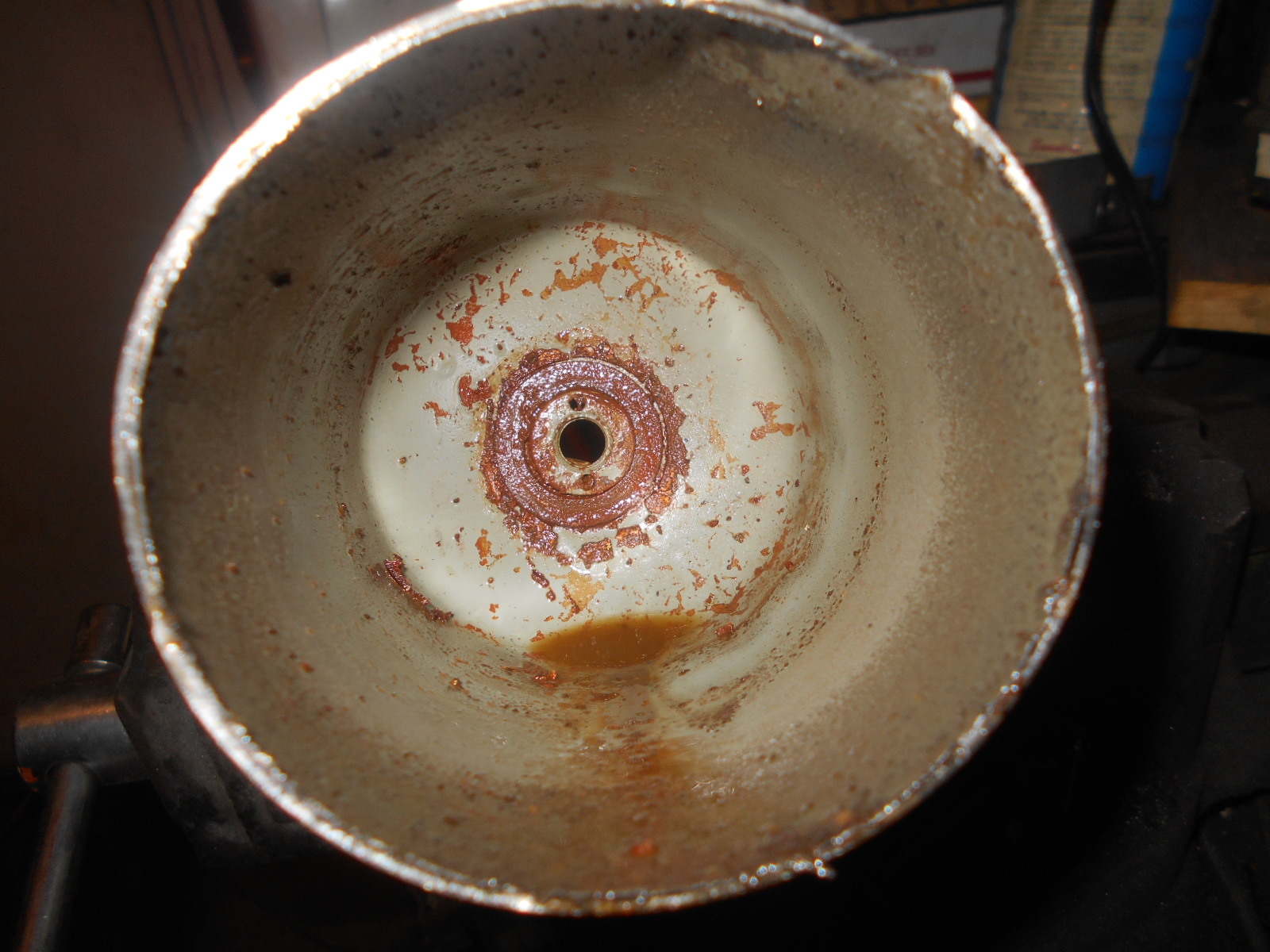

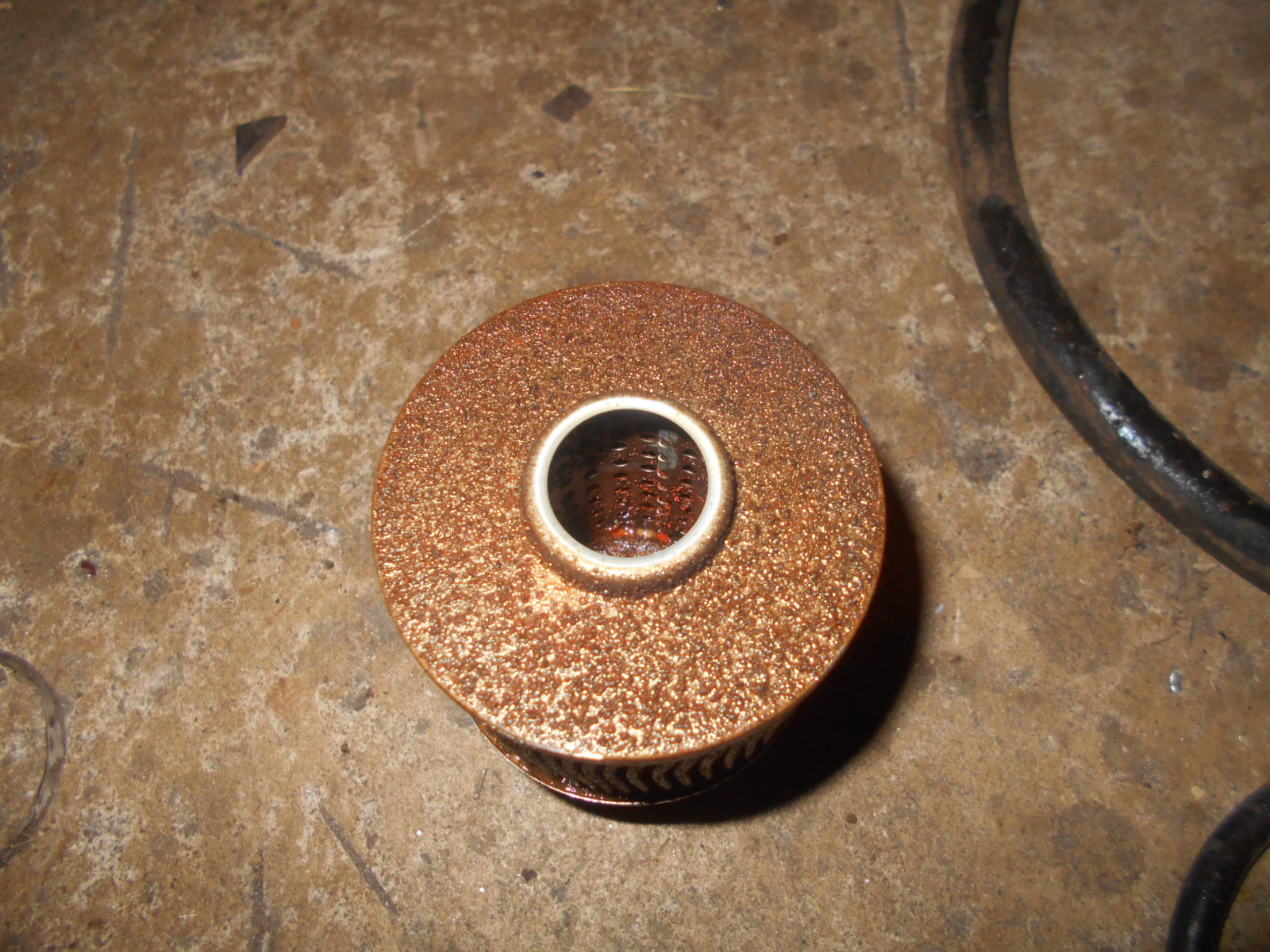

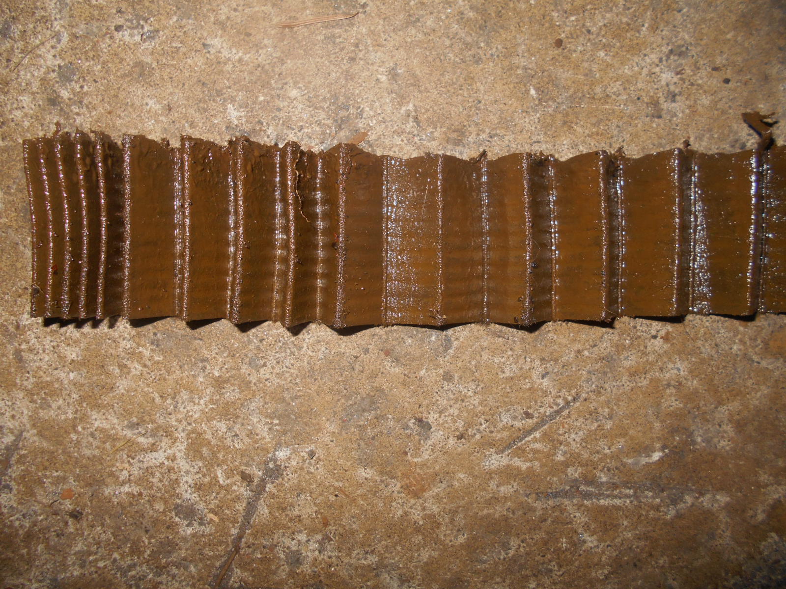

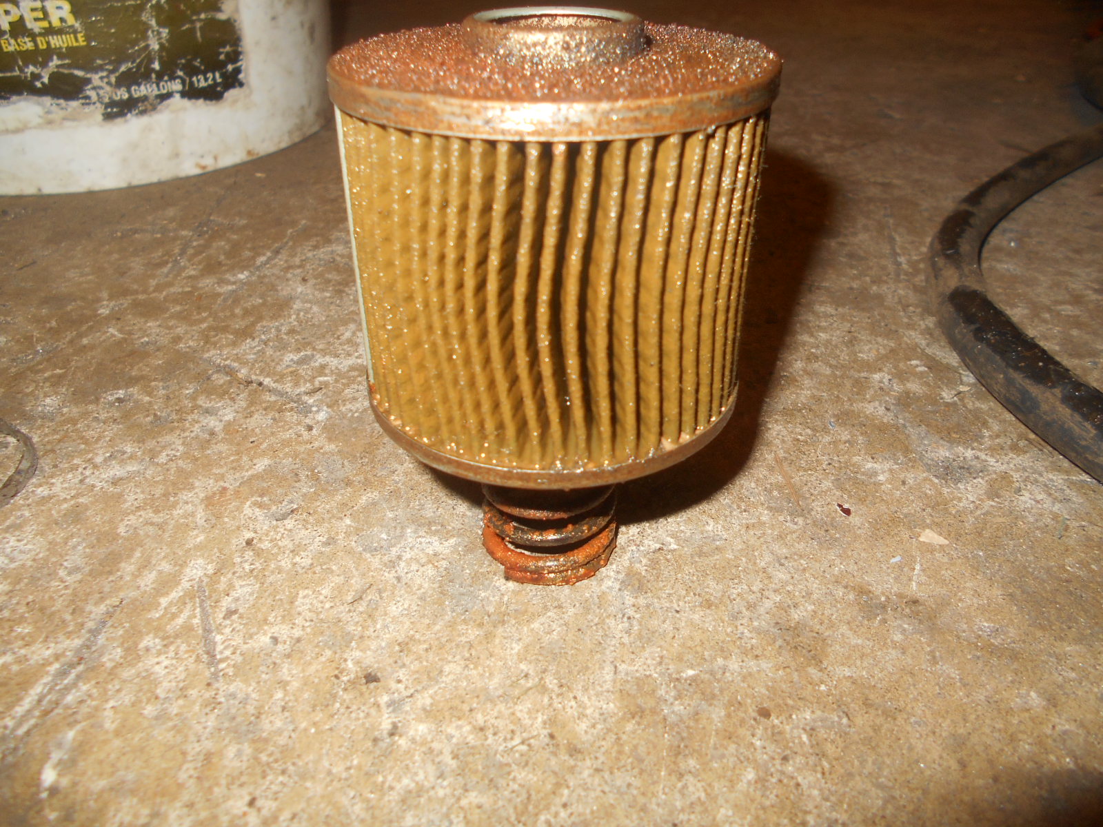

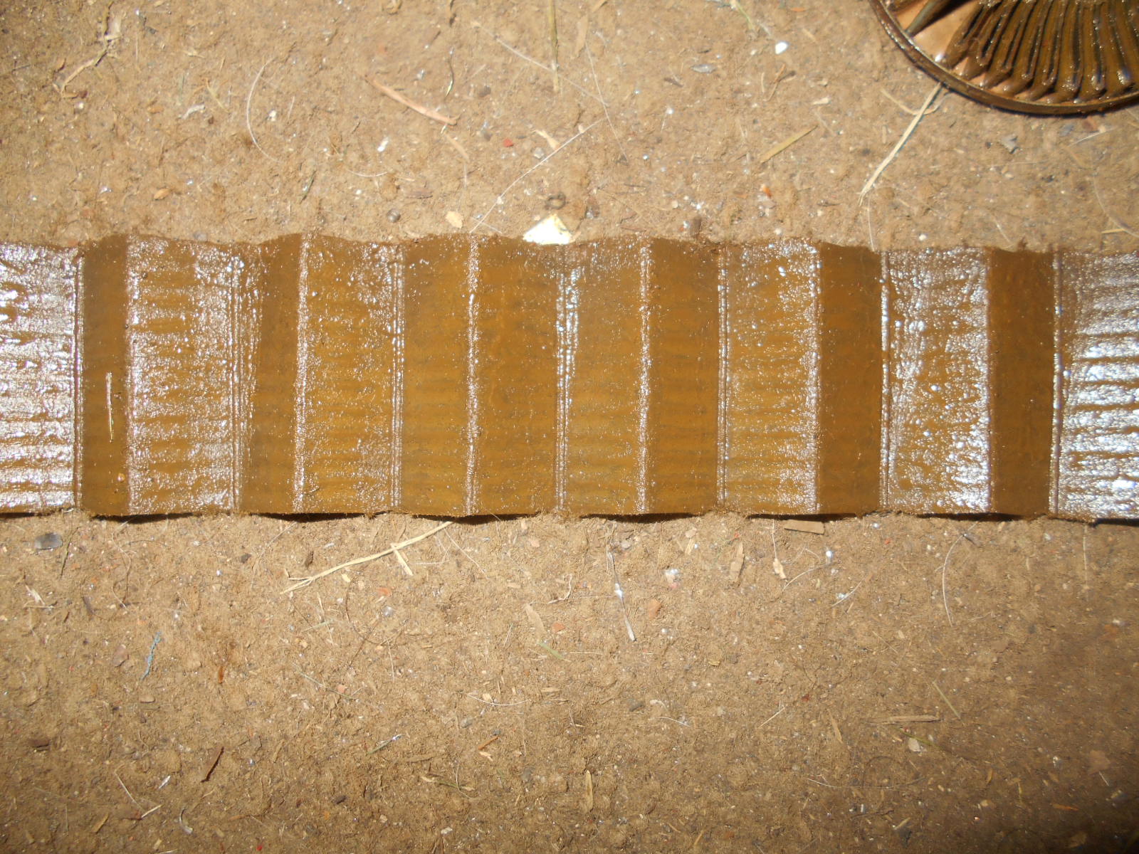

plenzen wrote:Did you cut open your old main filter ?
Never actually thought about doing that, so I did it just to see what it looked like inside, not what I expected.
I don't have a clue if it looks bad or not, but that rusty spring on the bottom makes me think there was water in the filter for a long time, but the bottom of the inside of the filter wasn't that bad.
It still lost power after I changed both filters Sunday, I lost power on the way there(5 miles) and I lost power again when I had almost made it home(50 miles), I have had no issues since, but I have not been on the hiway/freeway since either.
Here are the photos.

You can cut the medium top and bottom against the plates and stretch it out to have a closer look. But I'm betting it plugged with water etc.
I be thinking you got yourself a tank of funky fuel. Maybe their in ground tank was near empty and you got the dregs, rust, water and .... well,, troubles.
Is there anyway you can pump some out of your tank into a glass jar and have a look ?

plenzen wrote:You can cut the medium top and bottom against the plates and stretch it out to have a closer look. But I'm betting it plugged with water etc.
My tank has a drain plug, I can empty the rest of the tank, but I drove today without issues, but I didn't drive it on the freeway/hiway, just to the bank, 2 stores, Riteaid, the L&I building and then back home without a hiccup.
That filter had been on the truck a very long time, sometimes I quit driving my rigs when another one has my attention, this one sat for a long time when the 720 had my attention, it also had a bad battery and the sitting not using it made it worse, so the fuel filter was forgotten about.
The rust colored specks on top of the filter element are loose grains of whatever they are, rust chunks maybe, but it kept missing/losing power exactly the same way when I changed the filters, so maybe one of those rust grains got in the banjo fitting, I don't know, I was planning on removing the banjo fitting and looking it over real close tomorrow, and then possibly replacing it with the new one I have on that NOS complete filter assembly I have, if nothing changes I can put it back to the way it was, I just want to figure it out changing one thing at a time till I figure it out and know exactly what it is next time.
I have always run a pre-filter on both my diesel trucks, and the pre-filter element had been sucked flat 3 tanks before this issue, so maybe that filter got a hole in it when it got sucked flat and let debris thru and it finally caused an issue, the only reason I use pre-filters is because I want to protect the fuel pump from contaminants that could ruin it as they were not readily available on ebay 7 years ago like they are now.
Maybe if it is not raining I will lift the truck up and drain the tank instead, but it runs so good around here that I don't think it is a bad fuel issue, I only have issues on the hiway/freeway when the fuel requirement is steady, I think the banjo fitting should be the next thing to look at.

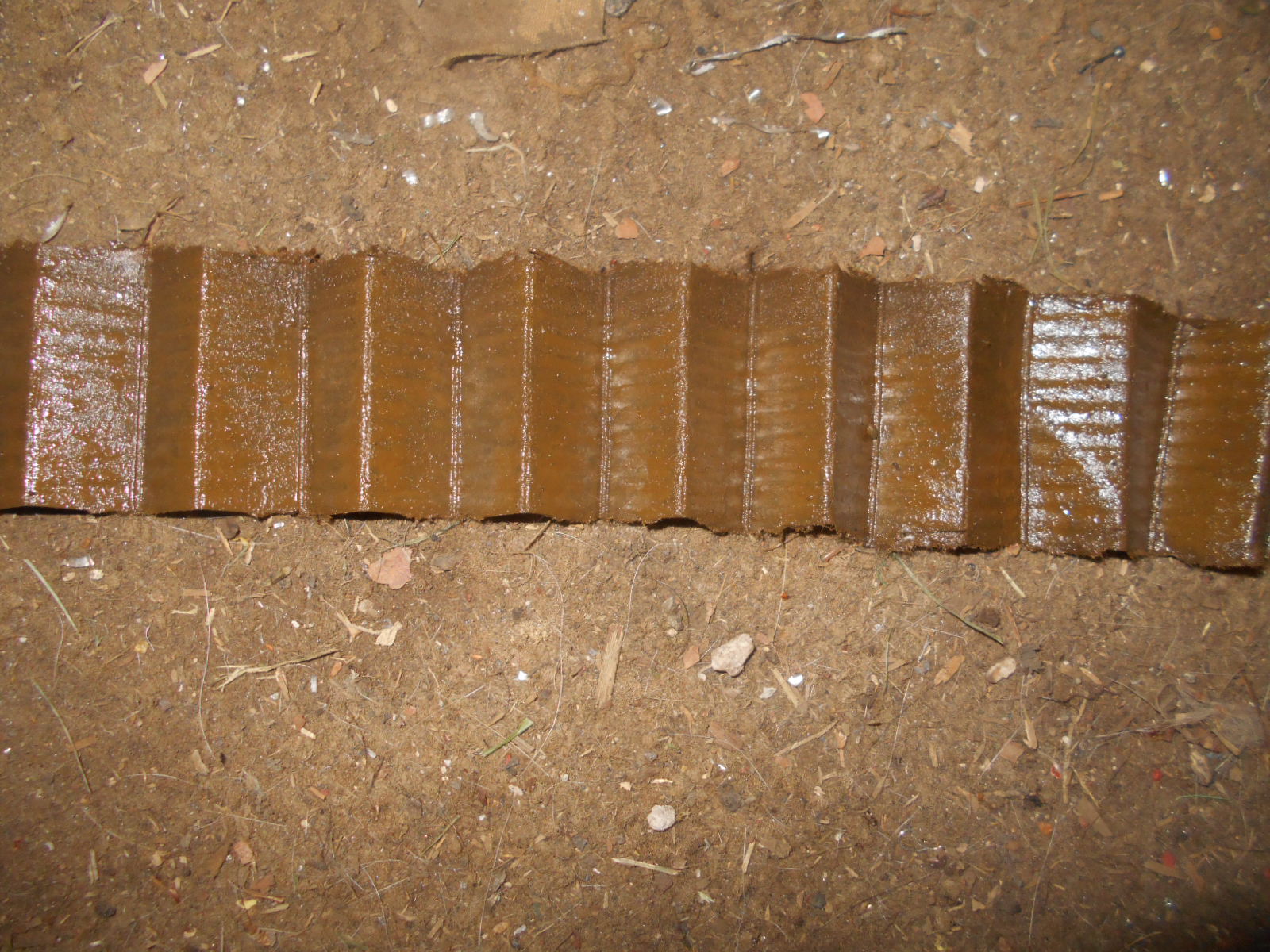

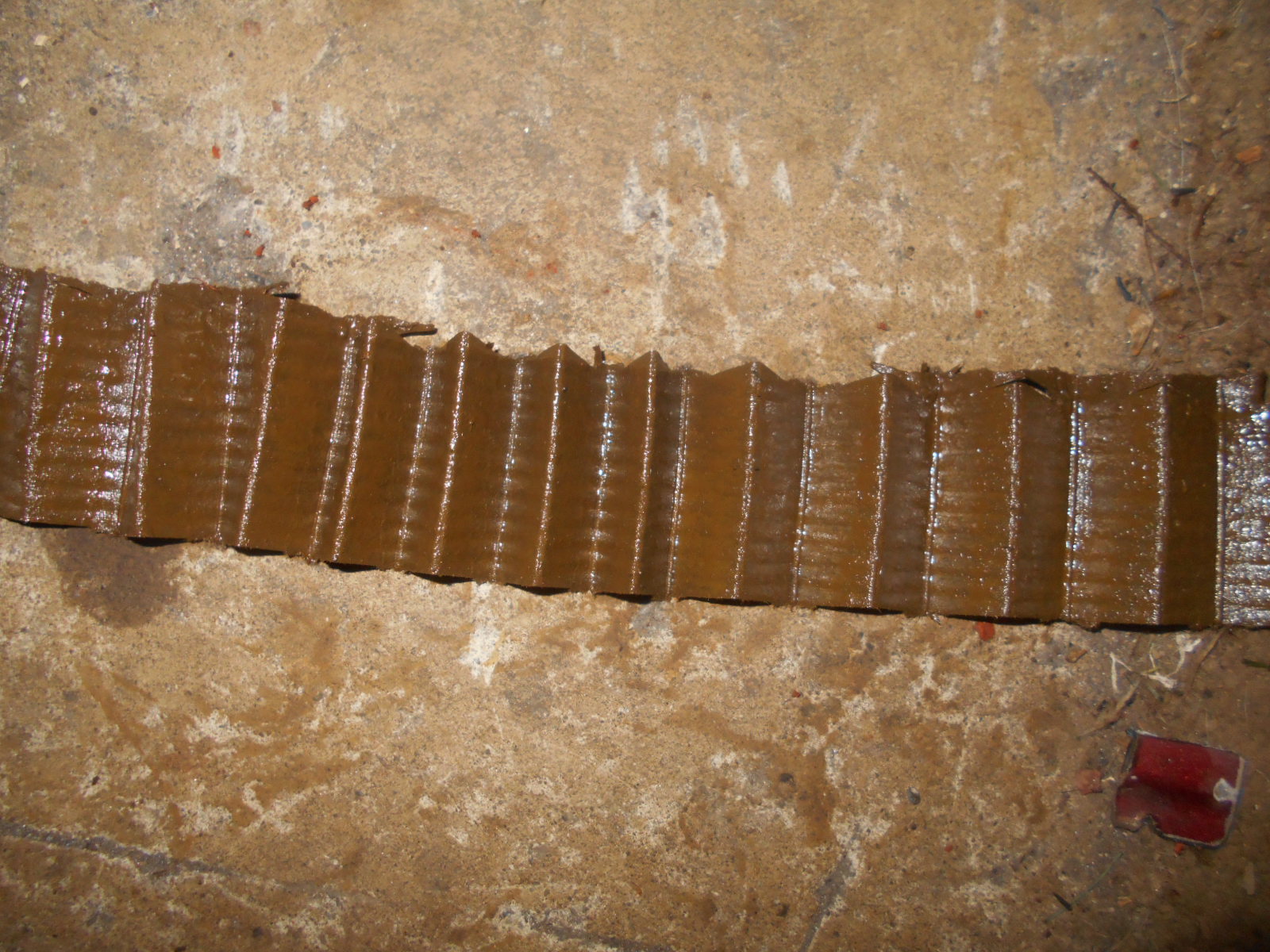

I don't know what water looks like, but the whole thing has a shiny light brown film on it, no chunks like rust grains on it though.
The back is darker and not shiny, drier looking.
What baffles me is that I drove over 110 miles before I started losing power on that tank, when I think of water I think it will settle to the bottom and screw things up right away, but when it starts messing up if I pull over and let it idle for a while and I am good to go again, at least around town.

I appreciate the pics you put up. Just now I remembered an incident that I dealt with few years back. I have very little experience with water in the fuel, but my 94 Chevy pickup has a water in fuel light on the dash. I put a 5 gallon jug of diesel, which had been setting for a short time, into the 94. Very shortly afterwards the W-I-F light came on, I drained the water filter, and never had any problems, then or since, with the motor.
In the filter you cut open I would guess that the shiny surface you described on the filter media would be water, but I have no experience with what water would look like on a filter surface. So, any information you come up with in the future about this situation will be a big learning experience for me.
Since there is a drain plug in that tank one thing I would do is drain about a gallon out of there and let it set for a while in a glass jug and see what it ends up looking like. Hopefully what you get out of the tank is from the bottom.

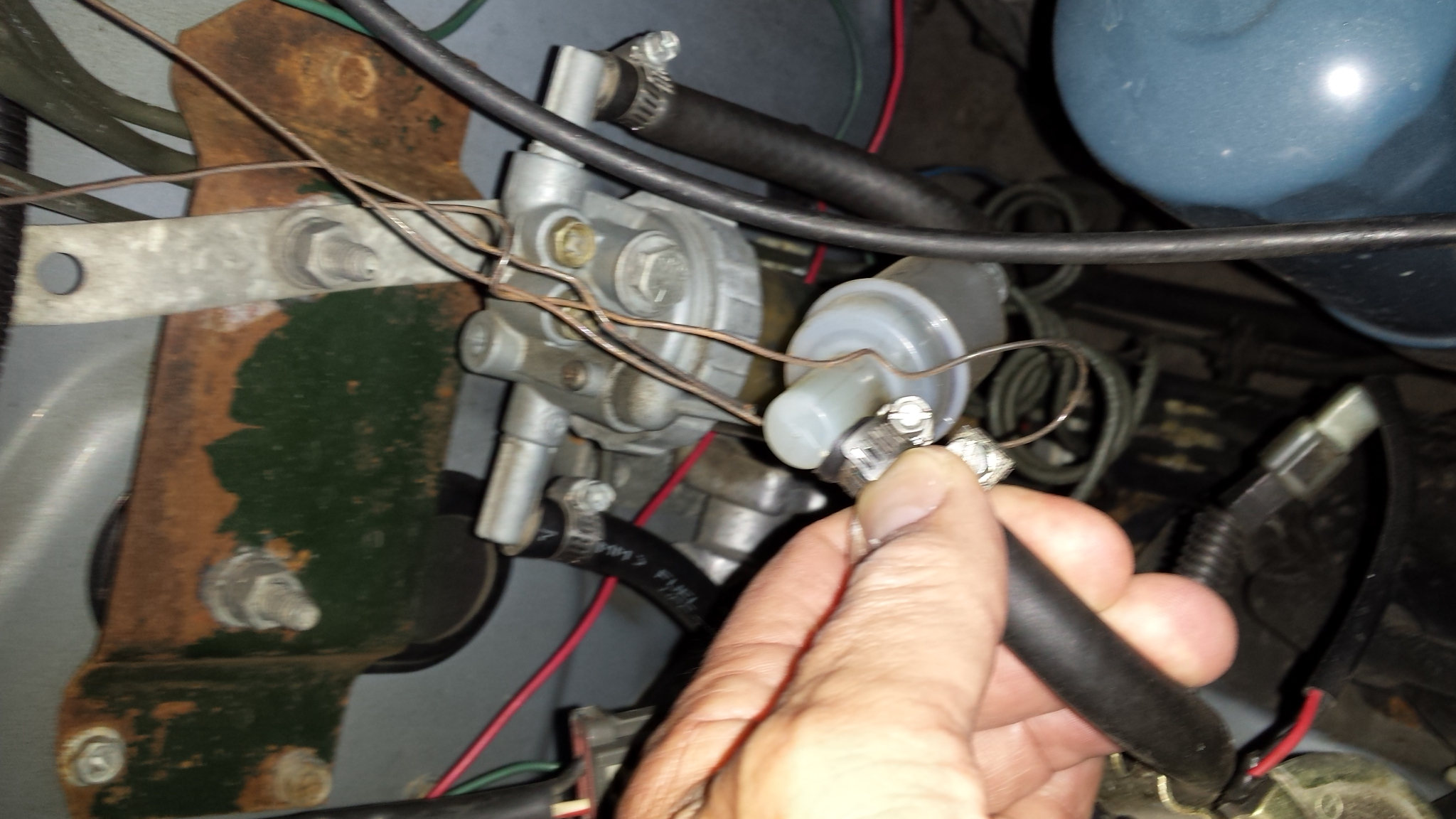

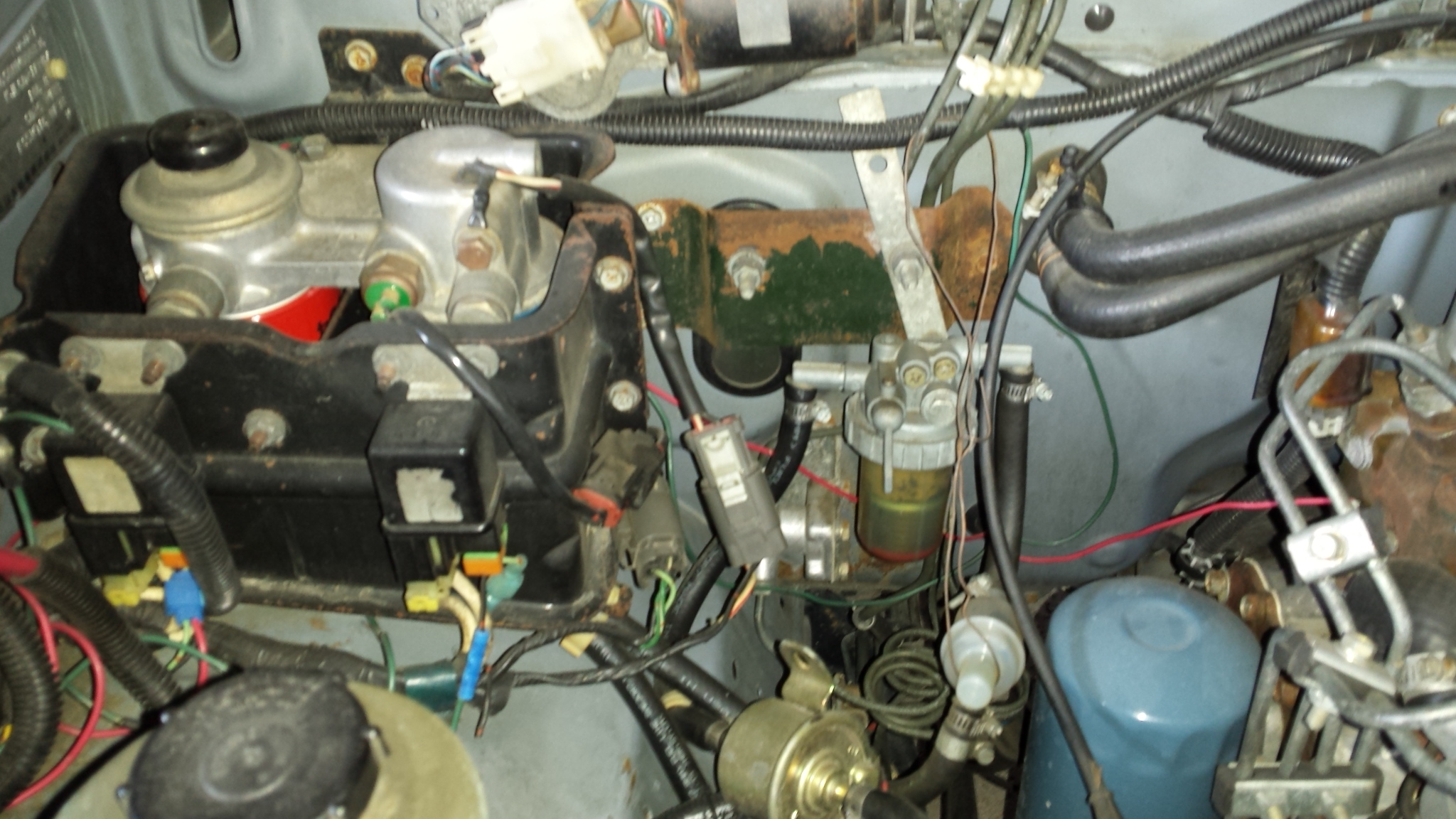

I use this for a water separator. I use it in conjunction with the OE one that is next to the fuel filter.
The picture with my hand in it shows the pre-filter from WIX for the diesel Mercedes.
The OE water separator has a fuel heater in the top of the housing and that's why I keep it there. The smaller one on the firewall is far easier to service should water accumulate in the tank. It has a small red ring in the bottom of it and if water is present it will float upwards letting you know how much water is there.
Its small and is from a Yanmar industrial diesel engine. I had a Racor separator on it when I got the truck from my dad and I had nothing but problems trying to get the O rings to seal on it and it ended up sucking air all the time.
The engine would run out of fuel climbing a hill. Driving around in traffic and on the level was fine but if it had to "work" at all it would lay down. I removed it and put this little guy on and it's been fine.

I believe that Don may be correct in that the sheen is water.
Would be interested to see what the fuel that you drain from your tank looks like.
Just had a thought here
If you have a strong magnet you can run over the stretched out media and see if it collects anything from the element.
If it "rusted" it should be ferrous and stick to magnet. Wipe it onto a clean white paper towel and see what you get.
Maybe fold it up and put it in a sandwich bag and into the freezer and see if it freezes. Might be a way to see if it is water or not,,,,,,,,,,,,,,,,,,,,,,,,,, maybe.

Look at your second photo of the fuel filter, the one that shows the center section of the fuel filter. That is supposed to be the clean (filtered) side. No matter how dirty the outside of the filter looks, or the cup (also the dirty side), the clean (filtered) side better look clean. I see all kinds of gritty crud on the clean side. Which means it is likely to have migrated into the IP.
Before we condemn the IP, have you checked for air intrusion? Splice in a section of clear fuel tubing at the IP fuel out fitting and check for tiny bubbles immediately after the problem reappears. Shouldn't be any.
