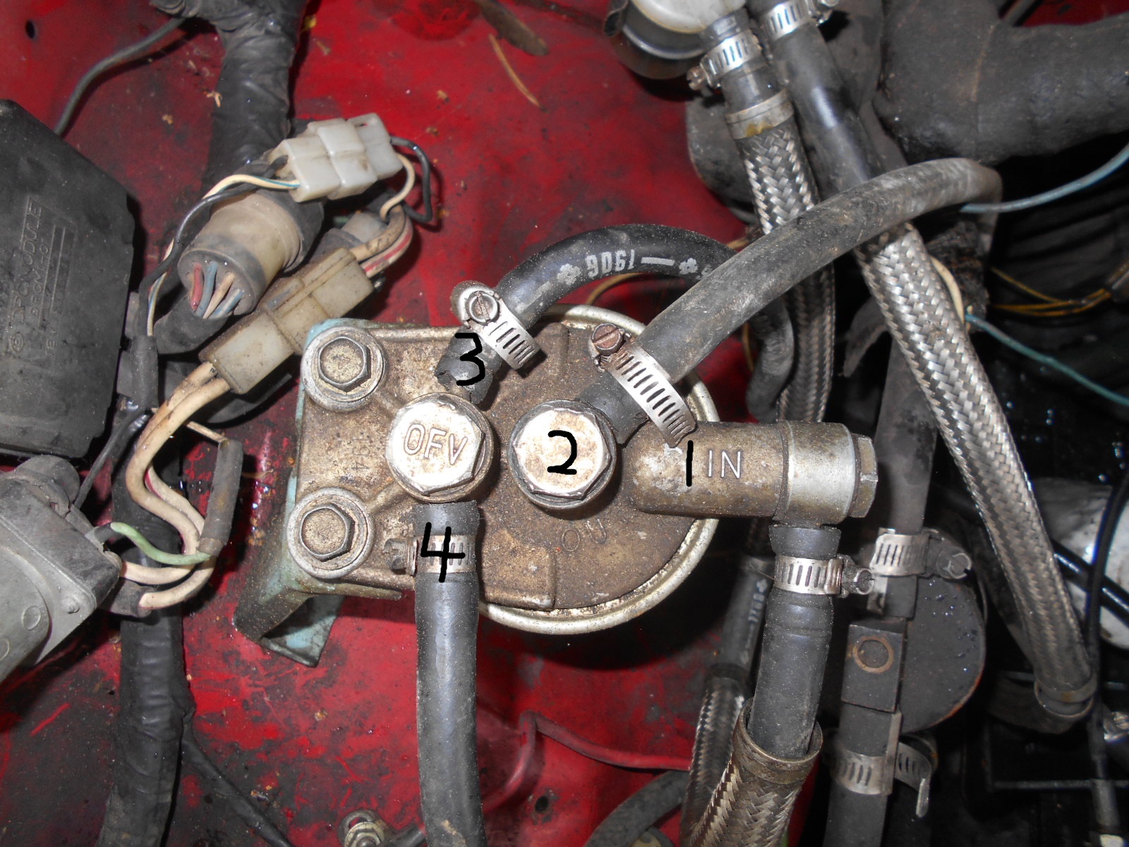

OK, in the photo attached I have numbered the fuel filter lines/fittings, #1 fitting is the line from the lift pump, #2 line/fitting goes to the front of the injection pump, #3/4 lines are interchangeable, one comes from the injectors as over flow, and the other is the return line to the tank.
Is your filter set up like this?

cseger1
- Posts: 122
- Location: Houston TX
cseger1
- Posts: 122
Re: Lift pump isn't getting it done.
