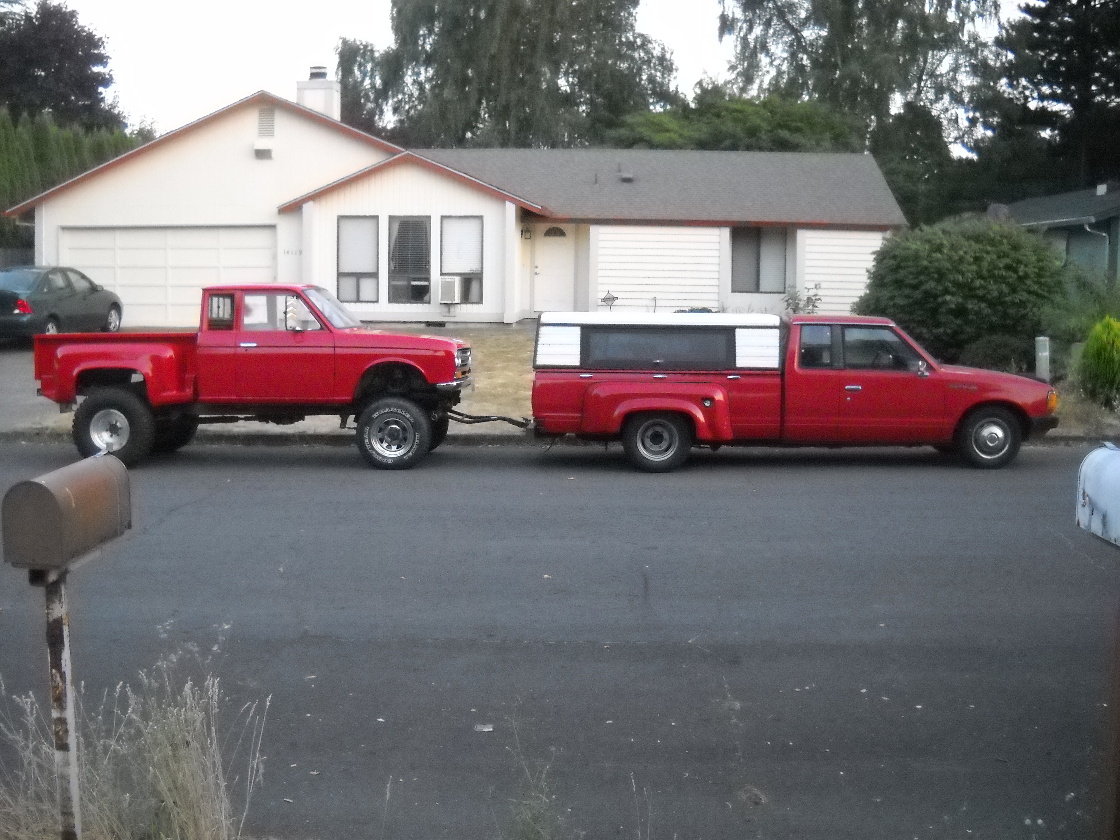

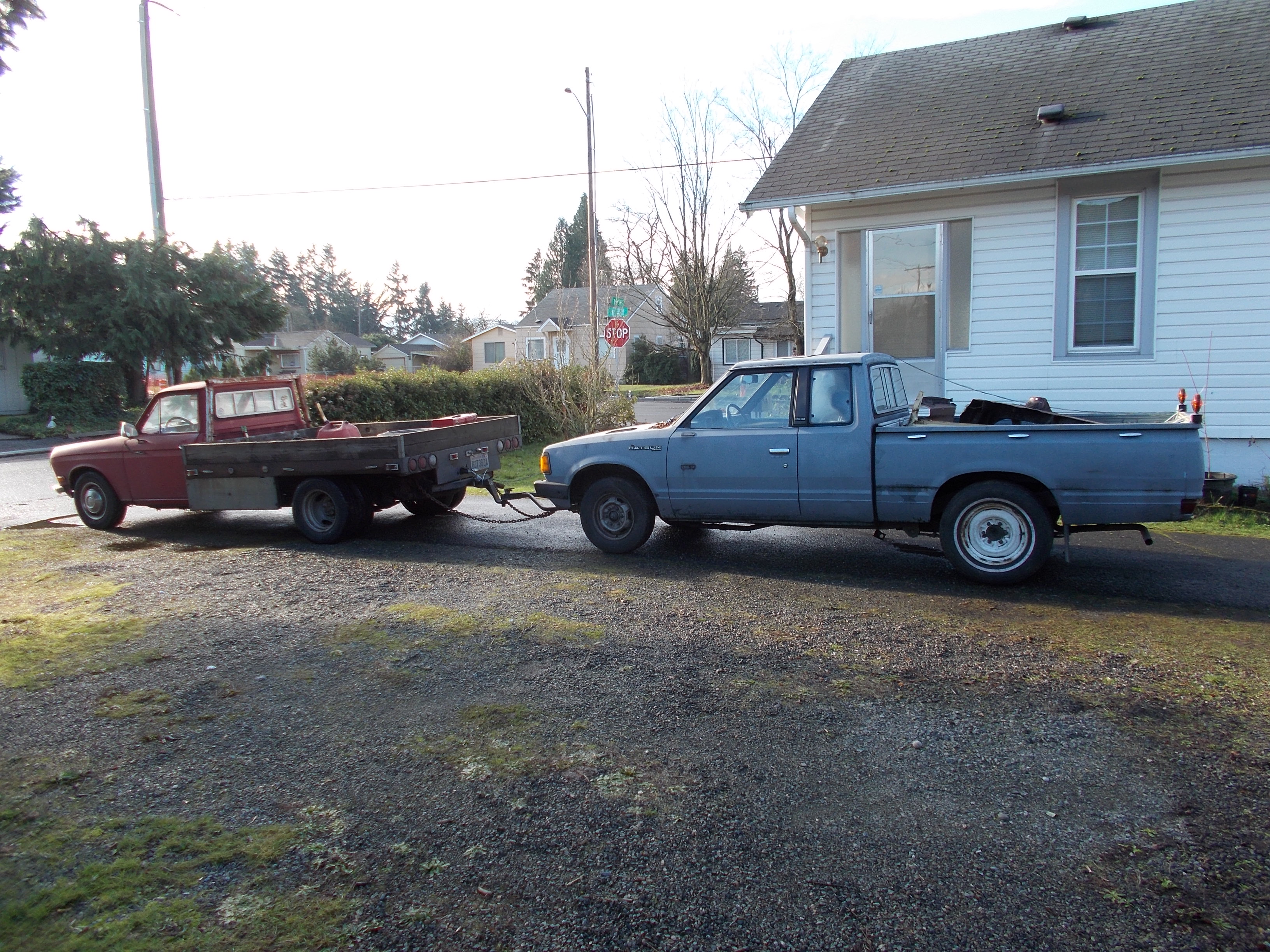

I have loaded up my Datsuns in the past with loads that all of you would say, "Are you insane?", I have towed several 720 diesel and gas trucks with my 720 diesel truck using a tow bar, sometimes it was scary, and the worst mileage I ever got was 21mpg.
The 720 diesel doesn't have a lot of power, so if your on flat ground your fine, but on a road trip with a lot of hills, leave the SD22/25 diesel at home.

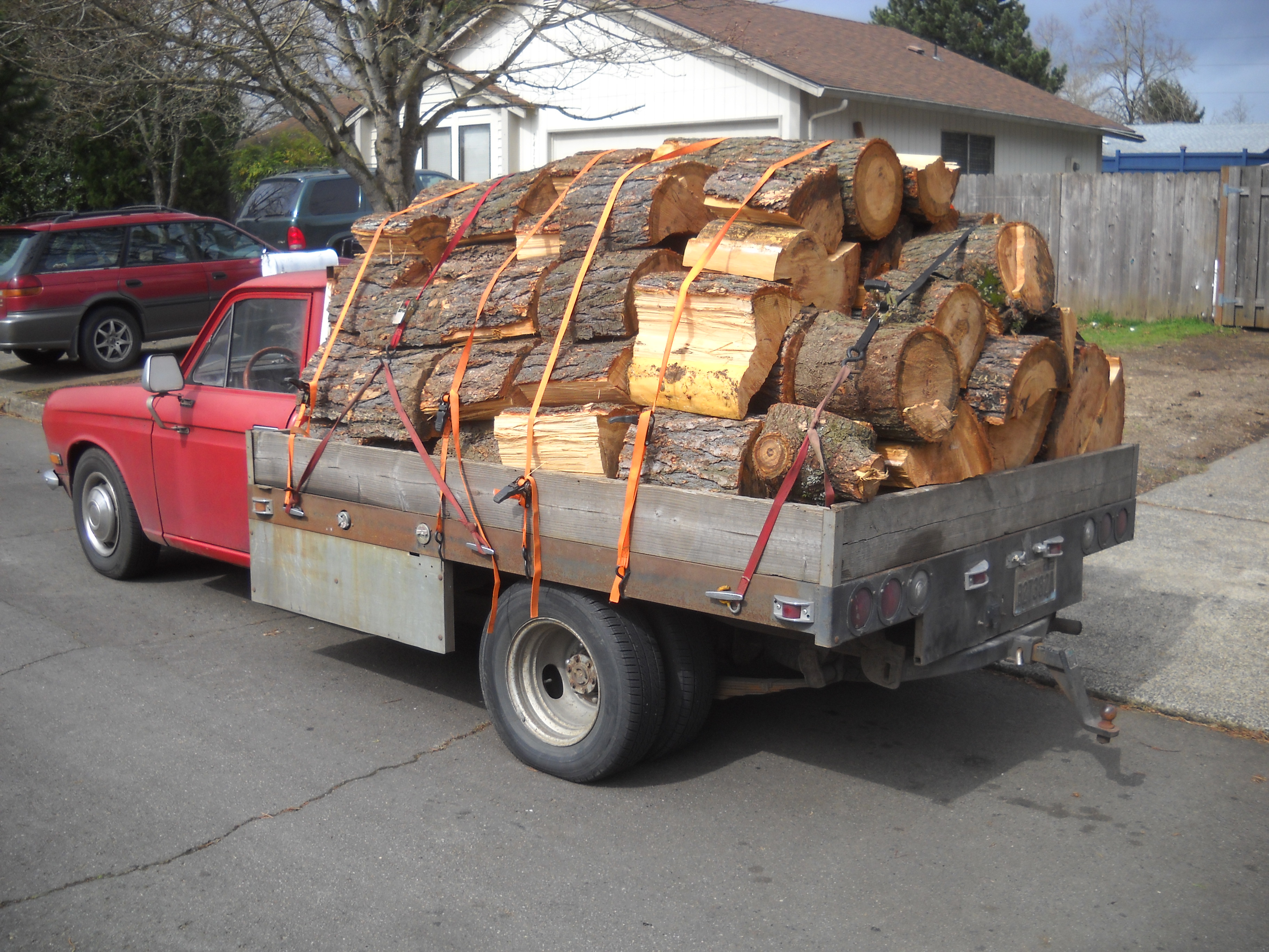

I also have to say this, if your going to tow a vehicle, with a tow bar especially, the tow vehicle should be a dually, the difference is night and day, 4 tires on the ground can be scary when towing, 6 tires on the ground is a pleasure.

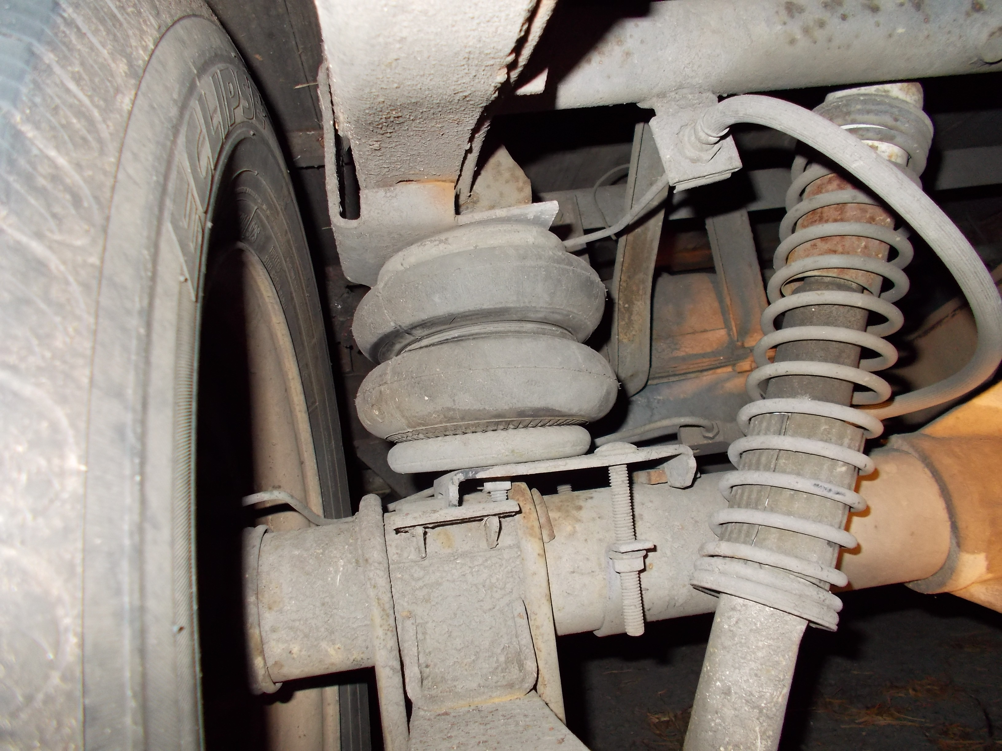

One of the photos is of my 720 diesel dually towing a 521 diesel 4X4, another one of my 521 dually with a load of wood, and the another one of the 521 dually towing home a 1982 Datsun diesel, I tow only with dually trucks now, the 521 dually has 2 extra leafs in the stock spring pack, it has coil over over load shocks, and it has overload air bags in one of the photos.

The rear axle is a stock 85/86/87 Nissan daully axle, they came on cab/chassis trucks and on Nissan motor homes of that era, the rims look like normal big truck dually rims except they are 14 inch rims, Toyota also had dually axles, but there is one drawback, the dually axles do not have the gearing for a Datsun/Nissan diesel truck, the best hiway gears that can be put in the dually axle are 4.10s, the stock Datsun/Nissan diesel truck has 3.89(3.90) gears, that puts the engine at 3000rpms at 70mph, if one had 4.10 gears in the 720 diesel truck, max speed would be around 50/55mph and the engine would be screaming, that 720 dually diesel truck towing the Datsun 521 4X4 in the photo is a cheat, I could not get the gearing needed in the dually rearend, so I had adapters made that allowed me to use dually rims on a normal Nissan 720 H190 rearend, I trust that truck to tow other vehicles, but I would never load it up with a lot of weight, the adapters are for looks, they are not made to haul any kind of weight.
This red dually 720 diesel truck has 3.30 gears in the rear, it is also turbocharged, I could never turn them type of gears without the turbo unless empty.
Here is the thread about the turbo engine.
http://nissandiesel.dyndns.org/viewtopic.php?f=5&t=3474
The Datsun 521 truck with the dually axle with the load of wood has a gas engine, it is a true Nissan full floating dually axle made for weight, not that kind of weight though, the bed/tray is 79 inches wide as per law so that I didn't have to use top of cab running lights, and the wheels are tucked in on each side about 1 1/2 inches, I should have mud flaps, but they both got ripped off by accident when I backed up a curb, I guess I didn't give mounting them enough thought.
