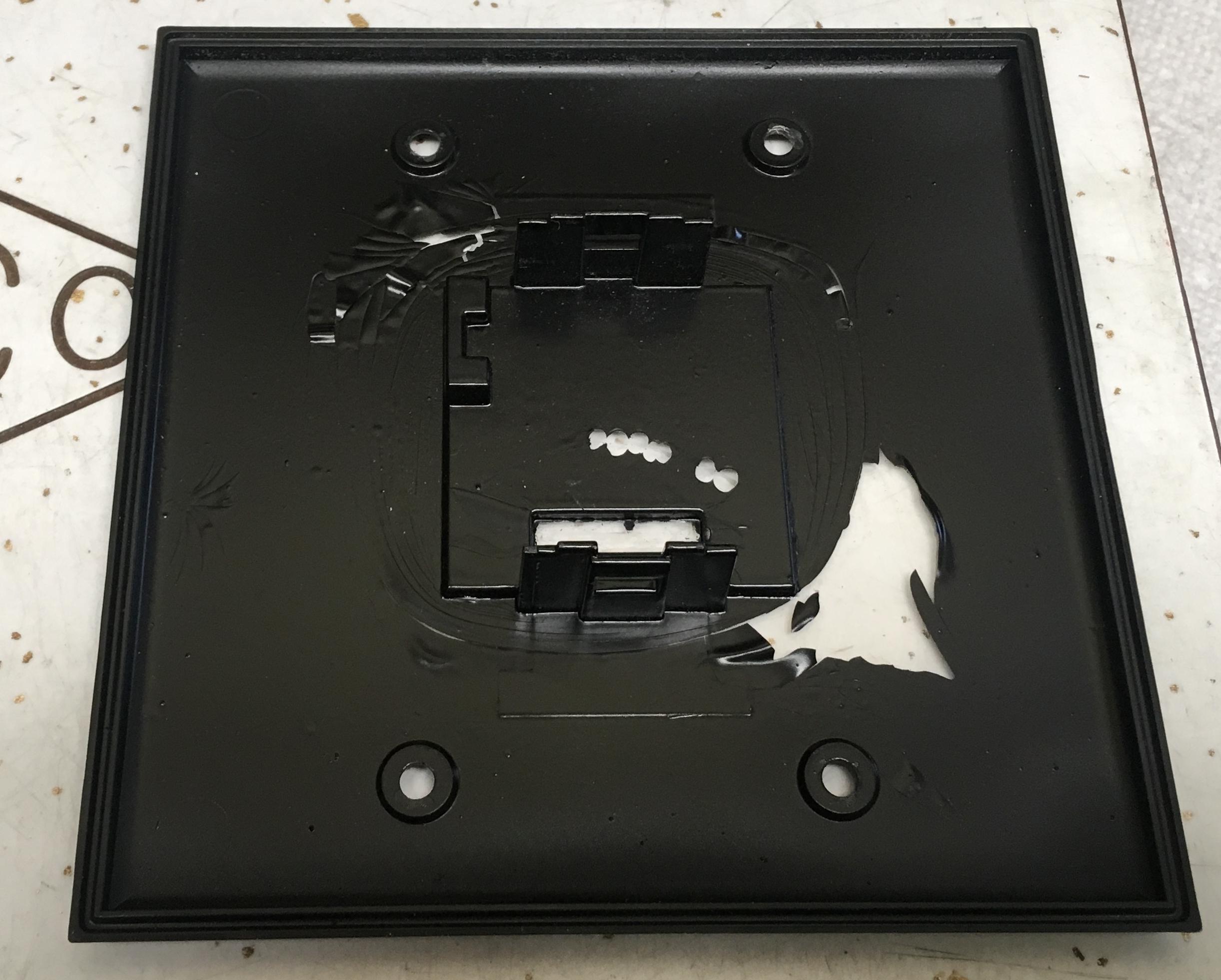

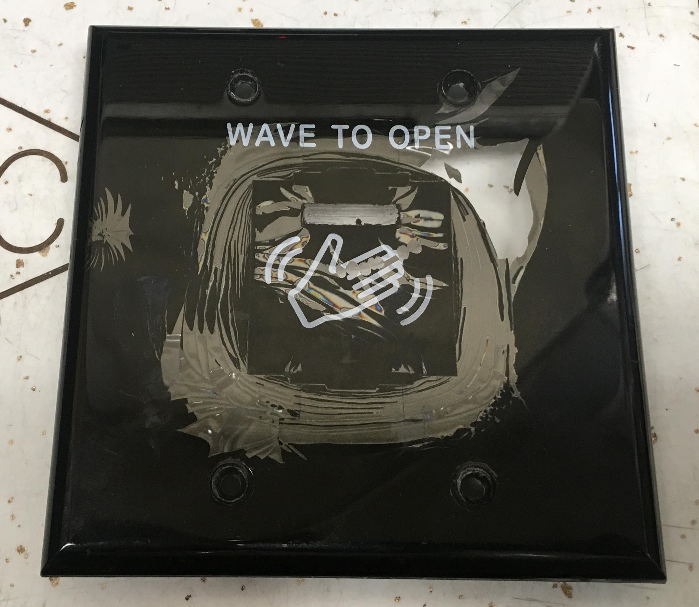

I had another one today, same problem: they hit the face plate hard enough to flex the paint off the back. The clear plastic is painted on the inside, and the paint is not as flexible as the plastic.
Despite the appearance, the plastic is not cracked, only the paint.
Hit hard.
Hit hard.
Paint came off the back, due to flexing of the plastic.
I used the same method to repair, though I replaced this wall plate with a spare. And I cut the slots in the nuts wider (two passes with the bandsaw), so the wire isn't as tight to fit in the slots.

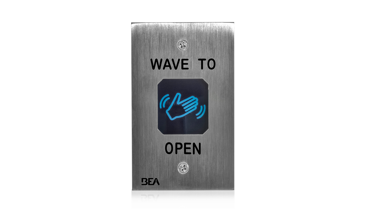

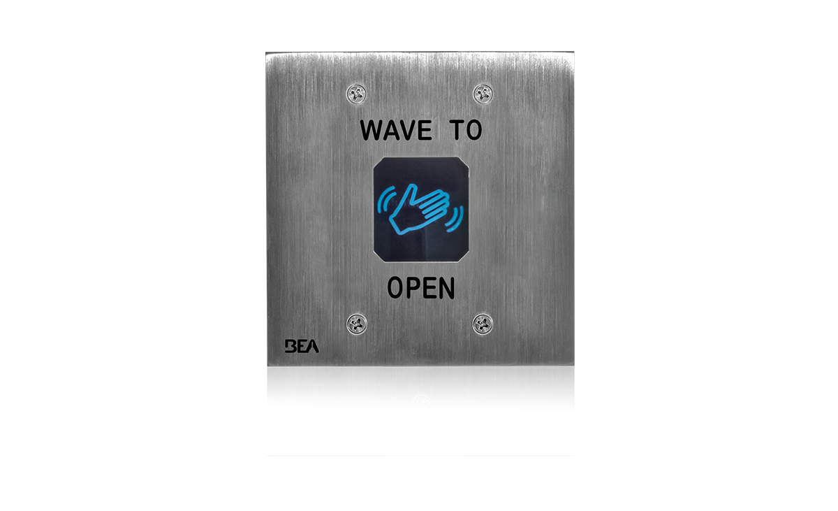

I've now switched from installing the MS08 to the MS11, which has a SS front plate and no clip mounts for the sensor, so this thread is obsolete for me.
BEA MS11, Single Gang version
BEA MS11, Double Gang version
