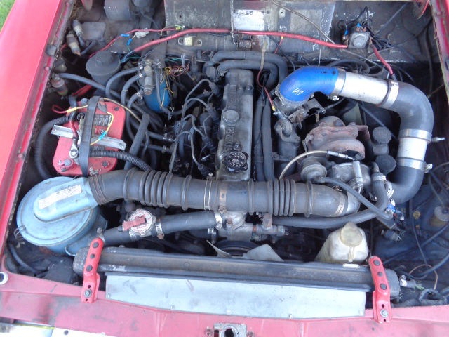

I really like driving my 1969 Datsun 521 kingcab with the SD25 turbocharged diesel engine, but I hate replacing the alternators and starters, the fact is have to remove the alternator to remove/replace the starter as you can see in the photo, removing the alternator is a pain itself.
Do you think heat might be the issue for the alternators going bad, the exit for the turbo is right above the alternator(about 4"), making a heat shield for that is not going to be easy and air does get in there, but it has to go thru the radiator first, there are all sorts of wires/hoses in that area, the power brake vacuum hose, the turbo oil feed line, the turbo oil return line to the block, the alternator vacuum oil feed line, the starter cable, the block warmer plug-in wire, the alternator wires, there is a lot of stuff in the left front engine compartment, the right front is just as bad, I have to remove the diesel filter housing to remove/replace the oil filter, that I got all this stuff in there and had it work properly was a feat itself, but it was done one thing at a time.

That's pretty tight engine room you have there for sure. Lot's of stuff going on. Even a piece of aluminium dryer vent tube with a couple washers for spacers hosed clamped around the closest part of the pipe would help ?
I think it was Al or maybe someone on here years ago swapped to a Motorola 120 Amp ?? alternator and ran a separate 12v vacuum pump for the booster. Had a juice can reservoir and pressure switch mounted someplace.
That said, you don't appear to have any room for anything more under there, although the pump, reservoir etc could be remotely placed ?????? somewhere.
I know the down pipe on my SD25 ( natural ) has a heat shield all the way from the flange to where it turns under the fire wall. It's a2 piece aluminum with a hose type clamp at the top holding it to the pipe.
Dang Mr. That appears to be a "Project" to dig any of that out of there.

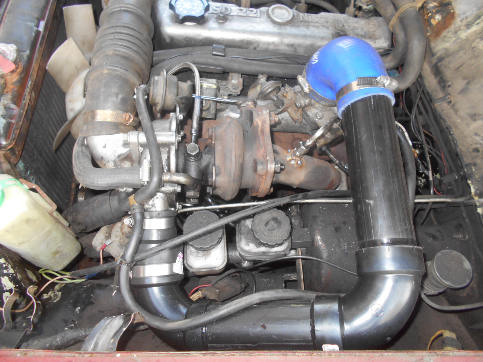

It does not even have the heat shield between the turbocharger and master brake cylinder reservoirs in that photo, I was still using ABS tubing when that photo was taken also, I really do not like working in the engine bay anymore unless it is something simple, starters and alternators are on my hate to do that list now.
My stock head pipes with heat shields do not exist anymore with the turbocharger, made my own heat shield for the head pipe near the starter to try and keep the starter solenoid cool, but the rebuilt ones only last a week before I get clicks 50 percent of the time, if I hit my power bypass button/relay to the starter motor it usually starts right up without letting off the key in the start position, I would cut a giant hole in the inner fender but the steering column is in the way, it has just got old recently, this last alternator did not last long and I am out of functioning good ones now, I pulled the brushes out of one that did not work(tested by me on my test stand), the brushes were over an inch long, they looked great, I do not know where the diodes are or what good ones look like, but I am willing to take them apart and make good ones if I can out of parts from other alternators, I have about 7 of them now that do not work properly.

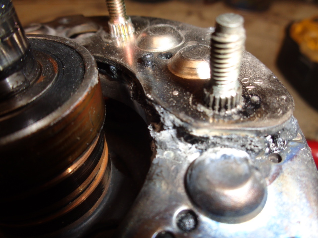

I pulled a couple alternators apart yesterday, I just do not understand them, I suppose I should have tested each one before pulling them apart to see if the light worked first as after pulling a few apart and putting them back together as none of the lights worked after that.
The first one I pulled apart looked completely smoked, sorry the photo did not focus that well but the plate looked burnt and it had what I would describe as ash between the upper plate and the lower plate, are these plates the diodes?

Diodes. Diodes blow apart (but the potting keeps them looking like they're still in one piece) on the Hitachi LR150. And the VR will often get taken out by the bad diodes, so you change 'em both. I've been into a LOT of 'em.

The six diodes are welded to the c-shaped plates and then potted in a silicone. Six stator wires are soldered to them. On the Hitachis, you replace the the whole diode assembly as a single piece.
