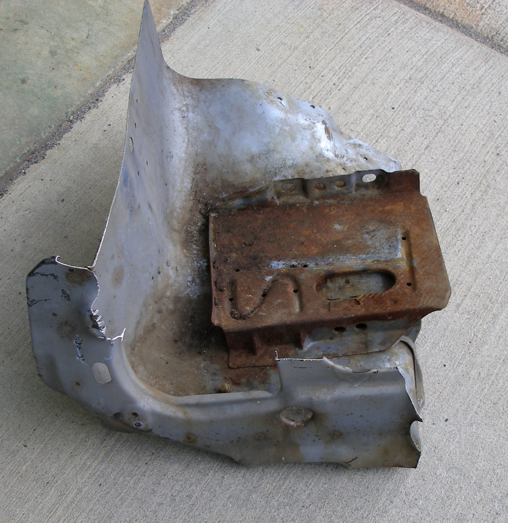

Still haven't had time to check on the trans length thing, but I did take a battery-operated Craftsman Sawzall to the JY yesterday, and had my pick of three good almost-rust-free 720 battery boxes. I decided on this one because the bumper, grille, and fender were already pulled, making this literally a two-minute job with a fresh battery and new blade:
Image Image Image Image
Believe me, for the PNW this is a very good looking battery box. Note that it does not have the extra bolt-in bracket behind the battery like a lot of them do.
Some trimming, and quite a few pop rivets or bolt/nut/washer combos, and this should overlay the "Arlington Trucks" rusted-out battery box nicely! The JY charged me a measly $1.50 for it -- you read that right. I doubt I'll get that deal again.
(Hmmm. Hard to believe, but I don't seem to have a pic of the rusted-out battery box on the yellow truck. It's bad but a board layed over it made do, unlike the "Orting Truck's" battery box, where there is more tire showing than support metal! I should maybe cut out a second one for it, but I think I'll wait until I figure out what I'm going to do with it.)

Today I took an hour and turned this
into this:
Image Image Image Image Image
I only bolted it in, Peter had spent a couple hours and trimmed out the old, rusty box and did a fair job of trimming the new one up to fit. The original plan was to use pop-rivets, but with the aid of welding clamps I was able to use 10-32x5/8" machine screws, fender washers, nylock nuts (all stainless steel).
I used a dozen screws to do this -- well, I broke or stripped three, but there are a dozen installed, and it's quite solid.
