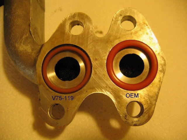

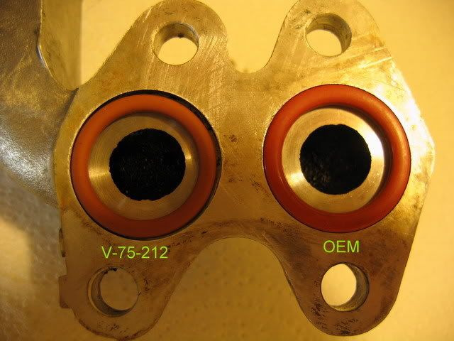

On the o-rings: In order to get what I wanted, I ended up buying a bag of two sizes by accident -- I had to make a minimum order. So I have something like (80) o-rings in two thicknesses for the SD coolers. I ran across them today again.
As indicated by the part number, they are both Viton 75 material.
The -119 is
15/16" ID x 1-1/8" OD x 3/32" cross section nominal.
The -212 is
7/8" ID x 1-1/8" OD x 1/8" cross section nominal.
(the sizing chart is on the right side of this page.)
One of these sizes fit the oil cooler pretty well, IIRC. Since the o-rings are not available from Nissan anymore, I offer some of these to anyone who will verify which size works ;) Free. You pay shipping.

asavage wrote:-SNIP- As indicated by the part number, they are both Viton 75 material.
The -119 is
The -212 is

My o-rings are for the oil pipe (the rings shown in red).
I can't advise you on removing the "radiator" from the aluminum housing; the usual methods should apply.
I will send you four of each size; your job is to tell me which size fits better.

Post by TDI_Joe »
Al,
I received the O-rings and have made a size check. Looks like V75-212 is the best fit.

Thanks for the check, Kevin. I've printed out the appropriate pic and put it in the zip-lock baggie with the V75-212s, so I know which are the ones to use next time.
I have (21) left.
