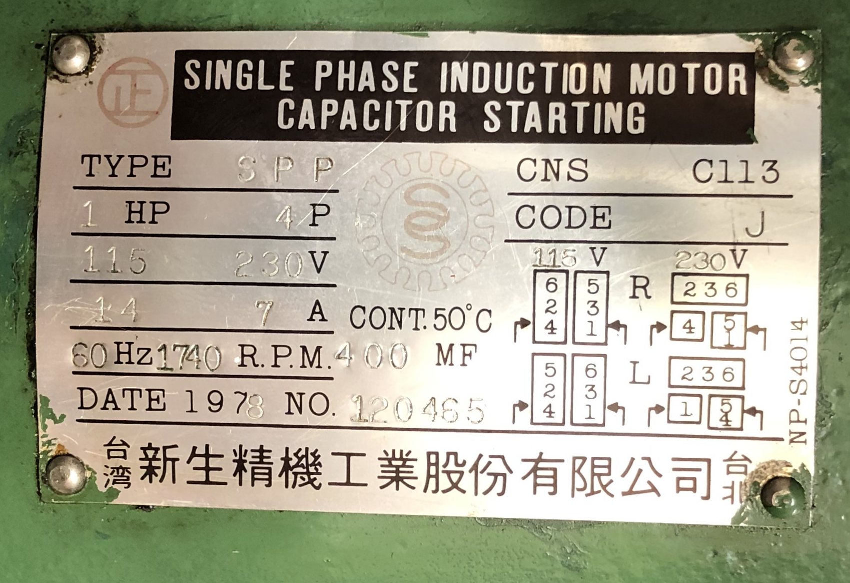

The motor is dated 1978, so it's coming up on 30 yrs old.
Jet-16 motor, 1978.
Jet-16 motor, 1978.

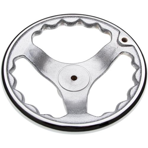

. . . and the forward one has been epoxied. Jet (WMH Tool Group) has obsoleted all parts for this antique, so I just ordered two generic "cast metal" wheels from Grizzly ($9 ea.)
[dead link 2020: it looks similar to today's Grizzly H3190:]
Grizzly H3190 - Cast Iron Handwheel - 8"
and I'll have to bore & ream them to 3/4", then cut the three-lobe jaws on the backside to interface with the table dials. I will actually be using the Jet-16 to make parts for itself :)
The 3/4" bore does not seem to be available for a 6-1/4" wheel from anyone, and neither is the jaw setup, so I'm pretty much stuck with having to fabricate it.

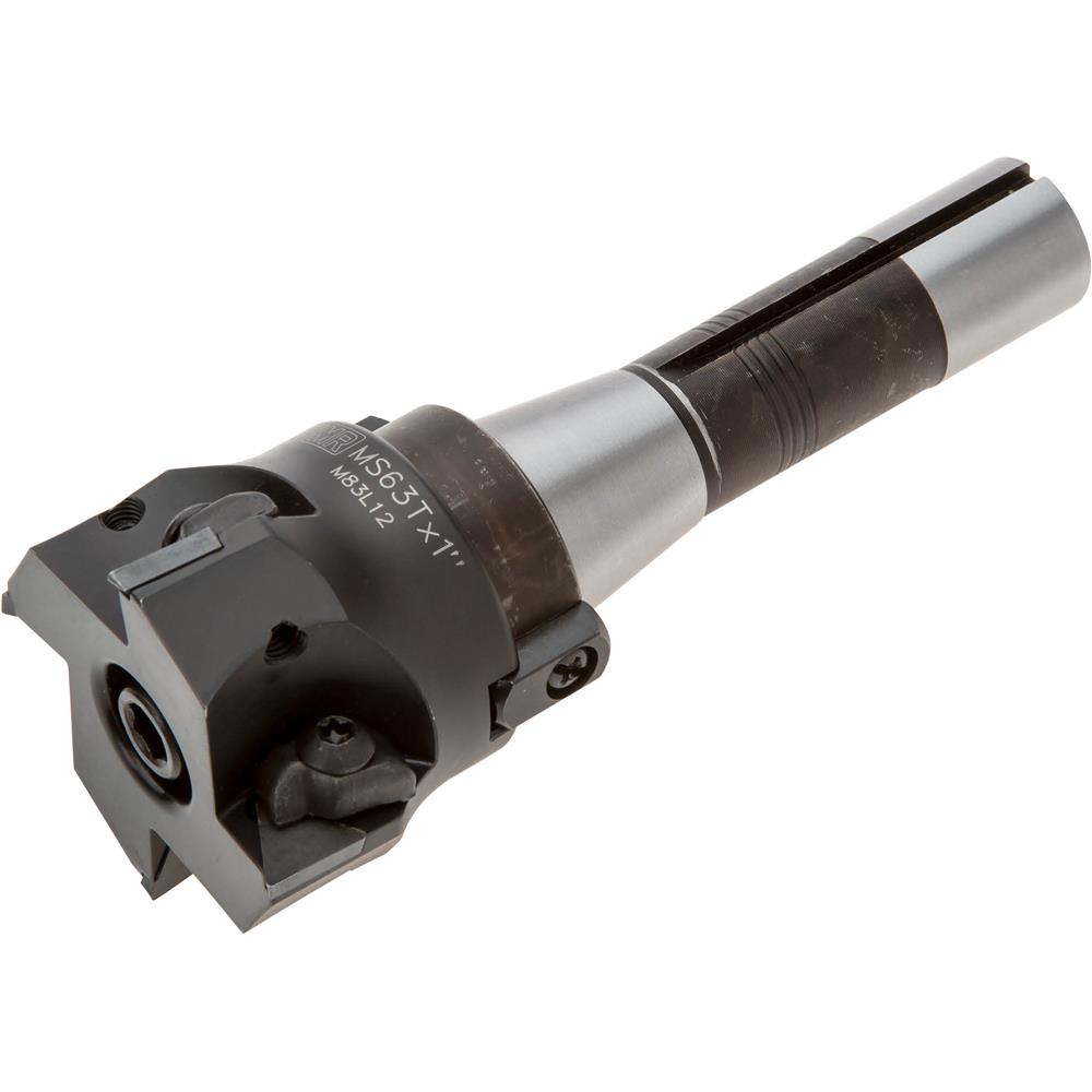

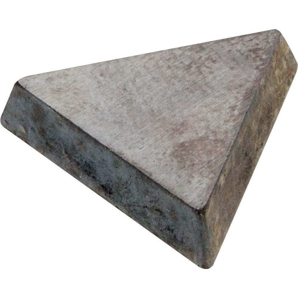

I ordered a fly cutter indexing face mill from Grizzly
Grizzly G2861 - Face Mill
along with some carbide cutters
Grizzly G4051 - Carbide Insert

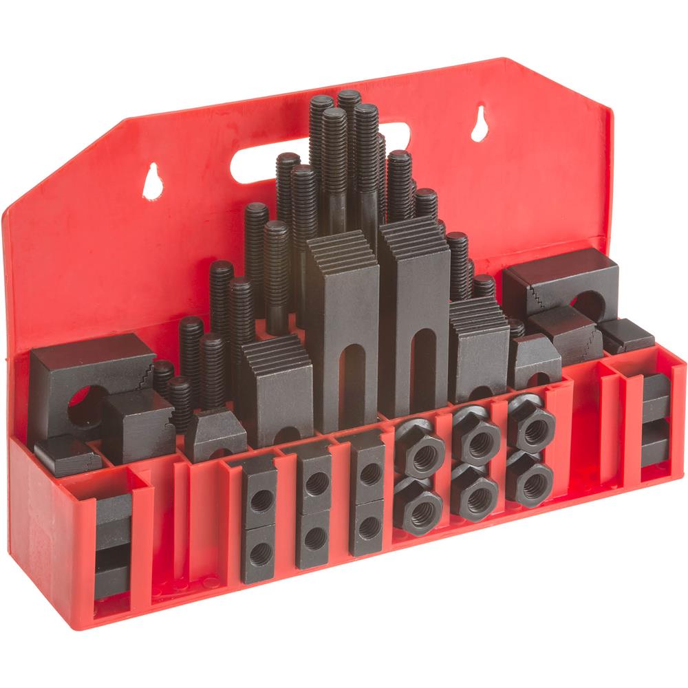

and some holding fixtures/clamps
Grizzly G1076 - 58-pc. Clamping Kit for 5/8" T-Slots

Got the flycutter face mill today -- it looks a lot better in my hand than that picture would suggest -- as well as the clamps set. As I suspected, the t-slots are too wide for my table. First order of business: use the face mill to narrow the t-slots to fit! Took four passes, works a charm. Nobody told me how much fun this would be :)

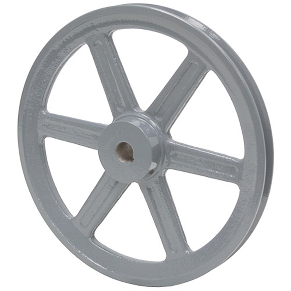

The pulley you are looking for (this and MSCDIRECT.com are wonderful sites)
http://www.surpluscenter.com/item.asp?U ... powerTrans
6.25 OD 3/4 Bore 1 Groove Pulley<br />item number: 1-BK65-C

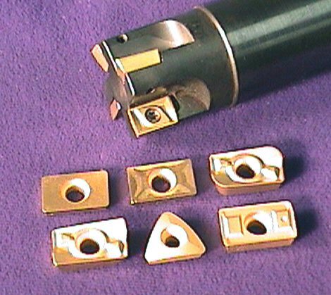

4) Don't worry about getting indexable cutters with the r8 shanks. Unless you plan on taking very heavy or very large surface cuts, a standard high speed steel endmill inside a r8 shank collet will work more than fine. Also just an FYI, if you get a traditional centercutting endmill you can plunge cut, allowing counterbore, spotfaces, or large very accurate holes. And a good rule of thumb, 2 flutes for aluminum, 4 flutes for steel.
Just a funny observation as well, I don't know why Grizzly calls that a fly cutter. Every place I've seen calls that and indexable facing mill.
A Fly cutter from what I'm used to is a slightly angled pate at the end of a shank with a slot in it for a HSS tool blank which can be telescoped in or out depending on the diameter of cut needed. They are a bit more low tech and slightly dangerous (when cutter spins it invisible and to heavy a cut will launch the tool blank) but they are also the most versatile and leave a very cool rainbow finish.

TooManyIdeas wrote:The pulley you are looking for (this and MSCDIRECT.com are wonderful sites)
That is a very good idea, to add a handle to that and voila! It becomes a handwheel. Better than the alternatives.
I received the two Grizzly handwheels today, and the hubs are a lot shallower and smaller than I expected, making them not as useful, because I can't cut the jaws out of them. The picture for the part above looks like there is a lot more meat to cut the three jaws from. Excellent find, Thanks!
OK.
Just one more of those things one can't easily pick up without working with someone who has learned this the traditional way.
I am playing with this machine more or less in a vacuum, which is scary.
Just a funny obsevation as well, I don't know why Grizzly calls that a fly cutter. Every place I've seen calls that and indexable facing mill.
Their catalog calls it a face mill. The packing slip & invoice have "fly cutter" which I now know is the wrong description.
I do not know what "indexable" means in the context of an end mill, but it seems to me its major advantage over a std end mill is that I can change the cutters out rather cheaply, rather than having to have the end mill resharpened. Do I have that wrong?

Indexable is a term given to an arbour that utilizes replaceable cutters. The common type is the triangle cutters that can be rotated 3 times before having to be replaced. It is very cheap and convienent to have repalcable cutters but...
A word of caution when it comes to carbide. Carbide likes continuos cuts on very hard surfaces. If you try and machine an interupted cut, (irregular surface where a smooth finish can't be achived with one pass) You will get very frustrated braking cutters. I find too that aluminum machines better with HSS than carbide.
For what its worth, if you take care of a traditional cutter, and maintain the proper speeds and feeds, it will take a long time to dull an endmill. But on the other hand, since you are learning broken, chipped, and cooked cutters are inevitable. I've been doing this for the better part of 10 years and I still mess up a cutter every once and a while.
