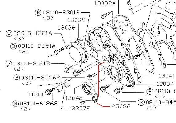

#29
Knucklehead wrote:In all practicality it doesn't make any difference because, 1.) the tach, which does have a different part number than the Z tach, is $217 (the gas one is $229). Moot, because it is not available anywhere, at all. 2.) The sensor (pn 25068) is about $60. Rush to your dealer now, because there is one somewhere in the US. 3.) I can't imagine finding a 720 w/ SD25 in a junkyard, so I'm back where I started.
For motorheads, I did get a breakdown of where the sensor fit. Looks like it reads the cam gear, which I suppose has an inset on it. If anyone has one of these trucks, you have a jewel of high interest!
More views of the same:
The full part No. for the revolution sensor is 25068-54W01.
