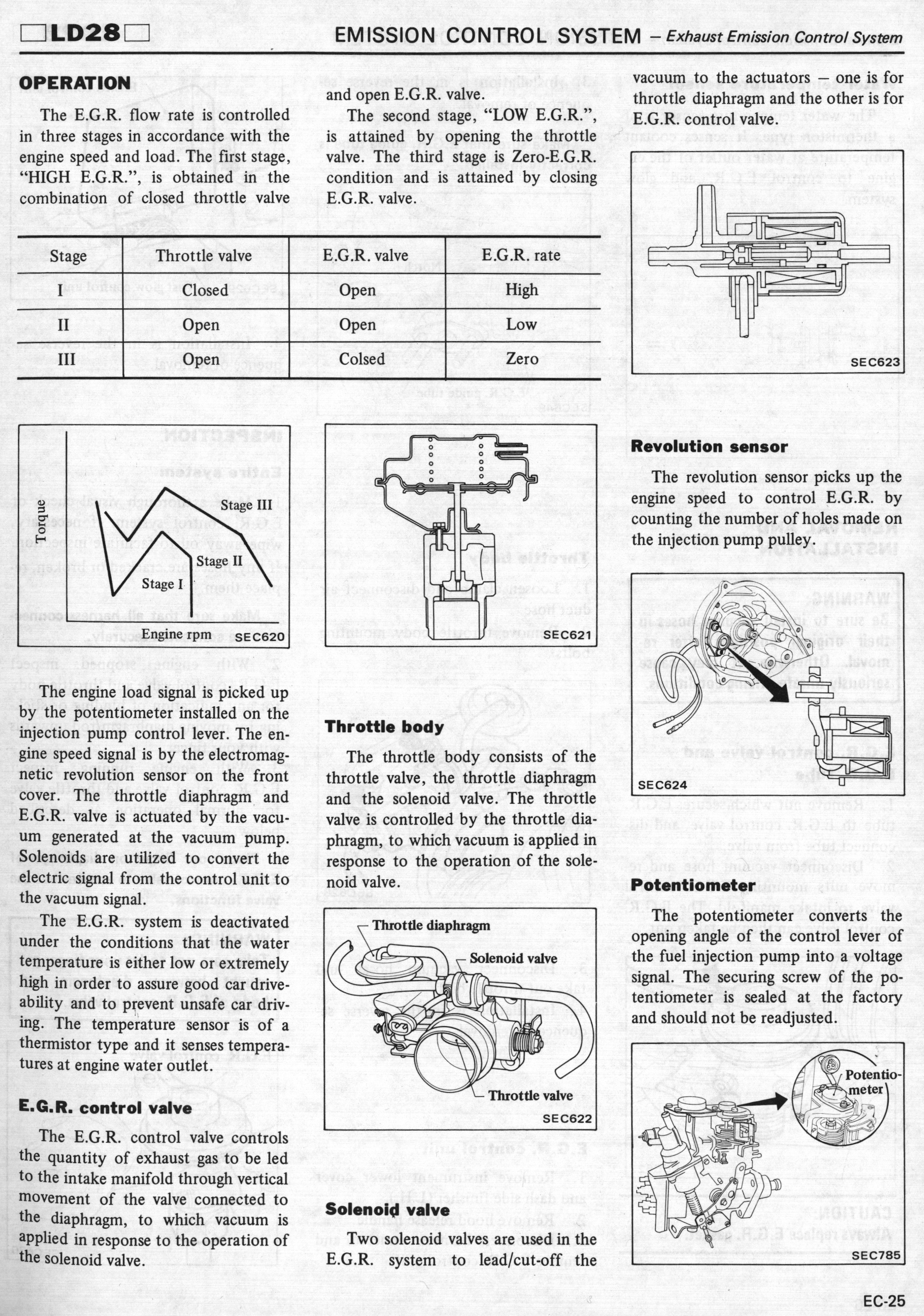

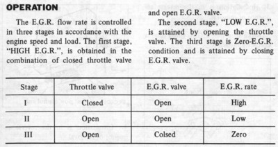

Yes. However, refer to the chart on 1982 FSM, page EC-25:
(Remember: this applies to 1981 and '82 ONLY, because Nissan did something different in 1983 for EGR control.)
There are times when only the EGR valve solenoid will be energized ("Stage II"), and other times when both the EGR valve solenoid and the throttle valve solenoid will be closed ("Stage I").
[Note the misspelling: "Colsed" in Stage III.]
You could wire a couple of low-wattage lamps or LEDs between
  • The White/Black wire (which is switched 12v+) and R, to see when the IP Advance solenoid fires;
  • The (Black [which is Ground] & YR) and (B & YL) wires, to see when those two solenoids fire.
