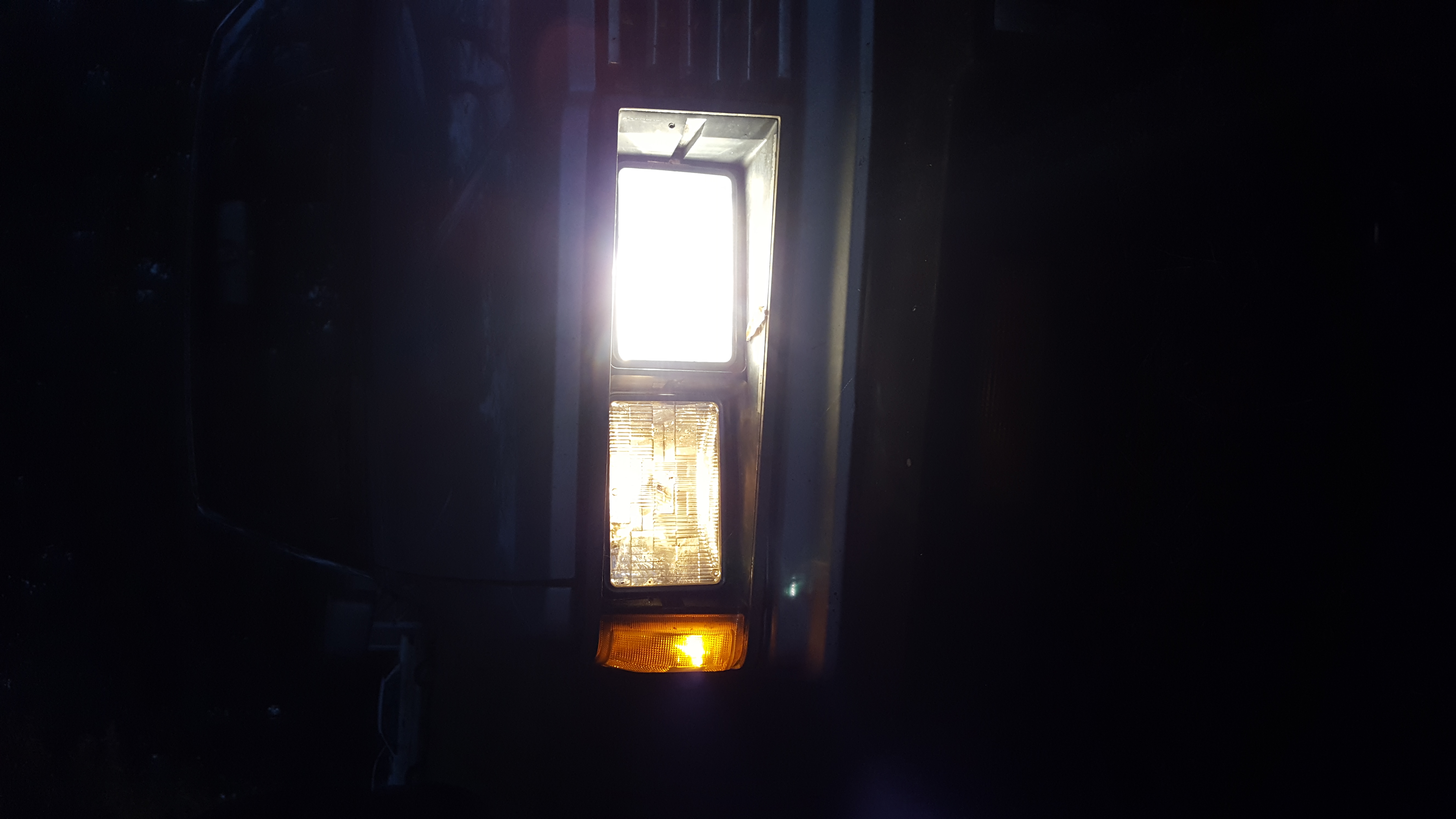

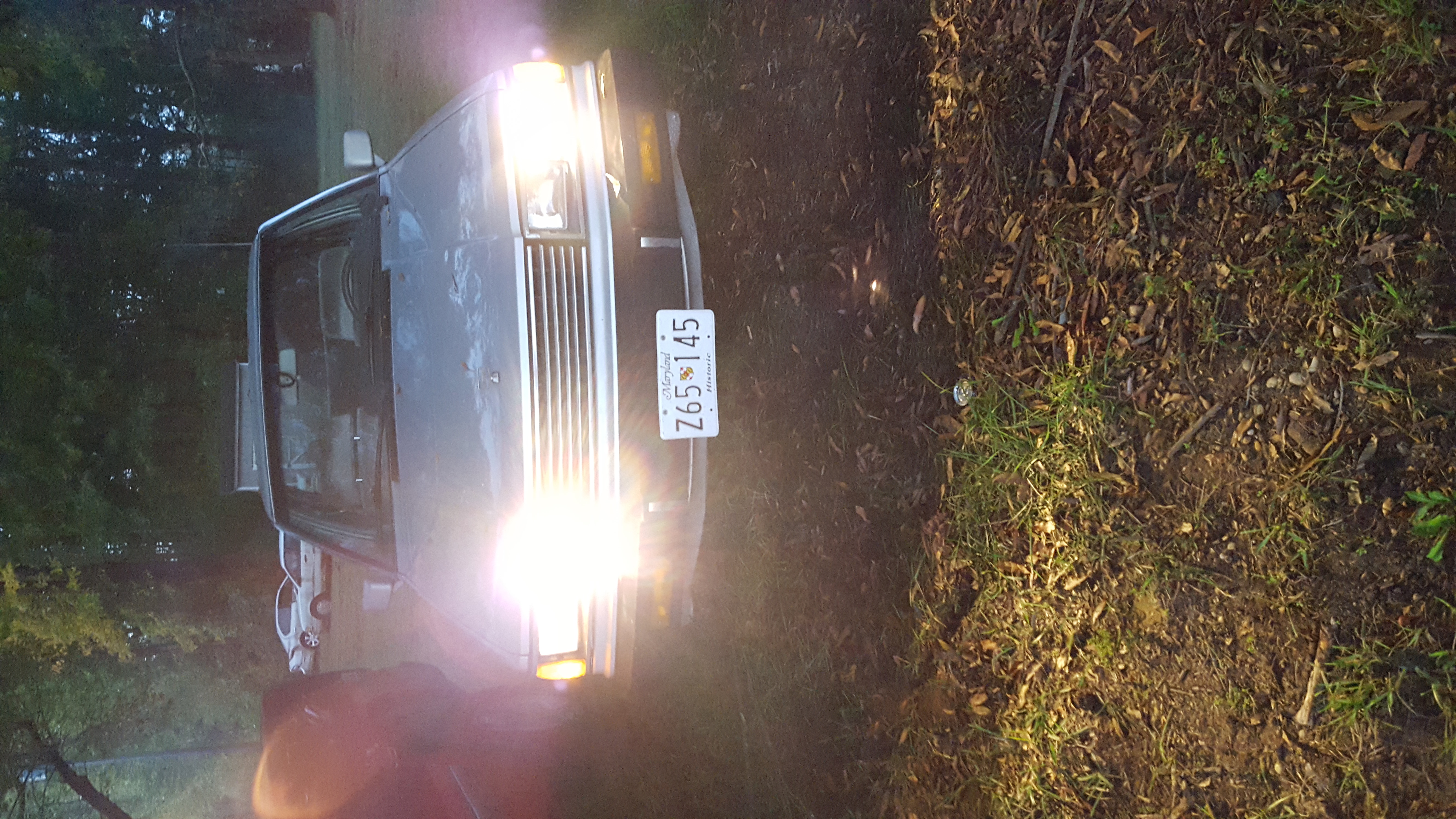

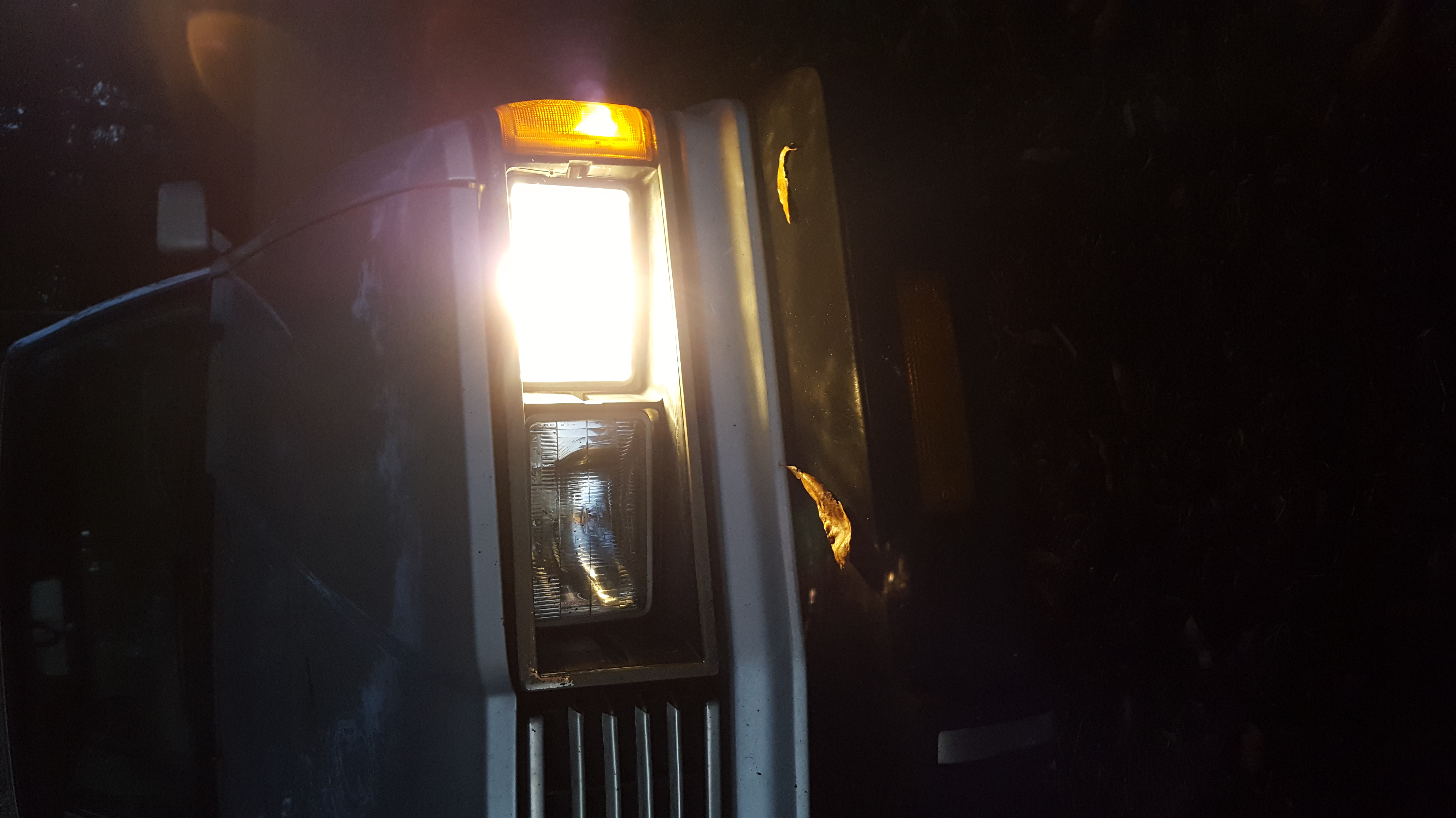

How's it going, I've posted a couple pictures below of what it's doing. I'm not sure which lights are which, and I'm also not sure what lights are on and what lights are off when either normal lights or highbeams are in use. Regretfully I never payed attention til I had this problem. But anyway the lights are like this almost all the time whether the selector is in highbeam setting or normal beam. Every rare once in a while, while driving, with the selector in normal beam it will switch back on to whatever normal beam is supposed to be but it's too dim to keep it on that, so I switch back to high beam and that's what the pictures show(the selector is on normal beam in the picture). But as you can see the far passenger side light is very dim, the inner side passenger light is lit normal. The inner driver side light is out, and the out driver side light is lit normal. The inner driver side light only had like 2.76v going to it, so I'm not sure if the bulb is out or not getting enough juice to light, either way it should be getting way more volts. The rest have what they are supposed to be getting. And lastly when you move the selector into highbeam the light on the dash doesn't come on ever either. I have no idea what's going on and I hope I have described this situation well enough for someone to give me some answers. I look forward to any replies and hope everyone has a good day! Thanks in advance for answers

My guess is bad switch and/or perhaps poor body ground.
You can try and purchase or source a new switch or remove the one you have and see if you can clean it out with some contact cleaner and compressed air. Although I do not have a Maxima I do have a Nissan truck from that era and have had a number of problems with different switches on it. The 4 way flasher switch and the turn signal switch. I removed them and soaked every little nook and cranny that may give entry to the inside where all the contacts live with contact cleaner and given them a good blow out with an air hose. It seems to have solved the problem. I have also checked and cleaned off with a wire brush or sand paper all the body grounds that I could find.
Dim lights and weird electrical problems most times are caused by bad grounds.
Not exactly sure where on a Maxima the main body ground is but that would be where I start. You can test it with a jumper cable from the Neg side of the battery to that point or to the wire connected to it.
Good luck and keep us posted.

Are the pictures I posted viewable? I made the post on my phone and I don't know if they didn't post correctly or if my phone is being stupid and won't load them
Re: 82 maxima strange headlight malfunction... help
Yes they are.
They take a few seconds to load and are oriented 90 degrees but they are there and show what you are talking about.
I still think it's a bad ground someplace.
I'm sure others will chime in.
