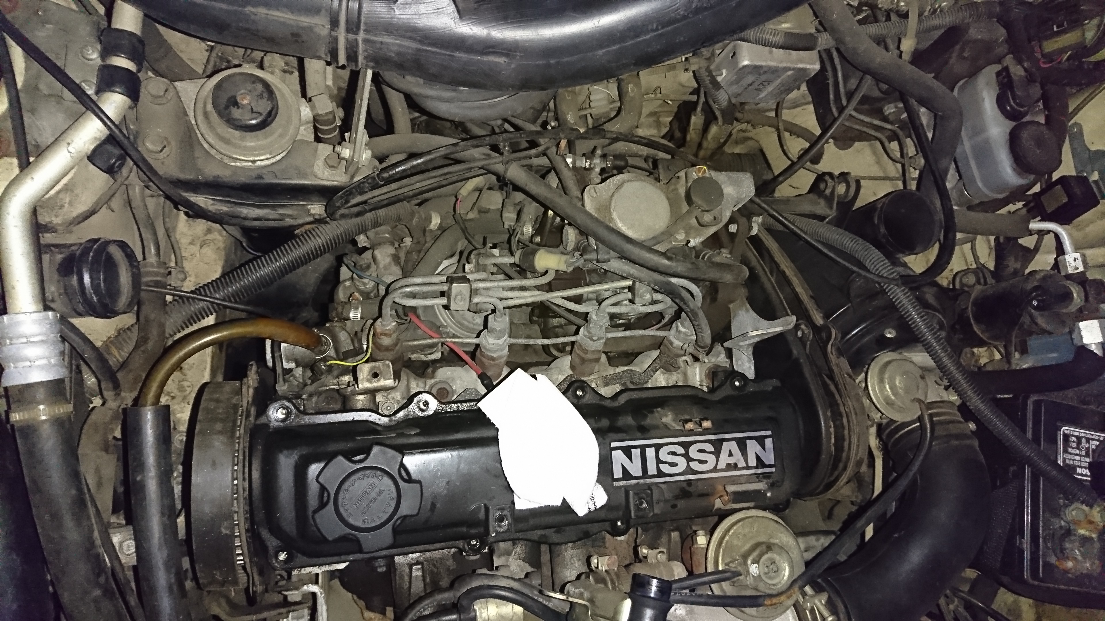

Thanks for the info. Since posting I picked up a Factory manual off ebay and it has plenty of info on the cd17 engine. As of right now, I've got it running but it's running rough and pushing out white smoke. The previous owner changed out the water pump and apparently didn't time it right and broke the belt on start up. I was hoping there was no damage since it didn't snap at road speed. I think there's a few more things to try before I pull the head off and check for a bent valve. I'll keep updating as I find time to tinker with it.

Pics!!
- DSC_0066.JPG (3.16 MiB) Viewed 13059 times
