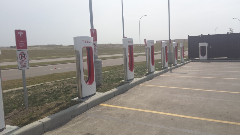

Since it's basically Tesla power are there any of these stations around you ?
- resized tesla 1.jpg (185.22 KiB) Viewed 76311 times
