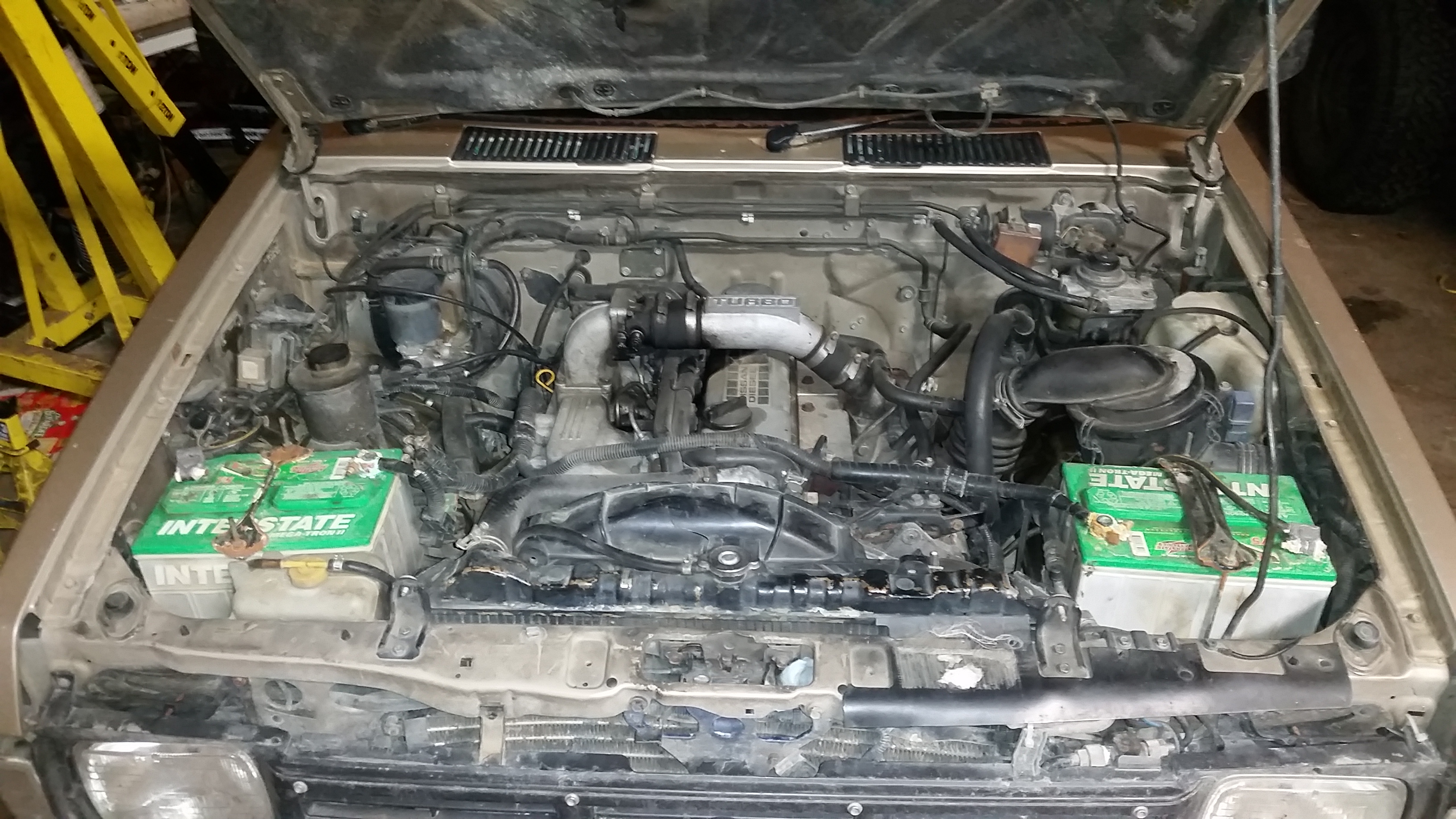

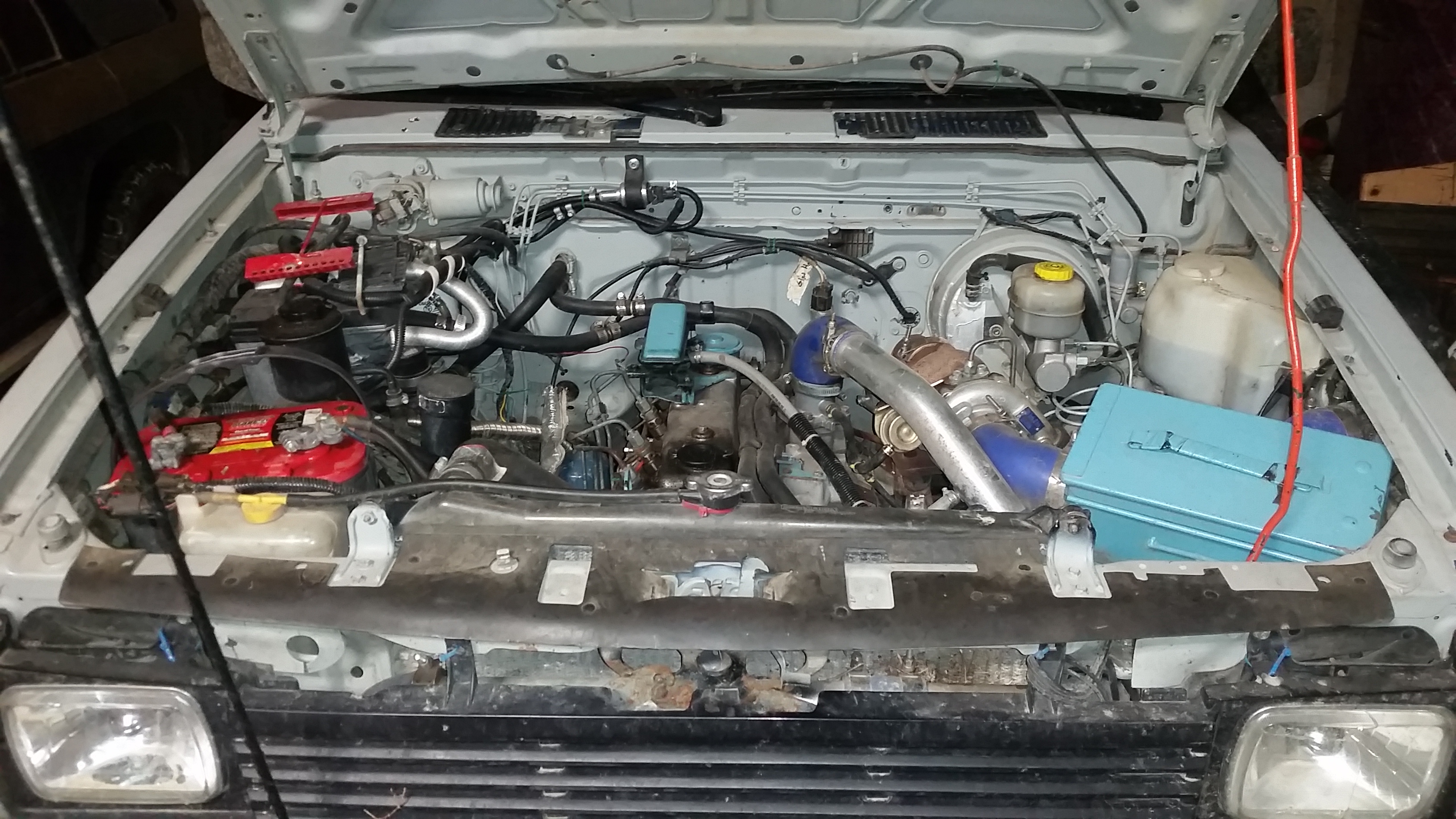

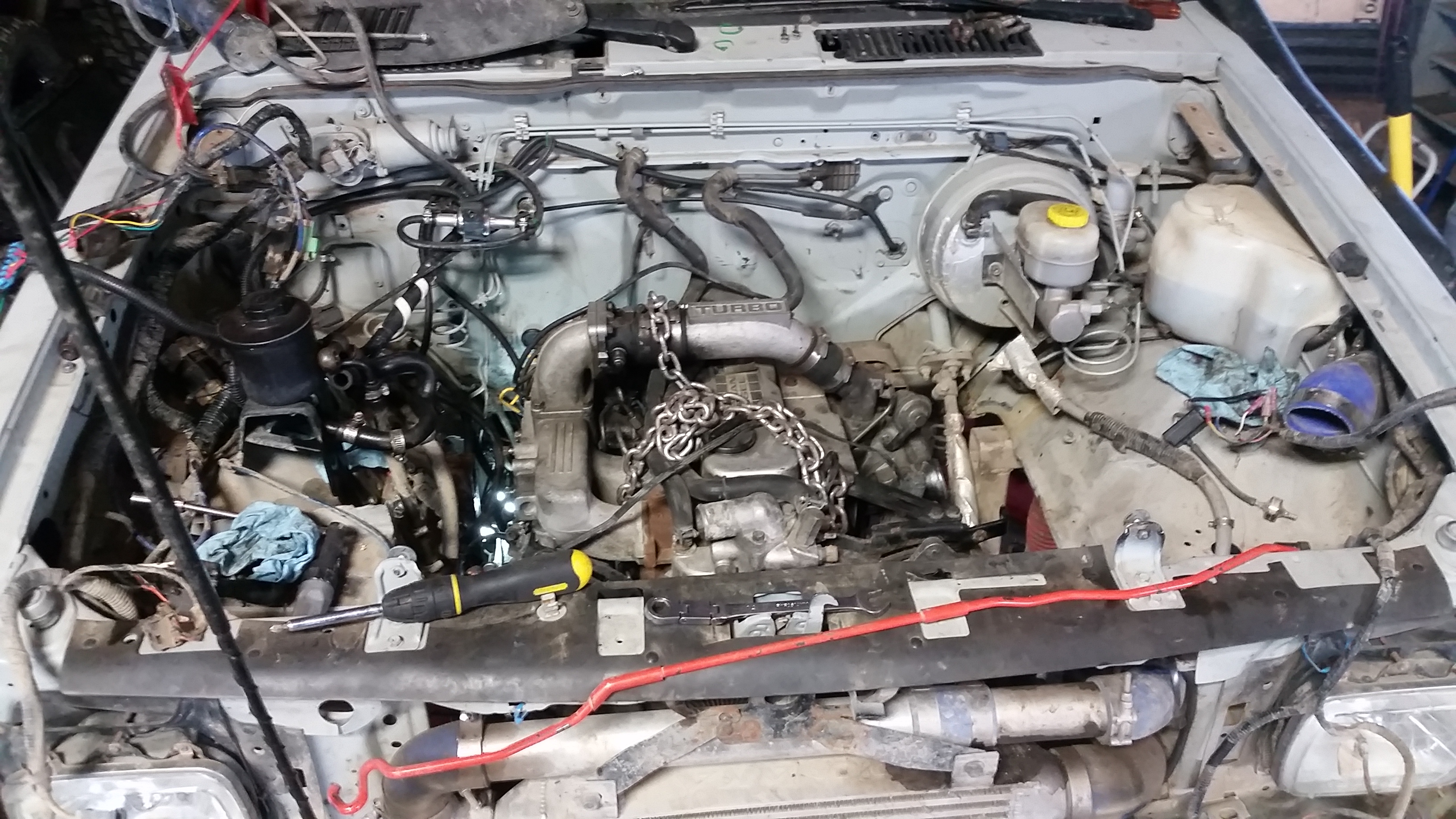

ok so ive been doing some reading and i think i will build the sd25 again. but im going to change a few more things. im goin to switch to the td27t VE injector pump # 10F2050RNP752 this will help with a few things. 1 being timing. 2 being an egt drop from proper timing on boost which should result in more reliable power. I also plan to drop my egt level considerably more to 1100F max. I will determine the engine part failure soon.
the truck has now been swapped to a td27T from the terrno. and Im mid way through re-wiring the truck with a plug and play harness. so if anyone wishes to have a td27t swapped into there truck I will be able to cut down the factory vehicle harness to - power/ ground/key power/ key start. so this motor could be dropped into any vehicle with only moderate electrical ability on the installers part.
d21 with the td27t in it
pickup engine bay
pickup engine bay
terrano engine bay
terrano engine bay
terrano on the left d21 pickup on the right
