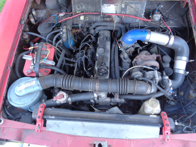

also im a bit curious about your engine! you mentioned its a sd25 in an earlier reply, but i see the sd22 writing on your rocker cover? im asking as im flirting with the idea of swapping the engine again to something i can turbocharge!

also i bought the car with the nissan engine, apparently the owner before that got the engine for a 6'er of beer from somebody his friend knew, so i think tracing the source-car is hopeless :p

The SD25 valve covers have way more stuff on them to deal with, the SD22 valve covers are a lot cleaner, so I use the SD22 valve covers on all my SD25 series diesel engines.
