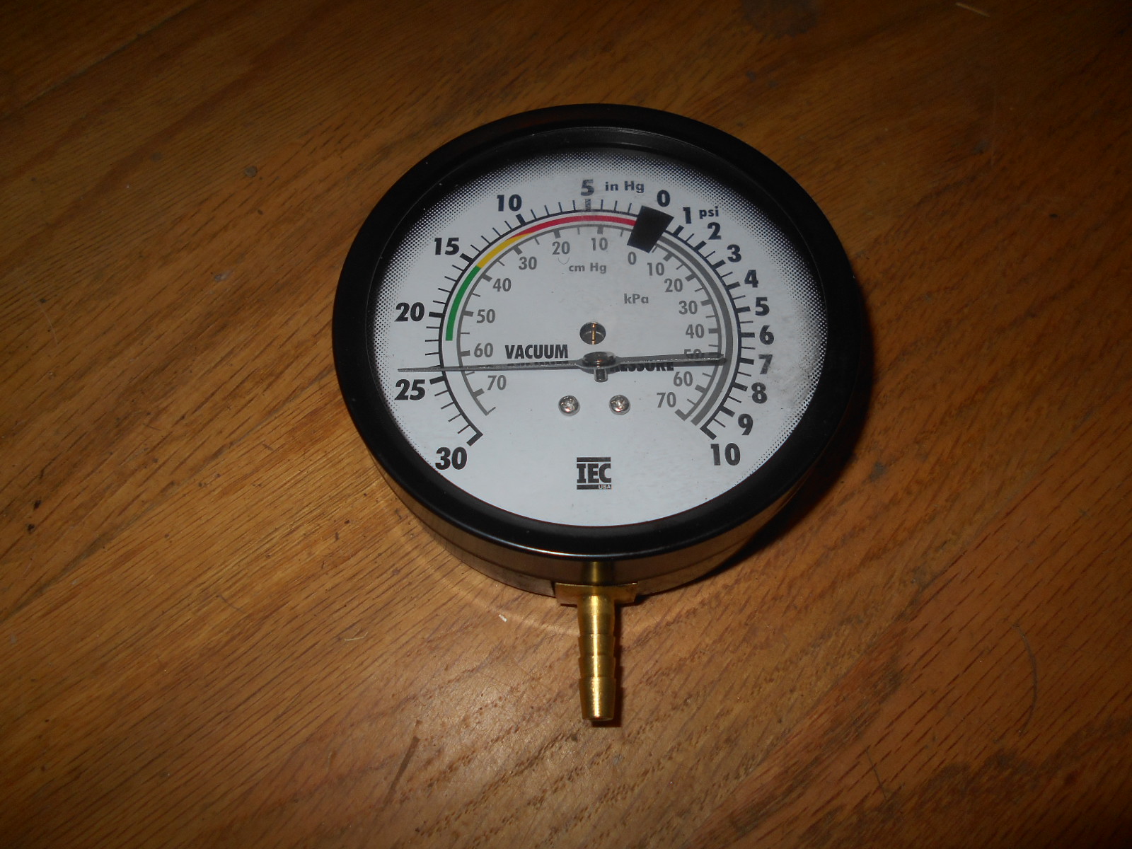

6) Diagnosing fuel delivery problems. Quoting myself:
"For fuel delivery problems, I use the same method most every time. I teed into the pressure line off the fuel pump, got out my old Sears vacuum/pressure gauge (it was old then; it's positively ancient today) and duct-taped it to the windscreen, connected it to the tee. Drove the truck. This time, I could see the fuel pressure falling off long before the truck began losing power. OK, fuel delivery problem confirmed."
Use the vacuum/pressure gauge, a tee, and some clear fuel line. Paste the gauge to the windscreen, and if you can make enough gap at the hood, also bring the clear fuel line up so a loop of it can be seen through the windscreen. Tee at the firewall or the fuel pump, not any further back. You need to know what's happening at the engine.
The vacuum/pressure gauge will tell all.
First, tee between the firewall hard line (from the rear/tank) to your prefilter. Run until you have a symptom/missing/loss of power. What does the gauge say? More than 1" vacuum? The restriction is somewhere between the firewall and the ass end. I've had crushed lines, rusted lines, lines filled with crap in the fuel, water (harder to pump that fuel), plugged vent line, rusted pickup tubes and probably others I'm forgetting.
No big vacuum on that test, but still loss of power? Move the gauge's test tee to the pressure side of the fuel lift pump. Repeat test drive.
Fuel pressure started high but dropped down under load or after a while? You've narrowed the problem to between the firewall and the fuel pump. I've seen plugged filter(s), collapsing inlet lines, and failed check valves in the fuel pump. Also, one defective filter head, I can't recall the details now.
Fuel pressure was good and stayed good, but still loss of power? Move the test tee to the line feeding fuel to the IP, repeat test.
Fuel pressure dropping when loss of power? Look hard at that secondary filter assy. (element, head, internal check valve AKA overflow valve).
Fuel pressure OK idle + under load? Has to be the IP or engine hard parts: you do not have a fuel delivery problem (delivery to the IP, that is). That said, the Inline IP is about the most robust part on a SDxx engine, so I would not condemn it lightly. Other than the leather diaphragm, they're as close to indestructible as an IP can be in consumer automotive-land, IMO.

OK, I will buy a vacuum/pressure gauge and start again.

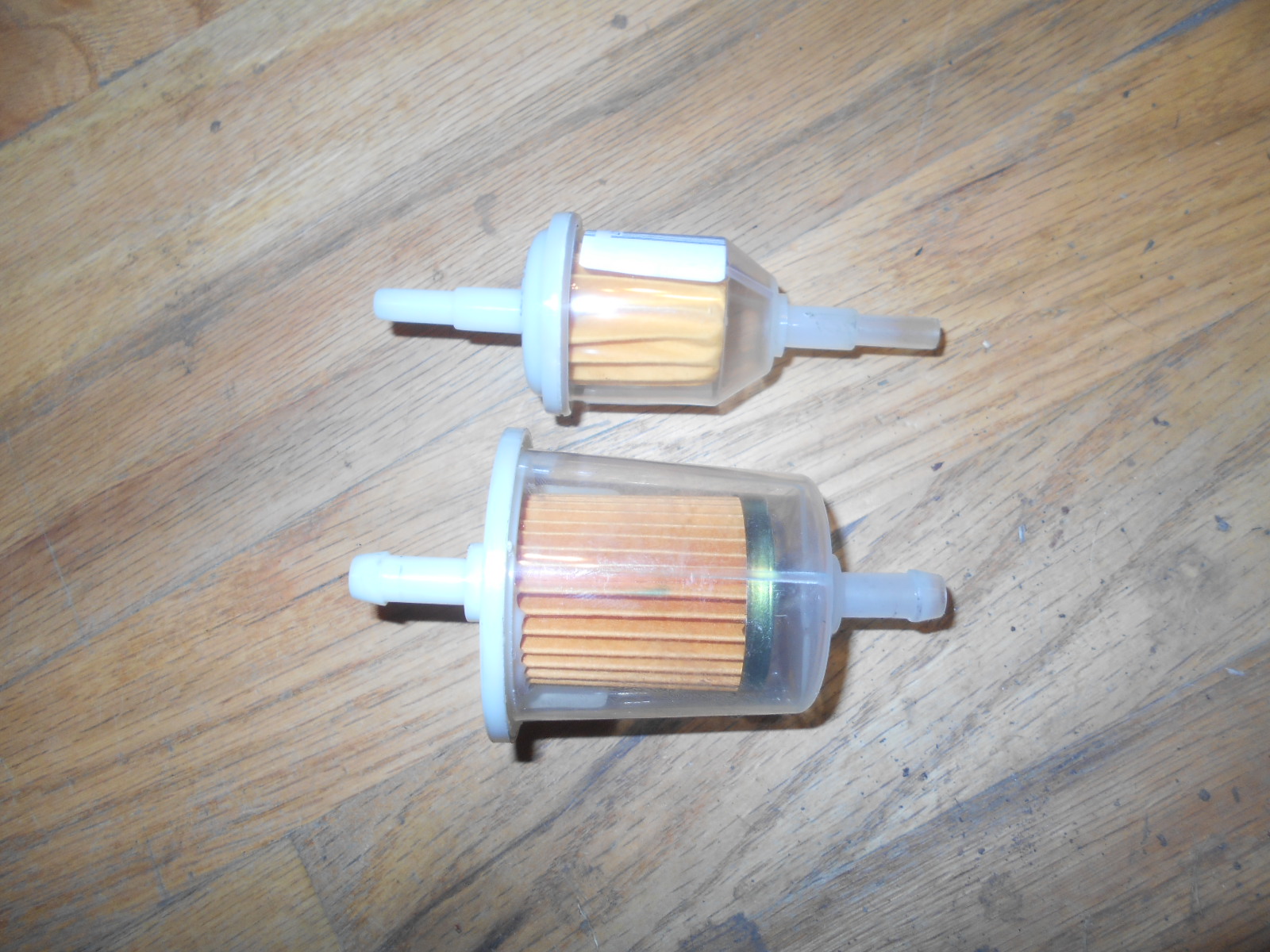

The 2" gas fuel filters won't work. I know you've been using them for years, but take my word for it: sooner or later they always give you grief, when you use them with diesel. They just do not have the capacity (surface area) to adequately flow.

If you don't want to buy the pressure/vaccum test gauge, I can mail you one. I'm certain I have at least two and probably three. Because I no longer own any older rolling stock, I don't work on things where that gauge is handy any more, and I picked up a couple over the years at swap meets.

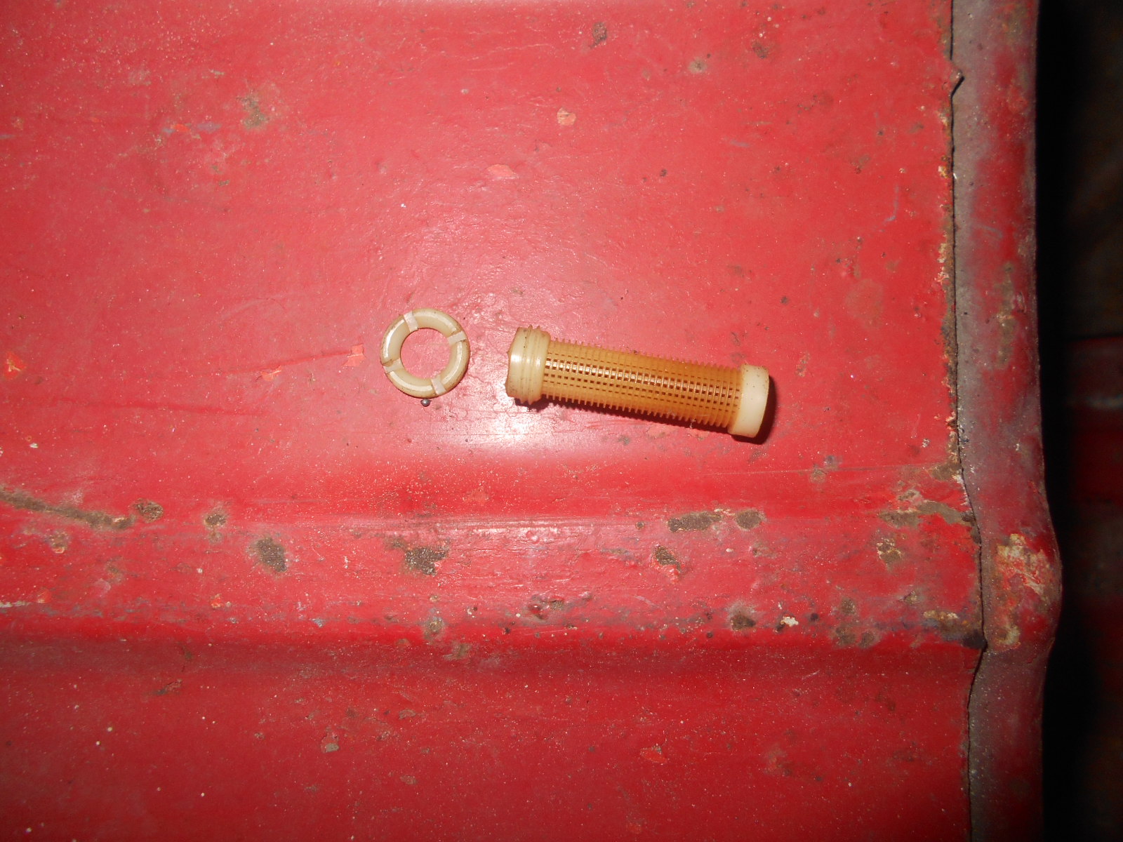

The first thing I did was remove the lower banjo fitting on the lift pump and check the screen, it was clear.

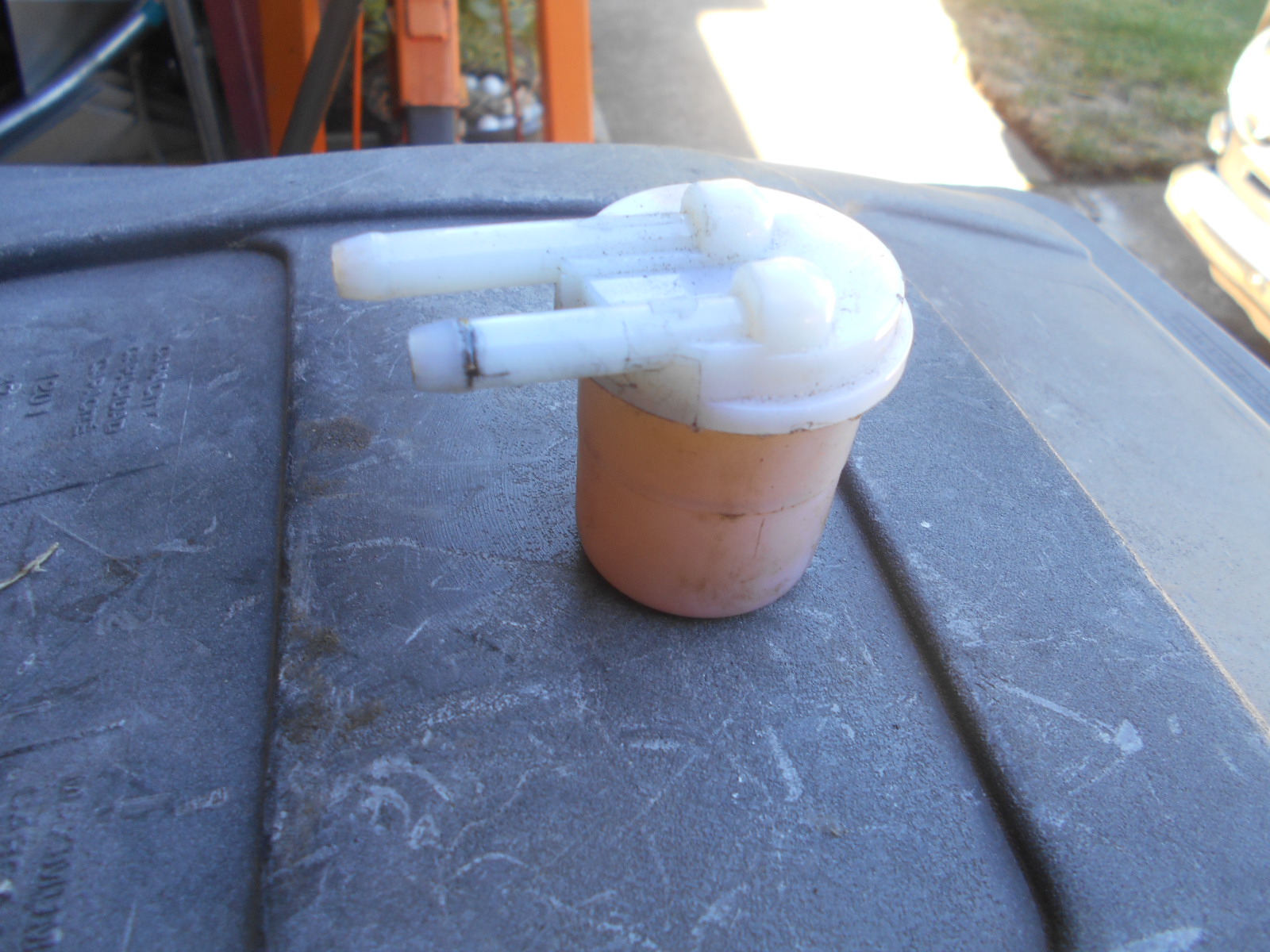

I then removed the fuel filter housing and replaced it with the new fuel filter housing and put the new fuel filter on the new housing, I then put all the banjo fittings on the fuel filter housing, I then ran two lines to the rear box and put them in a gas can of diesel fuel I bought to bypass the fuel tank, I now have bypassed all lines to the tank, cleared all banjo fittings and lines, and I checked every line, and have bypassed or changed every line since this issue started on that trip to Hood River OR, there is nothing left to change except the return line from the injectors and that line returns back the the fuel tank via that two fitting banjo fitting on the fuel filter housing.

The needle on the gauge was moving wildly at an idle and up to 2000rpms, and I am talking about I could hear it in it's housing slamming around, I thought for sure it would break and it did on the test drive, I made it to when I lost power and seen the needle getting down lower than 4psi, but then when I let off the pedal, the rpms dropped and it went wild again and the next time I looked at it the needle was going around in circles.
I am not sure how the lift pump could be effected by the boost, the injection pump pressurizes the fuel to a very high PSI and atomizes the fuel as far as I know, I thought it was hundreds of PSI if not thousands, I have had it up to 20psi boost, but all my issues are at 5 to 10psi boost, and I have both trucks(521/720) set to dump at around 12psi, the 720 has no issues so far, and the 521 had no issues till that trip back from Hood River after it got warm outside, the 521(this truck) loses power at 5/6psi at hiway speeds(2500rpms).
I will have to likely buy another gauge to test lines again as you can see the one I bought is likely toast, it was a $30.00 gauge(lasted 10 minutes max) and I really don't want to ruin an expensive one, I believe it is a fuel delivery issue or some how air is getting into the injection pump.
So you are saying that the lift pump provides 15psi to the fuel filter/injection pump, so anything over 15psi gets ejected out the fuel filter thru the return line via that spring loaded banjo bolt?

See if you can get a warranty replacement for that gauge.
If you want to eliminate variables, prop the wastegate rod open and drive it while watching the gauge. My money is on you still having loss of power. I just do not think the turbo has anything to do with this.
But you need to get another gauge on there. If you see that wild pressure fluctuation again, stop and remove the gauge (or pinch off the line) to avoid killing another gauge.
You might make your next test point for the gauge tee at the vacuum side of the lift pump. You already know there's a problem on the pressure side. May as well make certain you don't have excessive vacuum (which, in my experience, is exactly the most common problem).
OK, I am not saying it is fixed yet, but I just took it on a 20 mile drive again after changing one thing from the way it was yesterday, the pre-filter.
Now a little history of Wayno, in 2008(maybe 2007) I bought a 1982 Datsun 720 diesel truck, I put 25,000 miles on it in 2/3 years of driving, it had the exact same pre-filter I have been using on this truck since them 2 cheap(99 cents) pre-filters plugged up, one within 3 tanks(Hood River trip), I then switched to these more expensive filters that my 1982 Datsun 720 diesel had that I mentioned above.
I am having a hard time believing that this was the issue, there is/was no restriction when I blew into the one half hour old one I used on the trip to Canby, I used this filter for a few years on my 1982 diesel.
I went to the auto parts store yesterday and bought that gauge which I had to find myself on the wall behind the counter as the guy looked right at it and passed right by, I also bought some fuel line, I also asked for a diesel pre-filter, the guy took a very long time trying to find one, I finally said there has to be one for the diesel Mercedes or a diesel BMW, that finally got me a diesel pre-filter, that is what I used on this drive and I had no power loss.
Now I need to start putting it back to the stock tank and lines and hope the power loss doesn't start happening again.
I did find out one thing other than what pre-filter needs to be used on this truck, I found out there is more power to be had if one puts a valve in the IP vent line, this controlled leak helps the injection pump move to a slightly richer position, it still has lots of power without that controlled leak, but there is more to be had there that I would have never known about without going thru all this I just went thru, and it is a noticeable difference, as I pulled the valve off the end of the line and pinched it off and could feel a little less power, but when I quit pinching it off I would go, I could let off the pedal a little.
The truck ran way hotter than I was liking this test drive, I will look into a 3 core radiator in the coming weeks if this power loss issue is fixed.
I also will look into one of them nice pre-filters with a water trap and a hand primer, I have no idea where I will find room to install it, but I believe this will be the best way to go.
I still have a problem with this pre-filter I was using being the issue, the 720 turbodiesel has them really cheap ones on it and has no issues, but I have not taken that truck on any long trips either since it was turbocharged, just around town driving, but I put 10s of thousands of miles on it non-turbo and never had an issue like this with them really cheap filters, I have been using both types for 10 years. And this expensive type appears to be the one that has caused me my issues, but as I said, I don't know for sure yet, as I babied the truck on the last test drive as the water temp was really high, too high for me.
The original thread on this is from 2005:
720 SD fuel filters
There are more pictures in that thread. Summary: wire mesh or plastic mesh are OK for diesel, paper is not.
720 SD fuel filters
Wish I had read that about the pre-filters sooner, and I am certainly happy I coaxed Al into commenting on this thread.
The pre-filter I had in my 1982 Datsun 720 diesel certainly must have been the proper one even though the gas filter looks exactly the same, there is a dimple on the firewall where the mount hole is supposed to be for the pre-filter holder clip on the earlier models that didn't come with the pre-filter.
I went straight from the cheapo gas filters to this gas pre-filter that looked like the one in my 1982, the cheapo gas pre-filters lasted a year or two(depended on how much driven) before they would get sucked flat and the engine would start missing from fuel starvation, I always had one in the glove compartment and it was fairly easy to change.
Since I changed the 720 over to a turbodiesel, I changed that trucks pre-filter over to that type with a water trap(it came with the engine), at that time I removed the cheapo filter back by the tank.
I will likely put the fuel system back to how it was before all this started today, I will also take the pre-filter part numbers and see if I can get a pre-filter that fits in the clip I mounted to the inner fender well and use that instead of what I did yesterday as the fuel lines are to the point of almost kinking using this diesel pre-filter I bought which would also cause me issues.
Also there is a screen in the bottom lift pump banjo bolt, does anyone have a part number for that screen, I broke my new one putting it back in the banjo bolt to aggressively I guess, I used the old one out of the other lift pump I removed, it was really dirty.
