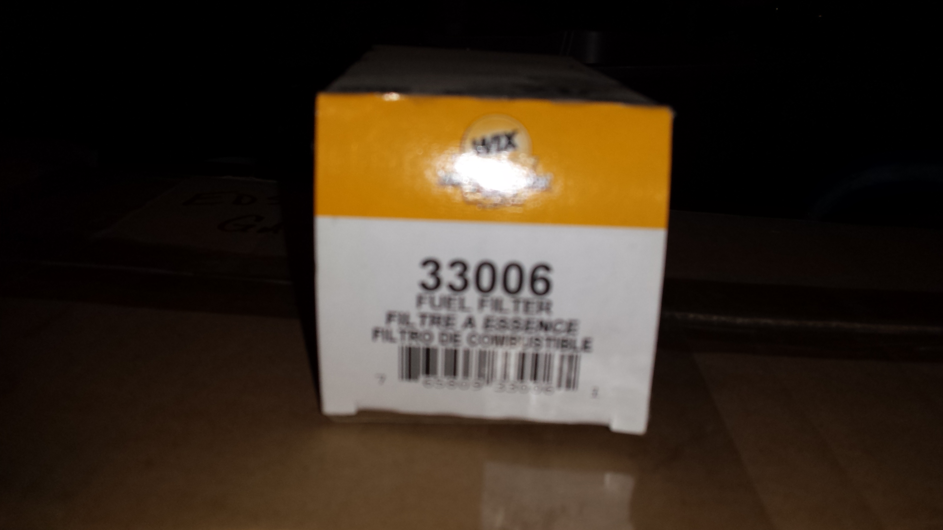

The Baldwin FF # is a BF954 and the Wix inline Mercedes filter is a 33006.
I think that either Al or Phillip may have mentioned this Mercedes part at some point on this forum.

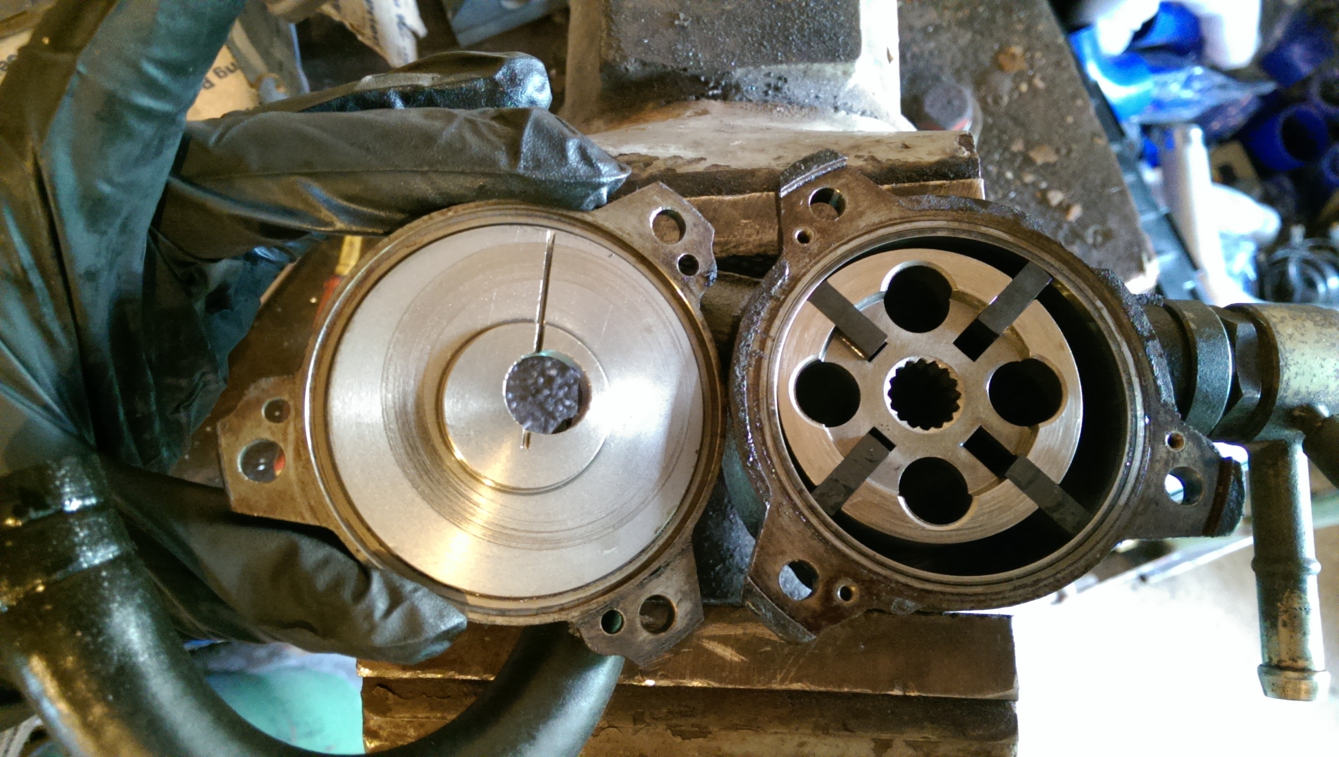

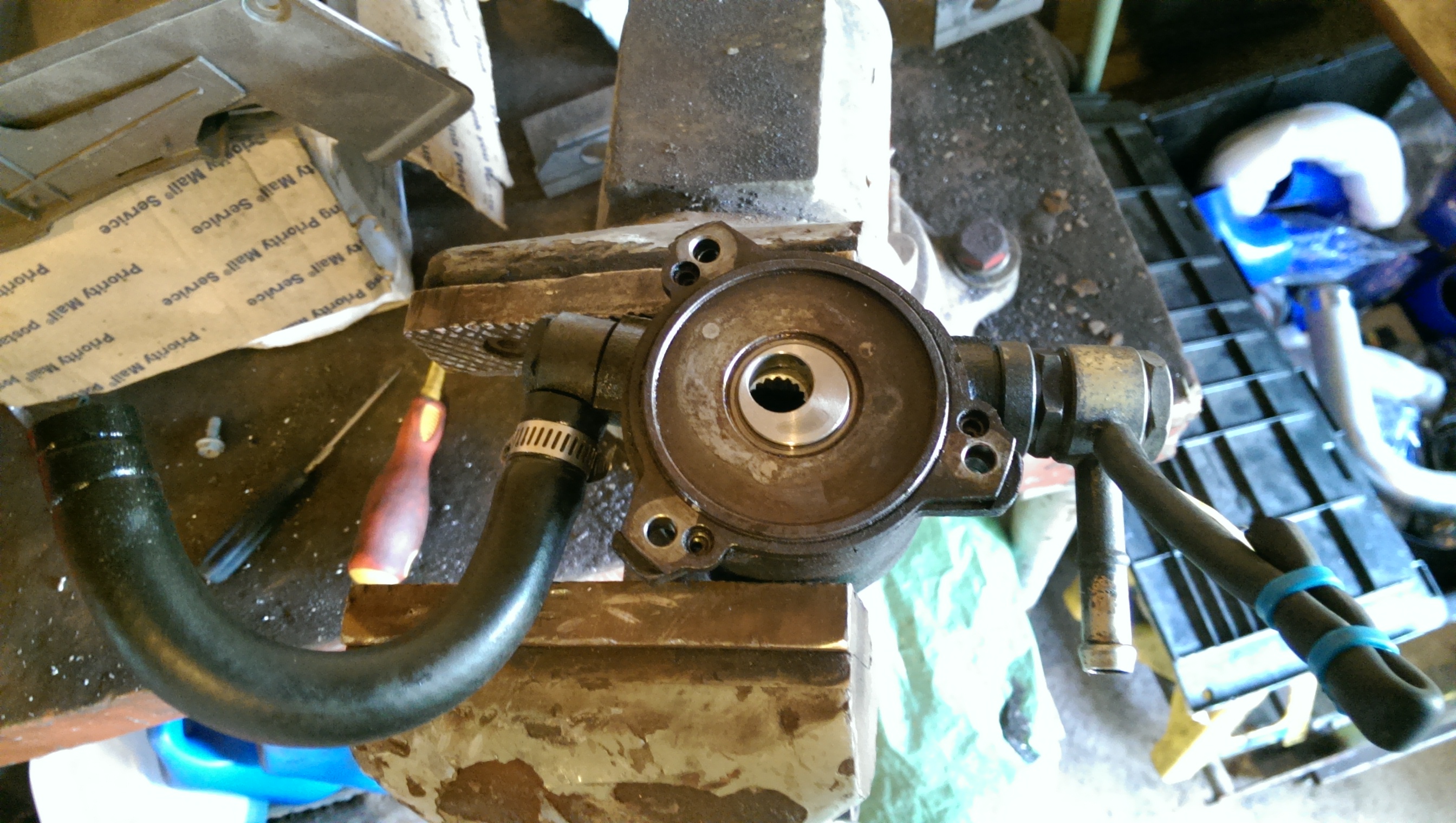

I took my vacuum pump apart today and took some pics. the case o-rings seem to be leaking.
i drew this badly on paint program. the red area is incoming oil pressure from the engine. acting inside the rotor assembly and the vanes itself pushing the vanes harder on the outer housing. the yellow area is the acting surface which creates the seal for vacuum once there is small amount of oil seeping around the rotor assembly. the blue area is where the vacuum is created and the exhausted oil is drained from
it appears to be a vane pump
3 phillips screws hold the cover plate on. which also doubles as the mounting surface to the back of the alternator

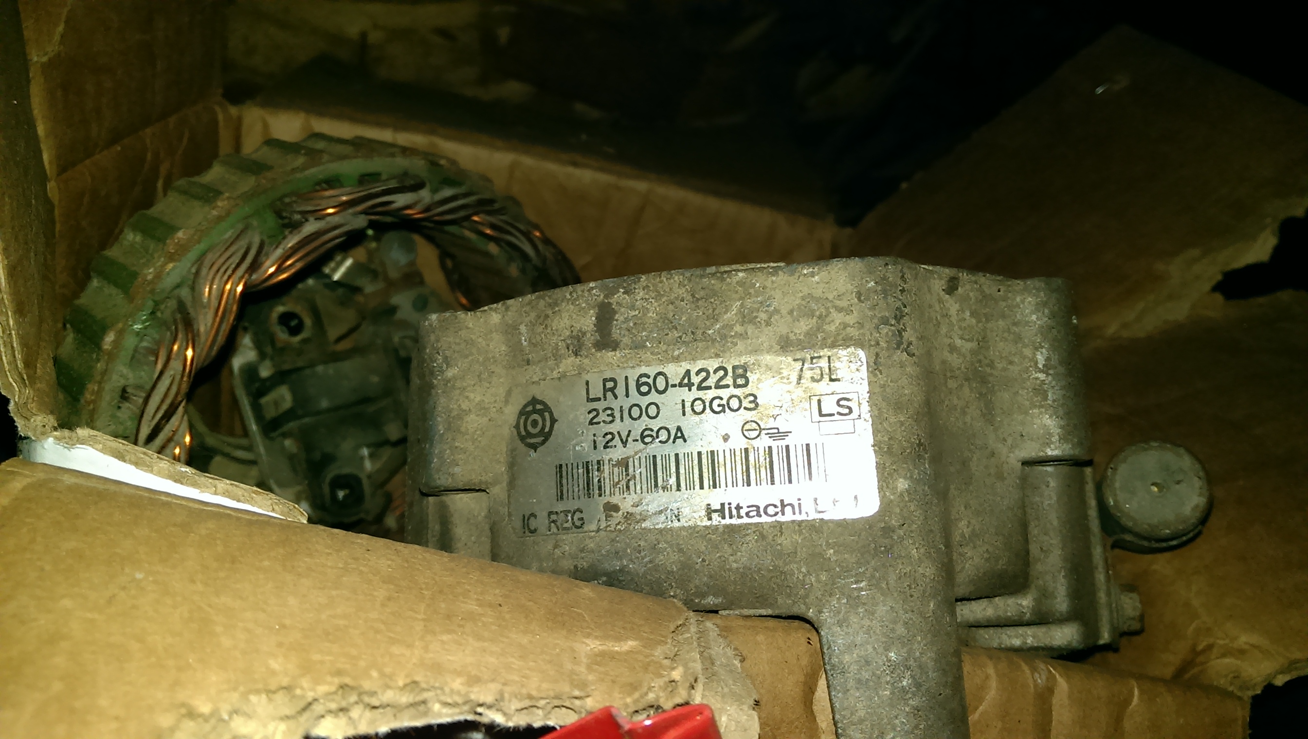

lr160-422b hitachi alternator from the sd25 VE. Some quick research says the td27 alternator was possibly 80amp or 70amp. this case says its 60 amp

I believe that Al ( or maybe it was Phillip ) had some success removing this alternator and using a Motorola unit and replacing the vacuum pump with an electric one and an accumulator mounted on the inner fender. Apparently the pumps fail after a while and are pretty much made out of Unobtainium now.
Were you able to source an O ring for it ?

hey thanks for the reply! I have been thinking about ditching this alternator for my 130amp beast from my old 4cyl gas. my only issue becomes vacuum pump then. I was thinking maybe a vw or new toyota diesel?
I just purchased an alternator LR160-437 off ebay. this is supposed to be a 70amp alternator with the vacuum pump on it. Nissan OEM still listed the alternator listing at $463! and the vacuum pump at $264! i was like hell no. all my alternators have started leaking from worn oil seal surface inside the casing that seals the vacuum pump.
as for the O-rings they are silicone 500F rating. the larger case o-ring is 70 durometer and the face seal is 90 durometer I believe. I went to the local hydraulic shop who ordered me a couple new o-rings. I tried replacing the o-rings in the datsun 720 inline IP alternator and the larger case o-ring is much smaller then the VE IP alternator. However the face seal to alternator was the same. So this would indicate to me the vacuum pump between the 2 alternators is different and not swappable. however you should be able to use either alternator on either engine. the regulator plug is what changes and output amperage.
I cant seem to post anymore pictures. so the package seems to say S70 037 is the larger 1\16in o-ring and the face o-ring is S70 021 and it is also a 1/16in. that is a 70 durometer face seal not a 90 like I believe that purplish colour is. But should work fine.

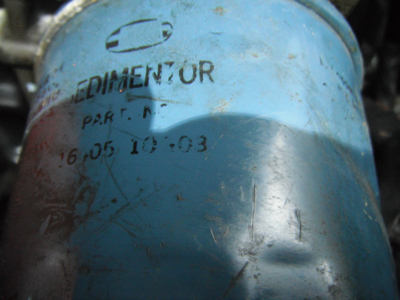

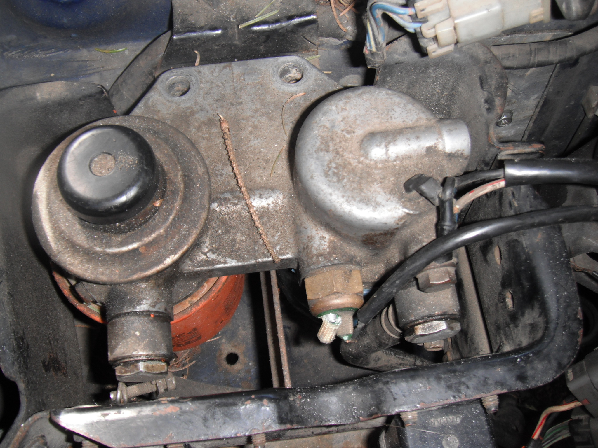

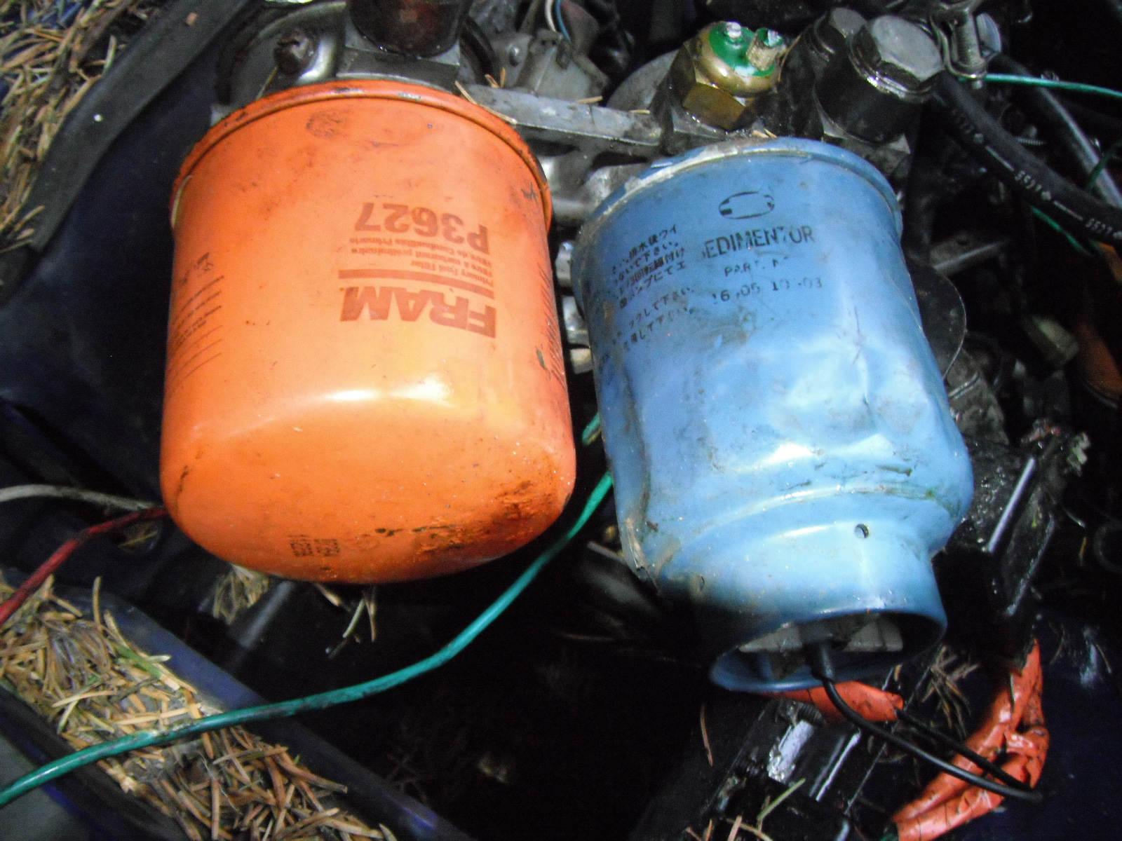

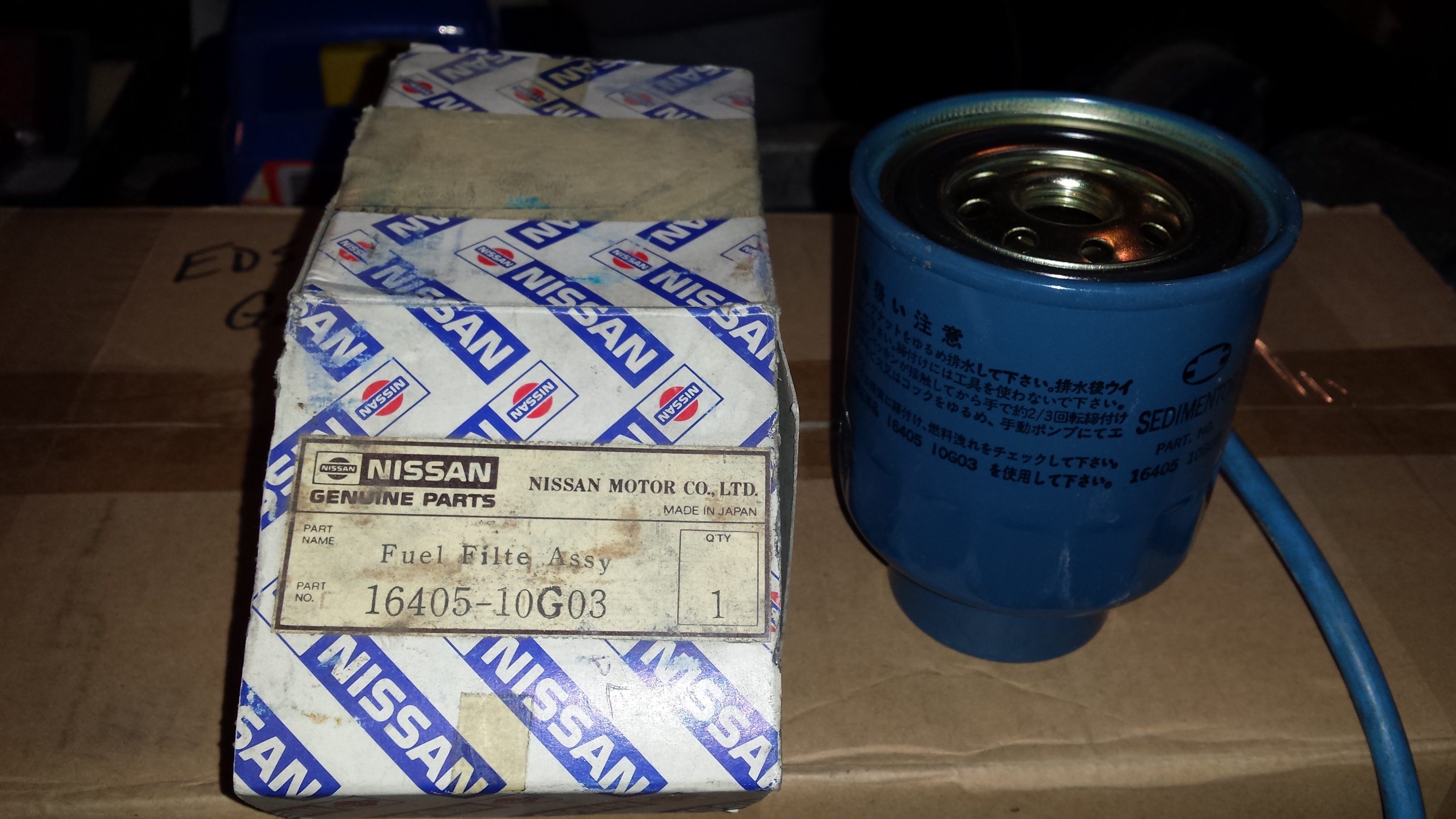

ehtrain wrote:hahaha I get fussy with some things........may make filters easier to change. I deleted the factory mounting bracket "thing" for a piece of angle iron since I could not conceive of how nissan figures the filters are easily spun off -on during and oil change without a bunch of bolts involved. Mind you I am VERY fussy about filter changes. oil is always every 5,000km and fuel filter every 10,000km.
I agree, very awkward. So far I have had trouble finding a water separator....any ideas what crosses over to a more standard manufacturer from nissan part on the SD25? I haven't changed it in a while and am getting worried.
I will try to figure out how to post a picture of the one I have.
Thanks you ALL so much for putting this stuff up here. Soooo much appreciated!

Re: SD25 Inline IP / SD25 VE IP / TD27t FAQ
#24
Why are you wanting to change the water separator ? It merely needs to be drained.
I have one here I can get you the part humber for it if you want.
What vehicle do you have ?
Is it a D21 with the filter/separator/heater on the firewall ?

plenzen wrote:Why are you wanting to change the water separator ? It merely needs to be drained.
Thanks
The drain won't turn.
I got some pictures downloaded (above) now. Yes they are on the right side of the vehicle's firewall.
Cheers
Niseamer
#26
Disconnect the wire and the whole assembly spins off like the filter. You can then "massage" the drain open. Don't break it. ! Be careful with the float inside too. Wash it out and I used brake clean to rinse and dry. Use some dielectric silicone grease when you put it back on both the drain o ring and filter housing o ring. This will allow you to remove easier in future. Just a bit over finger tight is good for the drain.
I will get you part number but it's only for the water trap housing. It does not have the float and drain plug with it. They are sold separately.

I usually remove the whole assembly when I do the filter. It comes off pretty easy and is much easier to deal with on a bench rather than screwing with it on the truck. The plugs are idiot proof and there are only 2 lines to remove. Much easier to pre fill the trap and filter too before hooking it back up. Less pumping and air purge drama as well.
The Wix filter is a Mercedes diesel part. I use it before anything gets to the filter/separator housing. It's an inline type of thing with a pretty fine screen in it and is somewhat transparent. You can see how dirty it's getting which will give you an idea on the probable condition of your main fuel filter. It's pretty cheap too and easy to replace. It will extend your fuel fitter life by quite a bit. If your buying fuel from a reputable busy station you should not have to worry about fuel filter for at least a year or more.
Just FYI. I use a Baldwin fuel filter # BF954. It had a better micron rating than the Wix but the wix is a good filter as well.
HTH

plenzen wrote:Just an additional post here.
HTH
Thank you, thank you! Will order one today - I live in a small community with very limited 'resources".
I will post an FYI description of why I am doing this right now when I get it all going again in the hopes it will help someone else with a similar problem.
Cheers
Niseamer
