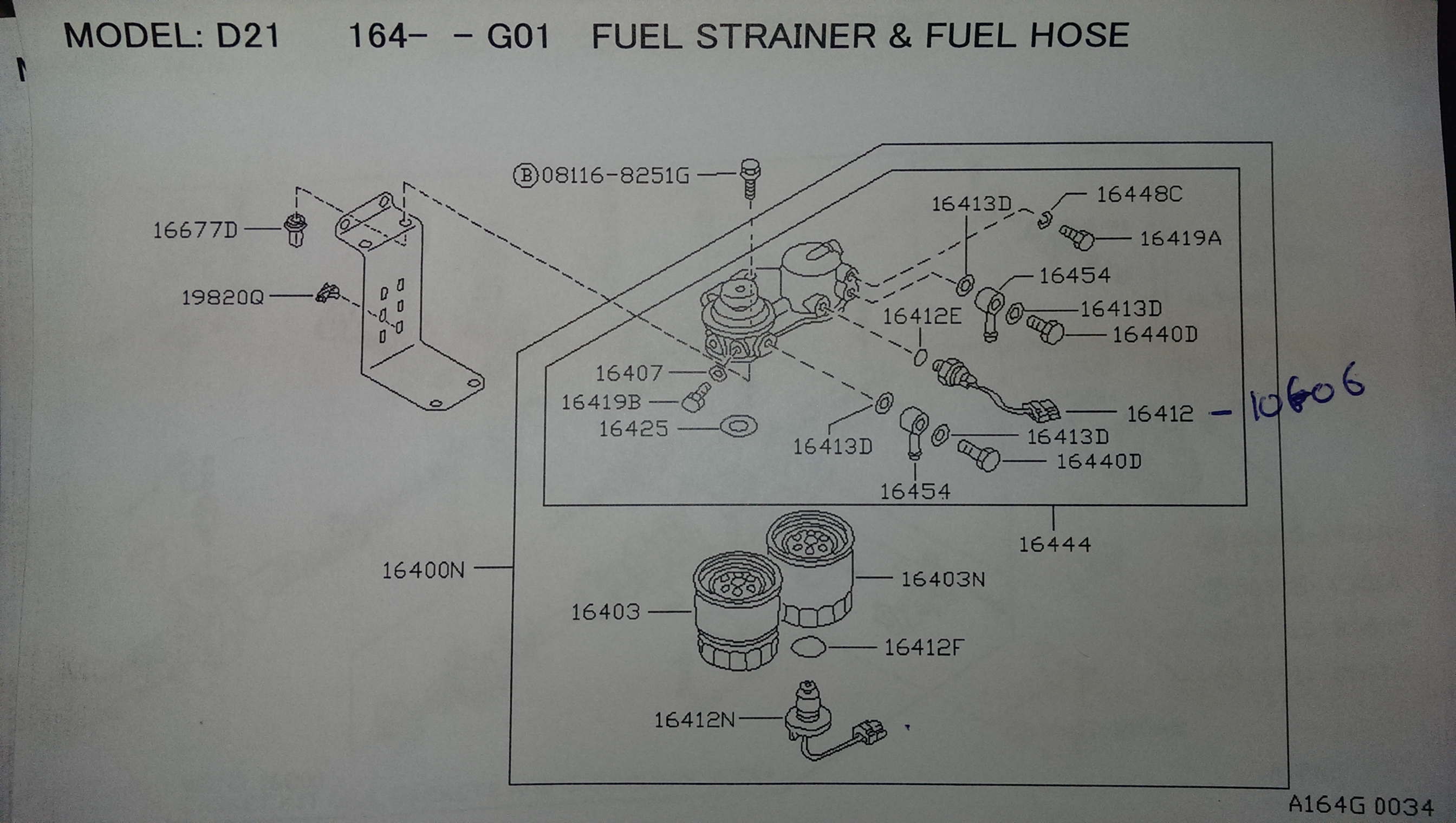

12. fuel filter housing (d21 uses dual filter with heater and primer pump in one)(720 fuel primer is injection pump mounted)

d21 body fuel filter assy. ( fuel heater, primer, filter)

I am wondering if you have a picture of the fuel heater that was used on the D21. I see the fuel strainer that you have posted for the 27 and mine looks very much like that only is a double wide unit that fits to the fire wall. The water trap is on one side and the heater fits into the top of it. The primer pump and filter is next to it.
The heater quit working a couple years ago and I have had it apart and the heater element is replaceable but don't know the part number to look up/search .

best i can do for the filter assembly. maybe there is a part number on the heater somewhere?
filter - 16403-09W0A
Filter - 16405-10g03
upper filter o-ring - 16406-18g01 -? may or may not be correct
water level sender - 16412-10g00 - not in production
fuel temp sender - 16412-10g06 - not in production
Posts: 919
Re: SD25 Inline IP / SD25 VE IP / TD27t FAQ
Thanks Mr.
I have those pics and even have a spare water trap etc. Finding the heater however has been a quest.
Looked at a Kubota part I thought would work but too much modification needed.
