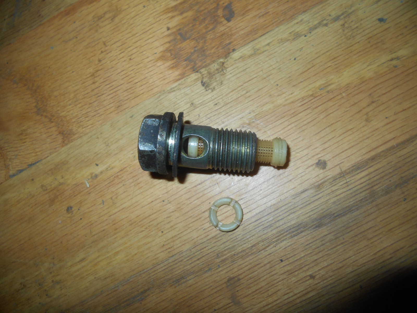

I don't recall seeing that part before.waynosworld wrote: . . . there is a screen in the bottom lift pump banjo bolt, does anyone have a part number for that screen, I broke my new one putting it back in the banjo bolt to aggressively I guess, I used the old one out of the other lift pump I removed, it was really dirty.
Here's what I looked up on FAST and ran through Google: 16656-37501
Well I have two banjo bolts with that screen/strainer in it, it threads into the end of the banjo bolt.

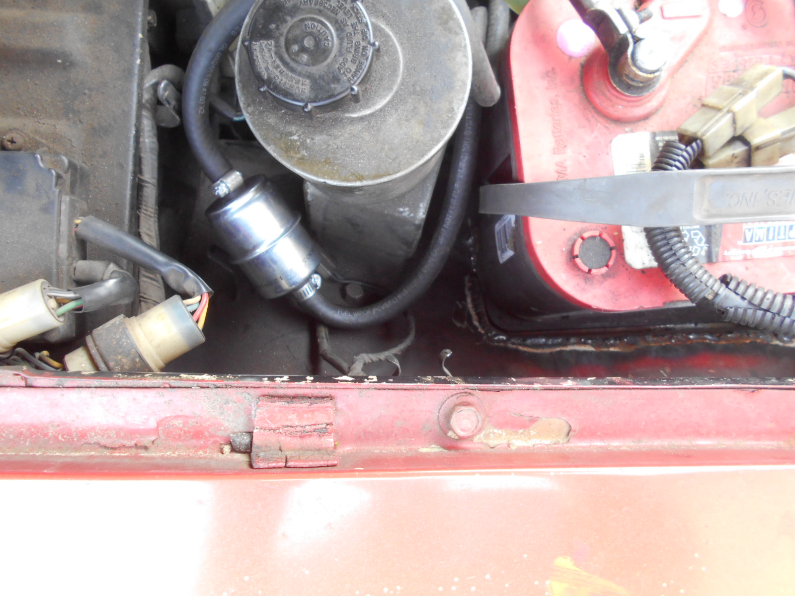

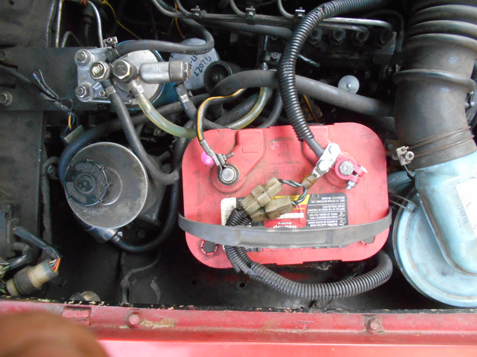

I was at "oil filter services" in Portland OR and they said everything they had had paper elements so I left.
I suppose I am being a little too picky, I have been trying to find one like the photos posted that said correct and in-correct with the fittings both on top pointed 90 degrees to the side, the latest one I ordered that doesn't seem to be cancelled yet is this one.

It has one coming out the top at 90 degrees and the other strait out the bottom, I think I can work with that one.
My issue is that I have a filter like that Baldwin BF7725 with fittings at each end and the fuel hose is almost kinking as it has to make a 90 degree bend on both ends, if I had more room in this engine compartment I would just get this one, but I have no room on that side of the engine.
