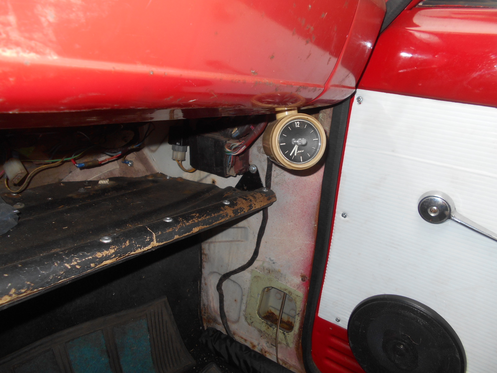

I did a bunch of stuff the 521KC diesel today, the stuff that you collect parts for but never seem to get around to installing them.

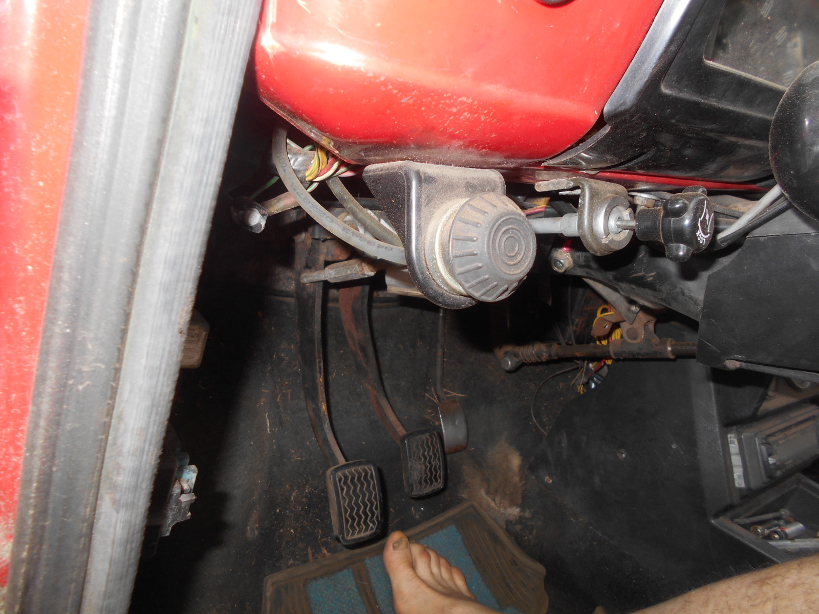

I put all the switches in position on the dash even though they do not function, and I put a good radio delete plate in. I also installed my 521 clock, and a few weeks ago I installed a parcel tray. I had the window washer plunger in position for years, but I installed the Kangaroo bag and piped it to the newly installed squirter. I then installed the diesel pre-filter(strainer). I gave it a bath and now am ready for the Blue Lake meet/show tomorrow, the last big Datsun show for all Datsuns this year in the Portland area.

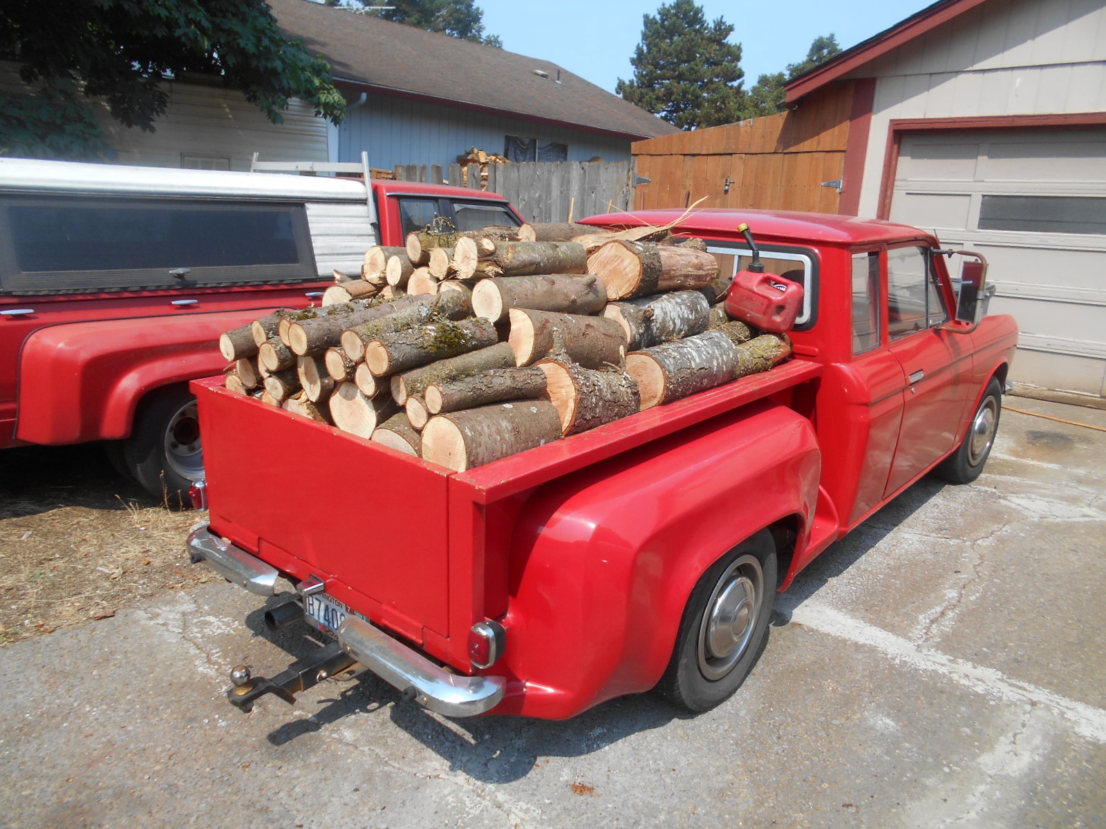

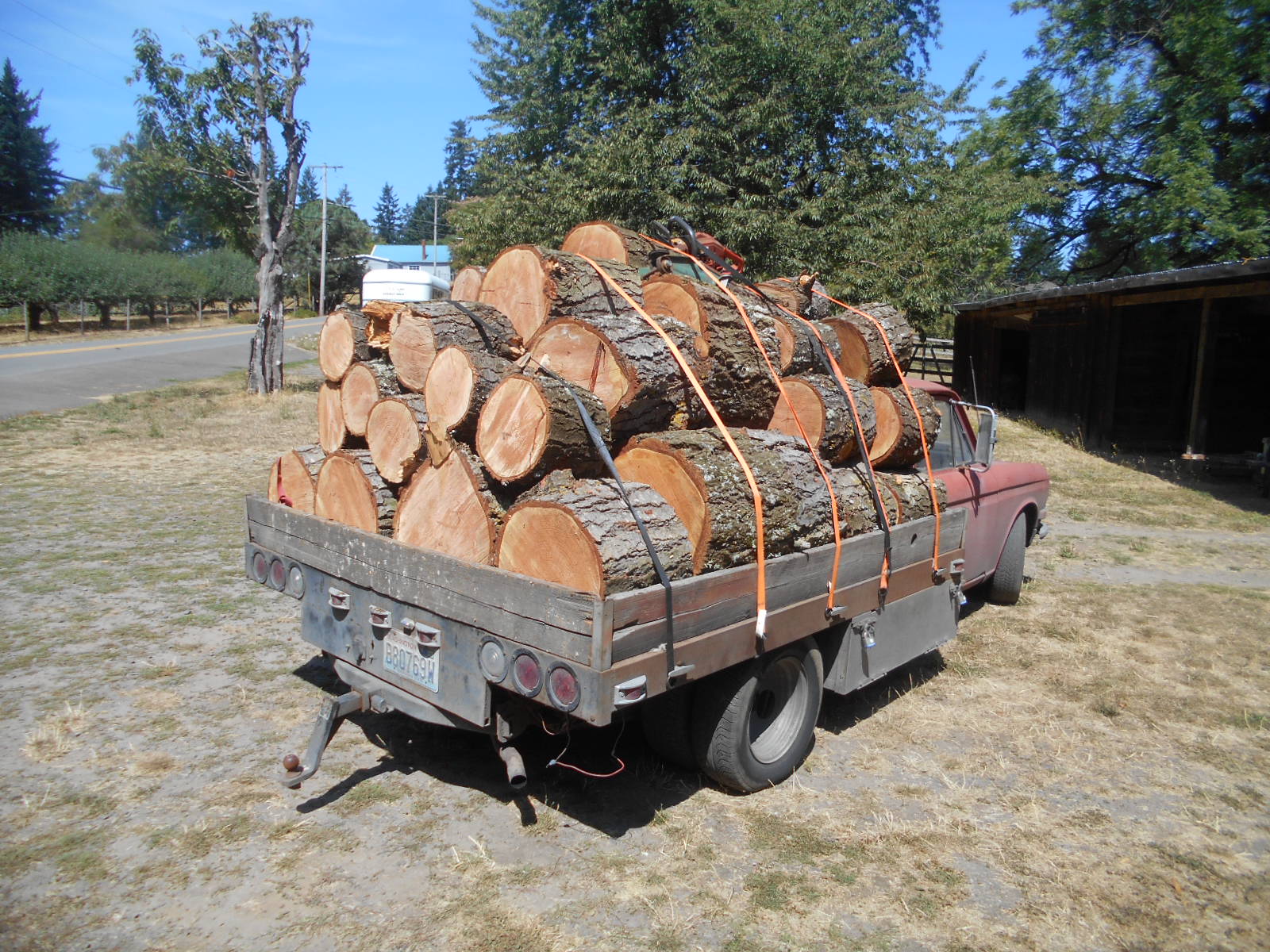

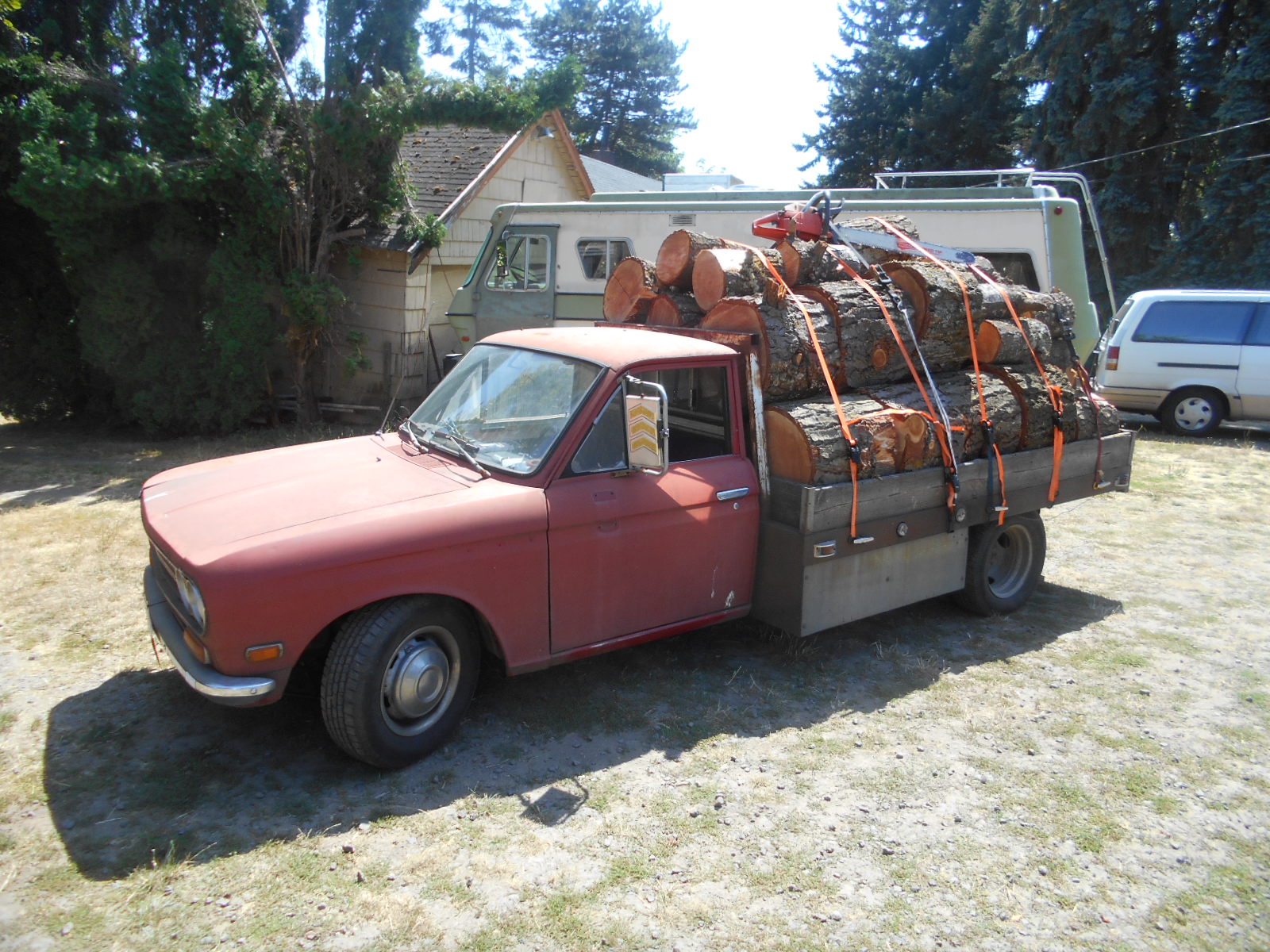

I picked up some wood today with this truck, I didn't think there was this much wood there, but the guy kept dragging big limbs over to where I was till I told him to stop, my axle was a half inch from the frame when I got out of there, I took the wrong truck.
This is what I hauled home yesterday.

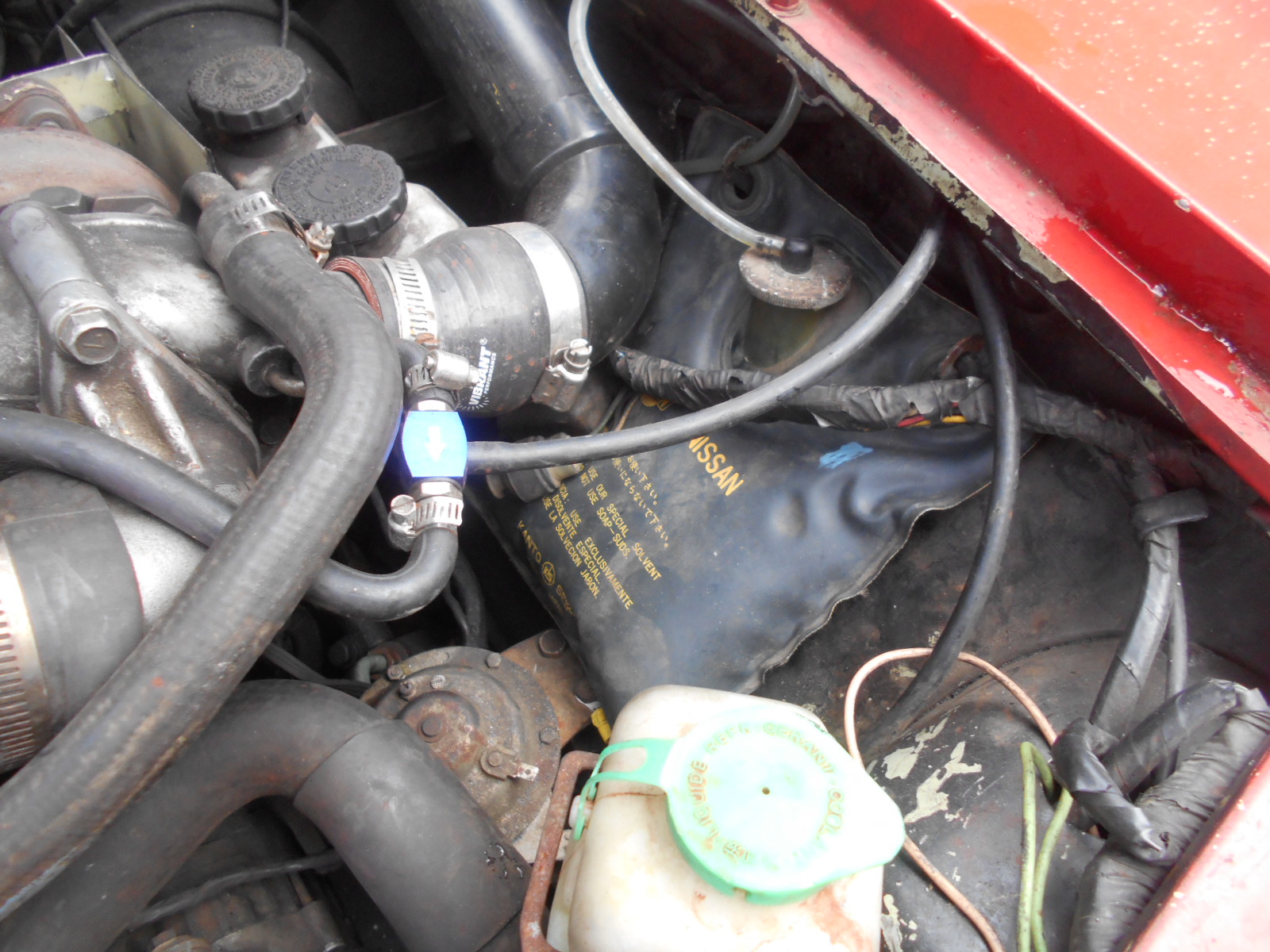

As I mentioned before, I also found more power during this process, the vent line I have piped to boost now has a "Tee" in it going to a valve in the cab, if I have that valve closed it's like there is no tee in the line, it has lots of power compared to how it was without the turbocharger, but if I open the valve enough or just pull the valve off the hose the truck noticeably has more power, but in certain circumstances with the valve removed or open to far when I am going thru the gears or trying to hold a steady speed the engine starts to surge, if I close the valve a little more(less leak) or pinch the line with my fingers the surging goes away, it has plenty of power with no tee in that vent line, but that power is there to be had, I believe that having that controlled leak in that line lets the injection pump run a little richer, but I have tried running the engine with that line vented to the air and the engine surges real bad like it is running away, that vent line has to be a controlled leak or no leak at all, the 720 turbodiesel has no such tee and has a shitload of torque/power, but that pump has been turned up/messed with and runs richer, at least that is what LarryR told me when I asked him, he is who I bought that diesel engine from, he has a few threads on here about the engine and what he tried after turbocharging it, but I could not drive it the way he had it, it ran way to hot(the EGTs), I would have smoked it, see my 720 thread about that story, it seems that my thing in life is to buy others failures and work on them till they work properly.

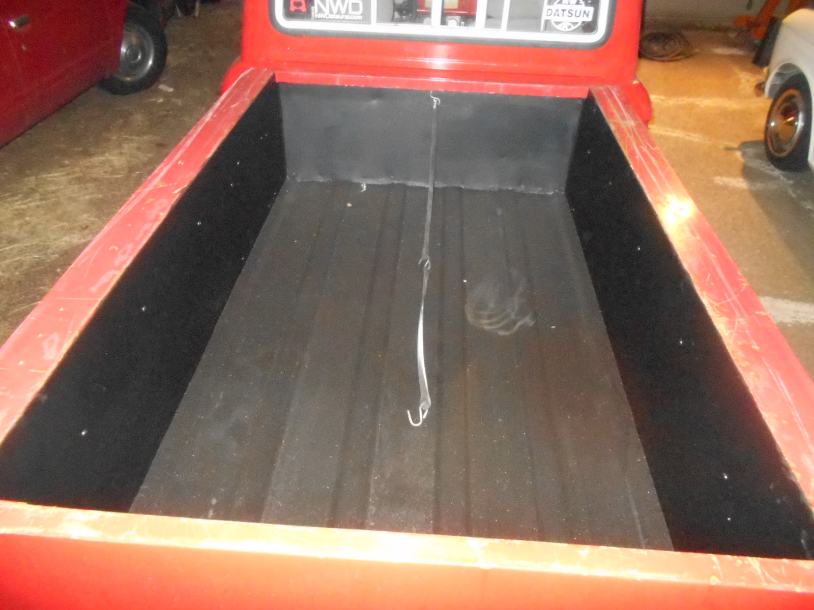

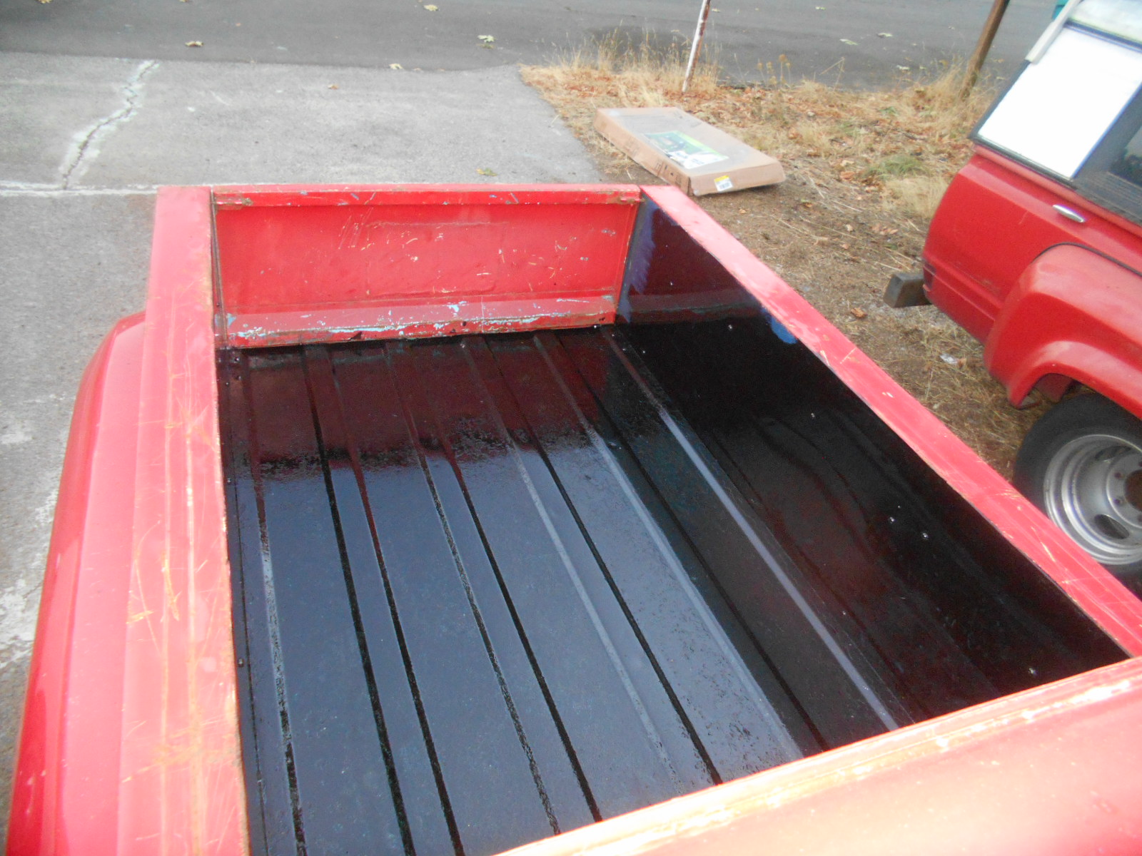

I worked on the box bed today for a little while, I pressure washed it out, then I scraped on it with a scraper for a while, then I blew it out with air, then I covered anything with rust with POR15 which was basically the whole bed floor and spots on the bed sides, if the weather holds I will likely paint it with Rust-oleum flat black(oil based), I have a small paint gun and a regulator.

I then painted it with Rust-oleum flat black(oil based) like I mentioned above, I did it with a brush and roller, I might apply another coat tomorrow, but it looks decent the way it is also.
