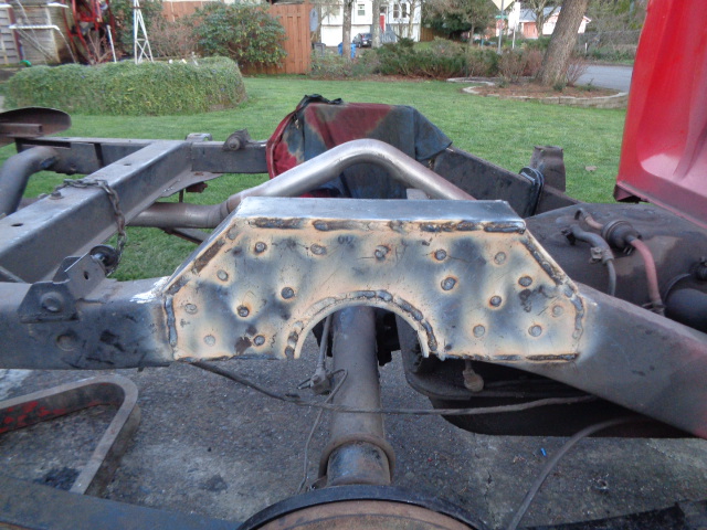

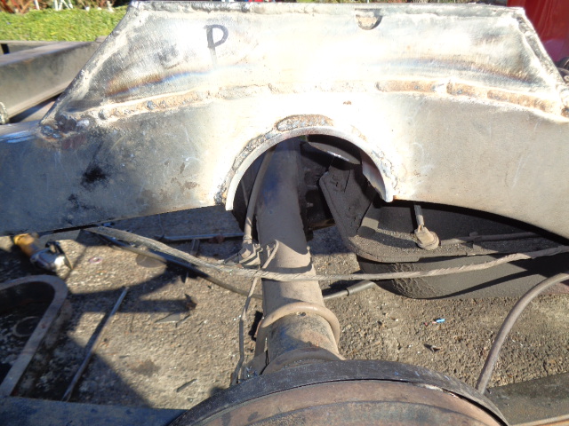

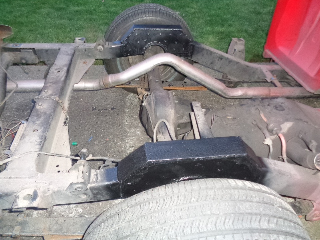

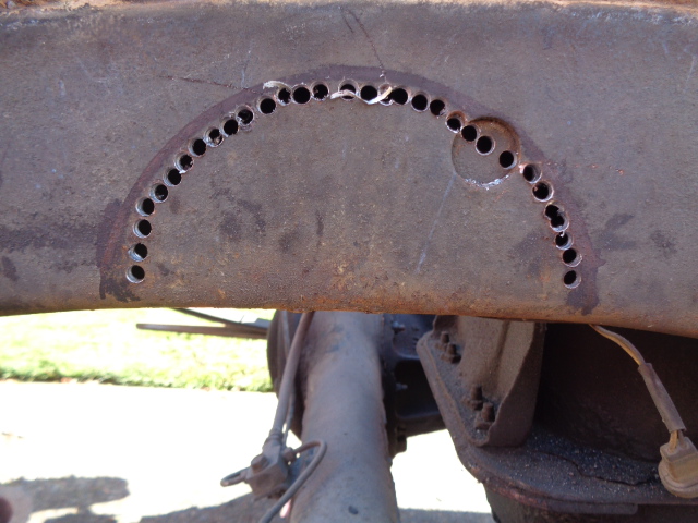

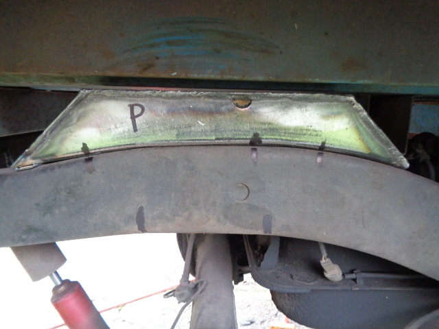

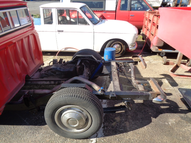

I did a frame notch to this truck last week, if I put even a little weight the axle would hit the frame(no bump stops).
First I put Datsun 720 4wd leafs in the rear, I kept the 2.5" lowering blocks that were already in it, then I did the notch.
First I made a frame brace/stiffener for both sides that would not hit the box above it as I didn't want to cut holes in the box bed. Then I removed the box. Then I did the notch Then I made plates for the sides with holes in them so I could kinda spot weld the whole thing together, then I welded the plates all the way around outside and inside. Then I painted and undercoated the notches. I then undercoated everything that could be seen from the outside. And it is all back together. I tore out the complete dash today to upgrade my dash lights so they are adjustable like they were in the 720, I didn't figure out how to do that back in 2010 when I first built this truck, I tested the wiring and all appears good, so now I will apply sound deadening material to the interior firewall and fill/block all holes, I did the windshield the week before and it appears I fixed all the leaks caused by the windshield gasket, I also installed my brand new windshield I had made 7+ years ago.

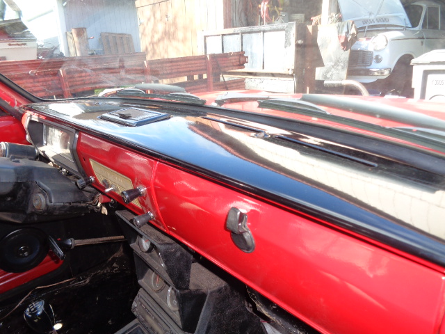

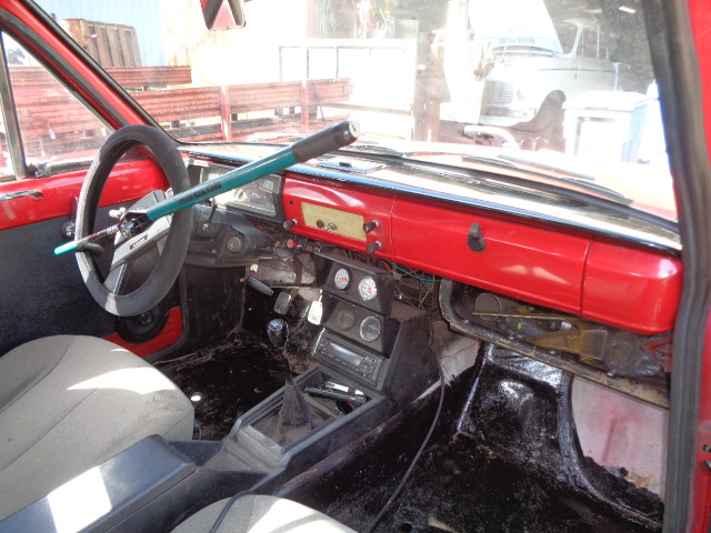

When I put the dash back in I will be using a freshly powder coated dash face and metal top that has been in storage for as long as the windshield.

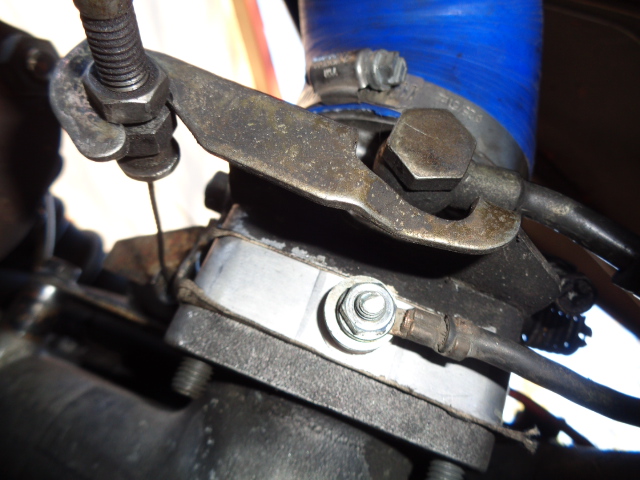

- Posts: 645

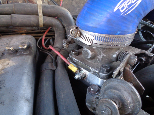

Here is the Air Heater Element installed, it's kinda funny, red is ground and black is 12V, it just turned out that way length wise.

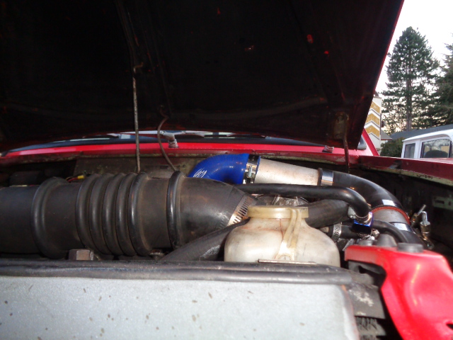

I shaved the blue elbow on one side and twisted the elbow connected to the turbo down which forced the whole assembly lower, I don't think it rubs on the hood anymore, I will know when I drive it again as I cleaned off the elbow where it was black from rubbing on the hood.
