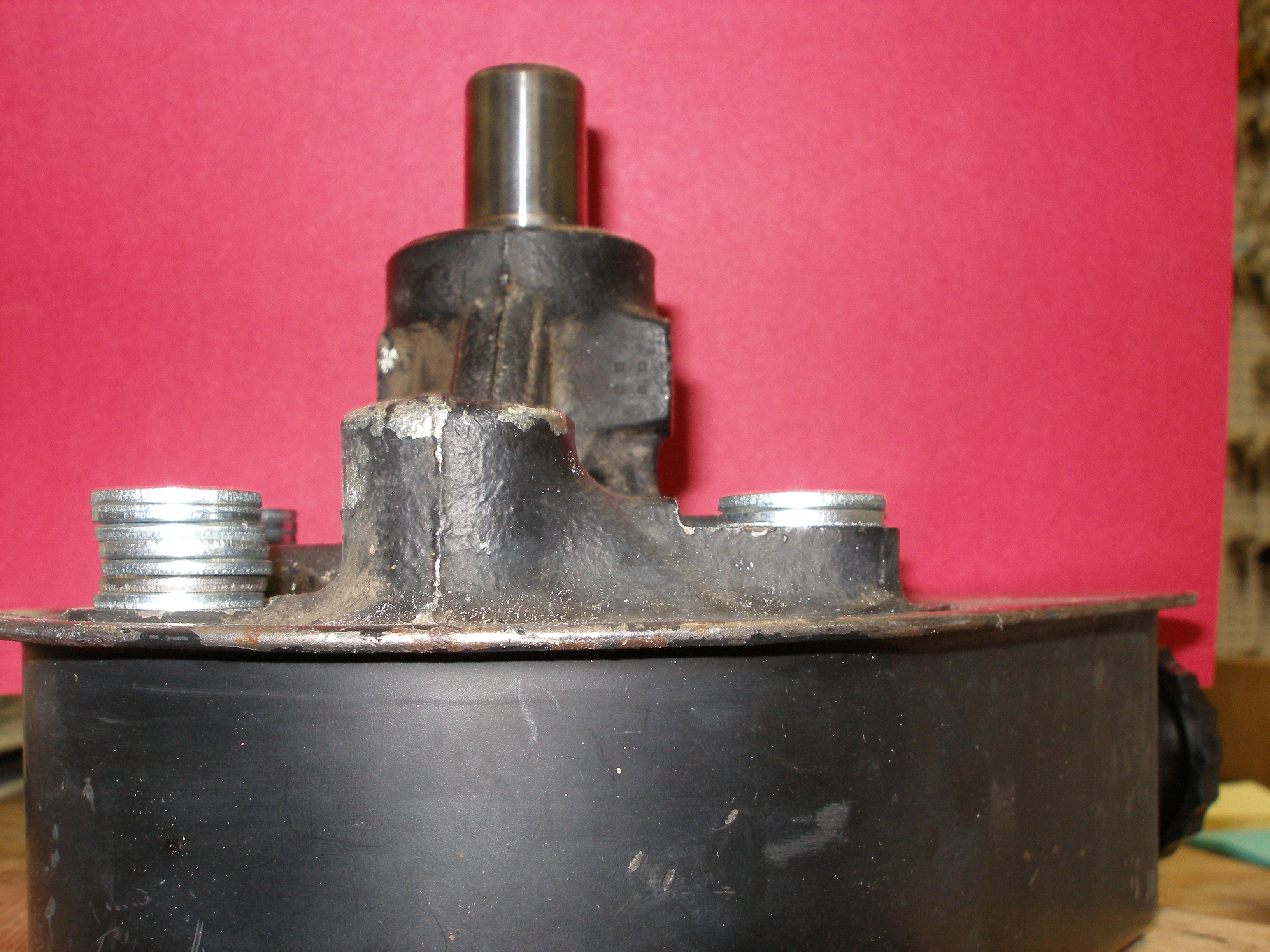

I was experimenting with plumbing washers and actually found a couple that would probably work on the PS lines, if the temp didn't get too hot.
