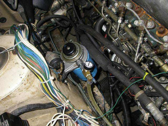

Here's the vacuum gauge at the filter:
Notice the tygon (sp?) tube? The GCC tech installed it and said it's suitable for biodiesel.
Between the gauge and the LED, I should be able to have a clue next time why the car is having trouble starting.

If that tubing is transparent or translucent then you have another important troubleshooting aid: You could see small bubbles indicating air entering the system under vacuum.Midnightz wrote:Notice the tygon (sp?) tube? The GCC tech installed it and said it's suitable for biodiesel.

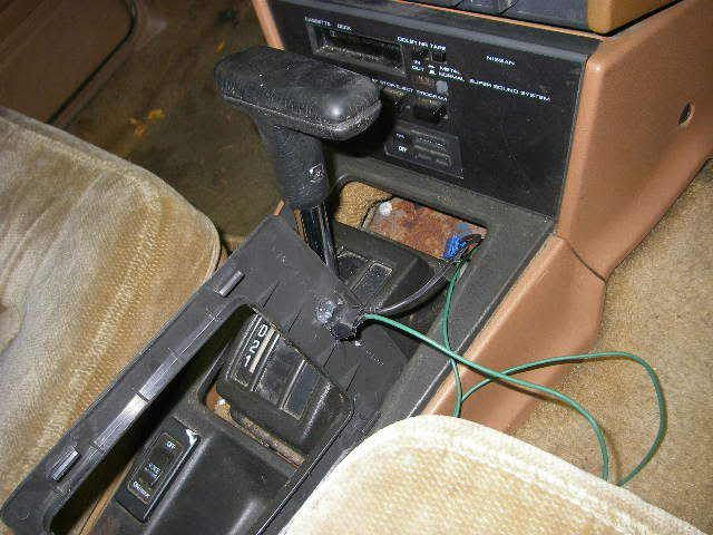

Would be interesting to see how long the GPs stay energized under cold start conditions, and warm start conditions. Could you report that to the forum?Midnightz wrote:I've wired a LED to the GP #1

The GP's energized for about 3-4 seconds under cold start. Went off after the main GP relay clicked. Haven't yet start warm. I thought the GP's would energized a bit longer w/ reduced voltage (after glow?), but I am not seeing that. I'll have to take a closer look at that later...Carimbo wrote:Would be interesting to see how long the GPs stay energized under cold start conditions, and warm start conditions. Could you report that to the forum?

Based on my three, should be closer to eight seconds cold.Midnightz wrote:The GP's energized for about 3-4 seconds under cold start.
Yes, you should see (reduced) voltage at the GP bus while cranking.Went off after the main GP relay clicked. Haven't yet start warm. I thought the GP's would energized a bit longer w/ reduced voltage (after glow?), but I am not seeing that.
