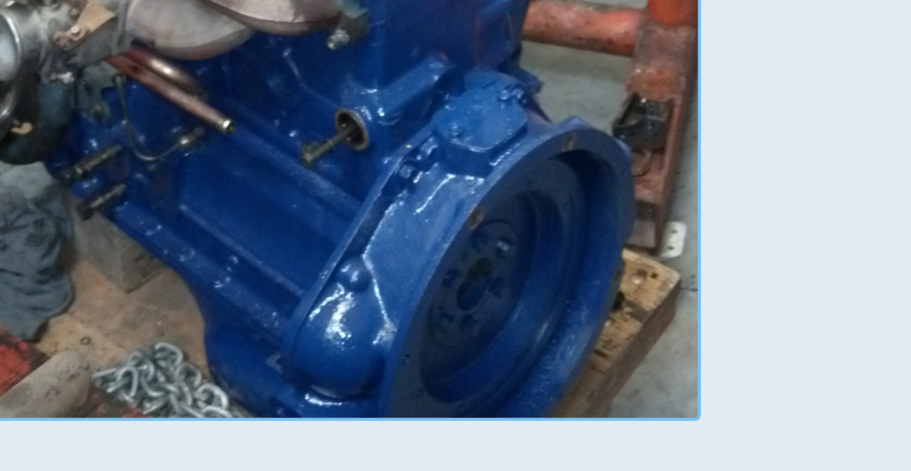

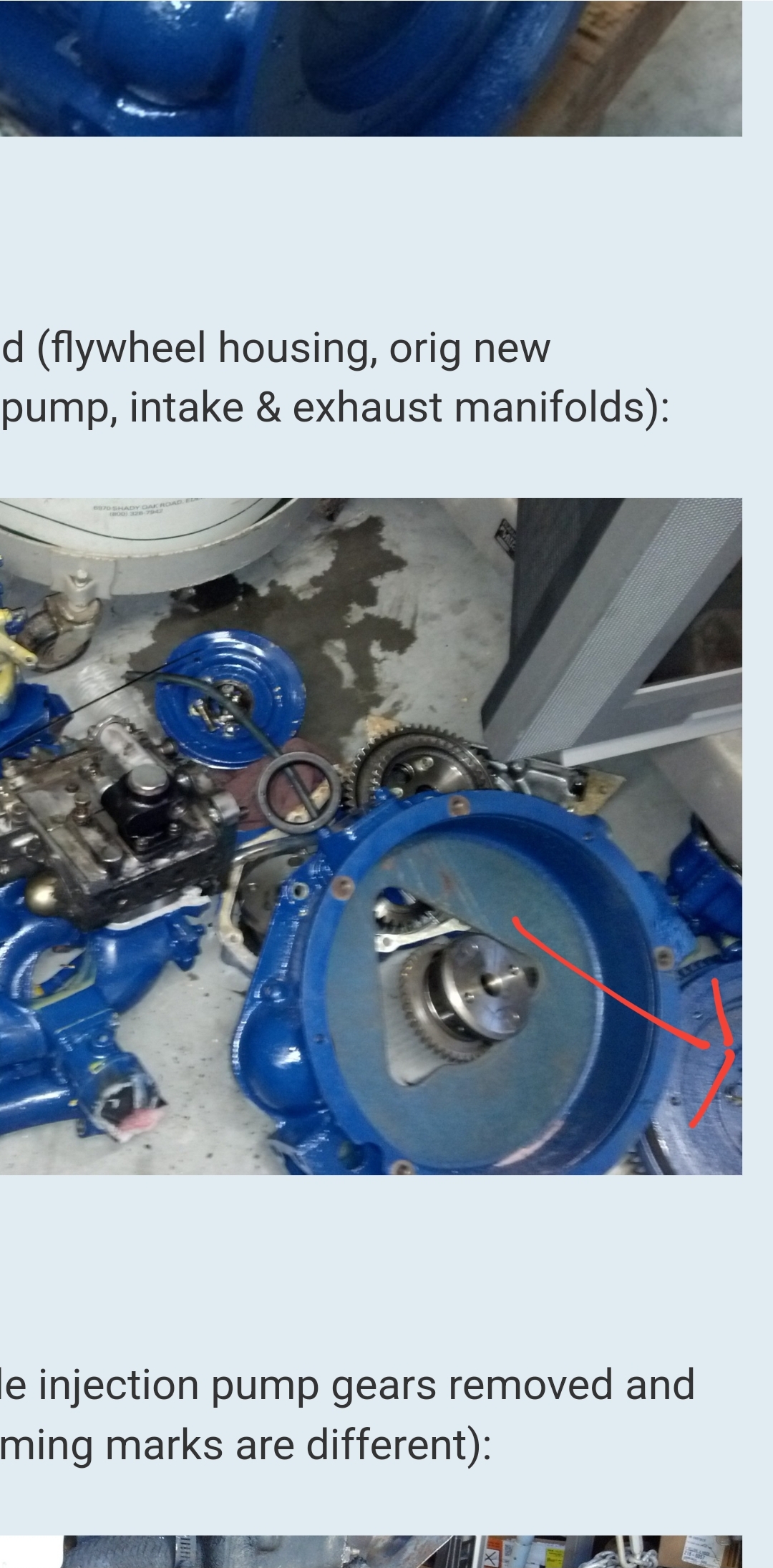

Just circling back to this since I was thinking about it tonight. Fromm what I can tell in your pictures it looks like the original flywheel was taken off. If you get the chance to see if it is still around let me know, I'm ready to get this machine working again.

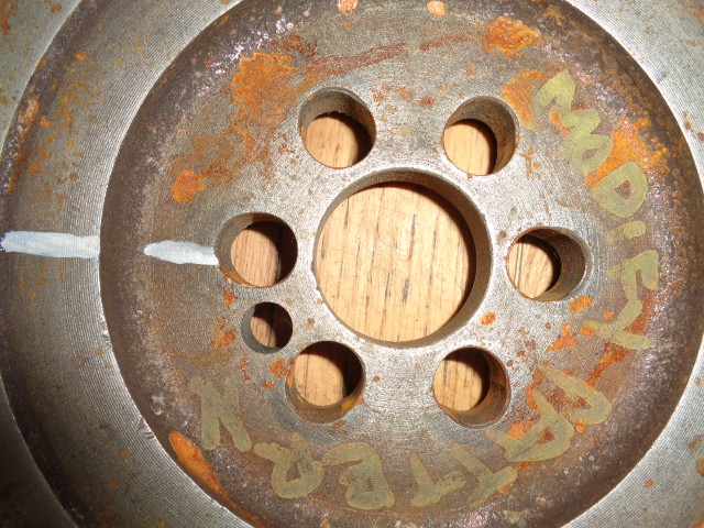

Thanks waynosworld I may have to go down a similar road. I actually have the SD25 flywheel out of a the forklift sitting in the shop. I'm looking for one like pictured so I can use the threaded bolt holes on the face to attach a mounting plate which then connects to the hydraulic pump on my skid loader. Any marine or stationary SD22-25 flywheel would work but every one I find is from a forklift or a 720 pickup. If I can get that flywheel this conversion will be relatively simple.
Re: New SD22 from Soot Fart finally installed in forklift
I guess I do not know all the details, I do know that the SD22 and SD25 have different flywheel bolt patterns on vehicles, so unless the cranks of special use engines are the same, I am confused.
Can you make an adapter plate that bolts onto your SD25 flywheel that will except your mounting plate?

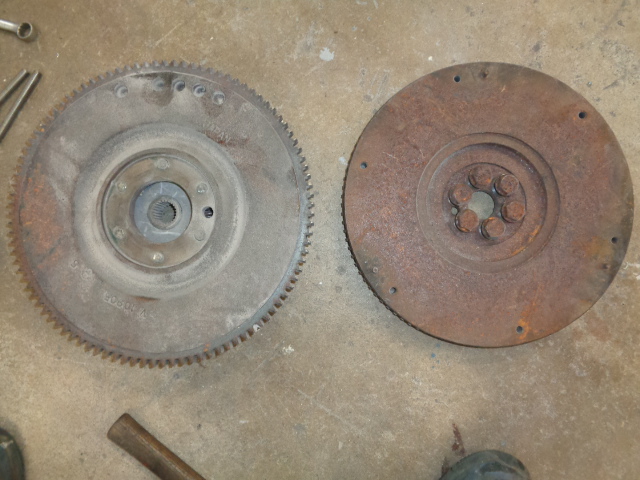

Here is why I am confused, the backside of the flywheel on the left is from an SD22 engine, the mount pattern is large, the one on the right is from an SD25, it has a small tight pattern, the flanges on the cranks are completely different sizes.
I know of no way to mount an SD22 flywheel on an SD25 engine, otherwise I would have done it myself, I just checked and it appears I scrapped that SD22 flywheel without the ring gear.

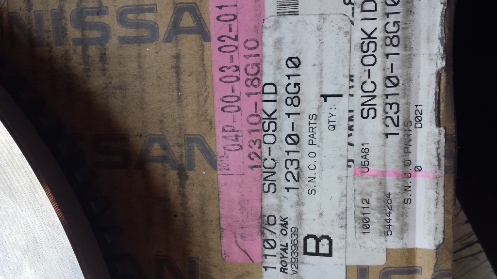

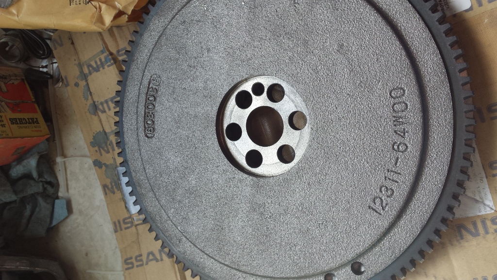

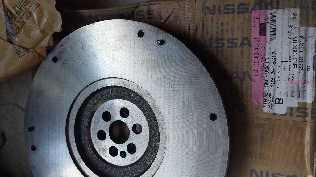

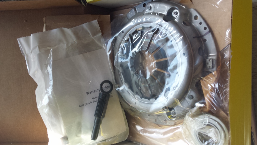

I just caught up to this.
I have a new in the box SD25 flywheel with ring gear on it. Had it for years.
Part number on the box is a bit different than that cast into the flywheel.
Flywheel casting number is 12311-64WQ00 and the Nissan Part number on the box is 12310-18G10.
If I can remember how to post photos I will.
EDIT: Just found the bill, bought it November 2011.
Edit again. I think I figured it out. I resized the pictures and chose "medium" for sizing but apparently they are still pretty big. In any event you can see what I have.
P
P
