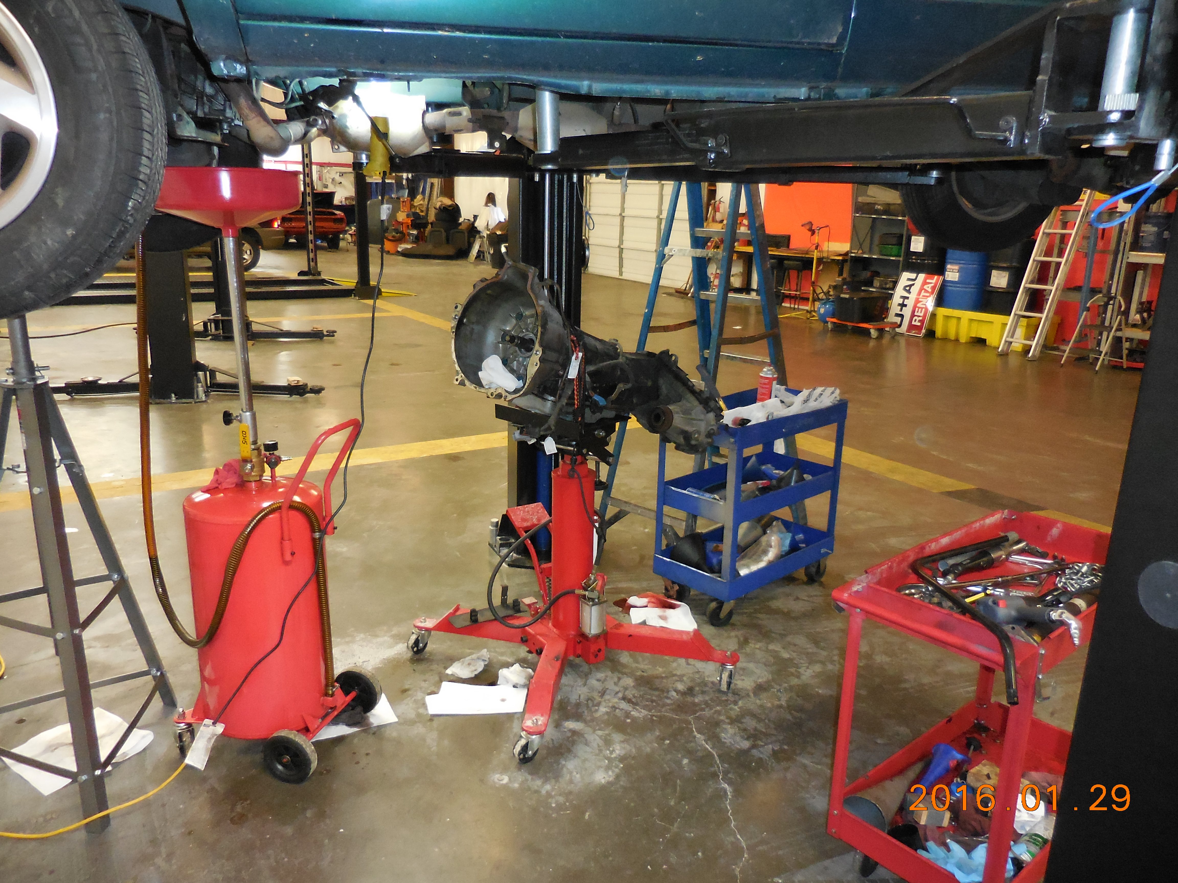

I got a P1744 a month ago. The torque converter clutch had died. This had happened on my '89 Aero too, which I drove until the clutch material plugged up the filter and the trans lost hydraulic pressure and stopped moving. The newer Aeros use an electronically controlled version of the same venerable A4LD, which they now call the 5R55E (in my case), and the electronics can tell that when the AT is told to lock the torque converter clutch, the RPMs should drop. When they don't, I get a CEL and a P1744.
Since this is an AWD rig, there's a transfer case. I am in my 50s now and while I've done several R&Rs of A4LDs in my various Aeros over the years, this is a different critter. I chickened out: I rented a bay in a self-service garage. Unfortunately, it's 1.5 hours away, but my AAA RV coverage handled that part nicely. Two days, $300 of bay rental and about double that in a torque converter, ATF, seals, tools, AT cooler flush, lunches, etc. and it's back on the road and I've got 1000 miles on it with no problems.
1997 Aerostar 4.0l OHV e4WD, trans & transfer case removed using rented service bay and transmission jac.

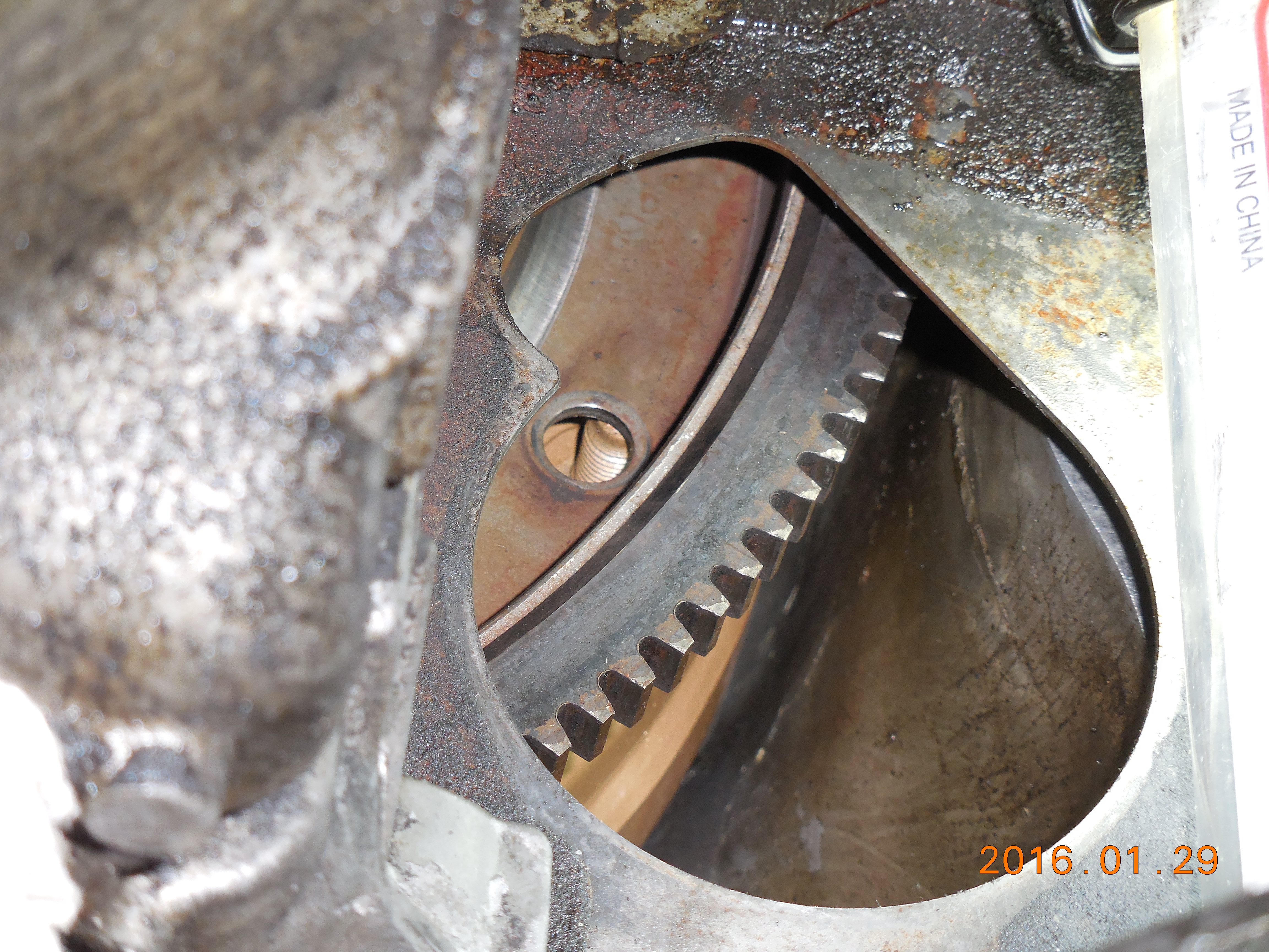

1997 Aerostar 4.0l OHV e4WD, torque converter stud to flex plate alignment through starter mounting hole.  This is tricky to get aligned, and trickier to get the nuts tightened & torqued.  Lots of ratchet extensions to the front to get around the front axle and motor mount, IIRC.
What with the towing and travel time, this took two days, and though I'd wanted to replace the engine rear main seal while the trans was out, there just wasn't sufficient energy or time. I even had the sleeve kit and seal with me :(
