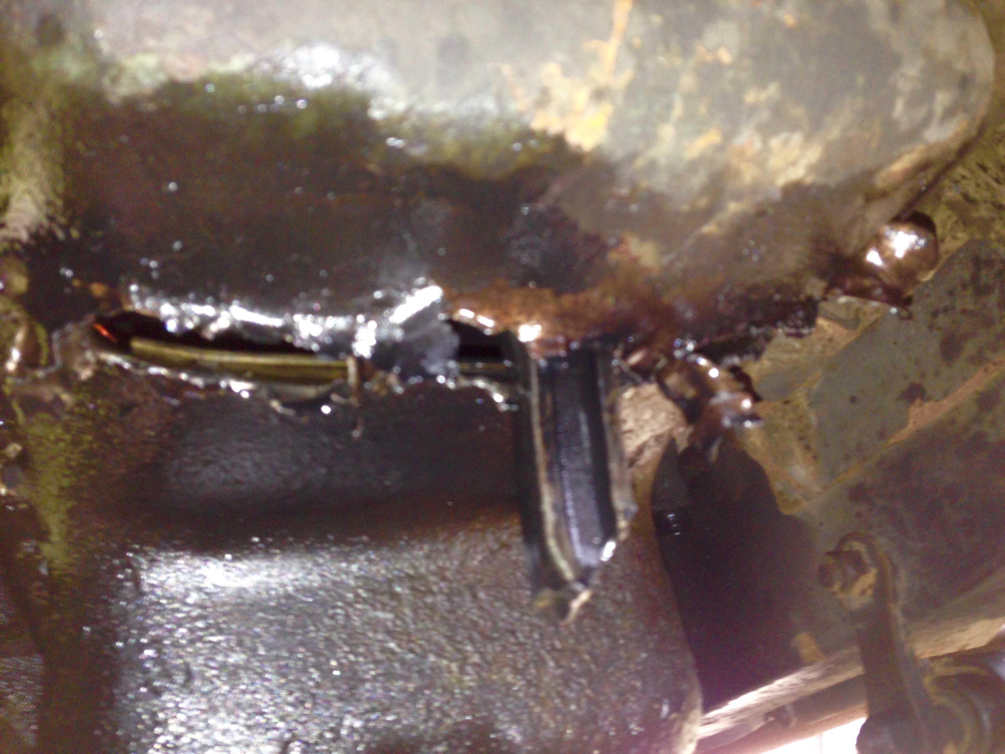

Not a pretty sight!
Not a pretty sight!

Today when i did some closer inspection on the engine it´s clear that it has passed on to diesel heaven. There was a big hole in the engine-block so i could see right thru the block and thru the gashed oil pan :(
